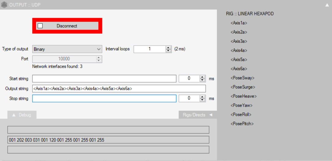

  6. Victor Urnes
    Victor Urnes New Member
    Jan 13, 2019
    20
    113Coins
    Motion platform, 6DOF
    We are trying to use the FlyPT mover with a wago PLC. Programmed in CodeSys. We are trying to receive the signal on the PLC via UDP, but are struggling a bit. Have somebody done it before? And how?
    Victor

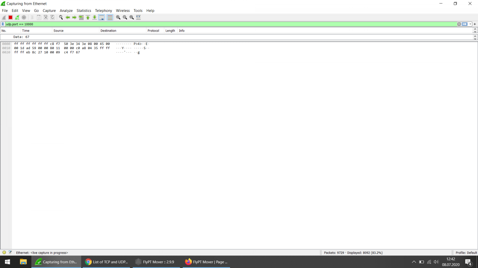

  8. Victor Urnes
    Jan 13, 2019
    20
    113Coins
    No, I havent tried.
    The string command is <Axis1a><Axis2a><Axis3a><Axis4a><Axis5a><Axis6a>.
    I have tried to sniff the output from FlyPT. It sends a short command every time i connect, but nothing more. See screenshot from Wireshark.

    Are you expecting binary or decimal?
    Please show me the output window also.

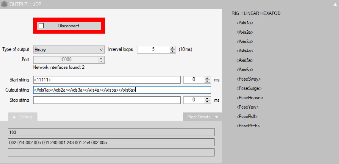

  10. Victor Urnes
    Jan 13, 2019
    20
    113Coins
    We are expecting binary signals. See screenshot.

  11. pmvcda
    pmvcda aka FlyPT
    Nov 3, 2010
    2,096
    Portugal
    14,906Coins
    +2,504 / 17 / -0
    That start string seems to have a problem...
    11111 should not be just 103, but 103 043
    Try to replace <11111> with <103><43>
    Not sure this is the cause
  12. pmvcda
    pmvcda aka FlyPT
    Nov 3, 2010
    2,096
    Portugal
    14,906Coins
    +2,504 / 17 / -0
    Or <43> <103>...
    Now i'm in doubt. Not near a pc to test
  13. Victor Urnes
    Jan 13, 2019
    20
    113Coins
    Sorry. This start string was only for testing. I dont need it for the finish result. I cleared it, and its the same fault..
  14. Victor Urnes
    Jan 13, 2019
    20
    113Coins
    See this updated screenshot. Same issue with this settings.
  15. pmvcda
    pmvcda aka FlyPT
    Nov 3, 2010
    2,096
    Portugal
    14,906Coins
    +2,504 / 17 / -0
    Did you gave permission on the firewall for that port?
  16. Victor Urnes
    Jan 13, 2019
    20
    113Coins
    Yes, same issue. We have a Thanos card laying here, maby we'll just use that...
