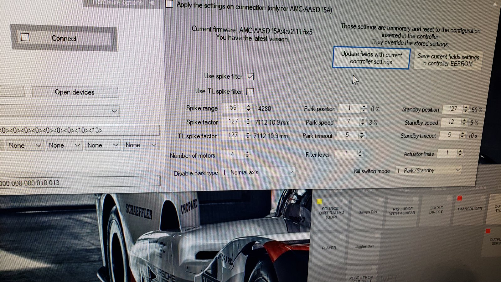

    So I'm having a bit of an issue. I think latest thanos firmware related. The spike filter in hardware doesn't match the latest flypt display.
    When I press update fields with current controller settings it doesn't update anything. And I know the spike filter activates lower than set in thanos. In dirt rally 2, certain jumps used to be ok, now the filter activates at a lower level. Setting the filter higher in flypt doesn't fix the problem .

    I didn't change anything from fix4 to fix5 regarding the Spike filter remote settings.
    BUT... SRS had same issue which it came down to removing the LF and CR characters in the end of send the remote commands and adding a bit of "sleep" time between sending the commands to set these parameters remotely, as they use buffer stream not interrupts like the real time motion data... also helps if the motion software does not sending motion data while attempting to send and set these remote parameters.
    Maybe @pmvcda can check the above and do a quick fix about the additional sleep time between each send and removing the LF/CR characters in the end...

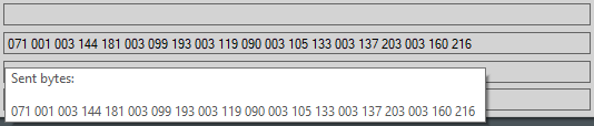

    @pmvcda I assume you work on 3.3.6? I have a feedback on that custom version from Dec.,1st that was handed over to me by @Trip Rodriguez to help me in my ongoing struggles to set up my rig (GforceFactory EDGE6D).
    I run the build and I set up an OUTPUT::TCP and a RIG::JUST POSE module. For the first time ever everything seemed to work as expected!:) Every movement of any of the six sliders was mirrored precisely by my physical rig. Throughout the whole range of the each slider, from one physical limit of the rig to its counter physical limit. JUST PERFECT!
    Next step was adding a POSE::FROM MOTION module. And here it happens: The very second I add the POSE..FROM MOTION window, the output string changes and freezes. This happens even with the checkbox "POSE::FROM MOTION" NOT checked.
    You should be able to replicate it with the attached settings and that 1st-Dec. build. Just add a POSE::FROM MOTION module to it.
    Here's is a correct output string BEFORE
    and AFTER (adding the window)
    My gut feeling says the value naming conventions might be the source of the problem. You mentioned several times that you are not quite satisfied with its current state. But you'll know better.

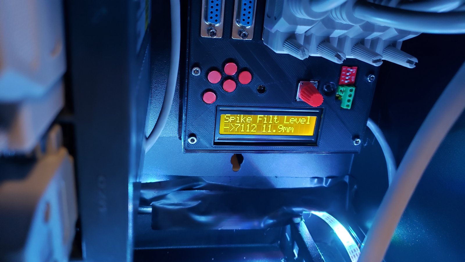

    Just to update you on this, for example I have Thanos set at
    Range: 14280
    Filter:8400 (14mm)
    In Fly PT it detects it as
    Spike Range: 14280
    Spike filter: 8400 (12.8mm)
    Before the Thanos firmware update, the highest spike filter I ran was 7112 (11.9mm) in Dirt Rally2, and that was ok on most jumps. And the two settings matched. (Thanos/FlyPt) Now even at a 14mm filter in thanos, it seems like it activates a lot lower.
    So I'm not sure what changed.
