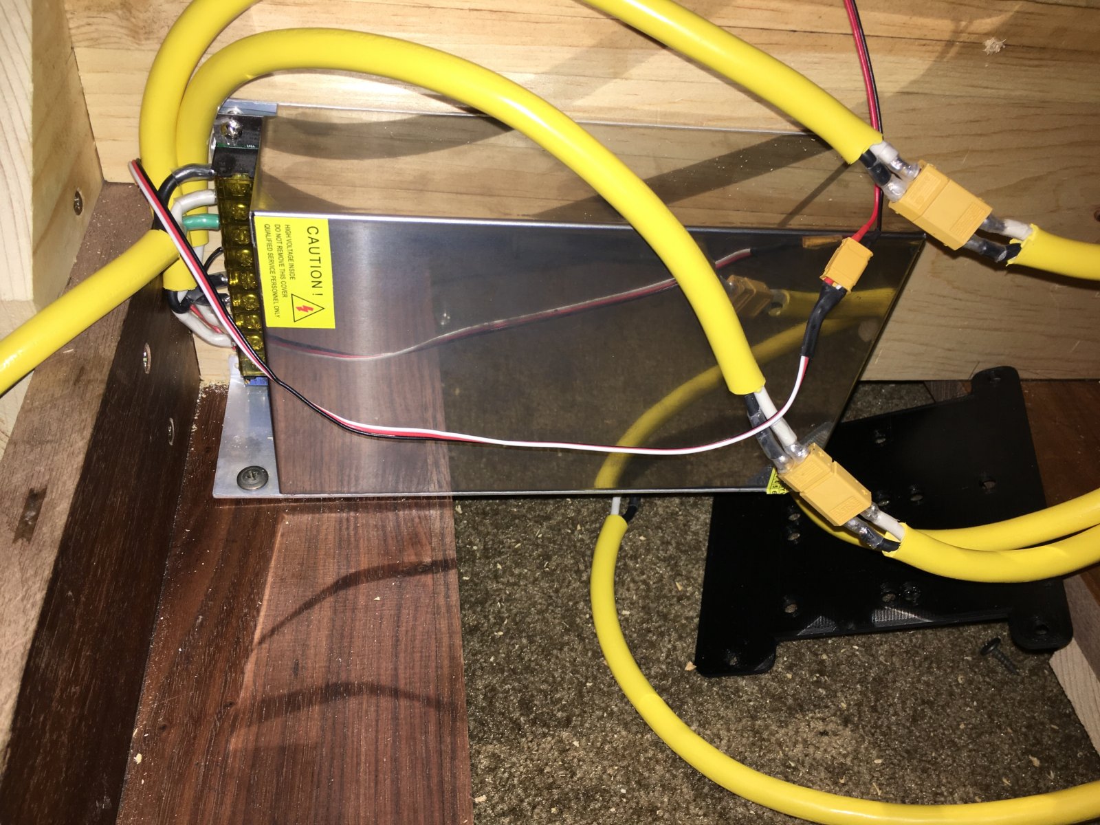

    Forgot to mention. The power supply was clicking during some of the more extreme direction changes. It sounded like a relay firing. I didn't notice any issues with the power feeding the motor, but it does have me concerned. Wondering if I need to wire up a diode between the IBT-2 drivers and the power supply.

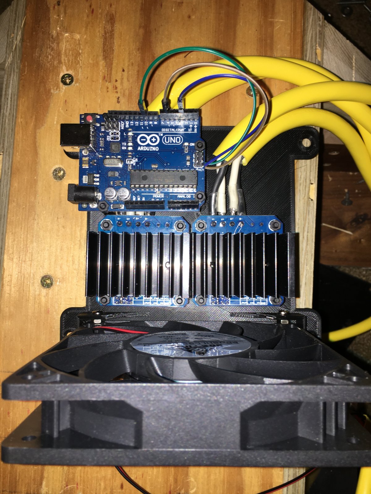

    Good to know. I’m running IBT-2 at 24v. The heat sink gets pretty warm during testing. But not alarmingly so. I’m gonna add some active cooking for a bit of insurance. Tried 35khz and did see some improvement with the noise.
    I’m not gonna worry too much about it until I start tuning it with a passenger. In my short motion tests while sitting in the chair, I noticed it quieting down quite a bit. So I’m thinking having no load is exacerbating the issue.

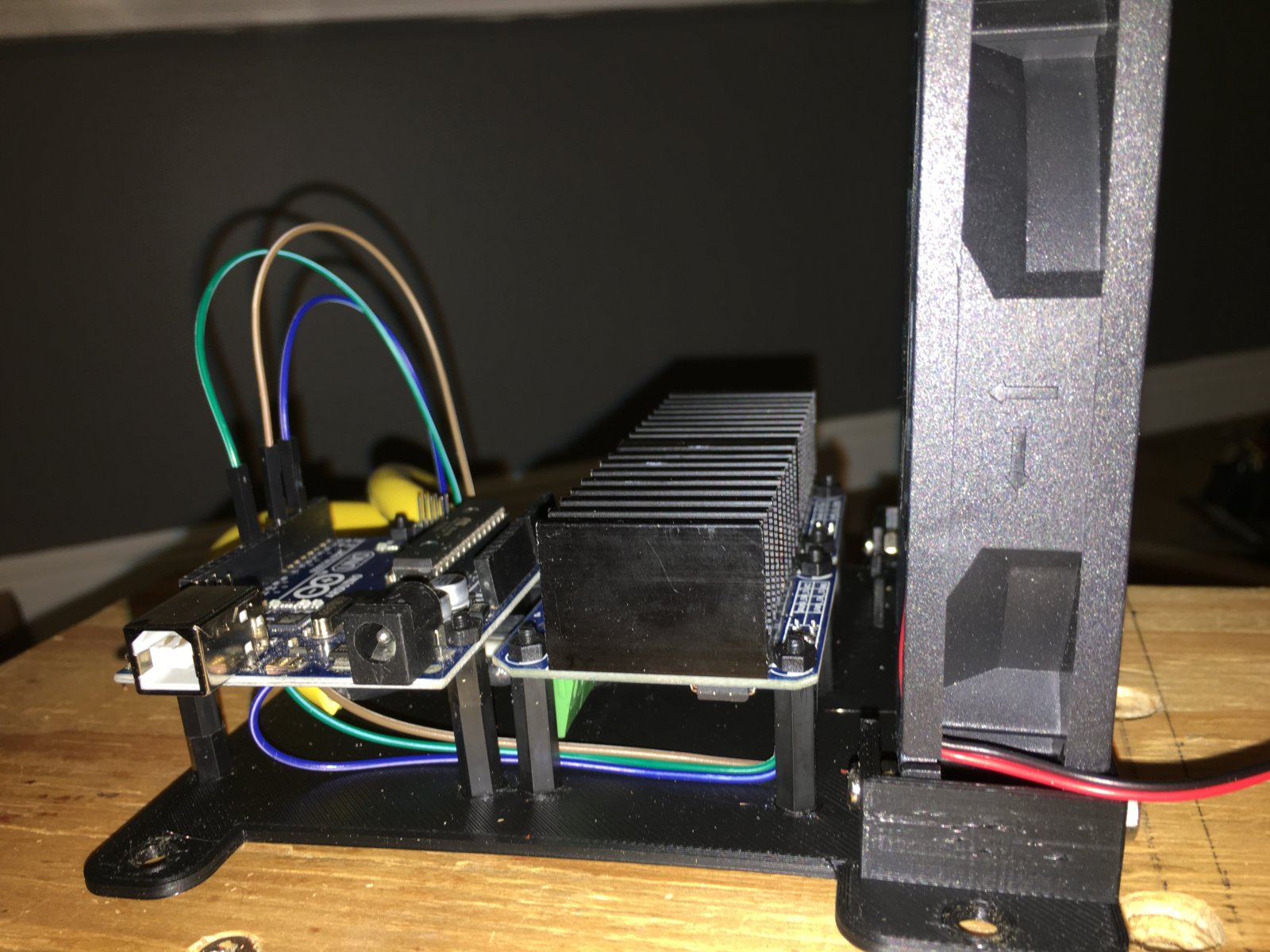

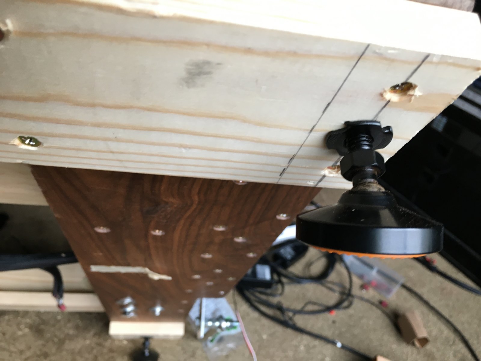

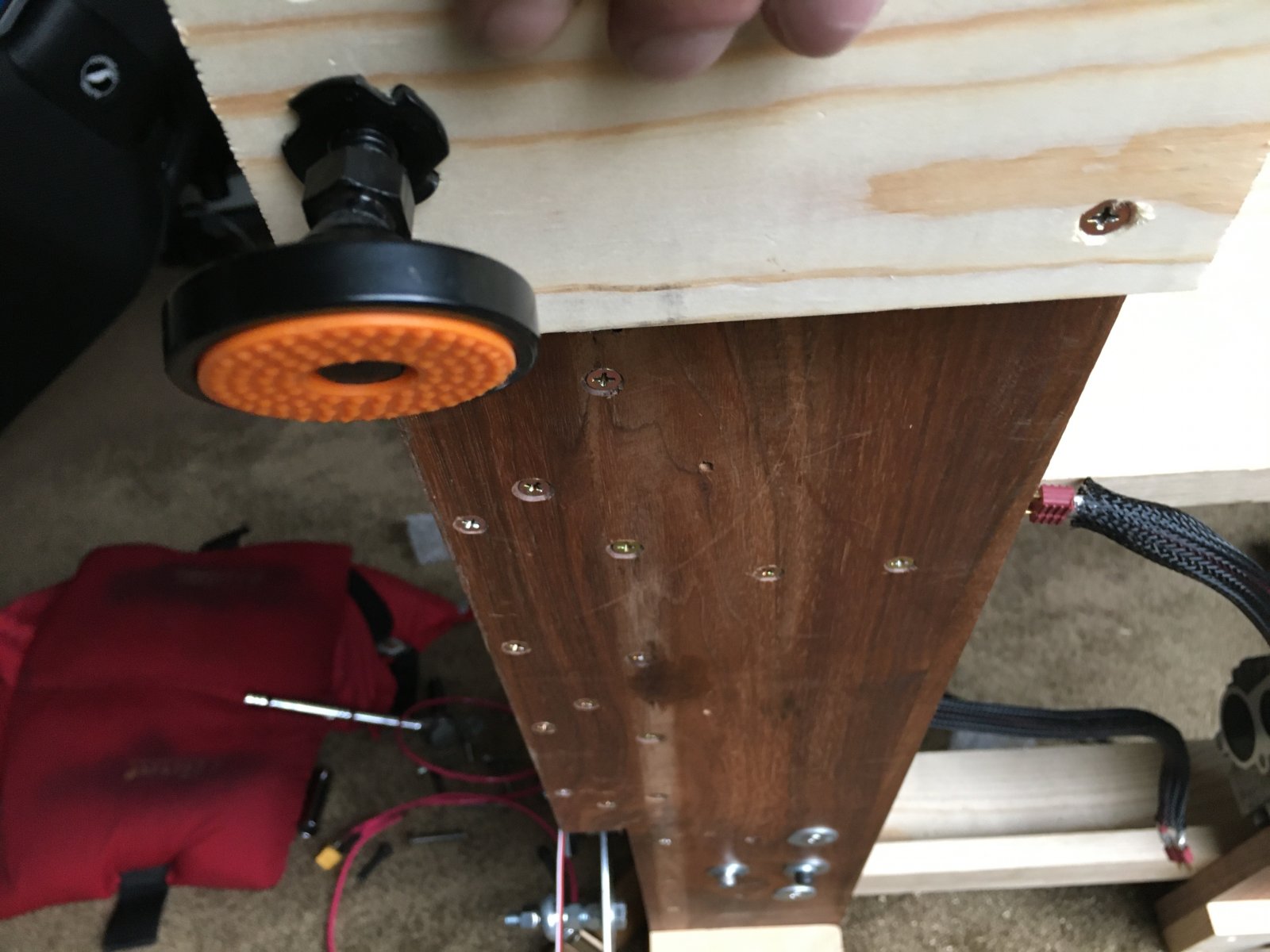

    Some updates. I installed the anti vibration feet. This has made the platform much more stable. [​IMG]
    Also printed up a mount for the electronics and a 24v fan. Man is that sucker loud. Gonna have to put a speed control on it I think. Doing some more permanent wiring now, still need to make it all neat and tidy. And debating whether or not I need to do 2 power supplies. My current one is 1000w. The motors are spec’d at 275w each but have like 950w peak draw.

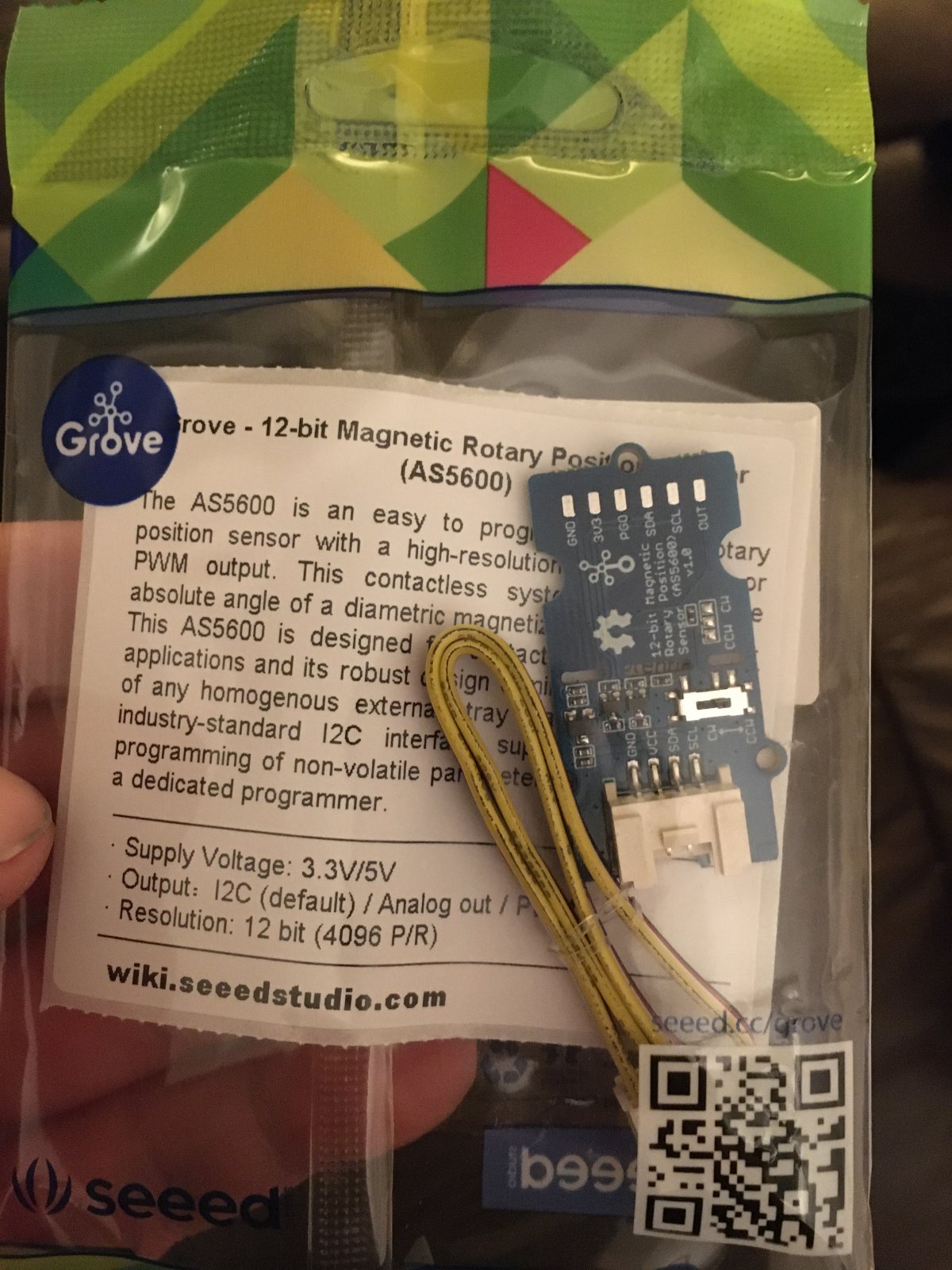

    Well some progress and some backtracking. The PWM code is just not working consistently. For one thing it’s a lot noisier than it should be. And it was going crazy when both motor drivers were enabled.
    Ironically the original as5600s that I ordered arrived yesterday. They only took a month in post. From LA. These ones haven’t been burned yet and are default analog. I decided to use those for now since I really want to get a working sim. So I reflashed the arduino with the original smc3 code. And now I’m back to square one.

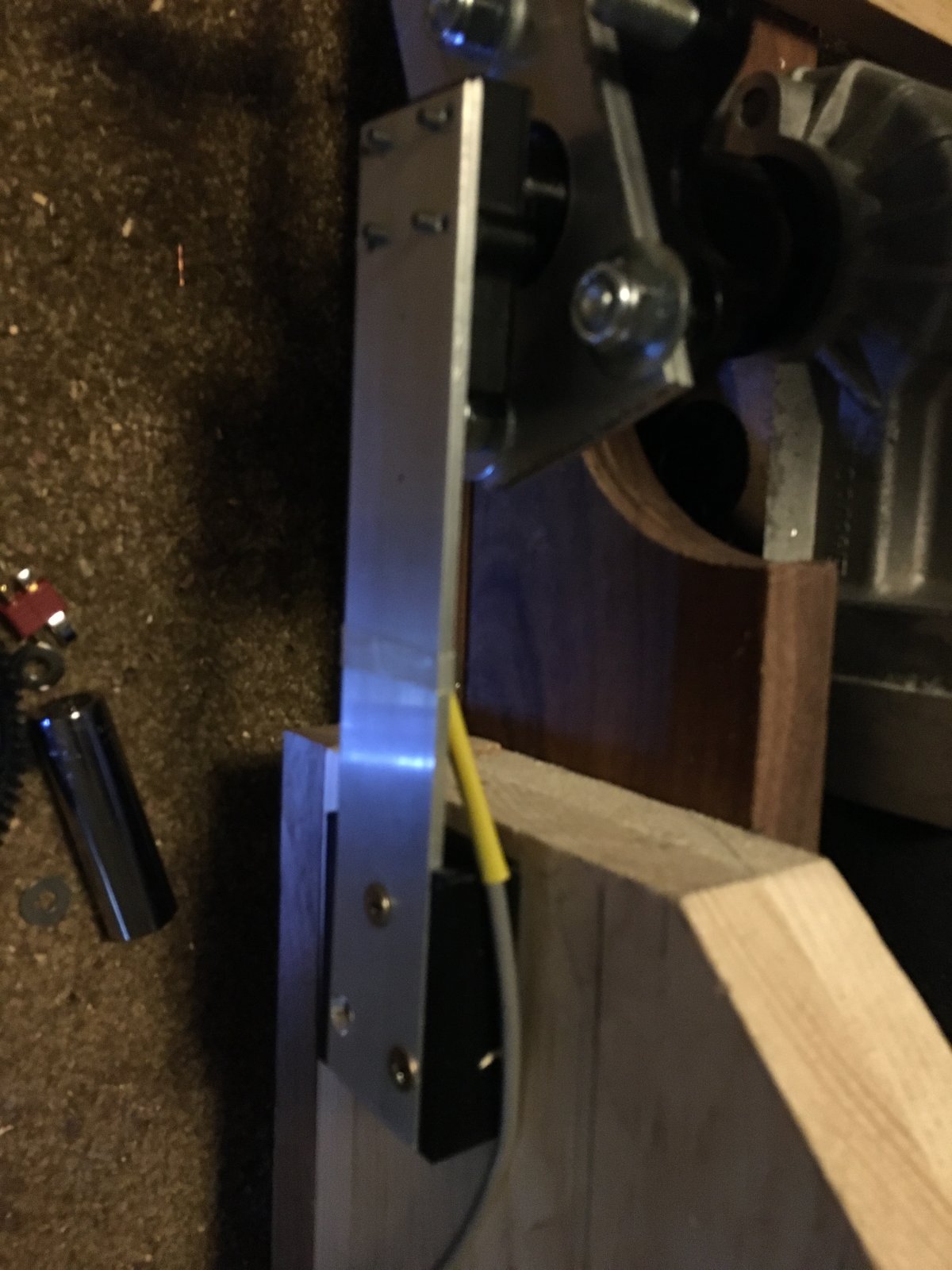

    Here’s the new as5600 board from seeed.

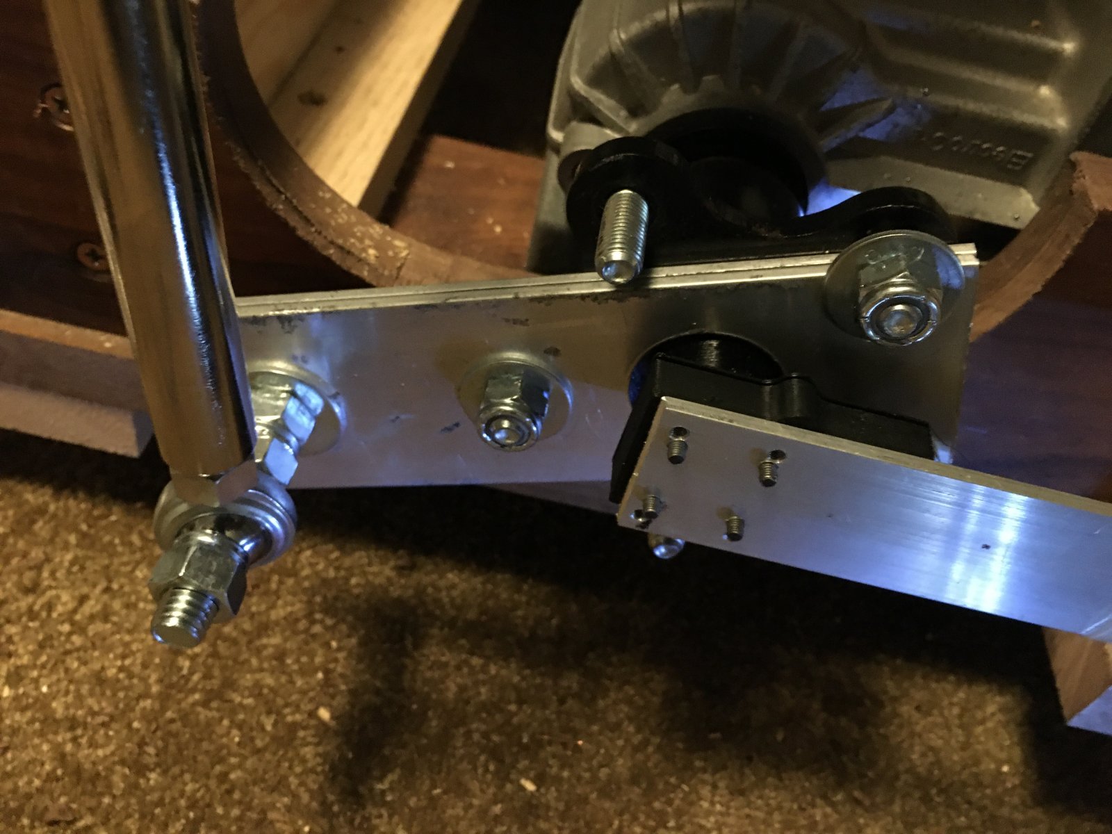

    This meant printing up a new mount. I decided I might as well print up a mount for the other side of the bracket as well. This now gives me a perfect air gap for the hall sensor.
    Also beefed up the CTC arm too.
    Hooked everything up to the first motor driver and the arduino and noticed that the range from the sensor wasn’t covering the full feedback range in the SMC utility. Basically it’s flipping to the low side too early.
    I can reprogram the ranges and the voltage range on the AS5600. But I’m wary to burn it permanently right now and I wanted a faster solution.
    So I did a few measurements modified the SMC3 code to add a multiplier to the analog feedback.
    Feedback looks really good now. And a lot cleaner than the pwm was. So that’s great. Except the motor drivers are totally freaking out.

    I’m an idiot. When I reflashed the code I forgot to change to mode 2. Now when I turn on the motor it responds correctly. Guess it helps to check your work twice. The multiplier seems to be working fine. I’m not sure if this reduces the resolution of the sensor though. I’m thinking it might. I’ll have to experiment with the different analog modes on the sensor and see if I can get the range to match better without the multiplier.
    Ultimately, it makes sense to me to interface with the as5600 over i2c. This bypasses a round of D to A conversions and would probably provide the most accurate and cleanest signal. But because of the fixed address on the chip, I think this would require a multiplexer. Or multiple Arduinos I guess.
    So I hooked up the second sensor and the motor driver. And... nothing. God this is frustrating.
    The second sensor seems to work fine though. So I’m guessing I have a bad motor driver. I’m gonna swap it out in the morning and see if that sorts everything out. It does make me wonder if the PWM code was entirely the culprit the first time around. I guess I should have troubleshoot that a little further. But I was frustrated by the constant holdups. And honestly the analog signal is a lot cleaner. So for now, I’m just gonna stick with what works and not try to break any new ground.
    I’m happy enough to have low profile, non contact sensors. Hopefully more updates tomorrow after I try the new driver out.

    Almost forgot. In all my experimenting I had noticed that the 24v fan would run at low speed whenever the Arduino was powered up without the power supply. This didn’t make a ton of sense since the fan is hooked up directly to the power supply and the Arduino is powered off USB. So the motor driver was feeding back 5v towards the power supply. I remember seeing that the ibt2 has internal 5v so I removed the 5v line coming from the Arduino and sure enough the fan stopped running. The driver seems to run fine on mains power alone so I’m gonna leave it. This does really remind me that I need to get some kind of protection in place for the power supply though.

    Well a day of victory and ultimate frustration. I swapped out the ibt2 and low and behold both motors are working. I finally was able to connect to Simtools and after some initial frustrations, started to dial in some settings.
    I’m using No Limits 2 as my initial testing. I figure the motions there will be far larger than most of the other games I play. After some confusion with the direction of the axis and such I seemed to get it roughly working.
    I tried a few ride ons and was experiencing some rough rides and some overshoots and such. So I dove deep into the smc utilities and found some settings that were getting me closer.
    The backlash on the gear box is killing me right now. I don’t know if backlash is just particularly bad on these motors or if the ctc arms are too long. I’m guessing they are. The range of motion is far more than I think I need at this point and the motors really seem to struggle when trying to recover from fast big moves. Especially the roll axis.
    I found myself overshooting the safety limits a few times and really hearing some whining from the motor drivers. Not sure if that’s bad.
    In any case when transitioning over the CG it is very violent and jarring and I can really feel the jolt when the free play runs out. I’m guessing shortening the arm will greatly reduce this. I’m at approx 3.5 inches right now. Do I go down to 2.5?
    So testing continued.
    Then tragedy. After a particularly violent move the motors seemed to stall out and then die. I heard a loud snapping sound and immediately killed power. It sounded like something mechanical, but I examined everything and didn’t notice any damage.
    So I powered up again. At this point I noticed the right hand motor was acting funky. I could press down on it and apply weight and it would hold. But it would vibrate and grind. When I lift up on the motor arm it moves freely though. Basically it seems like only direction is working. This was confirmed in the utility when I could manually move the arm up. But not down.
    I checked all my connections and they seem solid. I examined the motor drivers and that’s when I noticed. On the replacement ibt2 there is a millimeter sized hole in one of the motor driver chips. I’m positive this wasn’t there before. I’m not exactly sure what happened here. But all I can think of is that something overloaded and popped within the ic.
    So I’m wondering. Does each motor driver ic on the ibt2 only drive one direction? And did I just blow one?
    That was my last spare. I’ll have to order some new ones I guess. I may attempt to replace and reflow the ic from one of the other dead IBT-2s but I don’t have much hope for that. I may also try to troubleshoot the one that wasn’t working yesterday. But I really have no idea what’s wrong.
    Maybe this motor driver just isn’t cutting it. Except the left hand one seems to be working just fine so far.

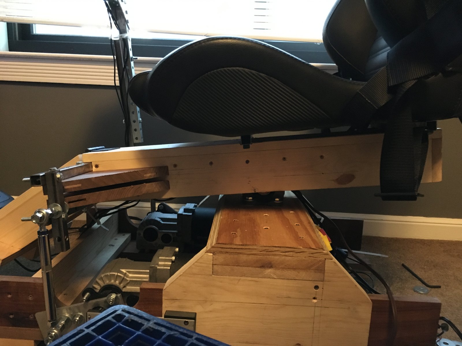

    Here are some of the updates. The motors were really straining to do big fast moves with a 3.5” ctc. So it’s been reduced to 2.5”. This should still give me about 15 degrees in all directions.
    I also realized that I could lower the seat in regards to the pivot. I figured it would increase leverage the lower I am. So the pivot has been sucked up to within a few inches of the bottom of the seat. [​IMG]
    This gives me just enough clearance for the pitch axis. It also has the added benefit of raising the linkage on the platform to a more rigid point on the frame. The attach point is still more or less in line with the pivot point. I know this reduces leverage, but I’m still trying to maintain a maximum range of movement.
    Got the replacement Ibt2 and it seems to be working well. Also got a 24v fan controller so the sound issues are much more manageable.

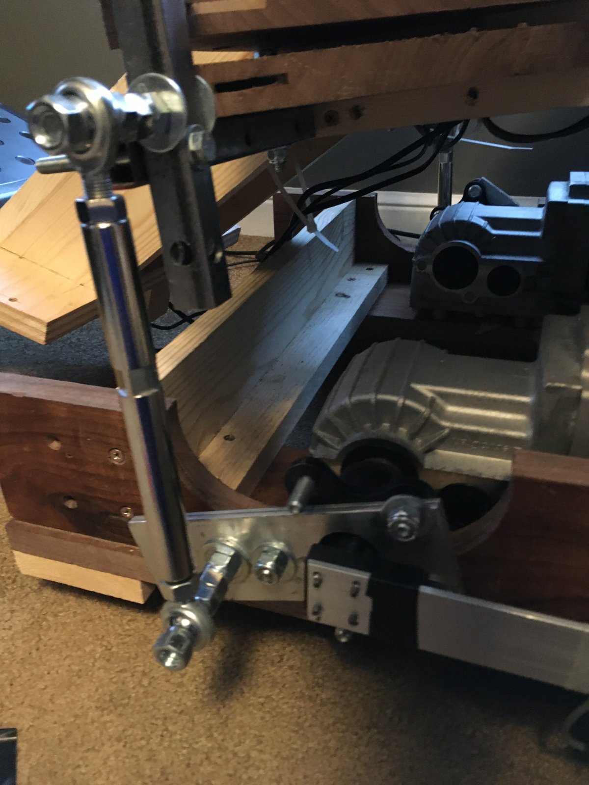

    Final notes for now. I really can’t stand the gearbox play. It makes the the motors quite loud when they are unloaded as they seek position. It also makes a big mechanical racket as the loading hops back and forth. And I can tell it’s robbing me of a lot of fine detail. I can hear the clacking of the free play for a lot of subtle movement that isn’t getting translated to the seat. I’ve got some forward loading from where I’ve placed the pivot but maybe I should try more? I just don’t wanna stress the engines.
    I know @RacingMat said there was a design flaw if you needed em. But I think I want to experiment with some gas springs anyway. I just don’t see what other options I have, short of replacing my drive units. $$$$
    DOF reality seems to have adapted motorcycle steering dampers for their purposes. But I think those might rob details and are expensive to play with.
    My idea is to put two gas struts in the front that will compress when you pitch forward. I’ll slightly bias the weight forward to let gravity help with compressing. Hopefully there will be enough spring strength to more or less always keep the load towards the back. Not sure if I’m making sense, but in my head it could work.
    Anyway, back to building up my anti vomit tolerance!

    Keep in mind the larger the lever CTC distance the more it will exacerbate gearbox play, and strain the motors.
    Also try larger Tuning Center values so that the motion is not so jerky.
    In VR it is more important the motion be fast and precise, rather than laggy large axis movements, so refine you motion profile by initially taming everything down a bit in terms of large axis movement and instead aim at precise movement. You may find it better to first get your VR/motion legs in something other than NL2.

    Thanks! I totally see what you’re saying and could definitely try experimenting with the shorter ctc arm. If it gives me better resolution for the finer moves then maybe it’s worth sacrificing more range. I do see how a little can go a long way with regards to immersion. It’s just that all these videos with gigantic ranges of motion are so enticing!!
    And no! Haven’t done any VR tuning in NL2. Tried it once and no thanks! Girlfriend loved it though so wanna keep a good profile for her.
    I’m gonna experiment with the gas springs for fun. And also gonna play with the ctc arm length some more.
