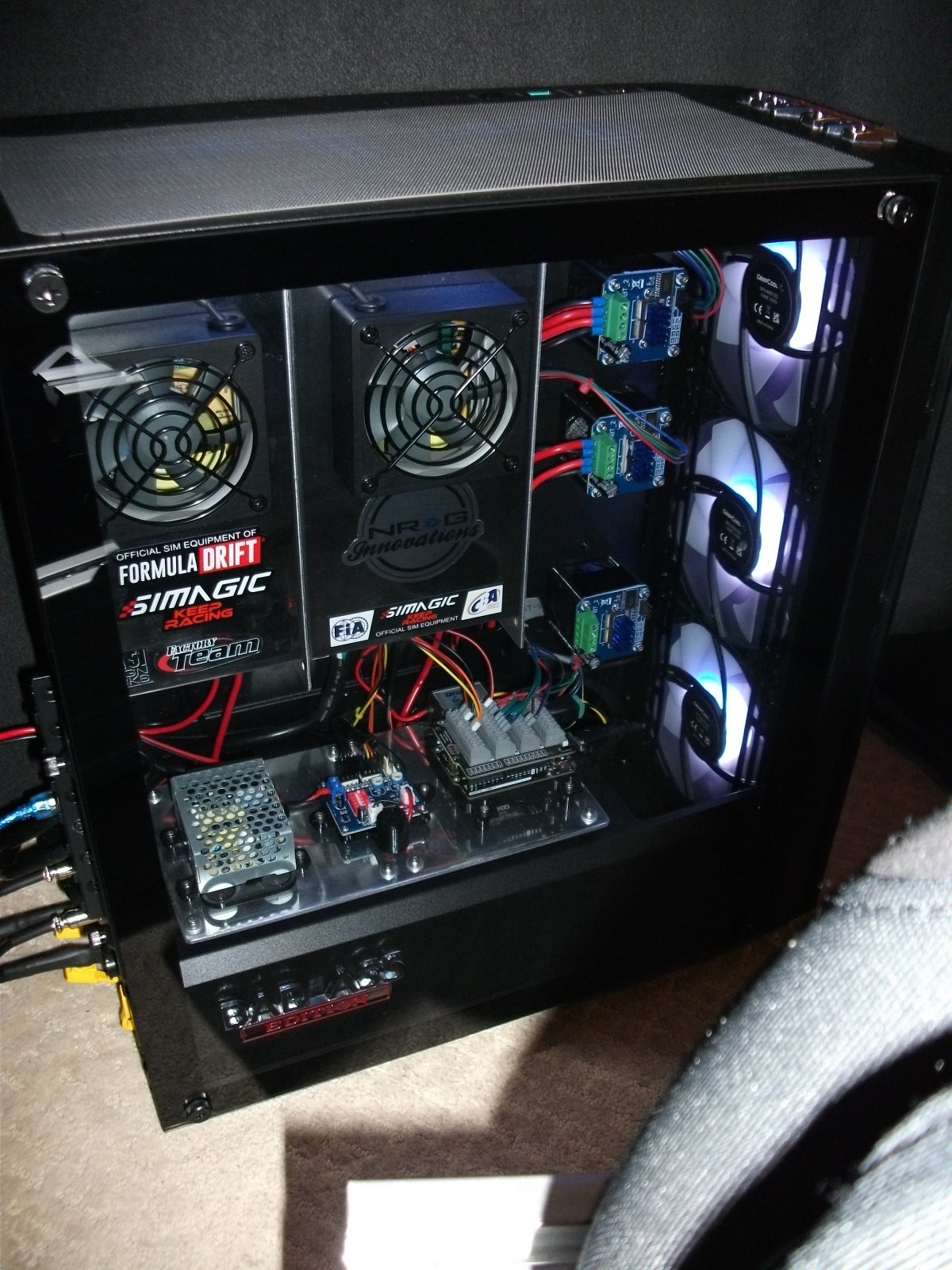

    Mounted to the rear mobo PC case area:
    Dual PSU's
    Triple IBT_2's (one spare or for future use)
    Mounted to a bottom custom aluminum plate:
    5V PSU for the case ARGB lighting
    12v PWM fan Controller
    Arduino Uno R3 + ElectroCookie Shield

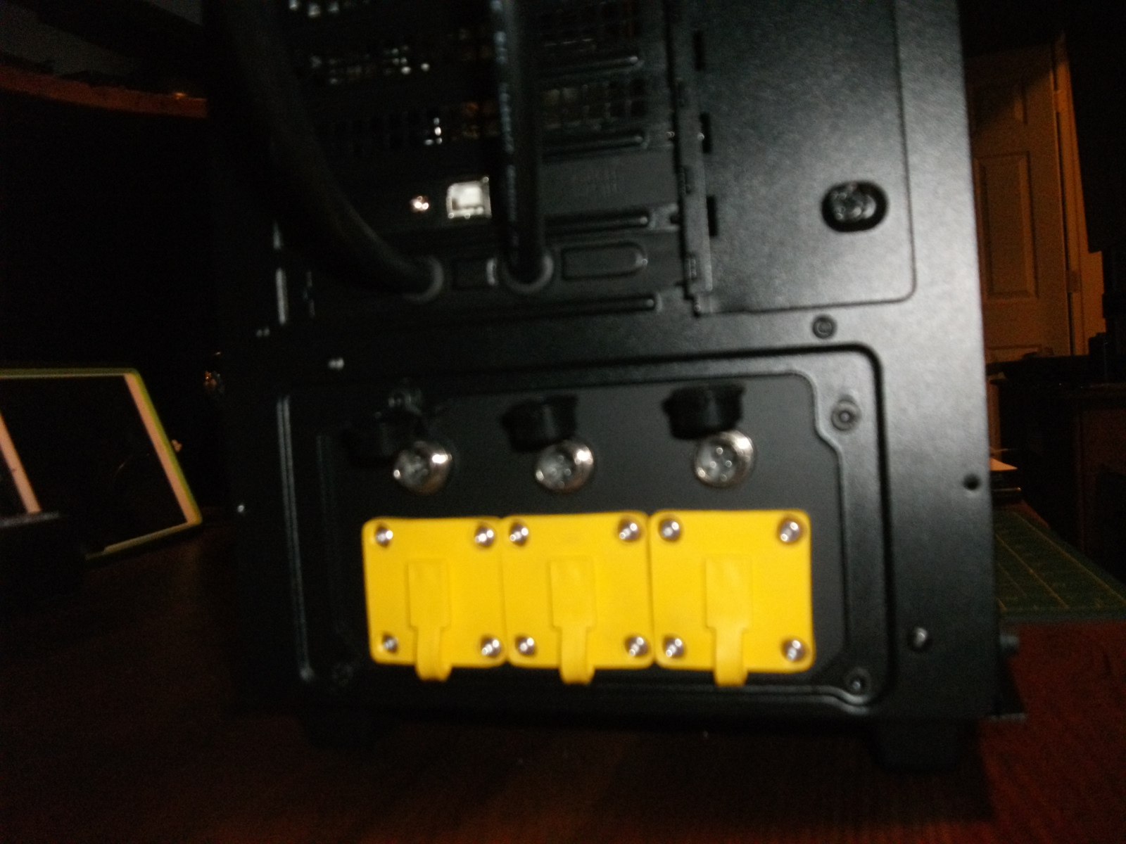

    Rear case PSU mounting area/hole has been filled with a custom cut plate for motor power outlets (XT60) and Hall Effect Sensor outlets (12mm 3 pin Avaiation Connectors).
