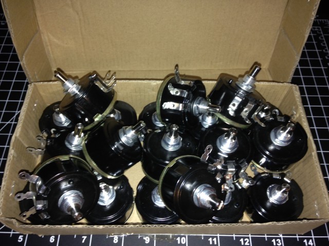

    Gotta love Amazon!!!
    I'd post a link, but for some reason Amazon ones aren't permitted here.
    10k wire-wound pots generally cost anywhere between $5-$15+ each here in Canada, and Hall Effect pots (if you can find them) are way overpriced for some reason.
    I happened upon an Amazon seller who ships free directly from China, $33 CAD for 20 pots, which works out to $1.65 each!
    They arrived in just 3 weeks, well ahead of the scheduled 7 weeks when I first placed the order.
    Since this is classed as a consumable wear item for my particular design, and with the amount which I use my sim I tend to go through them sooner than later, it's best that I have quite a few spares on hand.
    This should last me a while (fingers crossed).

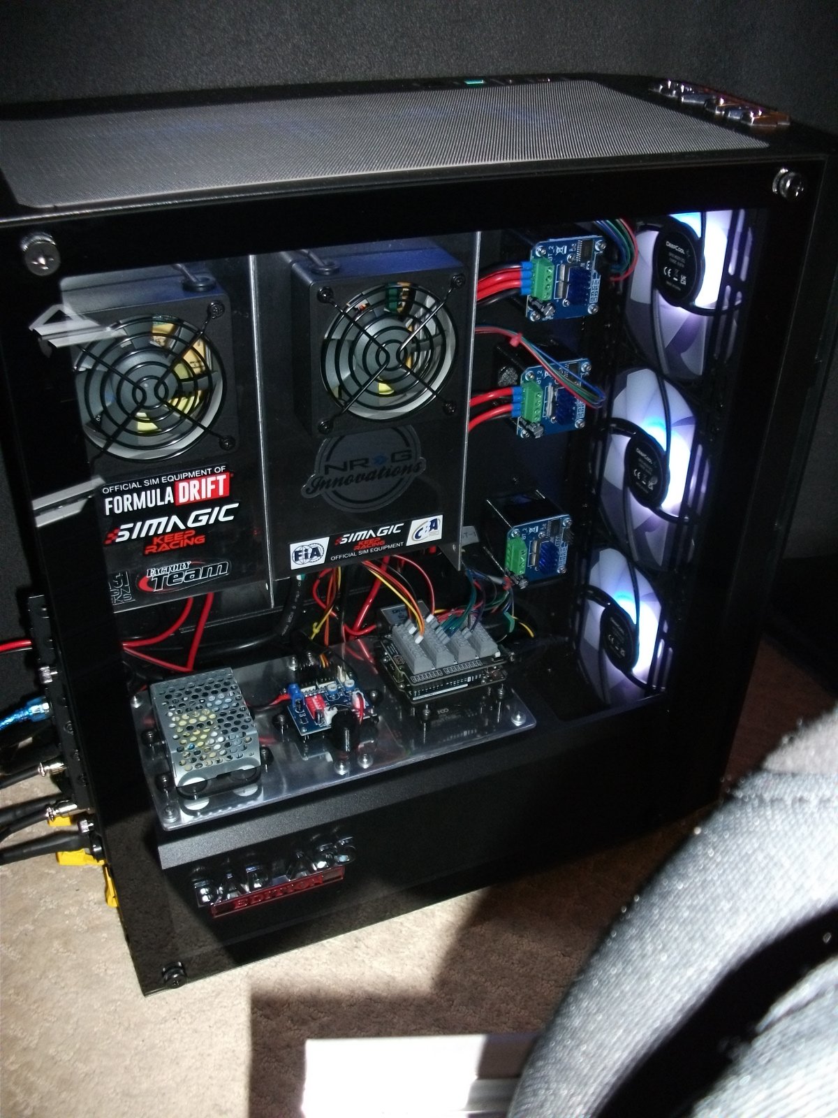

    UPDATES!!!!

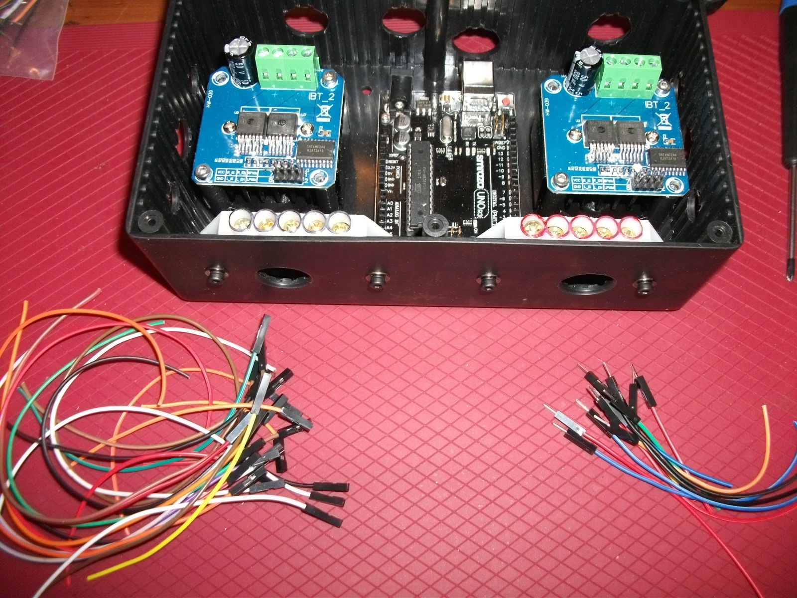

    One of my JRK's died, so screw it...they cost far too much now (if you can even find them)...so on to an Arduino Uno R3 + IBT_2 build/ revision.
    Wish me luck!
  16. Kranky Pantz
    Kranky Pantz Active Member
    Sep 9, 2018
    362
    Canada, Eh!
    1,288Coins
    +296 / 0 / -0
    First draft.....total waste of time...too small to work on...I'm either blessed or cursed with large hands, LOL!!!!
  17. Kranky Pantz
    Sep 9, 2018
    362
    Canada, Eh!
    1,288Coins
    +296 / 0 / -0

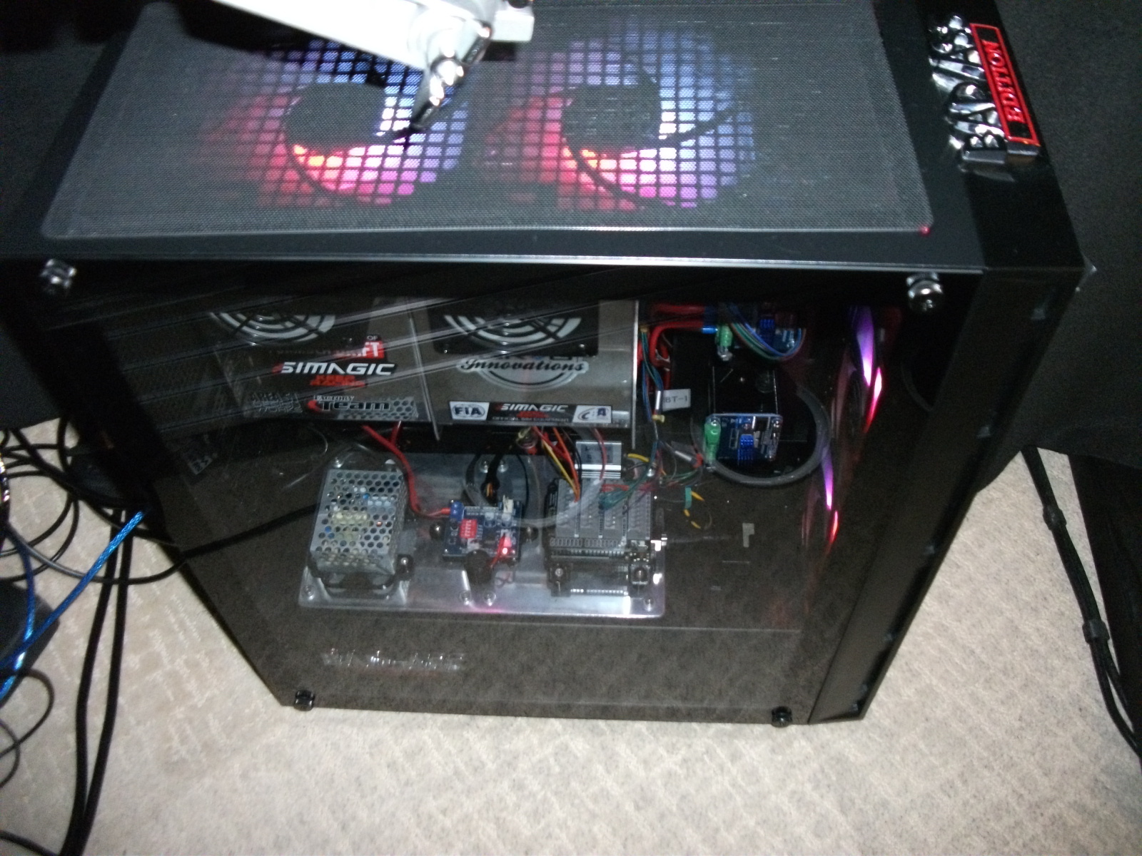

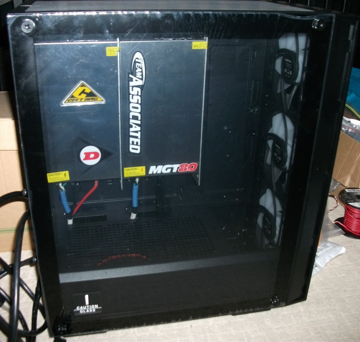

    Second draft....dunno why I'd never thought of this before... why not use an empty PC case as the base for the build?????
    A fair bit of room to mount components and hide wires, right?
    First test fit of PSU's in the case (using a custom cut aluminum plate which mimics an ATX mobo mounting pattern)
  18. Kranky Pantz
    Sep 9, 2018
    362
    Canada, Eh!
    1,288Coins

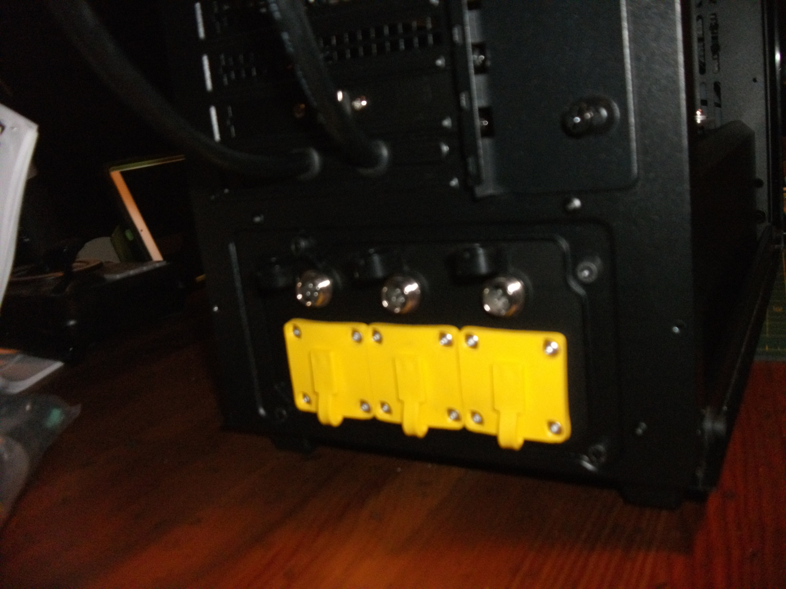

    +296 / 0 / -0
    Rear case panel where a standard PSU would mount, but have instead made a custom aluminum plate with cutouts for 3 XT60 ports for the motor wires and 3 aviation connector ports for the Hall Effect Sensors.
    Only 2 are in in use, with the 3rd being ready for any possible future upgrades.
  19. Kranky Pantz
    Sep 9, 2018
    362
    Canada, Eh!
    1,288Coins
    +296 / 0 / -0
    In the end, this is how it has turned out...and I've named her "Badass Edition".
    You can see that the dual Polulu JRK's have been replaced with an Ardiuno Uno R3 and an ElectroCookie Shield + 2 IBT_2's (plus a spare IBT_2 if needed in the future).
    So far with my testing all is well, aside from a few hiccups such as having to reverse the + & - outputs of the Hall Effects into the Arduino, and one of the motor + & - wires into the second IBT_2.
    Performing like a champ so far!
    :thumbs
    Thanks to all who have contributed to the SMC3 forum posts...you have been absolutes Saints and life savers for getting this up and running!
