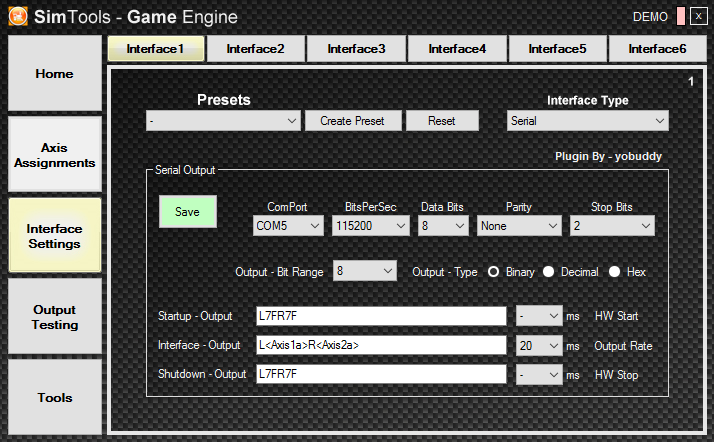

    so far i have downloaded LFS and simtools 2.1
    i am trying to get the Sim to drive manually using the mouse
    my guess is the axis settings are wrong - is there a standard setup for a 2 motor sim using an arduino
    I am using the Simforce GT profile
    am i correct you need only one axis setup Axis(a) ?
    when i click 'Turn on' in output testing the arduino lights up but nothing happens with the motors

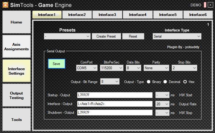

  6. Gadget999
    2,024
    12,341Coins
    +497 / 11 / -0
    these are the settings for the Axis and interface
    do I have the correct settings for the Arduino and the Axis
    22,208
    154,711Coins
    +11,211 / 57 / -2
    As per my earlier advice your Interface Output needs to be like this <Axis1a>and this <Axis2a>

    Thanks again Noorbeast
    so the settings should be
    L7FR7F
    L<Axis1a>R<Axis2a>
    L7FR7F
    i will plug them in tomorrow and give it a go

  10. dr.feelgood
    dr.feelgood Member Gold Contributor
    Apr 17, 2017
    88
    FINLAND
    484Coins
    +44 / 0 / -0
    Hi.
    If it still is not working to you, change values in Interface Settings-screen:
    Stop bits: 1
    BitsPerSec: 500000
    Output - Bit Range: 10
    Output type - Binary
    ...somebody should really update the documentation...
  11. Gadget999
    2,024
    12,341Coins
    +497 / 11 / -0
    so far not getting anywhere :(
    the rig will move when i use SMCutils
    but not with simtools V2.1
    the interface looks like this
    is it correct ?
    perhaps i need to try an older version of simtools ?

    my guess from looking at the Arduino code is the format needs to be like this
    // [Axx],[Bxx],[Cxx] Send position updates for Motor 1,2,3 where xx is the binary position limitted to range 0-1024
    [A<Axis1a>],[B<Axis2a>],[C<Axis3a>]
    the number will be binary 0 - 1023 (10 bit)
    i will try it again tomorrow

    we have motion !
    thanks everyone for the help especially noorbeast - there is a lot of conflicting information and it takes time to realise you are reading the wrong thread !
    hopefully now i will be able to assist someone else in my position to return the favour to the community
    right time to play with the settings and take this sim for a drive :)
