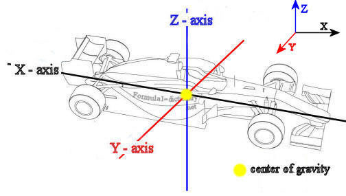

    thanks for those pics, its refreshed my memory
    I need to re-visit the DCS settings again
    - I hope the plug in is good it was faulty last time I tried
    the roll was all wrong for seat rocker type setups
  6. Gadget999
    2,024
    12,341Coins
    +497 / 11 / -0

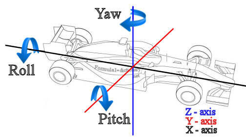

    how do you know which axis is which and does each dof refer to the number of motors you run ?

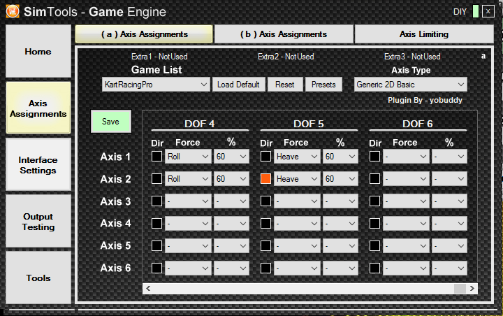

    i have made some more progress with Kart racing Pro
    settings are here
    no yaw yet - not sure i need it

    i have had the sim in motion with Kart Racing Pro, but not yet had the steering wheel and pedals inside the sim
    i will knock everything back to approx 15% and take it from there :)

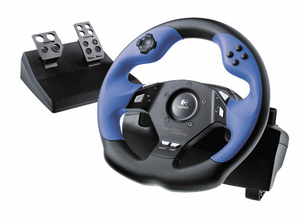

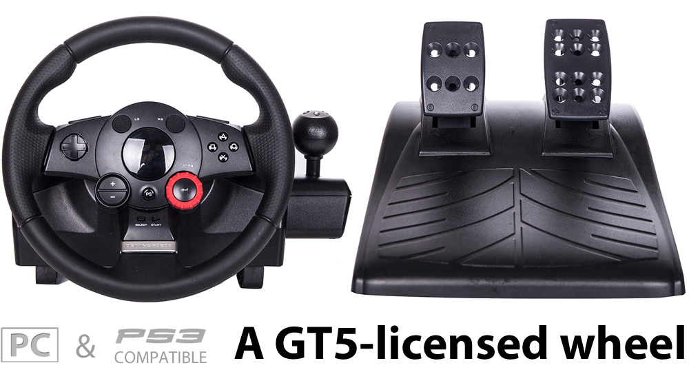

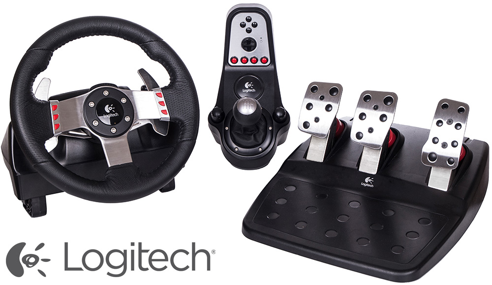

    i posted regarding FFB wheels in the wheels section buy got no reply
    i have a couple of wheels i have built up over the last year or so - i have had them working with the ps4 with something called a gimx converter which converts the output so it is compatible with a PS4 device
    logitech Driving Force x 2 -- a ps2 / pc wheel -- [​IMG]
    logitech Driving force GT x 2 -- a ps3 / pc wheel -- [​IMG]
    a logitech G25 wheel -- ps3 / pc -- [​IMG]
    i am guessing the G25 is the best wheel
    i would like to modify the wheel by fitting a real racing wheel and maybe adjust the power of the ffb
    does anyone have any suggestions ?
    is it worth me leaving the wheel(s) alone and building a new one ?
    should i buy something that is already built ?
    how does the fanatec compare ?

    a bit more progress on the sim
    i have decided to use the G25 wheel with a genuine racing wheel fitted to it
    today i have hacked out the area where the steering wheel will go and have done a quick test with rfactor and a force gt wheel
    video is below - was all going well till the passenger tried to get out !
    the sim settings are approx 15%
    do the forces look to be in the correct direction ?
    ie turn left - sim tips left?
    brake - sim tips back?
  15. SeatTime
    2,572
    +2,854 / 40 / -0
    Nice - I like the shell :D. In a 2DOF for the most part when you turn left the sim will actually roll to the right to simulate the force of sway (as you don't have a real sway) and you being pushed to the outside of the car. Same when you brake, the sim will pitch forward to simulate the force of surge moving you forward, as you don't have a real surge in a 2DOF. If although you want some real roll and pitch data as well, it all becomes a bit of a balancing act with a 2Dof, as they will fight against the applied surge and sway forces ;). Easier to just do each force in isolation and go from there. FAQ is your friend.

    From my experience they are a big part of the 'driving' experience so, buy the best your budget can afford either new/second hand. Fitting a bigger wheel to a g25/27 can upset the power balance, as the motors are not that big, so maybe not a good idea. Unfortunately they will all look/feel like toys when you move to a Direct Drive servo wheel :rolleyes:- so never try one :p. As for modifying, or building your own - there is nothing better then building stuff. Although no guarantees it will be any better than a purchased one.

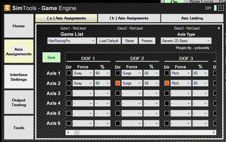

    I did some good testing on the sim today
    i stripped the axes back to only sway and surge
    both are set at 40%
    the problem i was having is one motor would stop working and a reboot would fix it
    by tuning the PID i got it under control
    P=40
    I=1
    D=0
    S=1
    (i might have a go at adding heave next to see what happens)
