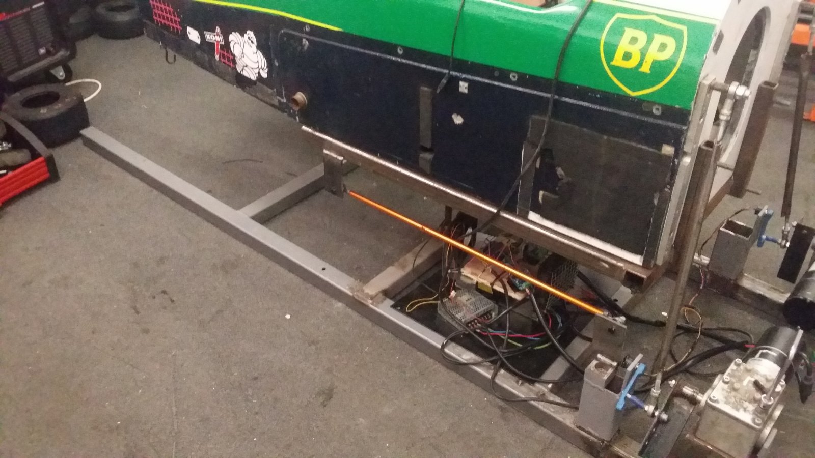

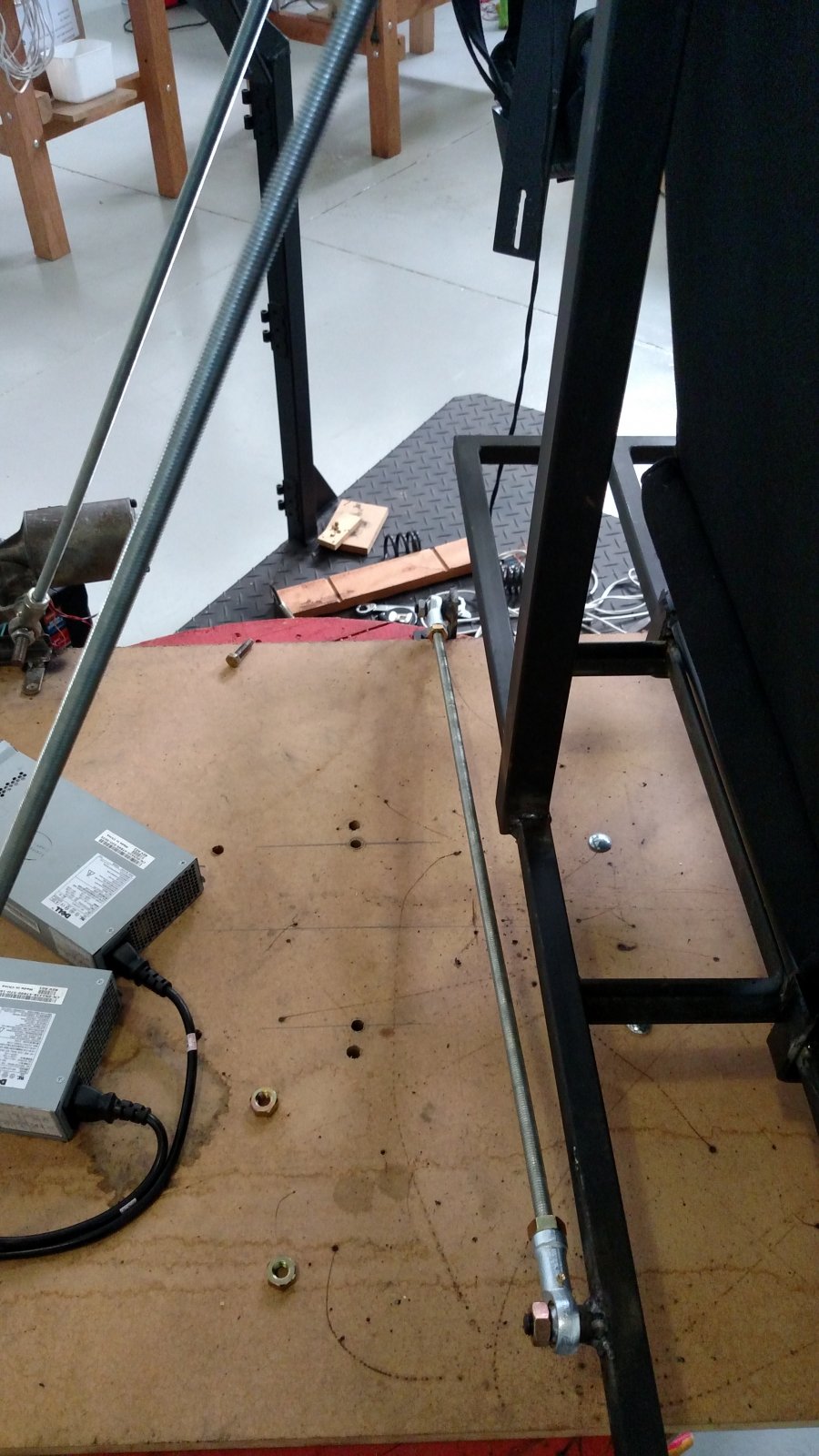

    i have a bit of twist in the front of the sim when loaded up with a heavy person
    the UV joint is from steering column and is probably not strong enough
    I can either source a UV from a prop shaft, or fit a panhard bar
    do i need 2 bars on each side or one bar on the rear ?
    does anyone have any examples i can look at
    22,208
    154,711Coins
    +11,210 / 57 / -2
    A single bar diagonally from the base frame to the seat frame will do the job.

    thanks @noorbeast - that looks simple enough :)
    will the pan hard bar not cause it to twist right when the nose dips and twist left when it rises ?
    do i need the angle between the left and right ends to be as shallow as possible
    I will get something knocked up asap and try it out

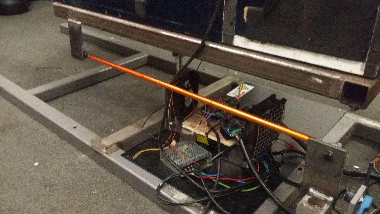

    Some pics of the panhard bar as requested
    It needs to be flat and level with the pivot axis
    It seems to have done the trick

    @Gadget999 - looks like you answered your question about Panhard bars actually introducing some twist in the rig while they lock out much more twist. Yup! I had to add them too with a steering U-joint where the mounting didn’t have quite enough resistance to the sim twisting.
    Very nice looking rig!
