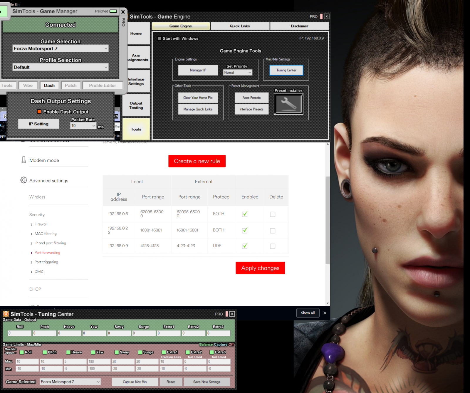

    I've managed to make some limited progress as now the plug-in is working but only for the first third of the lap, does that mean I have to do more data collection unpatched?
    I've included a screenshot of my settings and in game I have selected port 4123 and data packet format DASH.

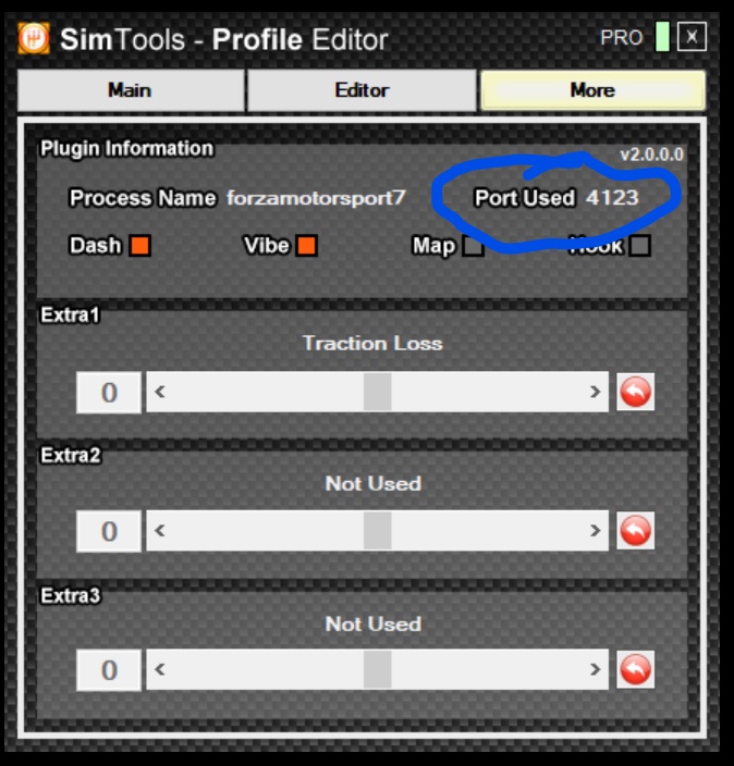

    Like @Drippz101 (see his comment above) my Simtools profile manager gives 4123 as the used port (see image below). If yours uses the same port (4123) but you need to configure 4122 then I will go back to the recommended port 4122 Forza MS 7 profile editor port_LI.jpg and see if I can get that working but until then 4123 has limited functionality for me some reason (at least I got movement on the first third of the lap, which I hadn't seen any movement on 4122 port)?
    Also if you could provide a screenshot of how you have configured your router port forwarding that would be much appreciated?

    @value1 can you confirm as per the image above that the Simtools profile editor port used which in my case is 4123 should be the same as the as the in game HUD "Data Out IP PORT" which you stated should be 4122?
    So in your case your Sim tools profile editor for FMS7 would in fact read 4122 if you took a screenshot like I did above?
  13. value1
    Jan 9, 2011
    2,192
    Zug, Switzerland
    14,299Coins
    +3,363 / 13 / -1
    In Forza you need to specify port 4122. 4123 is only the internal port, SimTool uses; no needs to worry about.

    okay I've changed it to 4122 and for the first time in a dozen tries it works only for the first part of the first lap which is the same as with 4123, why does the motion stop working after a while on the first lap on this plug-in only, I have no such issues with other plug-ins?
