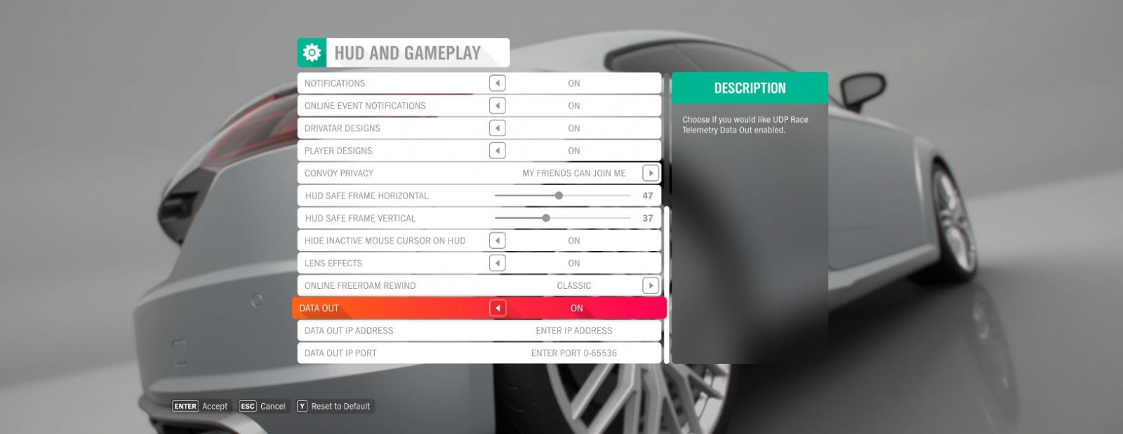

    Now Forza Horizon 4 data output is available, could anyone test it ?
    I have no rig here to test it but I believe it will be the same data.
    In the end, it seems both games share the same game engine. We can guess so looking the last video they did with shared content between F7 and FH4.
    If it is the case, maybe you could update the plugin page to mention that both games are supported with this plugin.

    #Add.
    Basically, FH4 also have a same issue like FM7 that localhost doesn't working and should follow setup guide about port forwarding first.

    I'm a bit late to the party. Strangely, I couldn't seem to find any news on the new 'data out' feature that has been added to Forza Horizon 4, but when I checked in game, it is indeed there. How are you guys getting it to work with simtools? Assuming you are just using the FM7 plugin? I just wondered because the process name is different.
    If anyone needs it, the process name is; ForzaHorizon4.exe
