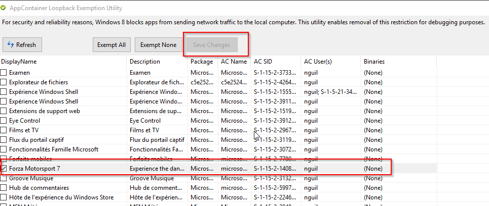

    I was reading on some forum that you can enable loopback for forza 7 like this.
    1) Make sure that Forza 7 is not running
    2) Make sure that you are logged on as an admin.
    3) Open a command prompt run the following command.
    CheckNetIsolation.exe LoopbackExempt -a -n=microsoft.apollobasegame_8wekyb3d8bbwe
    You should see the word ‘Ok’ appear, this indicates the exemption was added successfully.
    Now Loopback for Forza 7 should now work just like any other game.
    Anyone with the game want to give it a shot?
    Take care,
  11. value1
    Jan 9, 2011
    2,192
    Zug, Switzerland
    14,298Coins
    +3,363 / 13 / -1
    Yep, works perfect! Nice and easy setup this way! No need to fiddle with the router and all that crap.
    Thank you for the tip, @yobuddy hug:

    Hello, I apologize in advance for the noob question. I own a DOFP3 system and recently purchased Forza 7. I downloaded sim racing studio and then the loopback utility. I checked the Forza 7 and Forza 7 Hoonigan pack then saved. I can enter into the Sim Racing Studio and under motion it shows "Connected - Not Licensed". I made sure to add Forza in the drop down for game. I then went to motion test which all seems to work when I move the bars.
    After the above, I went into Forza 7, HUB, and then scrolled to the bottom to turn on Telemetry (or Data Out). I put 127.0.0.1 for the IP data out, 10001 for the data out ip port , and I tried both Sled and car dash.
    I can hear the servos however I get no movement while playing. Am I missing something here? Sim Racing Studio replaces Sim Tools for Forza 7 right?
    Thanks in advance for the assistance.

  18. Charlier12
    Charlier12 New Member
    May 11, 2019
    97Coins
    Im sorry Yobuddy, I tried this as well and think I am missing something. I never had to add a plugin so I am not sure how they even work. I logged into the CMD as administrator, added your text and received the "OK". Not sure what I am suppose to do after this. I am sorry for being this far out of whack from everyone else.
  19. noorbeast
    22,211
    154,729Coins
    +11,213 / 57 / -2
    Close SimTools and via the Windows Menu go to the SimTools entry and open the PluginUpdater app. Drag the plugin zip file on to the PluginUpdater app and it will install the plugin.
    You can get the SimTools manual here: https://www.xsimulator.net/community/threads/official-simtools-user-manual.12424/
  20. Charlier12
    May 11, 2019
    97Coins
    Thank you. I did this, plugin patched successfully. I can now see it in the simtool game manager and game engine. I picked Forza 7 and hit patch. Said it was connected but still no motion. I played with the setting in the HUD many times and nothing took. I feel like I am so close now. Do I need to run loopback or is there a process I need to follow? Also I am offline, not sure if that has anything to do with it.
