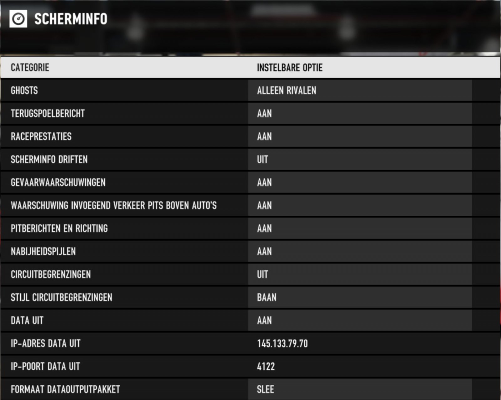

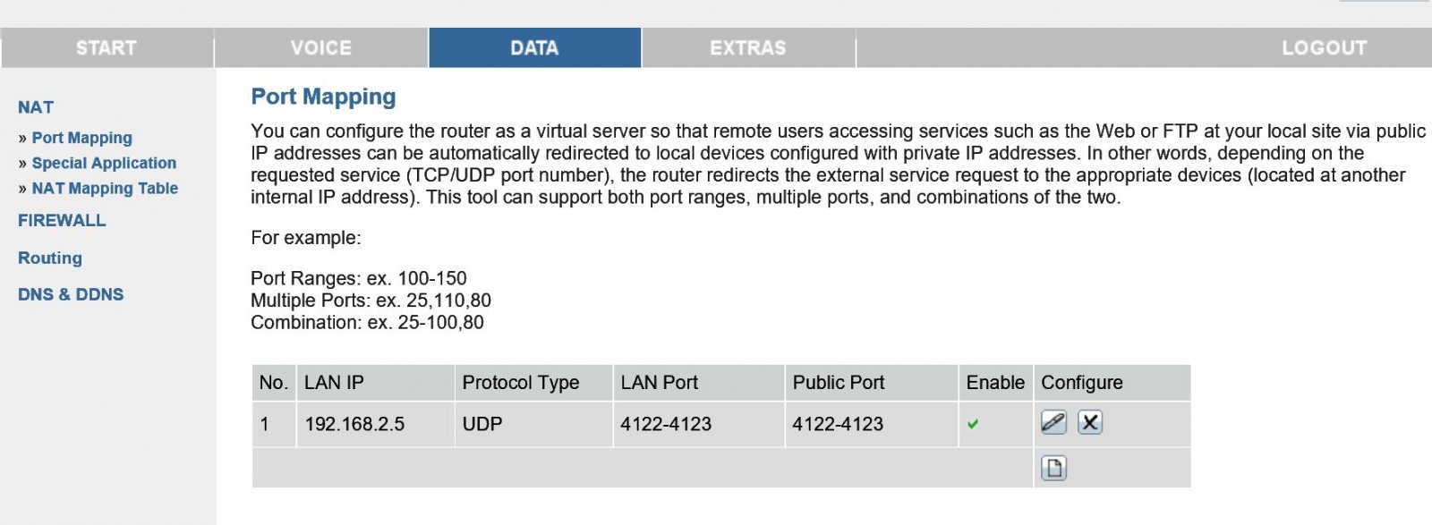

    Tuning center does not show any data.
    Other games are working fine.
    Maybe it's my modem configuration, is port mapping the same as port forwarding?

    When you apply the trick that @yobuddy mentions in the link above, there will be no need for port forwarding or mapping!

    Re-installed the plugin, it's working now!! :)
