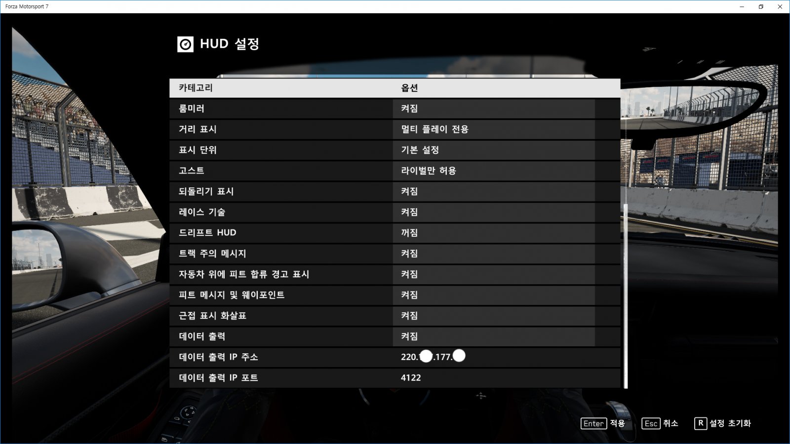

    @value1
    HUD Set
    IP : Real IP
    Port : 4122
    Router Port Forwarding Set
    IP : PC IP
    Port : Out 4122 / In 4123
    1PC Works well!!!
    GoodJOB!!!

    @value1
    Game Dash & Game Vibe Check. All OK.
    All seem to work normally. I will continue to test and let you know if something goes wrong.

    Thank you both! This does the trick! I knew there are clever guys out there that can help :thumbs
    I didn't think of using the WAN address in the router. Good stuff!
    I'll publish the plugin in the official plugin subforum.
