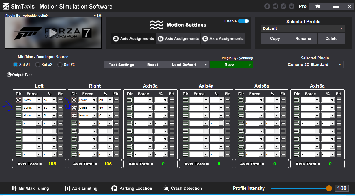

    Now is moving, thank God, but got a problem, axis are inverted, when I accelerate it moves forward and viceversa, know how to change in game engine?
  3. p00ky
    p00ky Active Member
    May 4, 2020
    117
    Self Employed Laser Cutter
    Wales
    392Coins
    +66 / 2 / -0
    You have to change your axis settings in Simtools, there's no way of doing that in game. Just invert the ones that need it, click save and you should be good.

  4. izhangt
    izhangt Member Gold Contributor
    Jan 6, 2021
    32
    - 91Coins
    2DOF, Motion platform
    u know where can i make the axis inverted for aceleration /brake?
    22,185
    154,750Coins
    +11,196 / 57 / -2
    The Dir box in Axis Assignments being checked orange or not determines which way each axis moves, it sounds like whatever you have set for surge is reversed to what it should be.

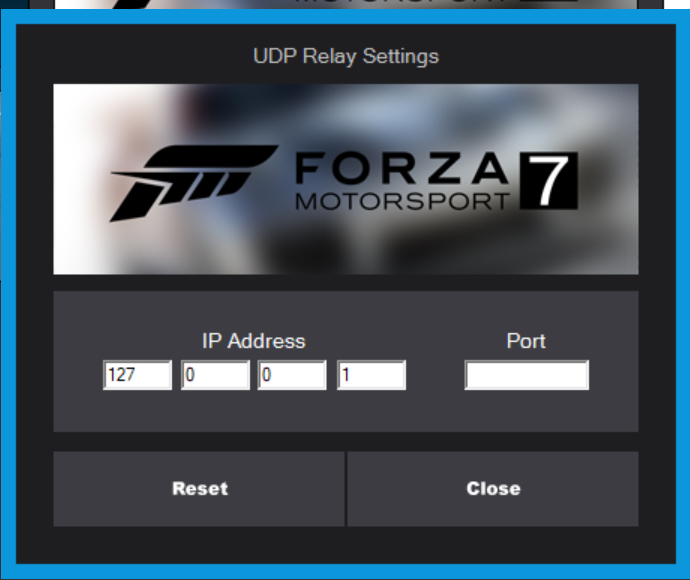

  7. p00ky
    p00ky Active Member
    May 4, 2020
    117
    Wales
    392Coins
    +66 / 2 / -0
    I got that when I first tried it but it was because I had entered a port number into simtools..... dont.
    it should look like this.....
    Only put ip and port number into the game, not into simtools. Hopefully that helps.
