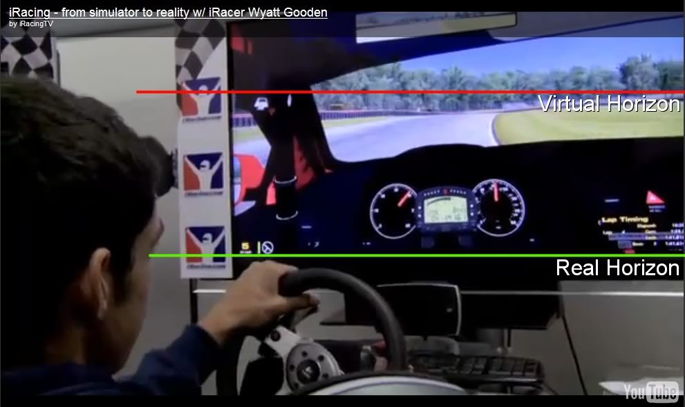

    2. Height of the sight
    Right focus of our sight has to be in straight line to the “road”. You achieve this when your eyes are at the 60% of the height of the screen. There is no need to change the focus or other inconveniences physical issues.
    Wrong
    Right

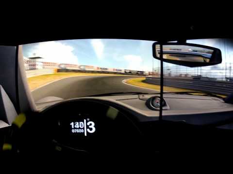

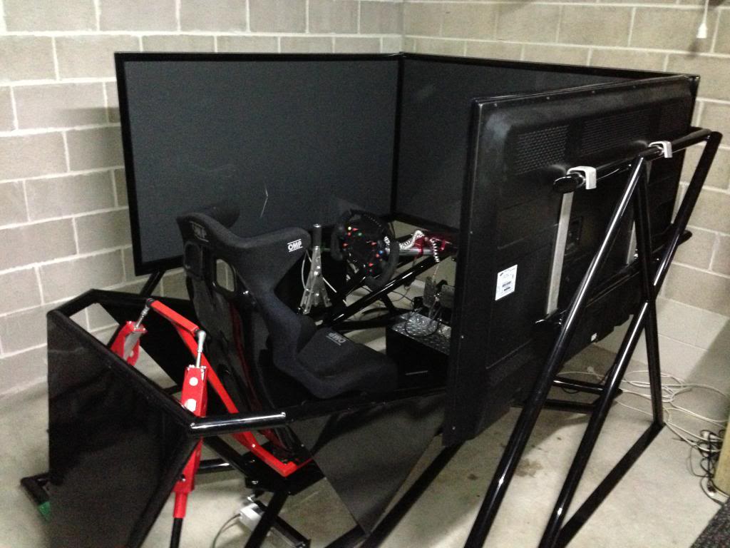

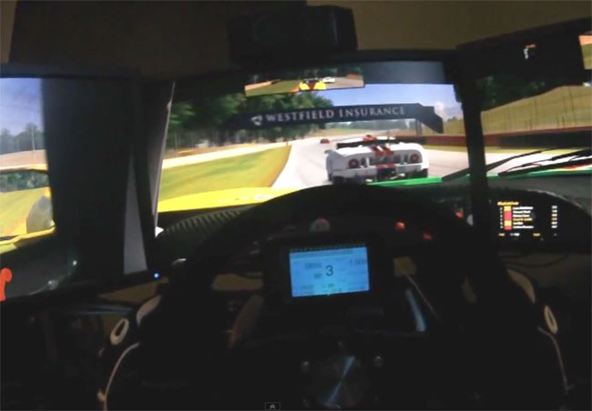

    6-Covering
    Even with only one screen is advisable to get a cover. Its function is avoid every kind of distractions for our sight. Speed feeling is also better.
    Wrong
    Right

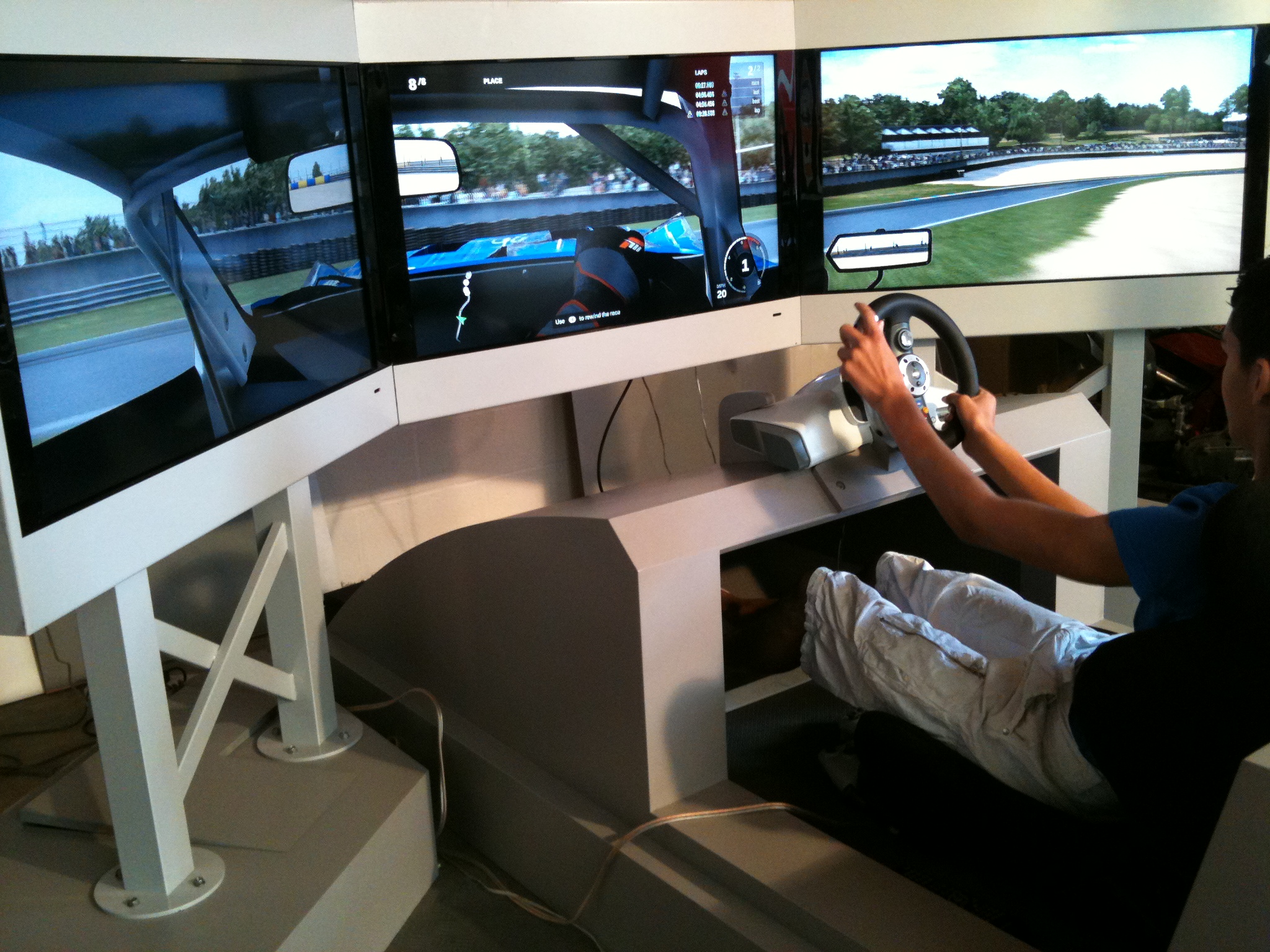

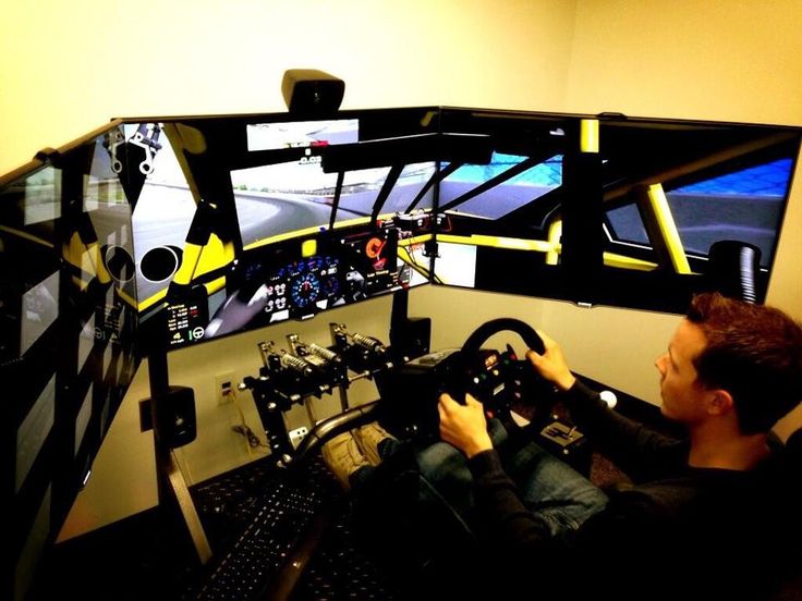

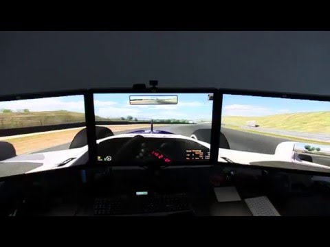

    7- Triple screens
    Frames are important value to consider when you are setting a triple screen configuration. Try to get something with less than 10mm. To reduce this black strip you can overshape frames of the monitors.
    To calculate angles of the triple screen there are different tools which with a few value inputs can show your ideal FOV, angle and distance to get the ideal configuration.
    Lateral screens Angle
    Link Calculator
    http://www.totalspanishsimulator.com/manuales/varios/CALCULADORA FOV 3 PANT.xls
    Wrong
    Wrong
    Right

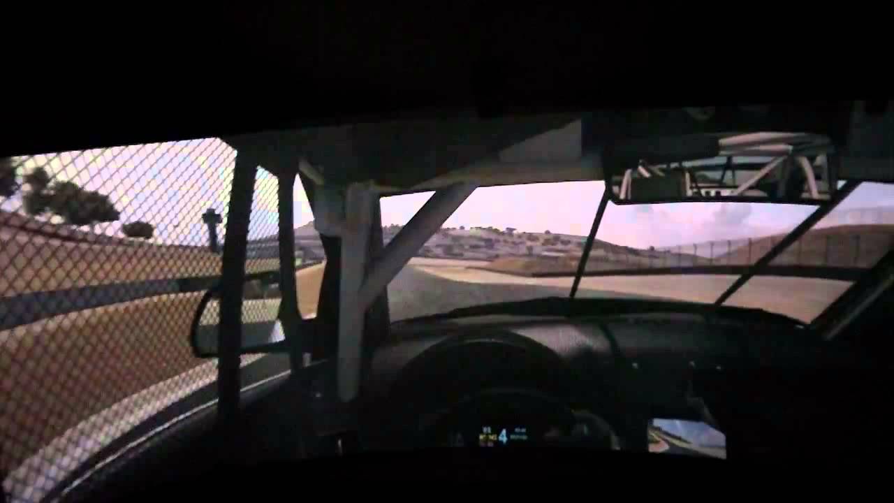

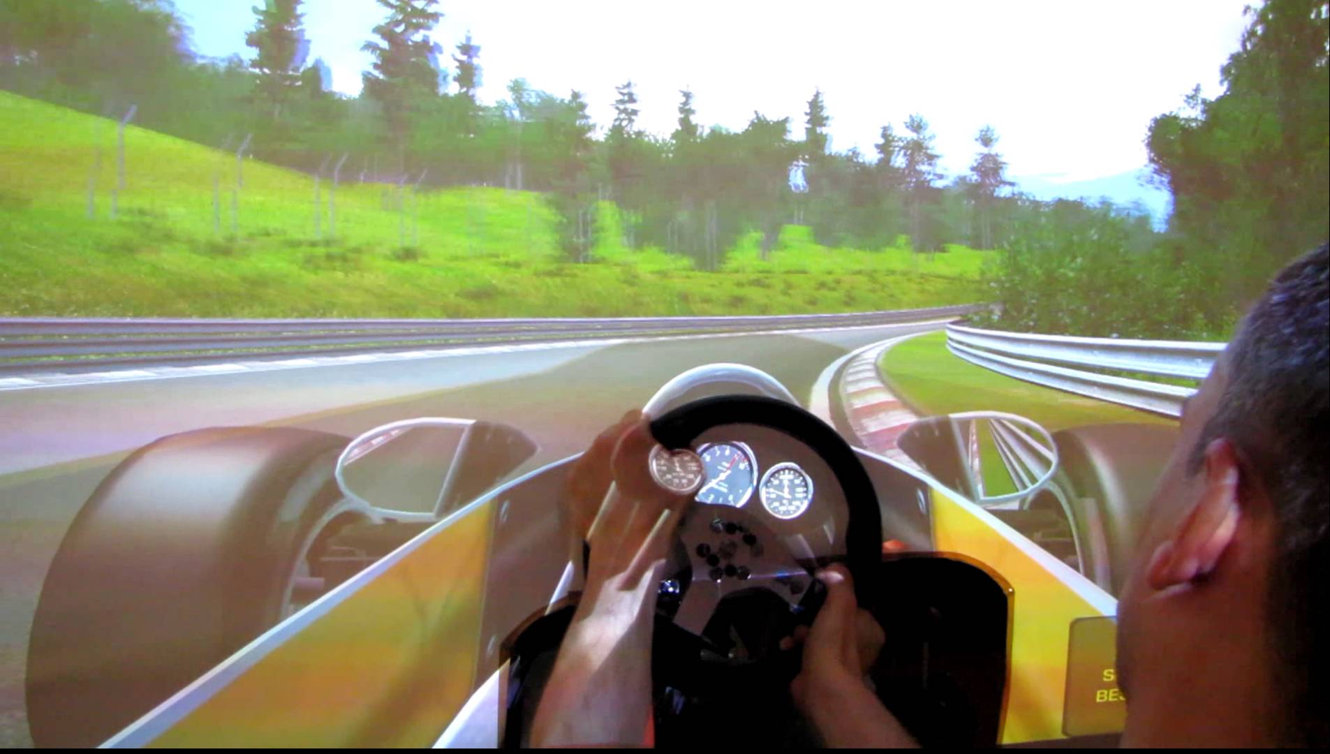

    8-SUPER FOV
    Big screens with projectors which wheel is very close to the main screen.
    A big single screen has the problem due to the distance of our sight to distant points of the sides.

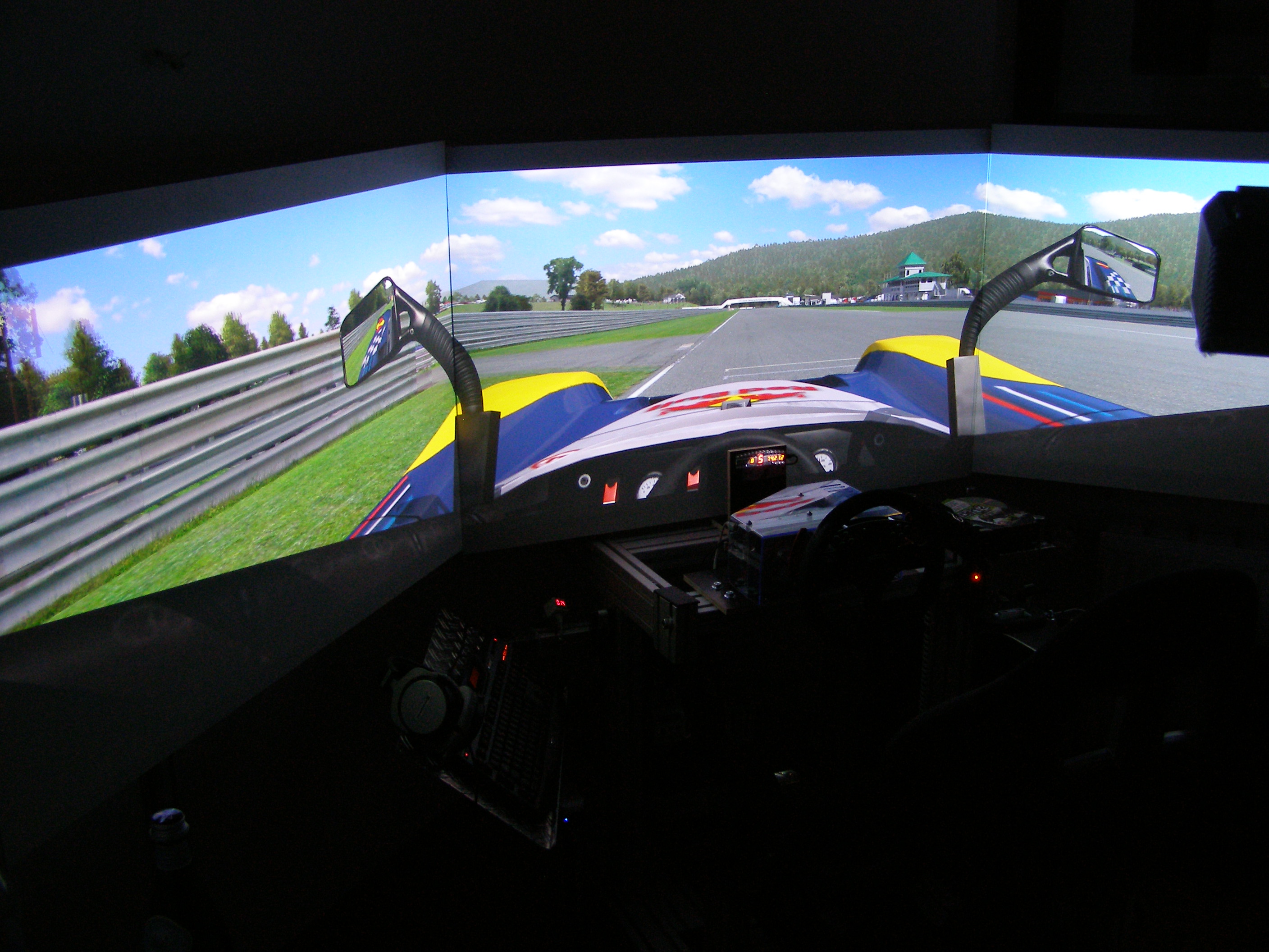

    Three panels or curved panels don’t seem to have same problem if you use a software to correct the FOV.
    3 panels
    Curve Panels
    http://www.youtube.com/watch?v=25KB1OJoYeA[/youtube]

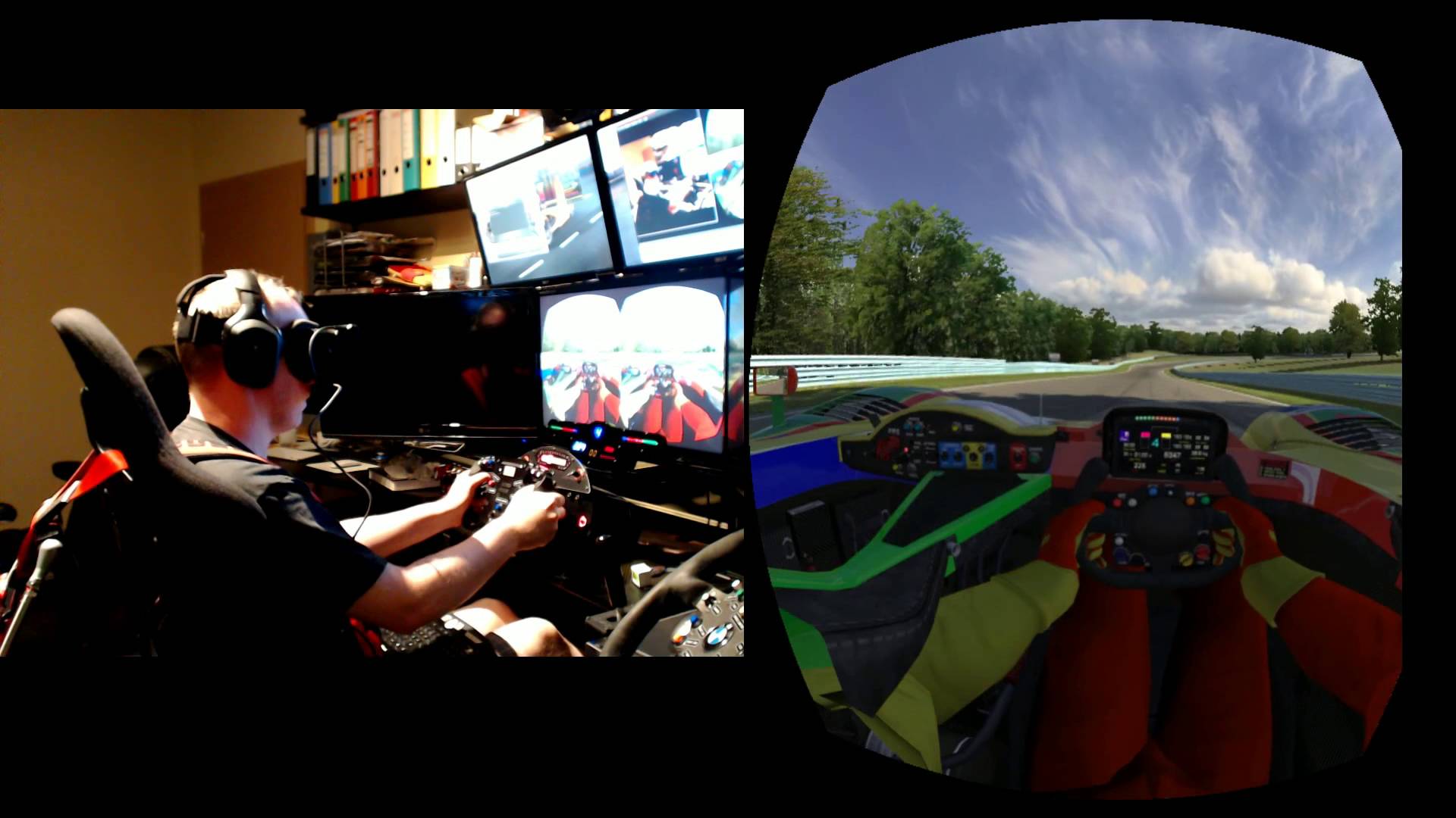

    9-Virtual reality
    Seems the next big thing. It promises a total immersion getting you into the game. Speed feeling and head tracking incorporated. In the con side, still in development, lost the physical limbs and fingers, not a human real FOV yet, not a big resolution yet, feeling sickness, etc.
    We will hope the next CV1 will solve some of these issues.

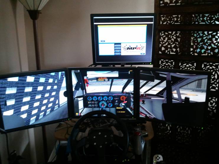

    6 monitors:
  20. djboss001
    djboss001 Member
    May 25, 2014
    47
    Test engineer
    - 34Coins
    +17 / 0 / -0
    Excellent immersion but WAF = 0 :confused:
