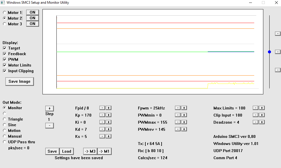

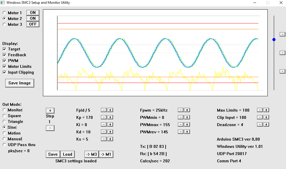

    Hi, I'm still having some noise problems. I already installed shielded cable to the hall effect potentiometers with the shield connected to the ground but look at the yellow signal:
    It is worse in the motor 3 (Motor 2 in SMC, front left motor in the rig), you can see when I change from the motor 2 to 3 (1 and 2 in SMC respectively) the motor 3 always have a little bit of signal trying to correct that little movement it left to be done to center the motor and it makes a lot of audible noise (sounds like scratches inside the motors) and also that continuous signa get hot the motor. Increasing the Kp makes the motor move that little to fix the issue when the motor stills BUT when the movements starts (whatever moves, SMC sine, FlyPT, etc) the yellow signal get worse and worse increasing Kp.
    The motors runs up and down but because of the noisy signal the movements have a little bounces/stutters. I think the only thing I need to be at 100% is filter that noise and it will runs perfect.
    What do you thnik I can do? Thanks!

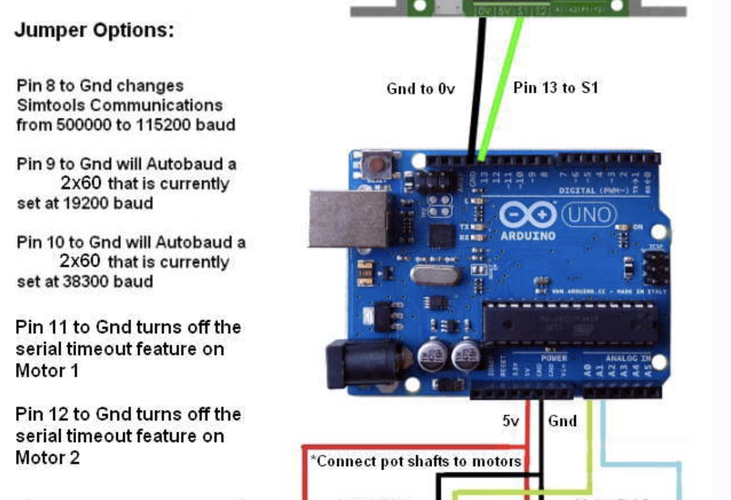

    Well, after 5 months testing and making changes I finally found what was causing the problem. The solution was always in front of my eyes and well documented in the SPS thread but......I didn't understood it at all, shame on me.
    I noticed that if the commands were coming from the PC the rig jitter and the motors got very hot BUT when I move the hall sensor manually the motors ran smooth so I deduced the problem were with the PC-Arduino communications. After lot of work with cable management and shielding all the wires nothing works until I read that thread of the gods that shows me the way:
    The last post of this thread (https://www.xsimulator.net/communit...ering-issues-rendering-my-sim-unusable.17048/) was the key to discover how to make the rig working well.
    What I was doing was put the jumper from the 8 pin to GND and then release it BUT the way is put the jumper and don't remove it!!
    Now the motors run cold for a long time and the movements are MUCH better so....time to configure and make tests with Simtools/FlyPT.
    Thanks @noorbeast for the patience and help to you too!
    I'll update how it works!!

    Can you show a picture of how you did it ?

    Hey Attyla, do you need a pic of the jumper? Its only a dupont wire from the pin 8 of the Arduino to the GND pin. It is mandatory only if you are using the SPS code. This afternoon I will post a picture
