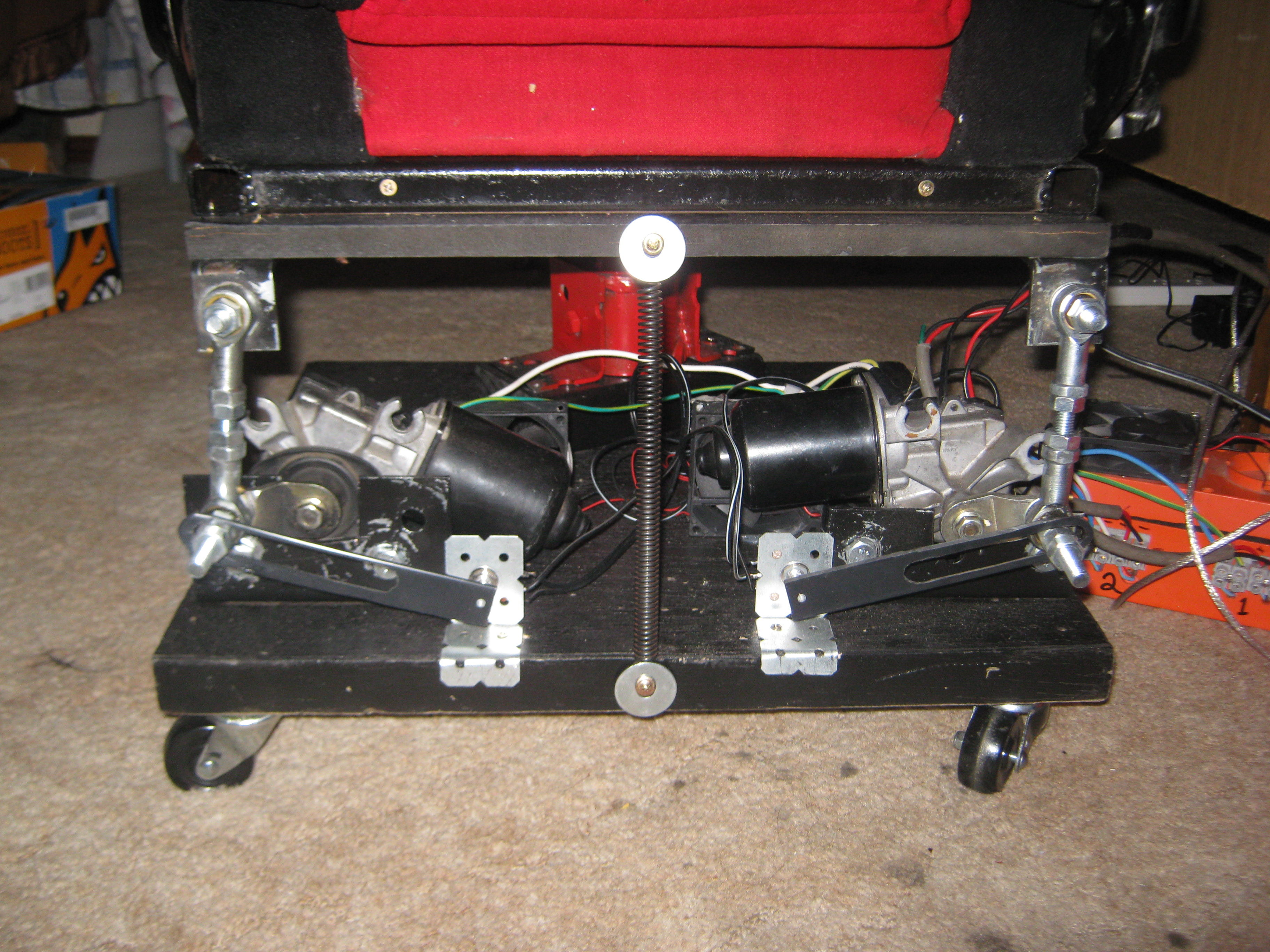

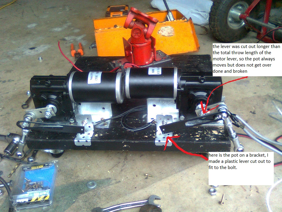

    I used a single turn pot with a plastic lever glued to the end of the pot shaft, then as you can see in the pic, the cut out on the plastic lever was made long enough so even if the motor lever went right over, the pot didnt break. This is good , but only gives about 90 deg of a 270 deg single turn pot. I did the same for wiper motors when I started with them 714630615_IMG_0914_122_572lo.JPG

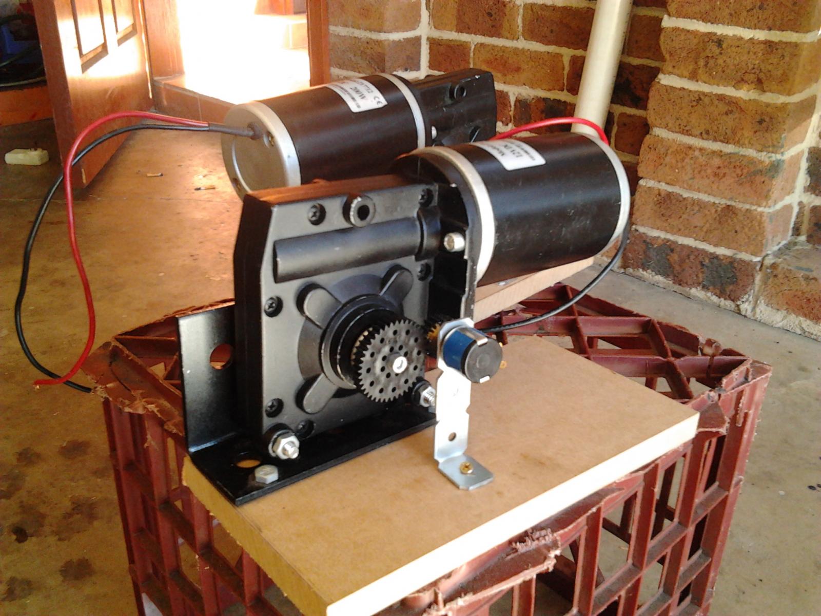

    I also use a 3 turn pot, (in this case because of gear ratio), For feedback I used a gear set from an electronics shop, I tapped a thread into the back of the motor shaft and used a smaller gear on a 3 turn pot. I use about 1.8 turns of a 3 turn pot.
    This gives a finer resolution on the motion.

    On pot location, direct is good but if you don't get the centers just right the pot wears out very quickly and if they overshoot they instantly break the pot. I prefer and only my opinion I would use a multi turn pot and have it run by simple cheap rc gears so any misalignment can be taken up as well i use a 5 turn pot but only use about 80% of the turn in the movement so that if an overshoot does happen and can happen, the pot doesnt break.
    Another way is the simple slide lever that bfst has shown, works well if the motor goes out of control, it doesn't break the pot , only bad bit is it only uses about 60 deg of the pot.
