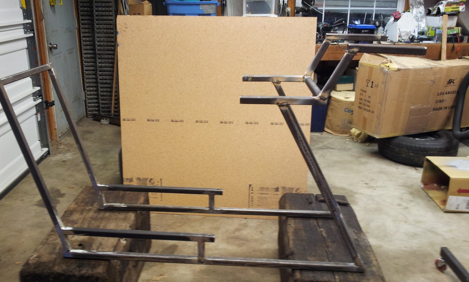

    I notice you have the wiper motors mounted in different positions? is this recommended?
  6. bsft
    @Tech2123 , racingmat has only built ONE sim, if you have a design in mind, start a new thread and we can chat about it there.
    There are some of us whom have been through 10 or more builds getting motor position sorted.

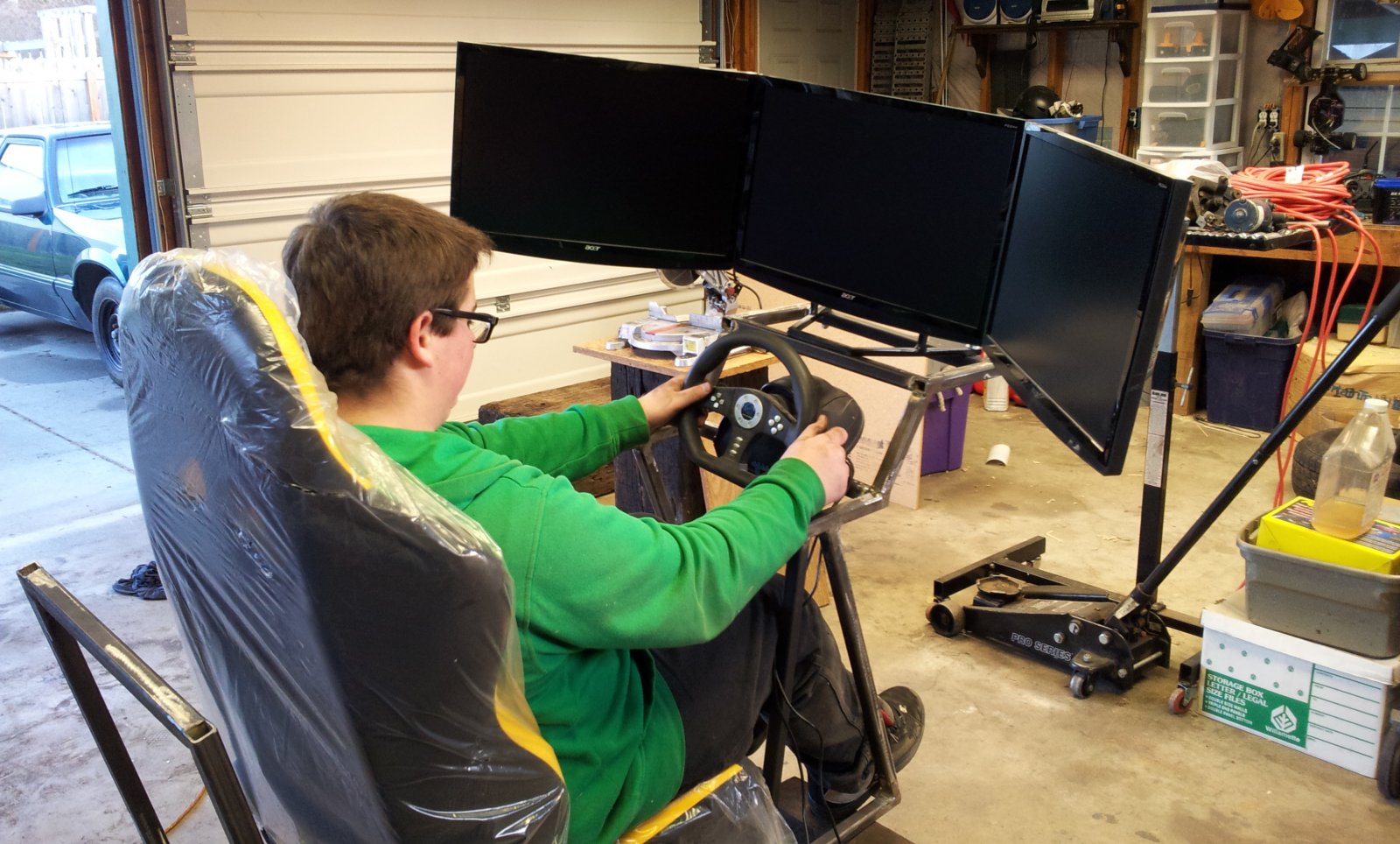

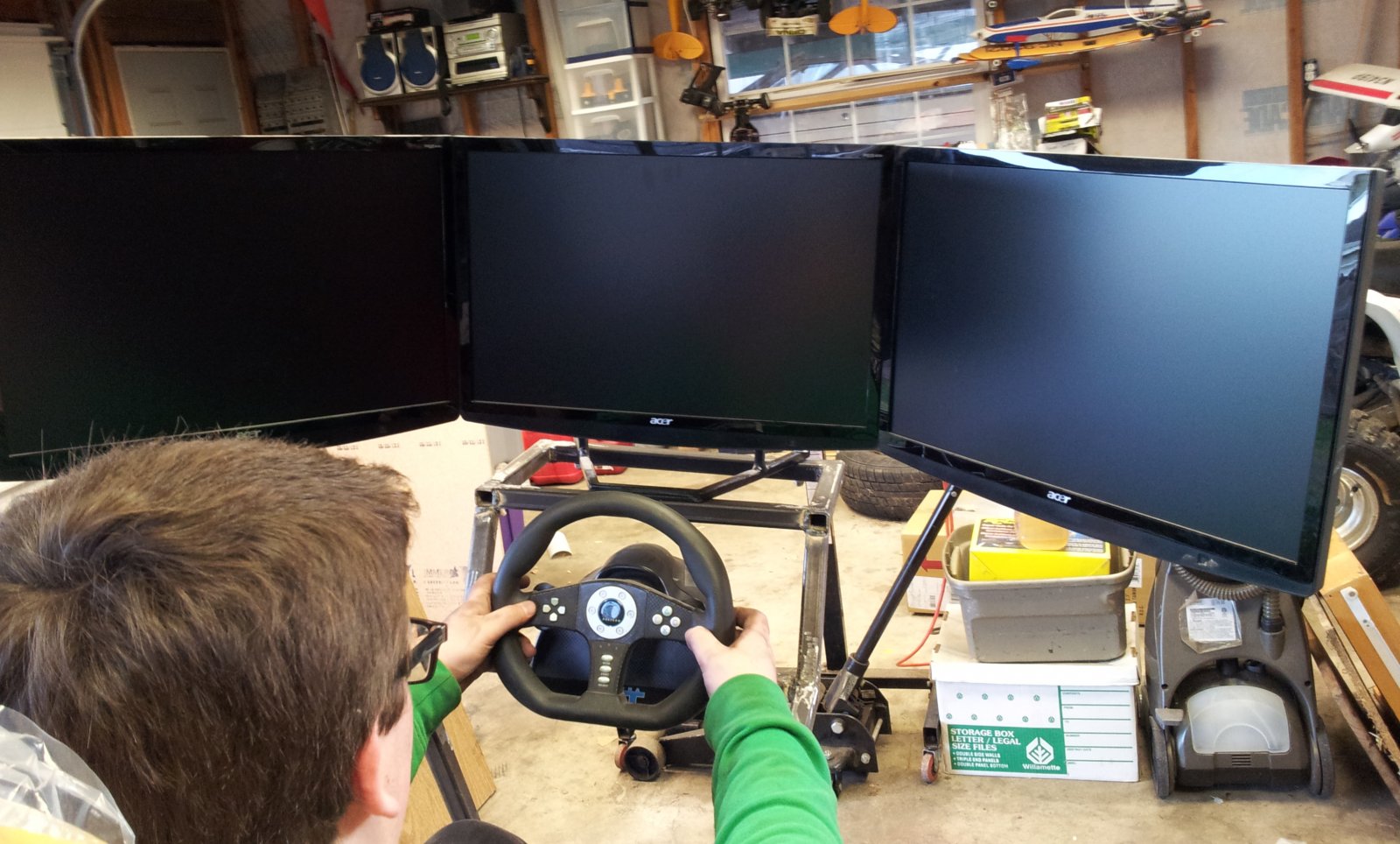

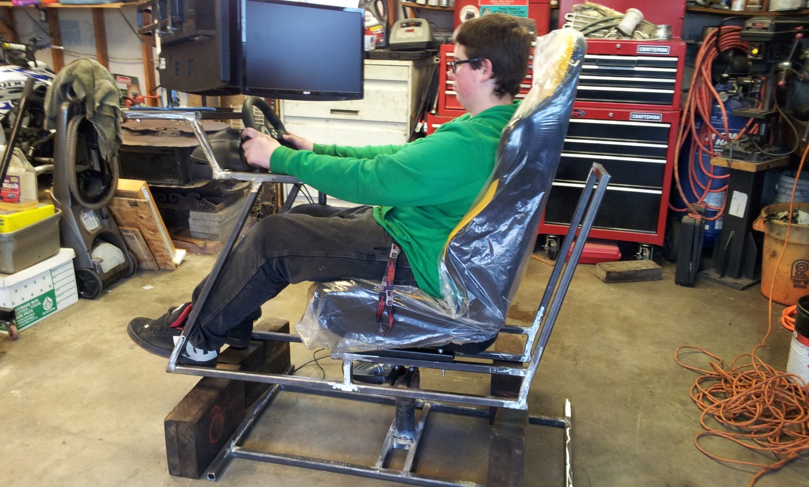

  9. Tech2123
    Tech2123 Tech2123
    Dec 16, 2013
    72
    Wa. USA
    314Coins
    +17 / 0 / -0
    Yes I have started to build it, based on your design, added monitor mount for 3 monitors, at stage of mounting motors ect, got electronics all built, will need info on the software and plugins, want to run a dash as well.
    I will use for Flight and car sim, I will try to use 2 computers.
    Pics attached..
  10. bsft
    wipers will struggle if not break using them and his motor placement. Especially if you plan to add 3 screens.
    Make sure it is balanced properly as well.
    Look at either big worm gear motors like the daytons or 12v boat winch motors. Then place the motors at at least 30 deg angle back and to the sides so they run properly. Mats design (not actually his) is NOT suitable for what you are planning.

  12. bsft
    Just a note, another member has 3 screens on his sim, so you will need bigger motors and more angle and height for the motors to connect.
    look at this vid to see, disregard the surge slider he has underneath it. The video shows the better placement for motors if you want 3 screens on it.
    Thanks Lee.

  16. bsft
    Yes I has motors up front near the feet , but I didnt have screens mounted on it.
    With screens on it, you need to have the motors connecting as high as possible to overcome the high centre of gravity. Hence the shoulder mount and motors at 30-50 deg angle at the back. The angle should be something like how the Scn5 is mounted on a seat mover. That sort of angle.
  17. Tech2123
    Tech2123 Tech2123
    Dec 16, 2013
    72
    Wa. USA
    314Coins
    +17 / 0 / -0
    Great thank you.. I will go with the rear high mounts, that was the plan for the mount originally, just the 30-50 degree part I will need to extend the motor mounts a bit (putting the motors sideways seems a bit more easy to mount)
    Another question? The pots I got are not 360 degree so I will have to either get different ones or mount them with the slotted lever style that never goes 360.
    Re: center gravity, I did center it with monitors, and controllers, pedals, etc. and driver before I attached to base.
    Thank you for all the info really helps, I have been wanting to do this for 3 years now.

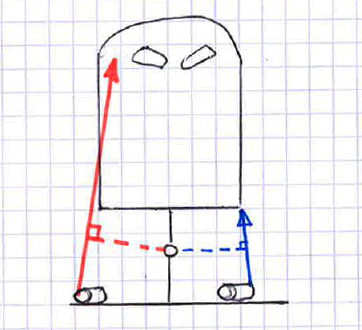

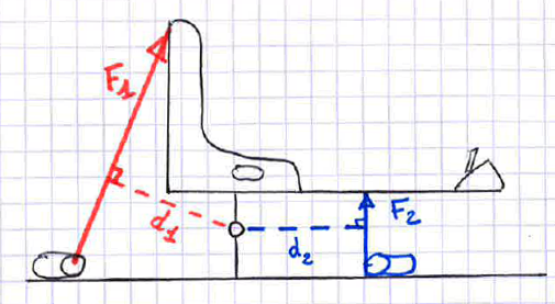

  18. RacingMat
    2,233
    21,066Coins
    +2,092 / 21 / -2
    Hi Tech2123!
    What you have to design is the Moment = F * distance from joint
    Both lateral view and rear view
    Effort required from motor in Red or Blue configuration is roughly equal if distances are equal.
    As in your case, front part is longer : so putting the motors in front of the seat will let you have shorter rods.
    Mat

  19. bsft
    @RacingMat , @Tech2123 , again front mount motors will work, especially down near the feet, but you still need to connect them as high as you can.
    With my "foot motor" frame, I made a section so the motor connection hooked up at about the bottom level of the seat, but higher is preferred. Mine worked as the motor to pivot was about 700mm distance. I didnt have screens on mine moving with the frame. In foresight, a bit higher connection would have been better again.
    Its not JUST a matter of balancing the frame, but going higher than the centre of gravity , which generally speaking is your belly button. If you can go up near the same "line" as that or higher, you are going to put less load on the motors.
    Its not a matter or shorted rod end connections, its a matter of overcoming the power needed to move the thing.
    So @Tech2123 , if you want to move 3 screens, you HAVE to mount the motors at the back at the shoulders or even a bit higher if you can. And yes , as much angle as you can. 30-50 deg.
    And you calculated the best pivot point with everything on the frame, not the actual centre of gravity. Pivot balance is crucial, next thing is over coming centre of gravity.
    With pots, if they are single 360 deg turns, just tap a hole in the back of the motor shaft and slot the pot shaft into this. Then you use about 180 deg turn of that pot and it will still be very accurate.
    Cheers, David.
    • Dislike Dislike x 1
