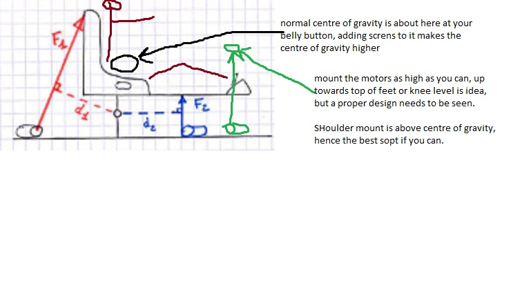

    Using Mats pic, @treza , do you see what I mean now? Centre of gravity and pivot are two different things. Higher above centre of gravity is ideal, especially if the builder is planning to add screens to it.
    And if you have a better idea, then add to this thread. I have been though 11-12 different designs , mostly building them myself. I know what limits are in design.

    @treza been through many builds too, motor underneath do not extert the same power as shoulder mounts, built them both, shoulder mounts can handle a greater mass, the higher you move an object above its centre of rotation the easier you can move it, having the motors underneath requires alot more force, the sketch and calc is in correct.
