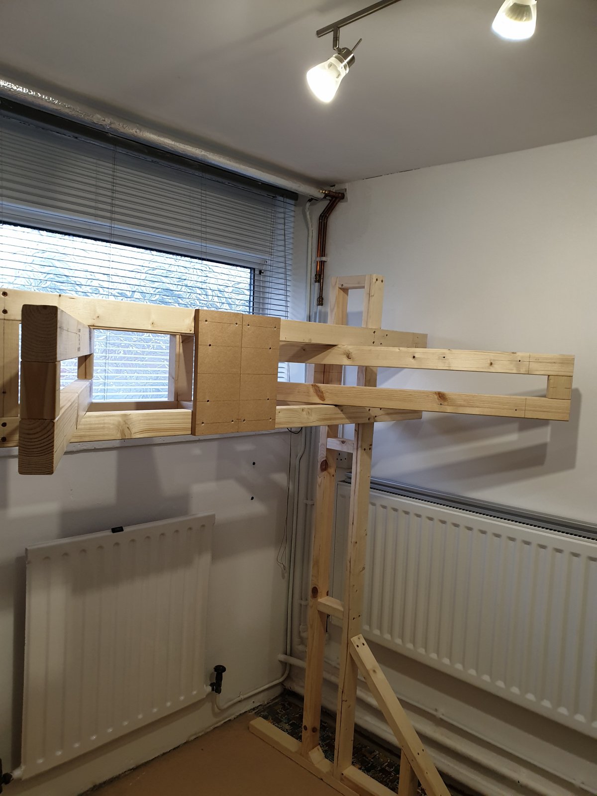

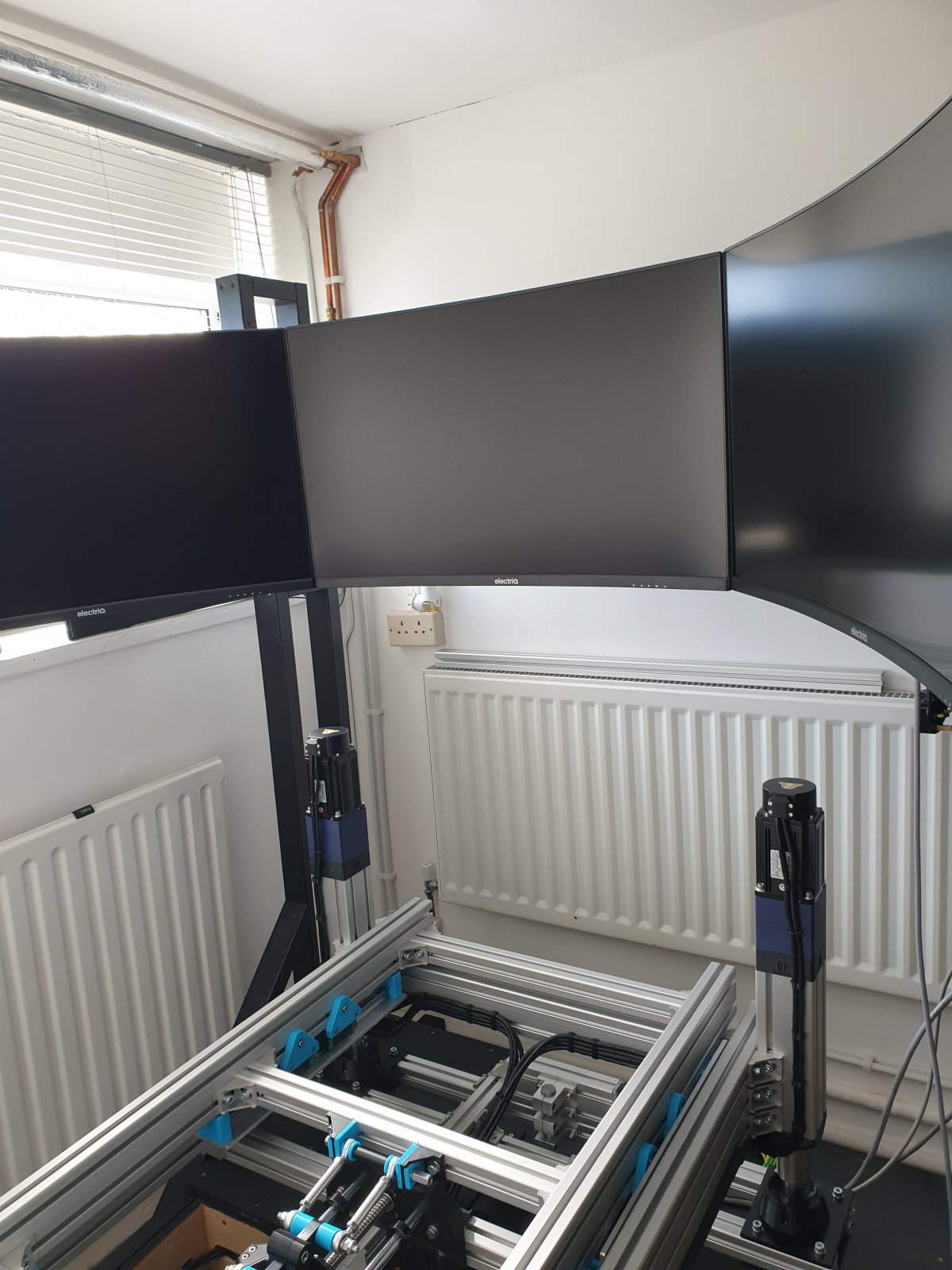

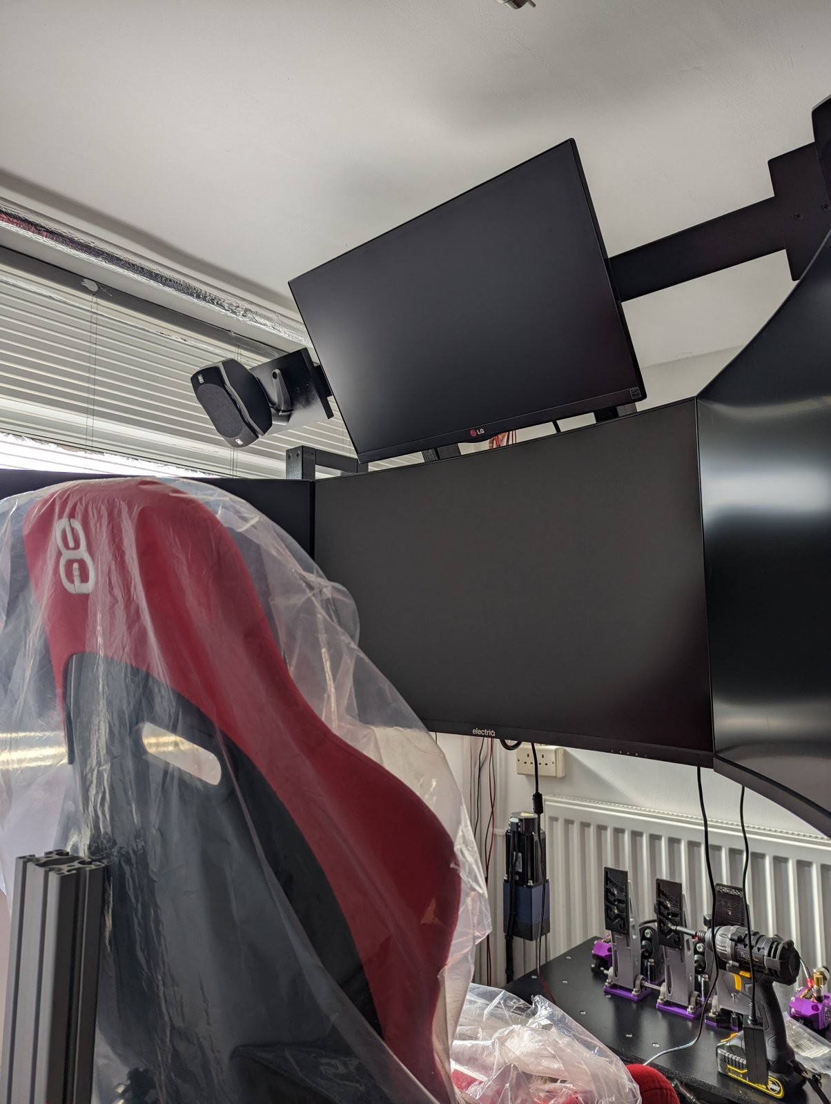

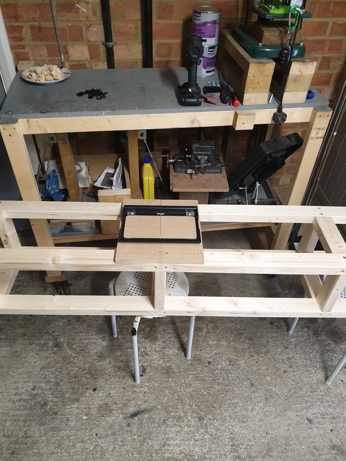

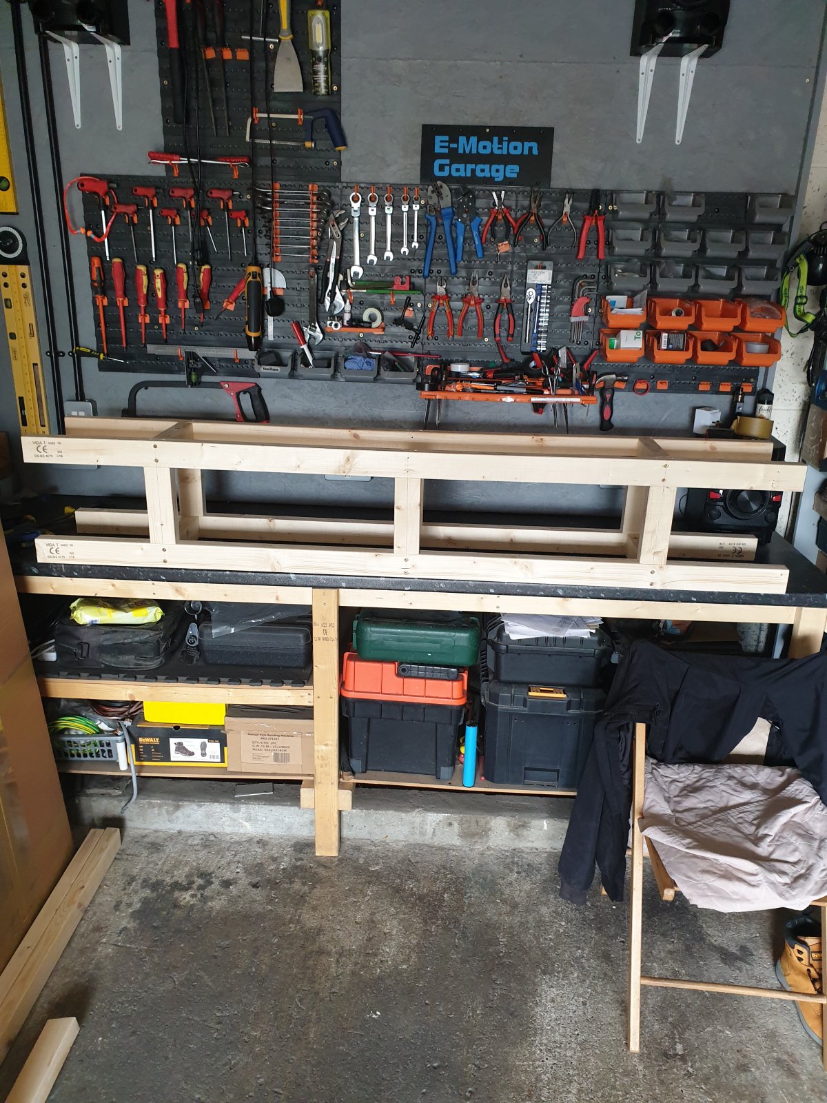

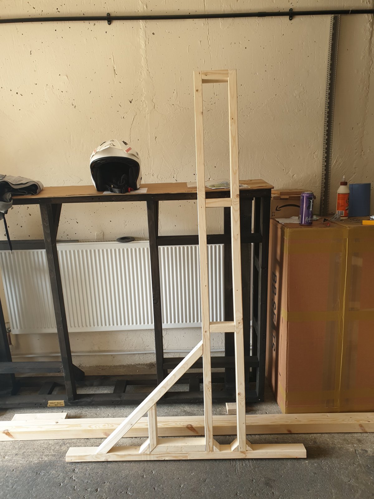

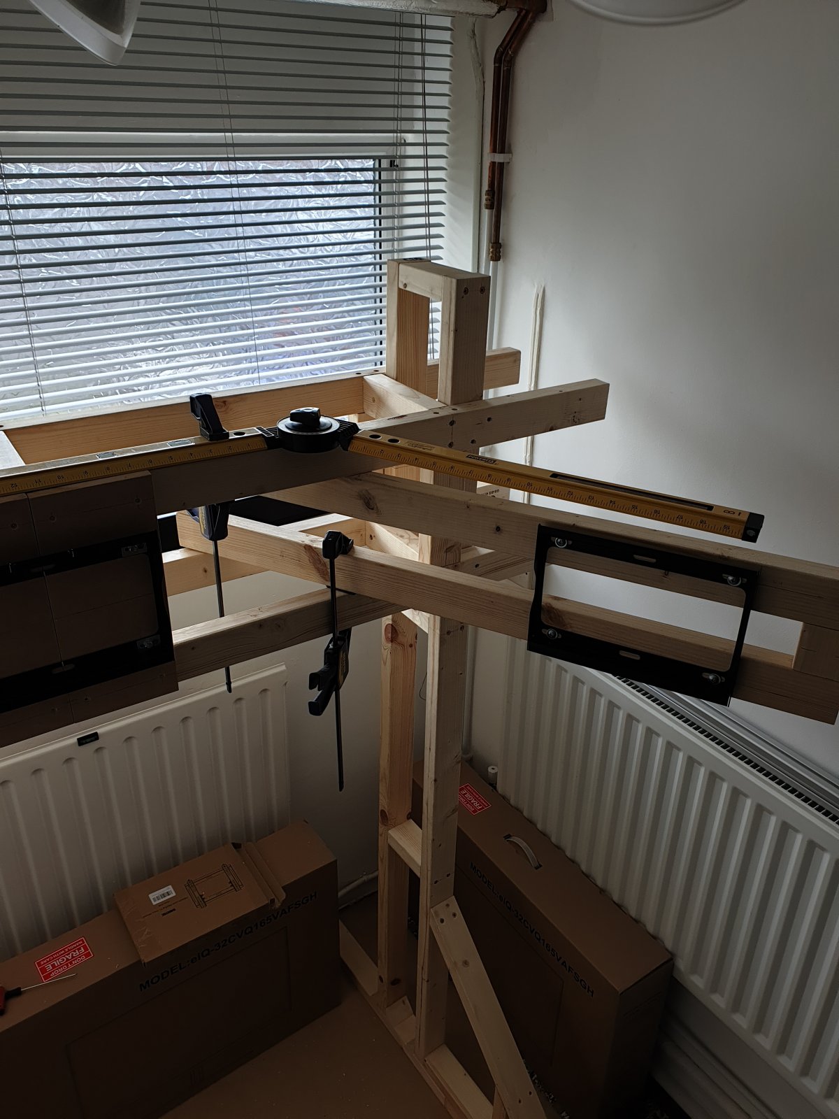

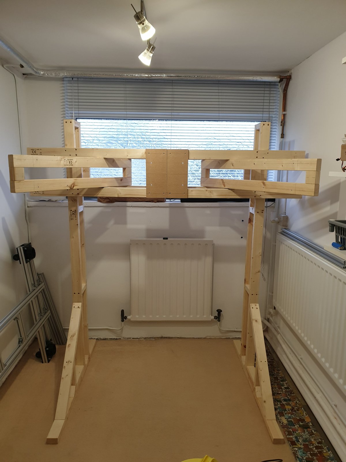

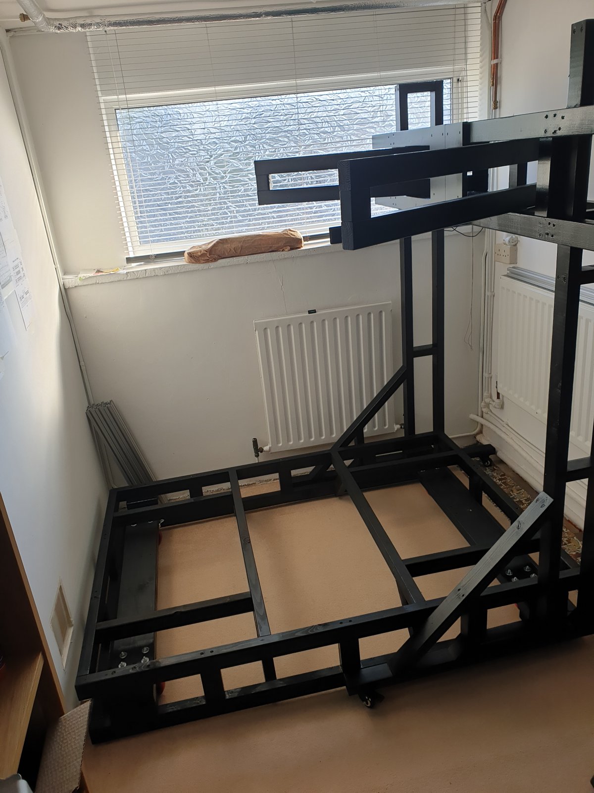

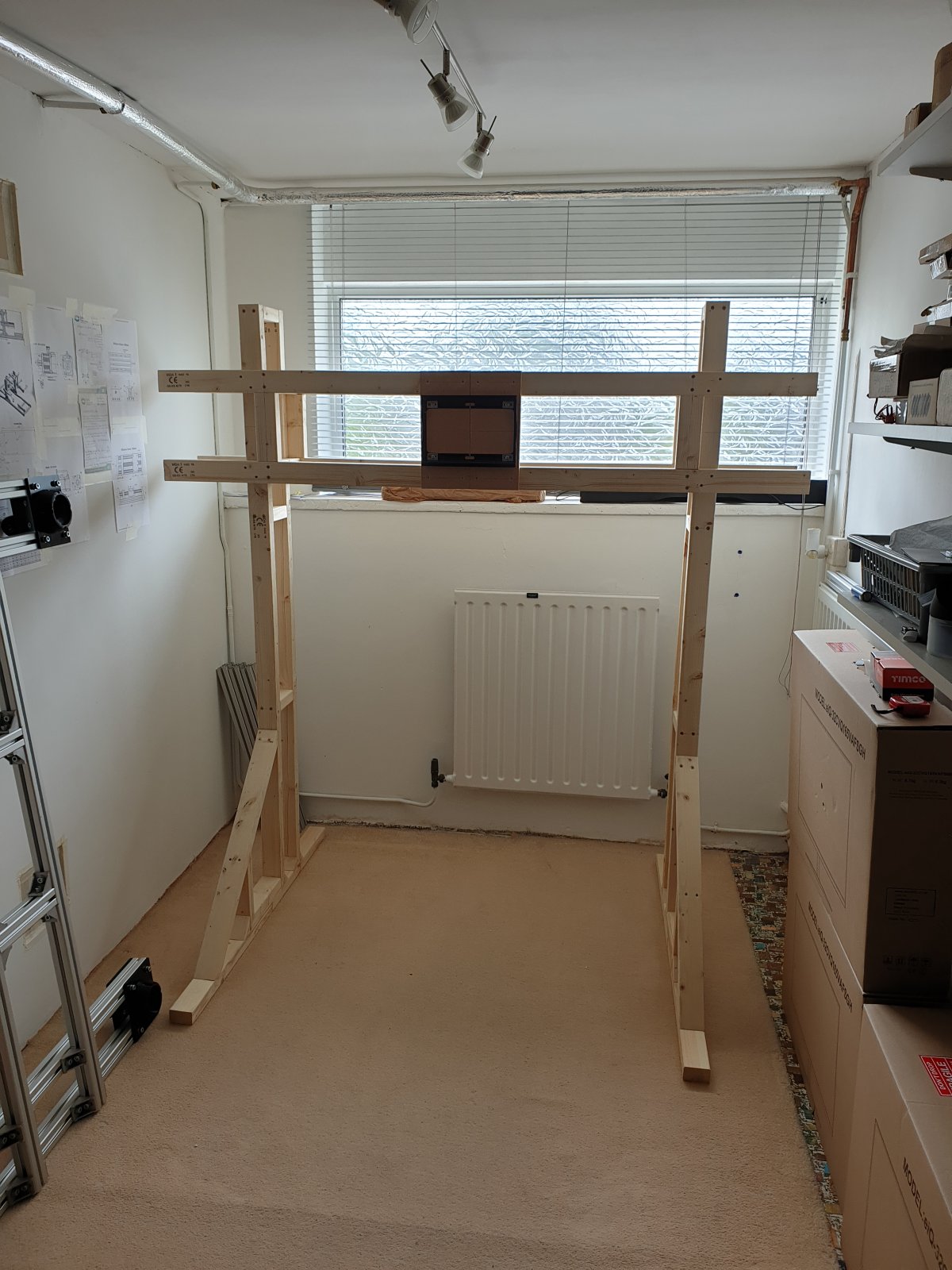

    Got the monitor stand fully built (2 reprisals , first 120⁰ which was too wide and it would not fit the width of the room as i have cabinets and shelves on both walls as part of the workshop plus i will have to offset the rig and stand to one side of the room to allow plenty of space to jump on the rig on the opposite side) with 180⁰ FOV , each monitor at 60 ⁰ from the horizon line.
    The stand looks and it is overkill but it happened that this type of CLS Studwork timber was a lot cheaper overall comparing to the smaller sizes, plus i will add (in the near future) some sort of canopy/more of an enclosure for the rig which will mostly be connected to and part of the monitors stand.

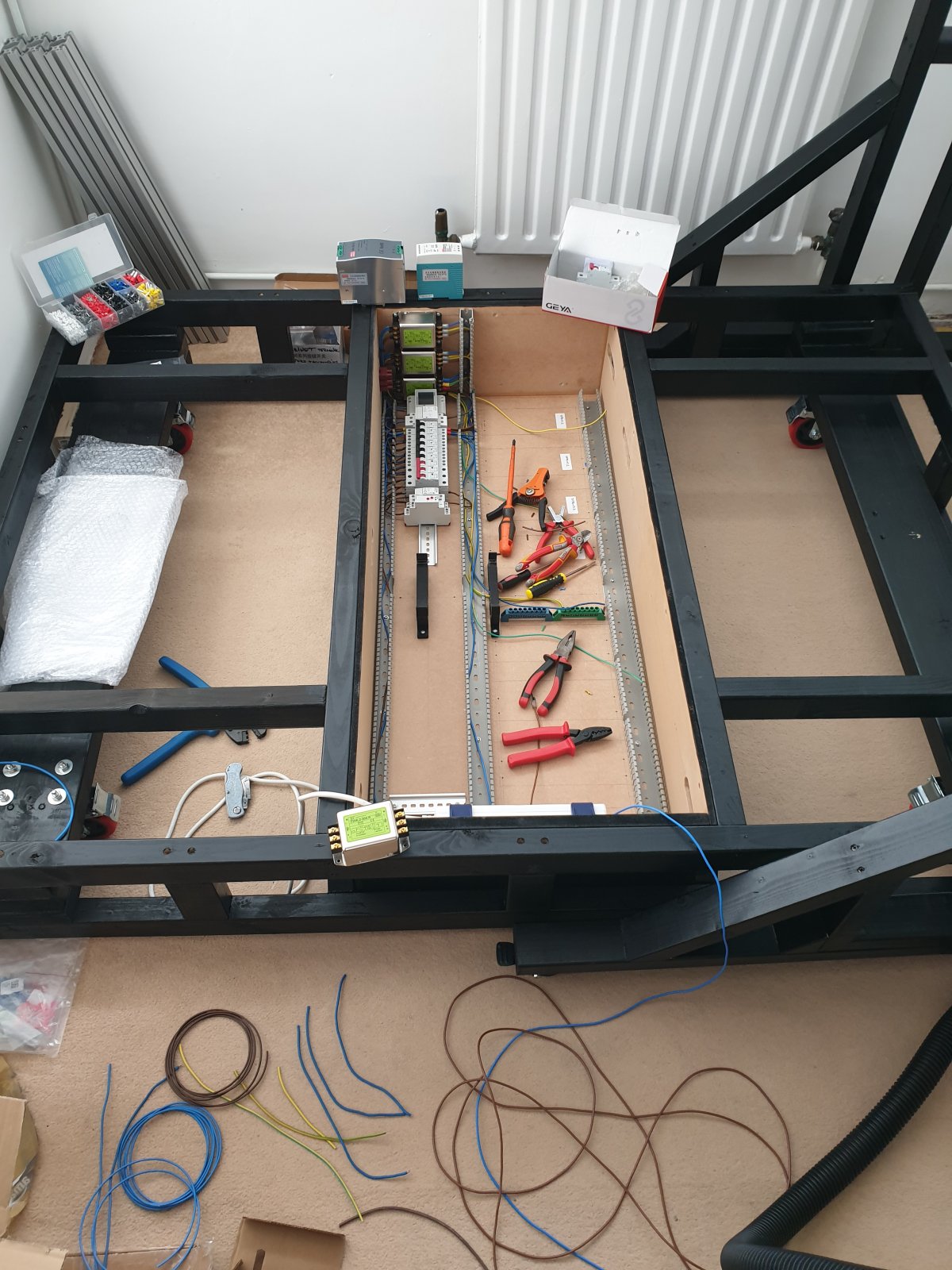

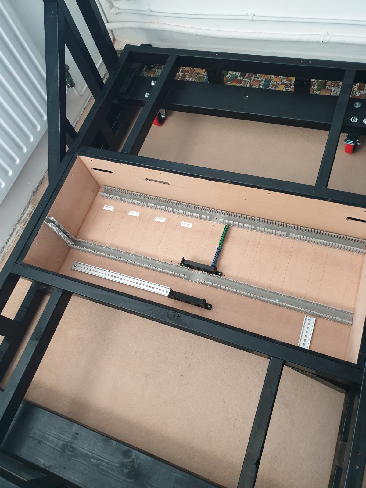

    Here we go again!

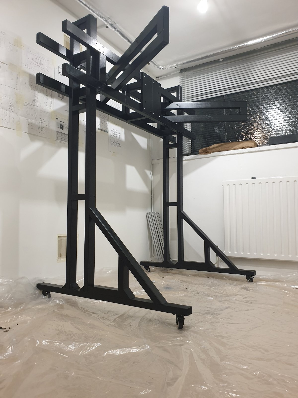

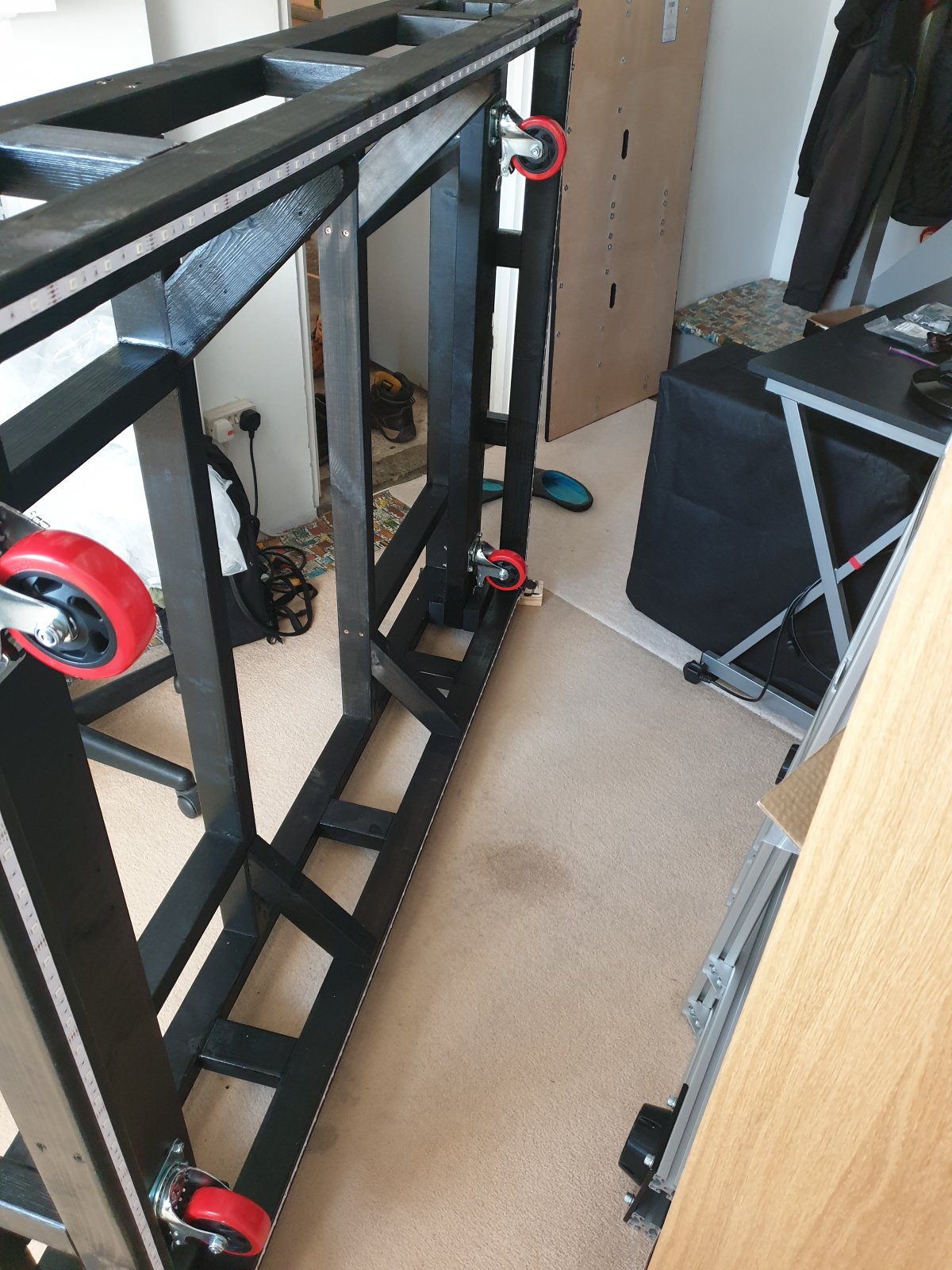

    I have to admit i have 95% of the parts, but the entire build is going SLOW. I am aiming to work on this 2 3 hours during the week (after work at 17:00) and 6 to 8 hours on saturdays and sundays.
    Painted all the woodwork and lay it down on it's final position, added casters for ease of moving it around for housekeeping mainly.

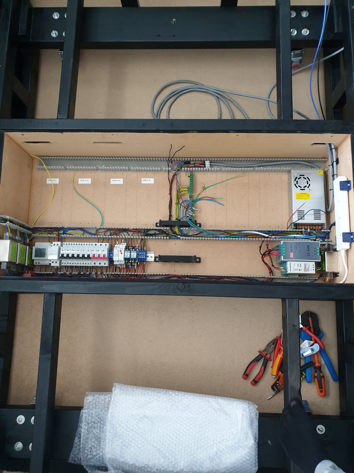

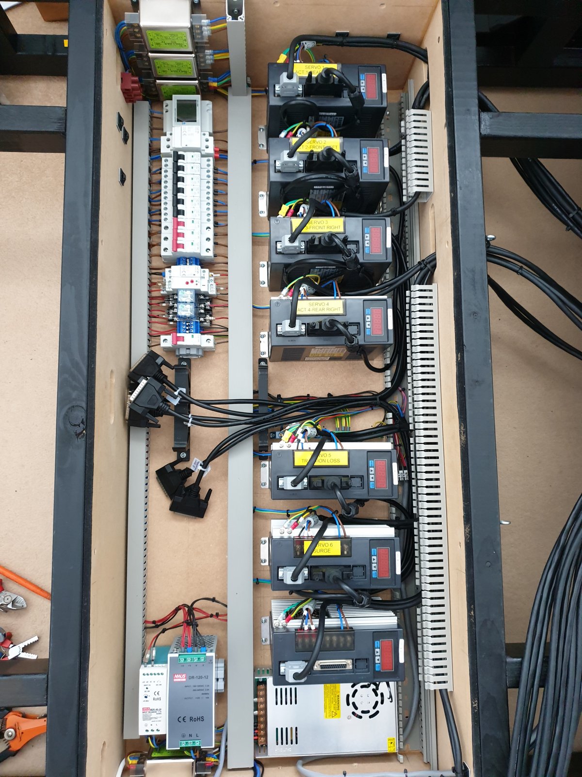

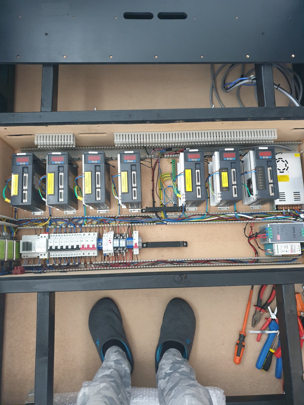

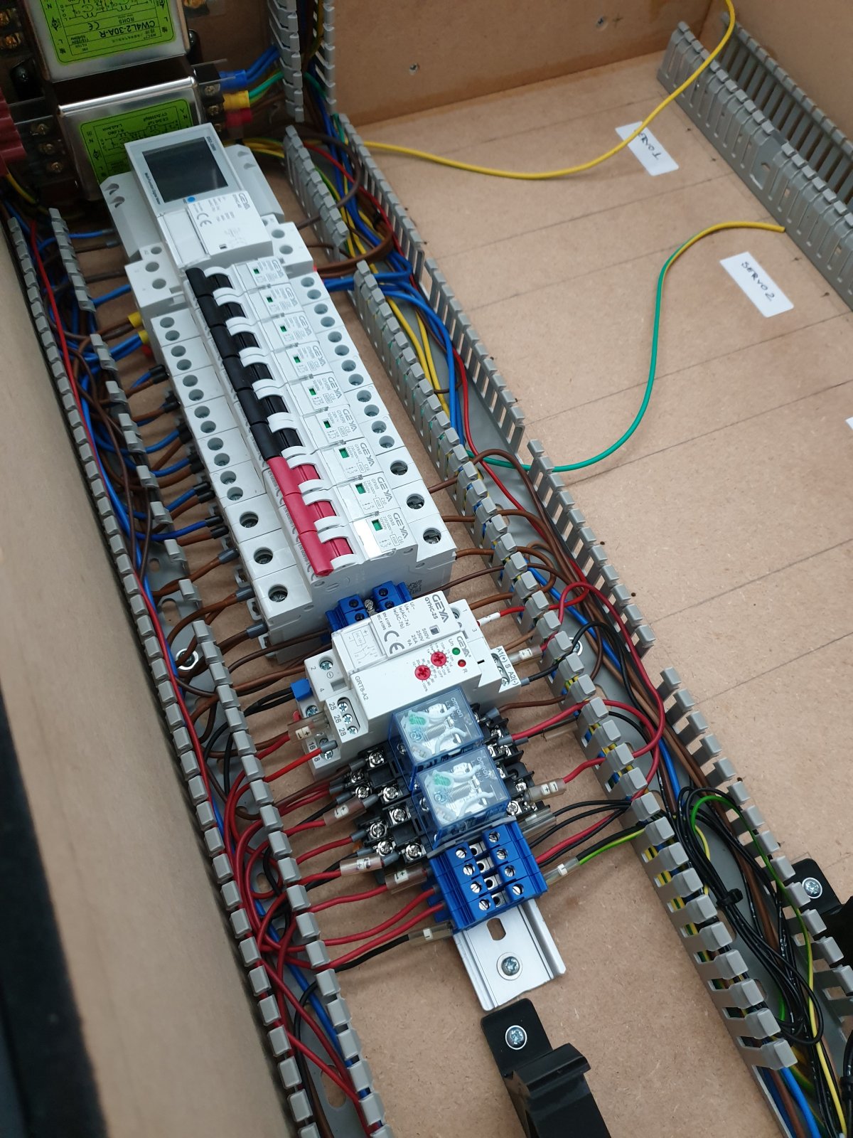

    Also started on the wiring of the electrical cabinet, which i should finish by monday evening.

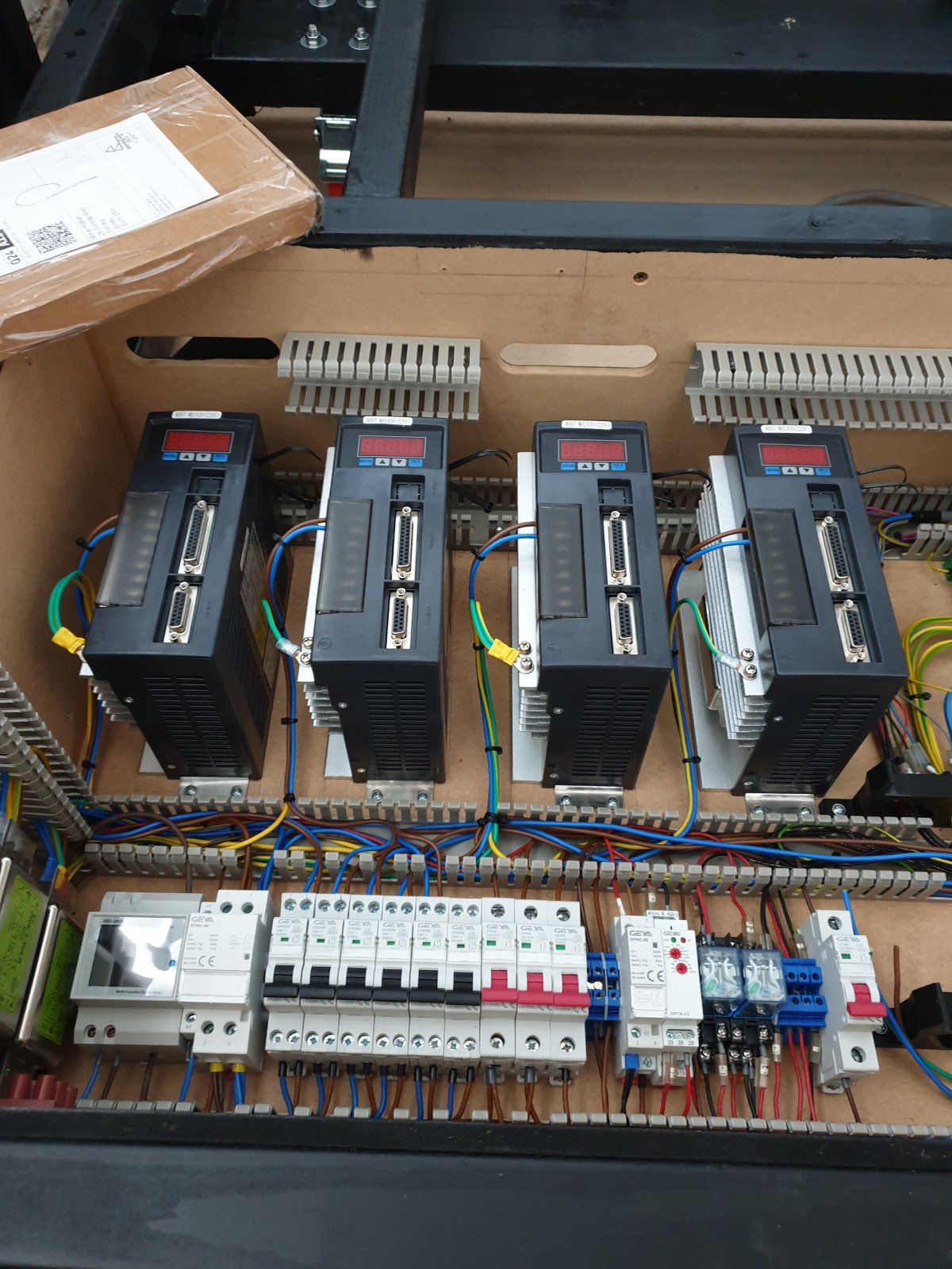

    Still ticking along with the electrical cabinet.

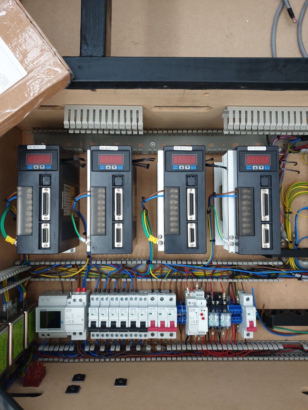

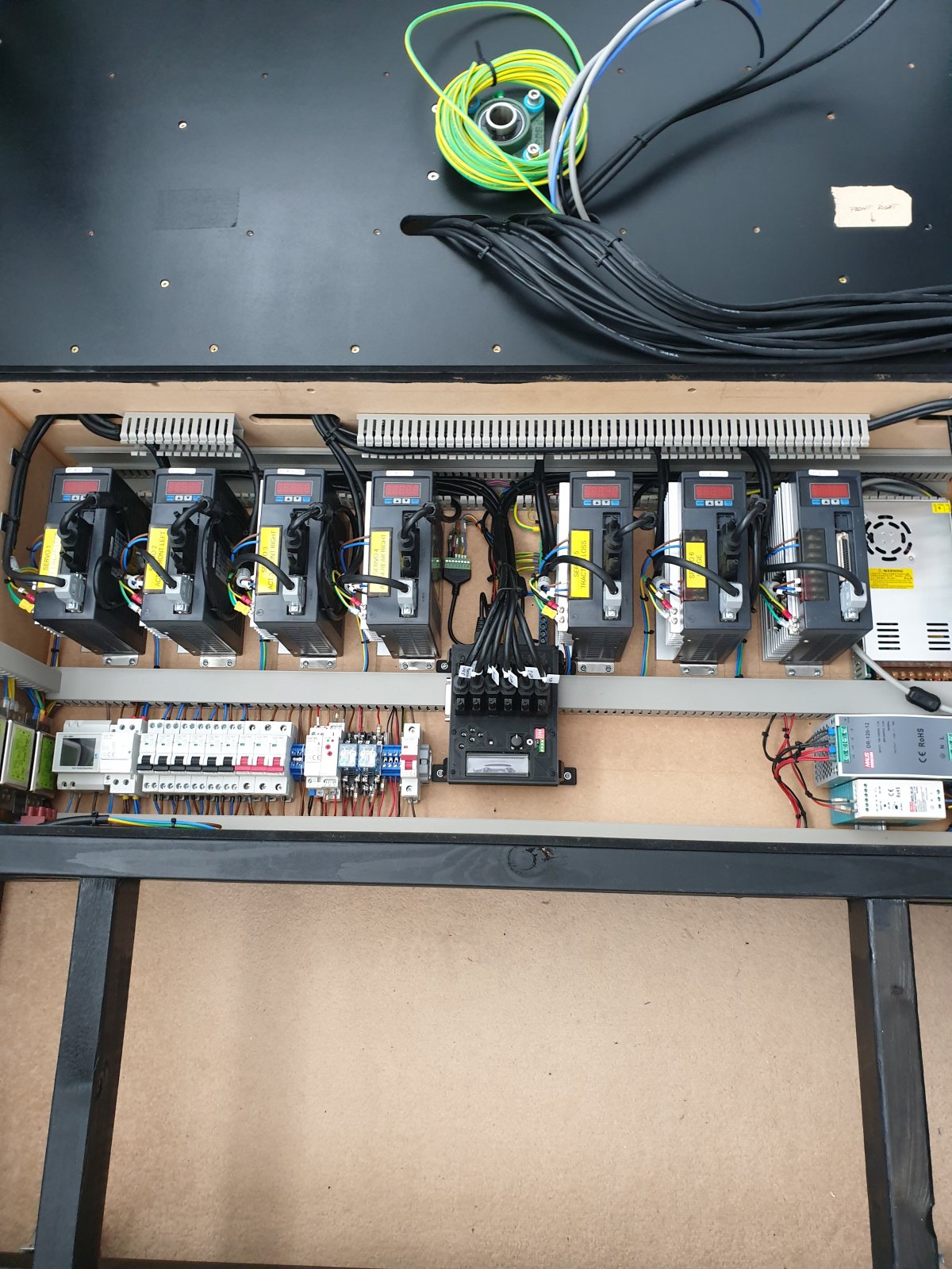

    Electrical cabinet is DONE !

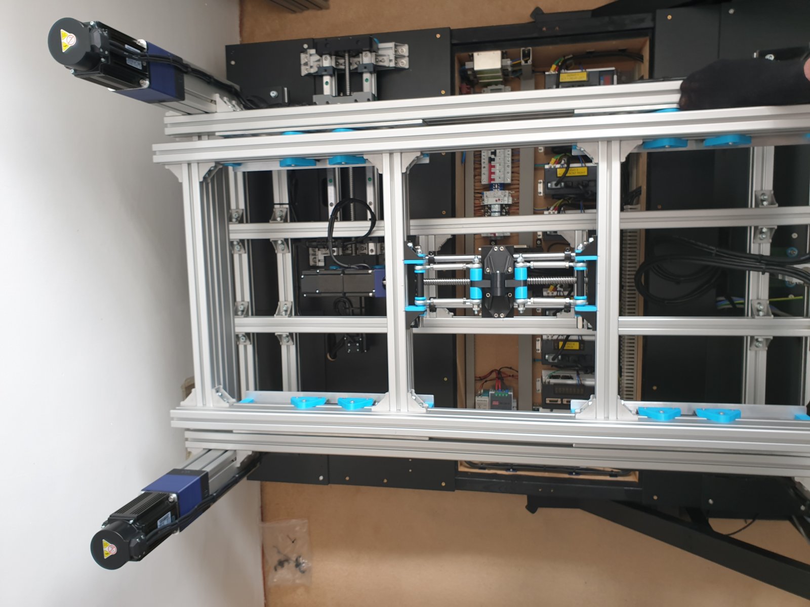

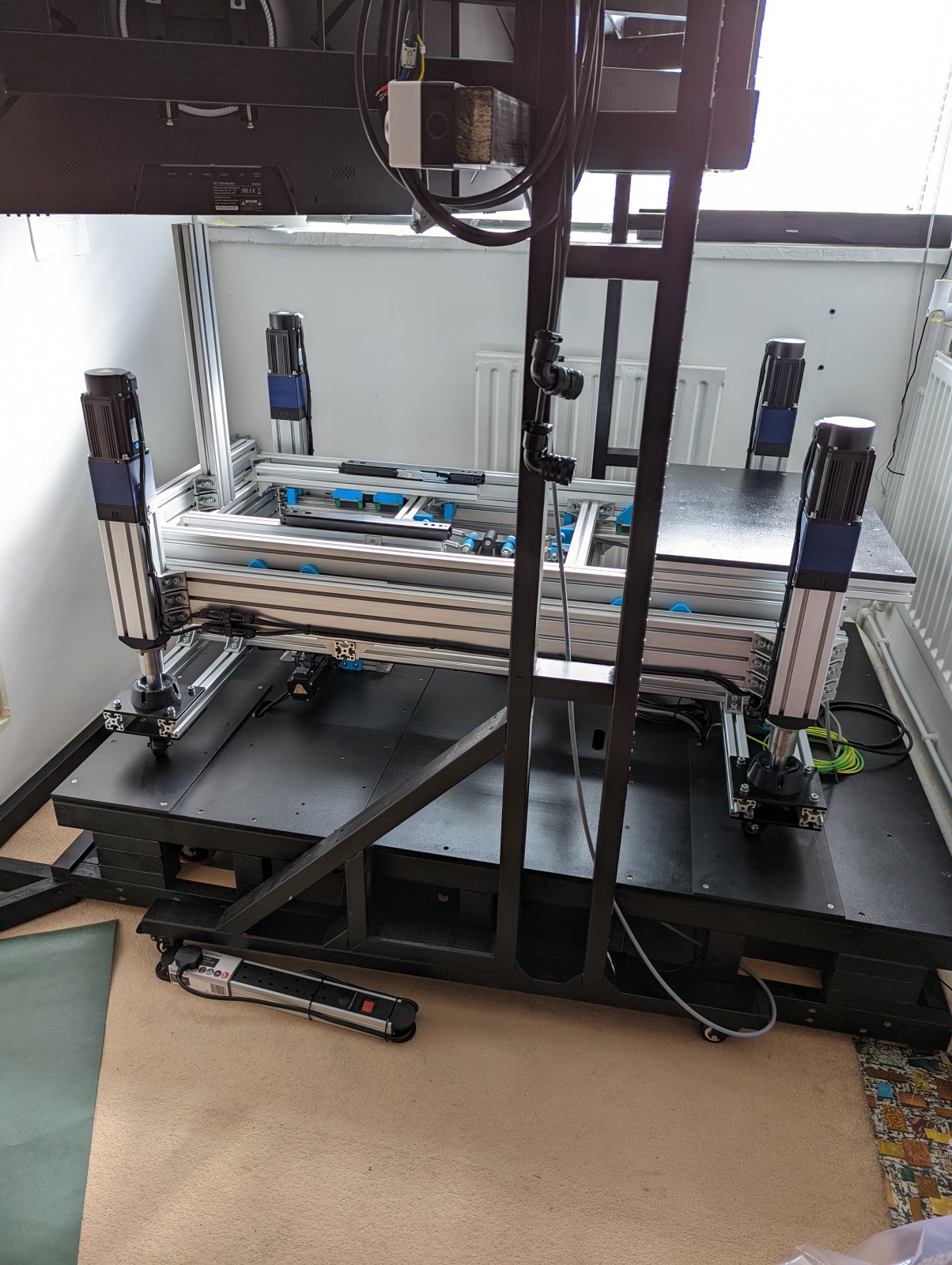

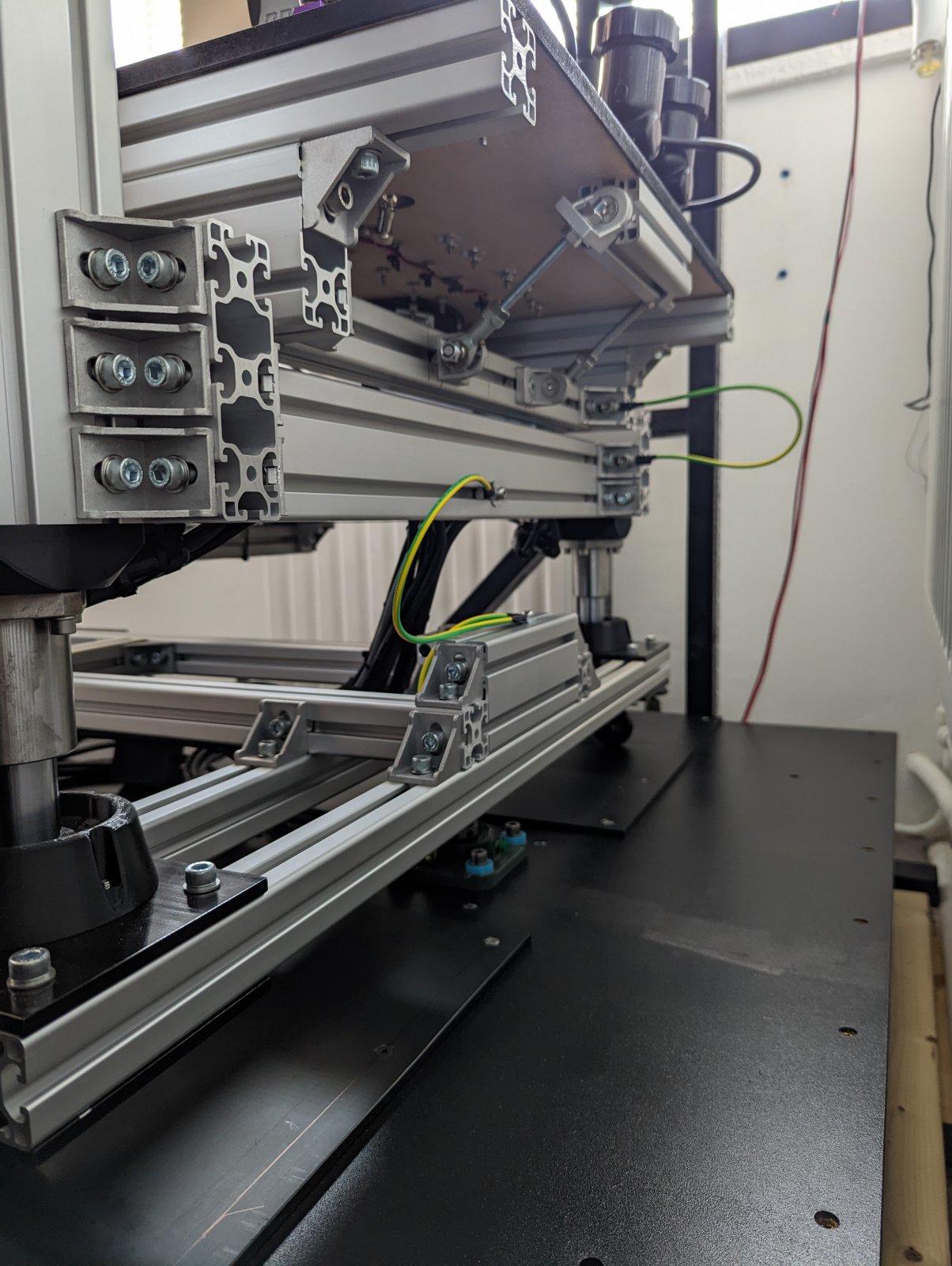

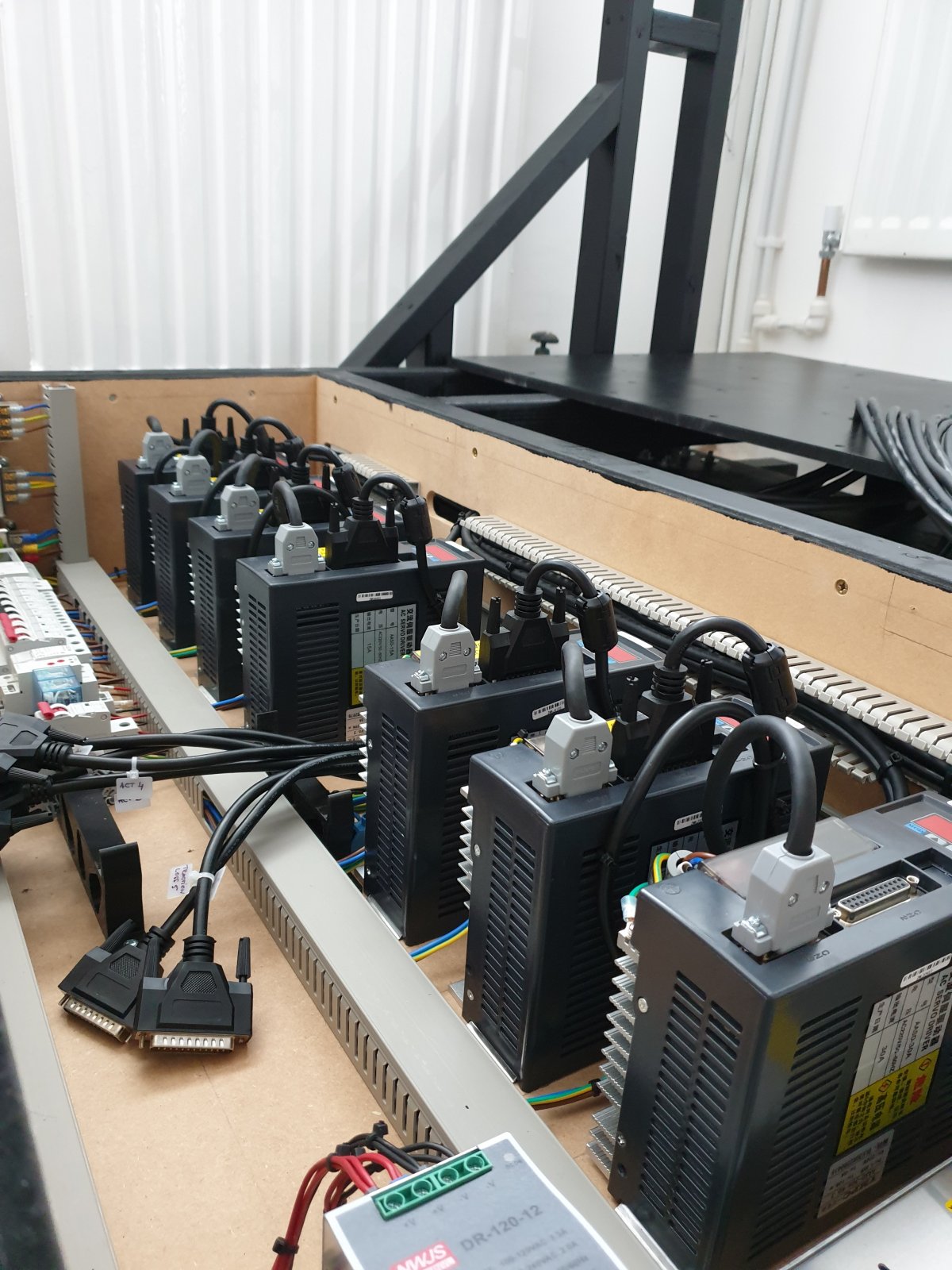

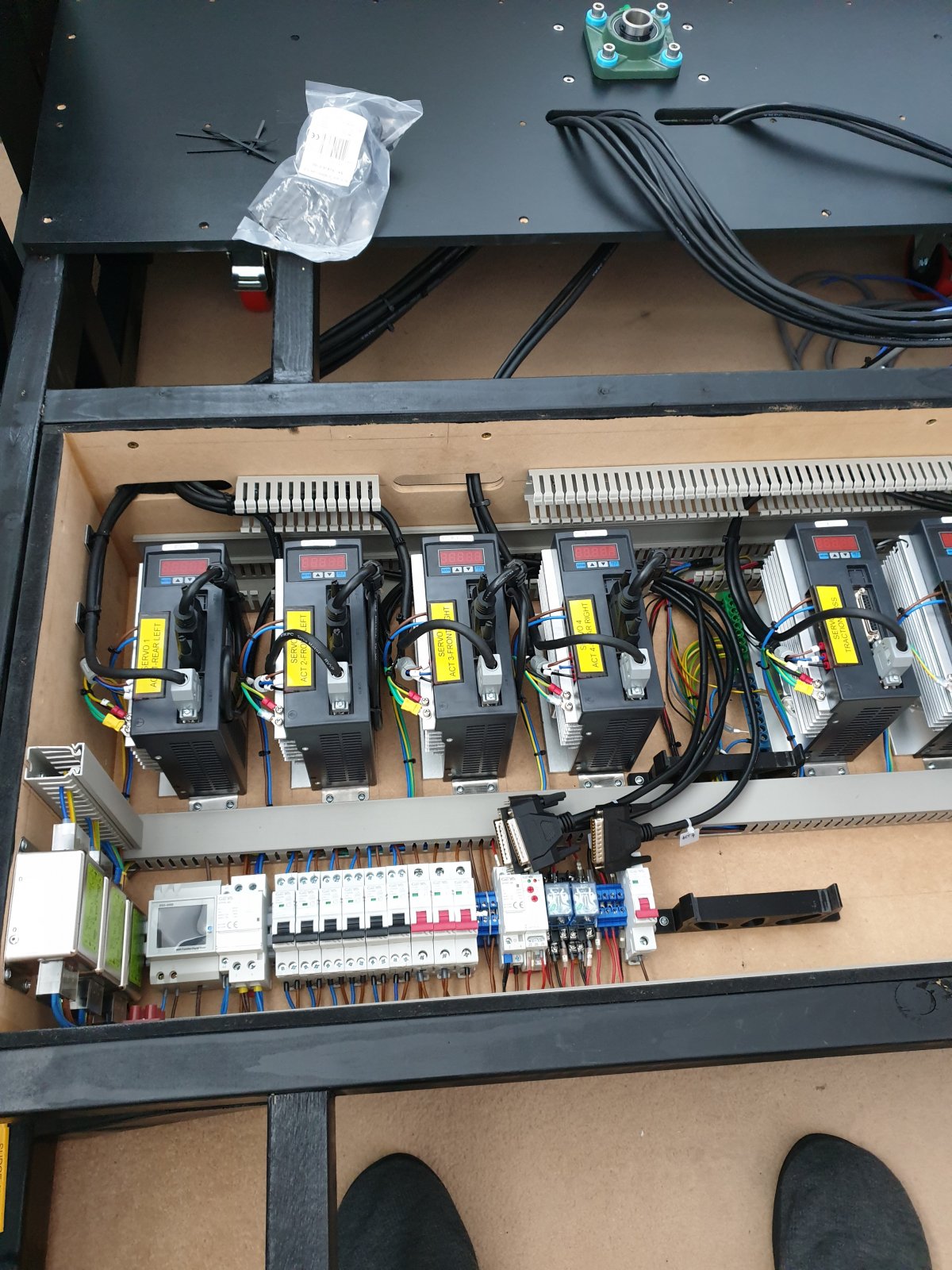

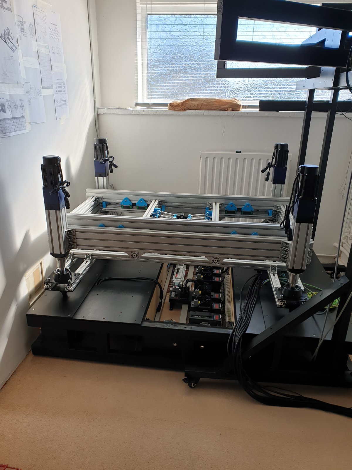

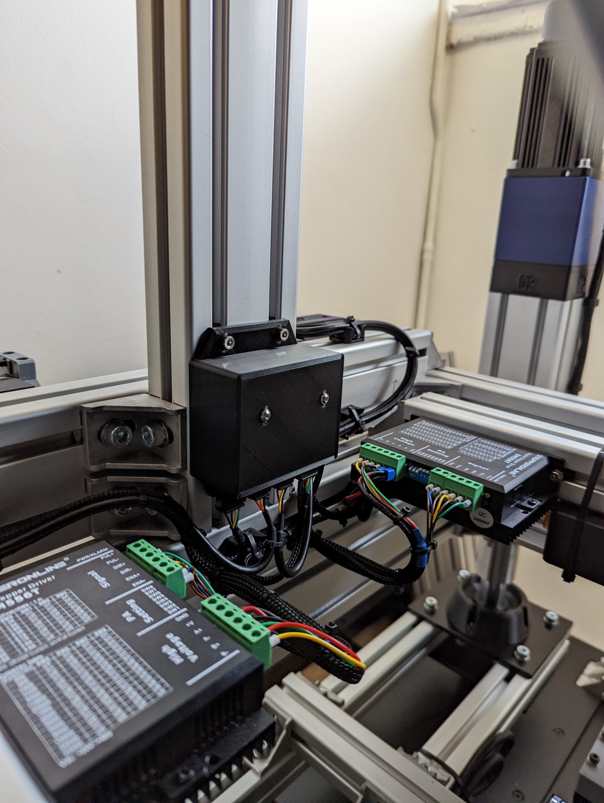

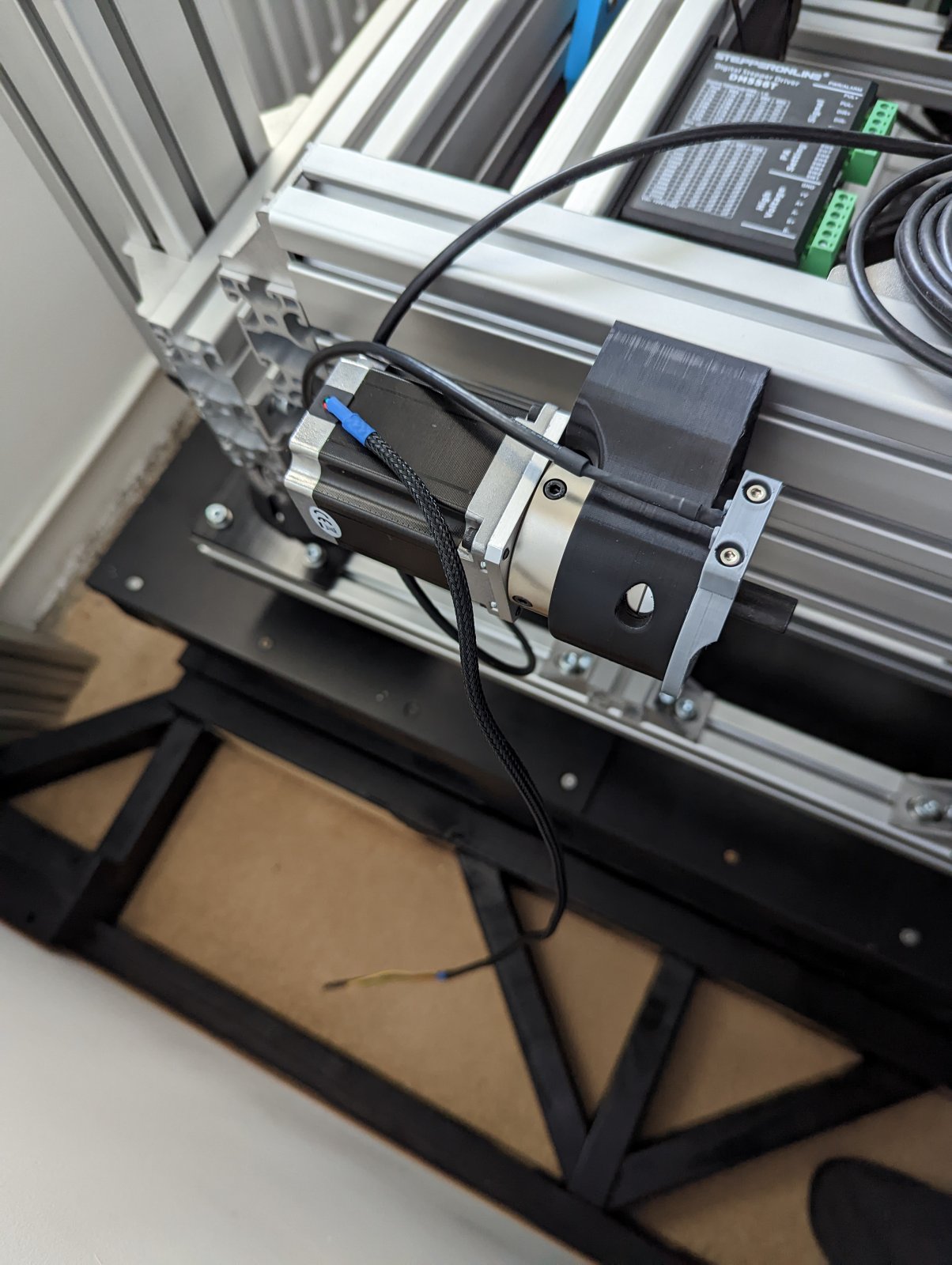

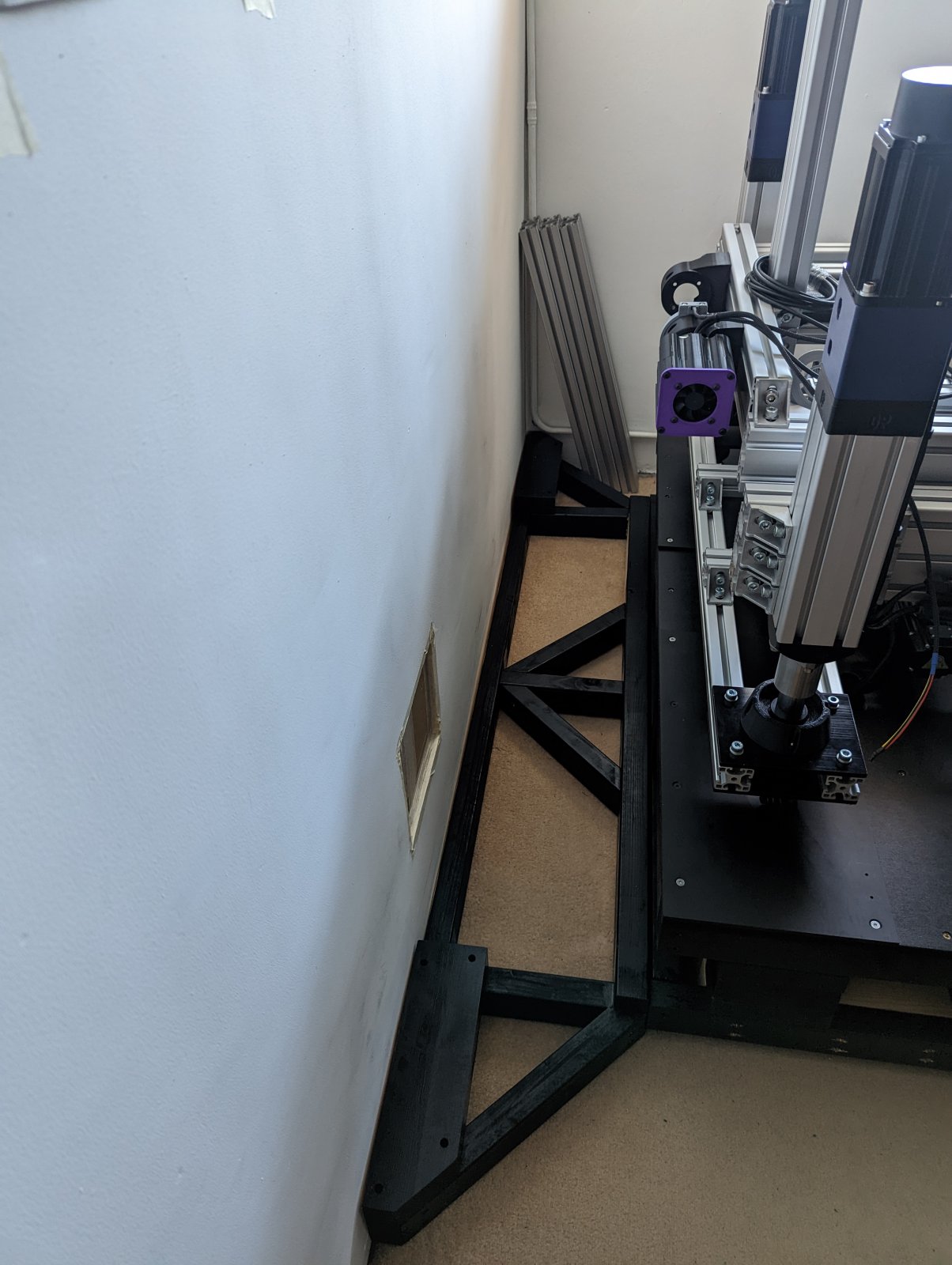

    Finally got it up on the platform and wired in the verticals only. It Moves !!
    The platform does give some unwanted noise resonance , more than i expected, reason why i did not wanted to have a closed box and left the 4 sides open, but still a bit noisy even open platform. I guess i will have to either live with it or deal with it .

    Looks fantastic, I really like your horizontal actuators. They are much better designed than mine. And your wiring is far far tidier than mine as well . I am jealous :thumbs

    Thank you very much, i really appreciate it.
    I wanted to have such machinery since very long time ago, this is why i am taking my time to make it nukeproof and look good too ✌
    In regards to wiring, it is just my very bad OCD , as the cabinet will be covered with a MDF lid because there is where i need to step in order to jump into the sim and no one will see it, a bit of shame but i wanted to ve stealth-ish without cables sticking out on the floor, with separate cabinet etc.

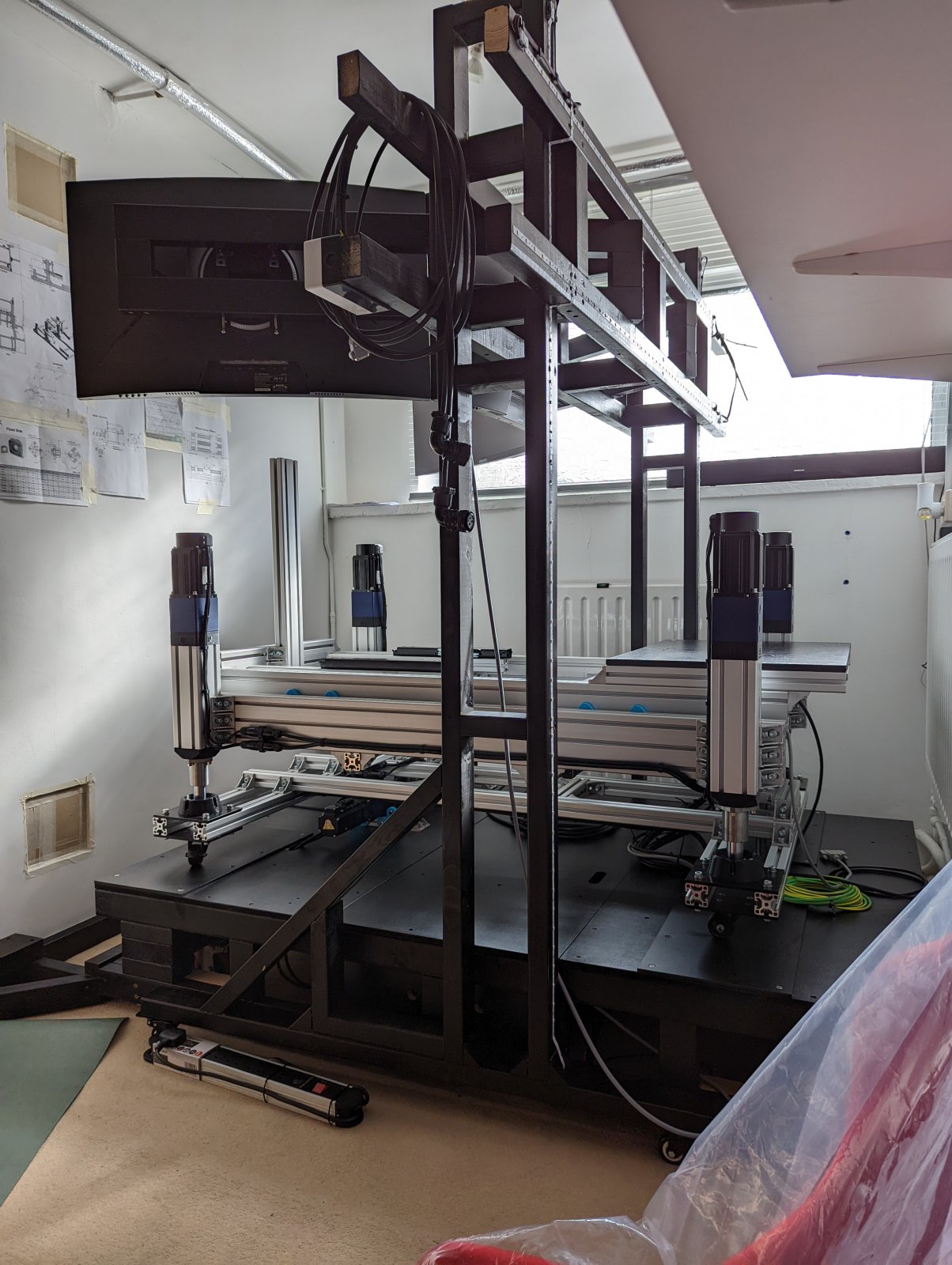

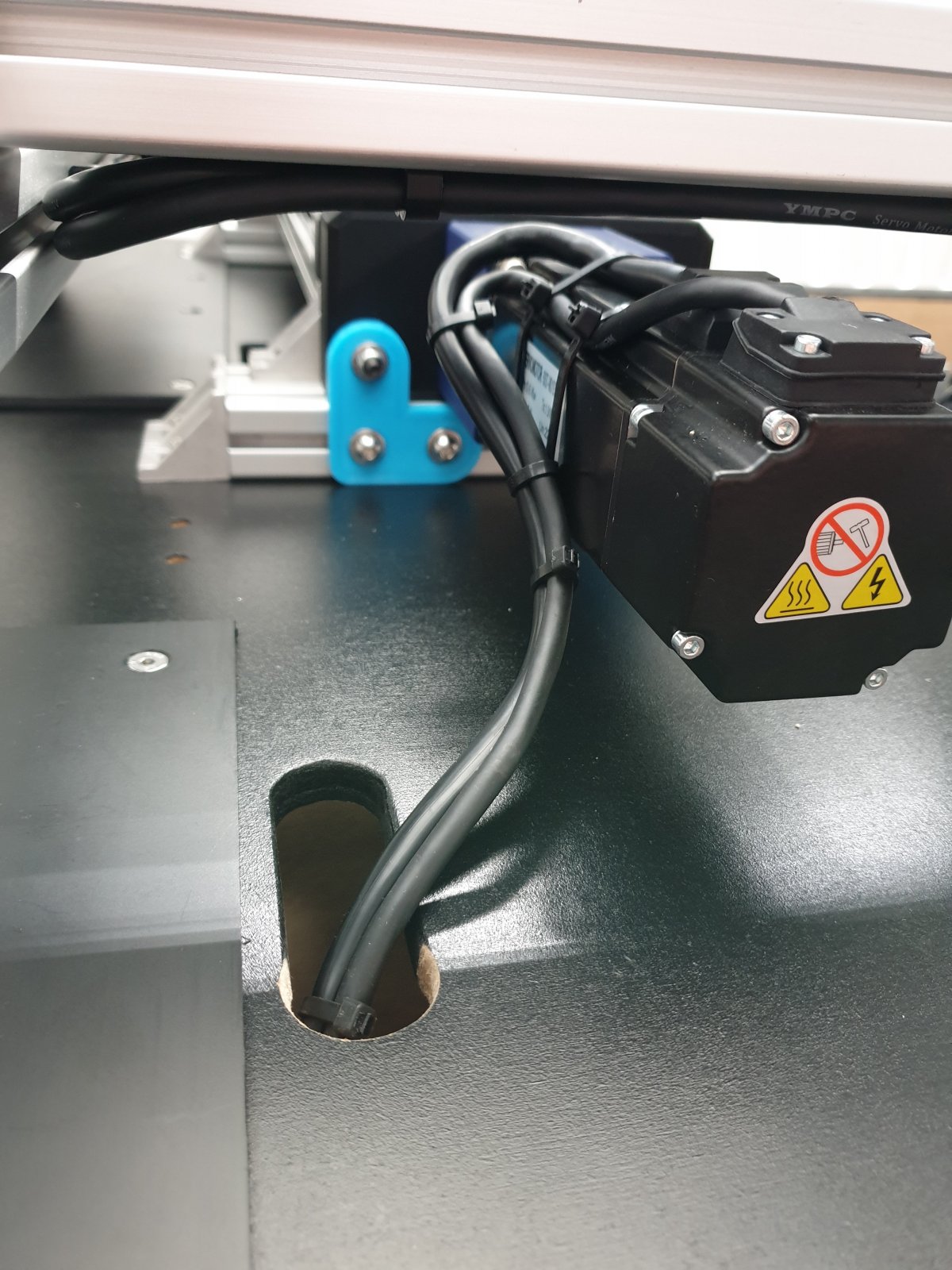

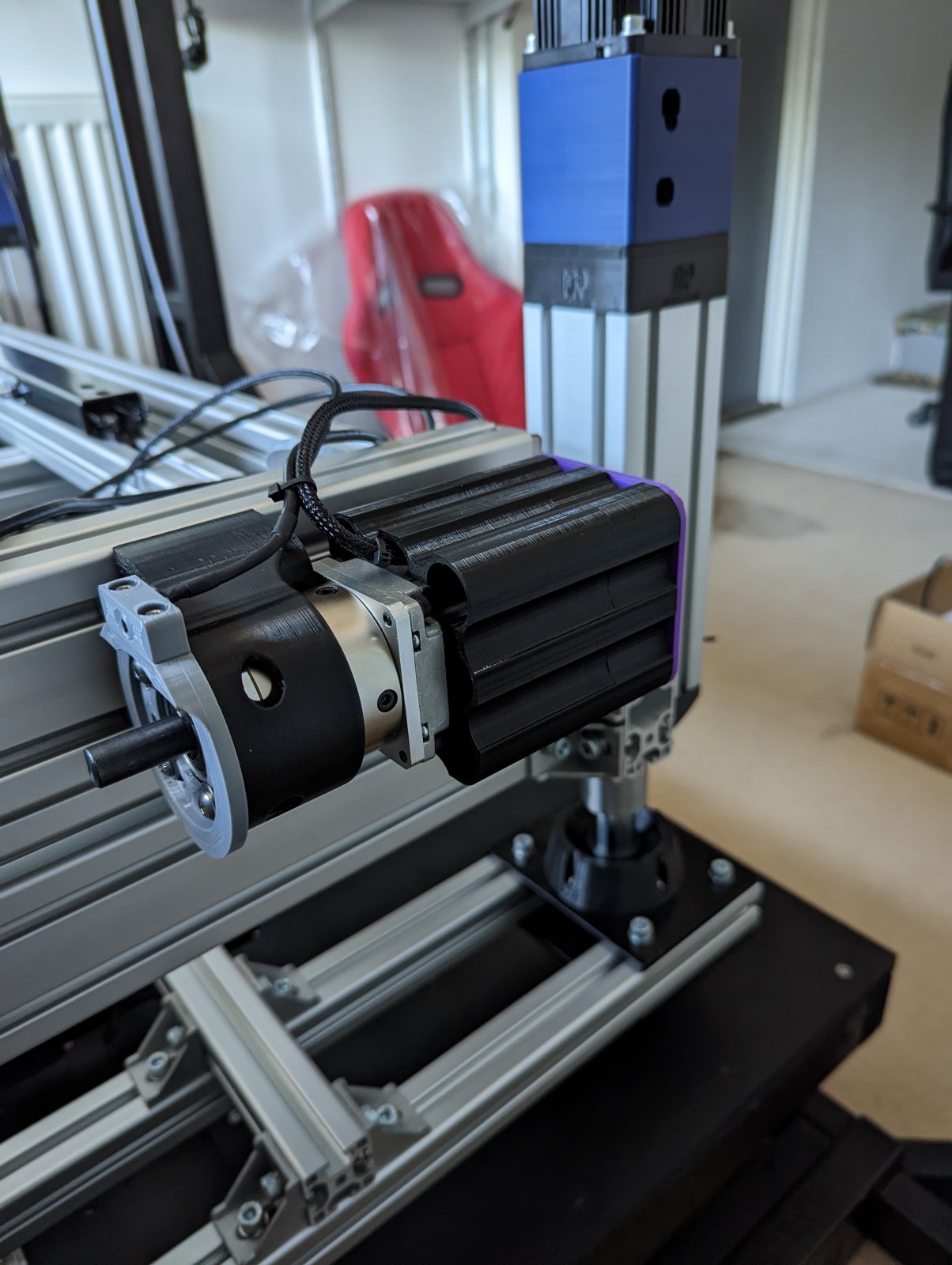

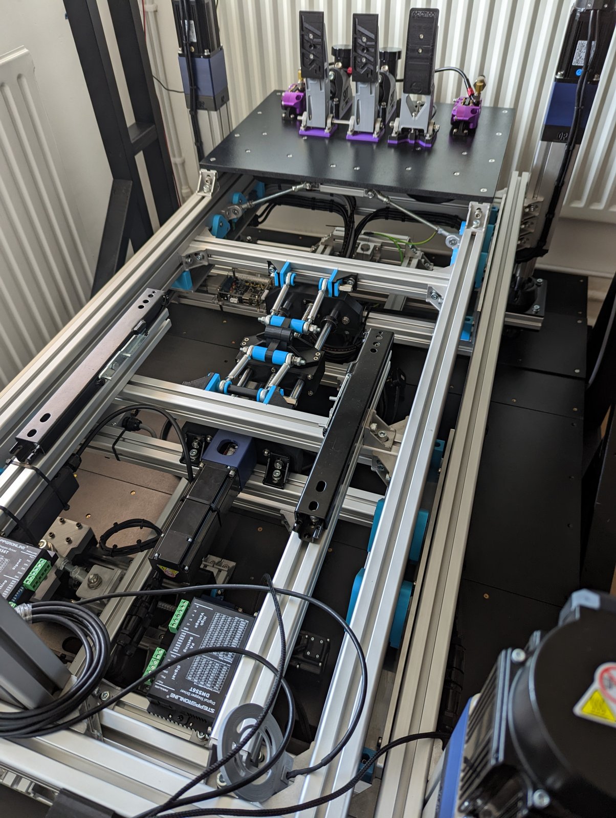

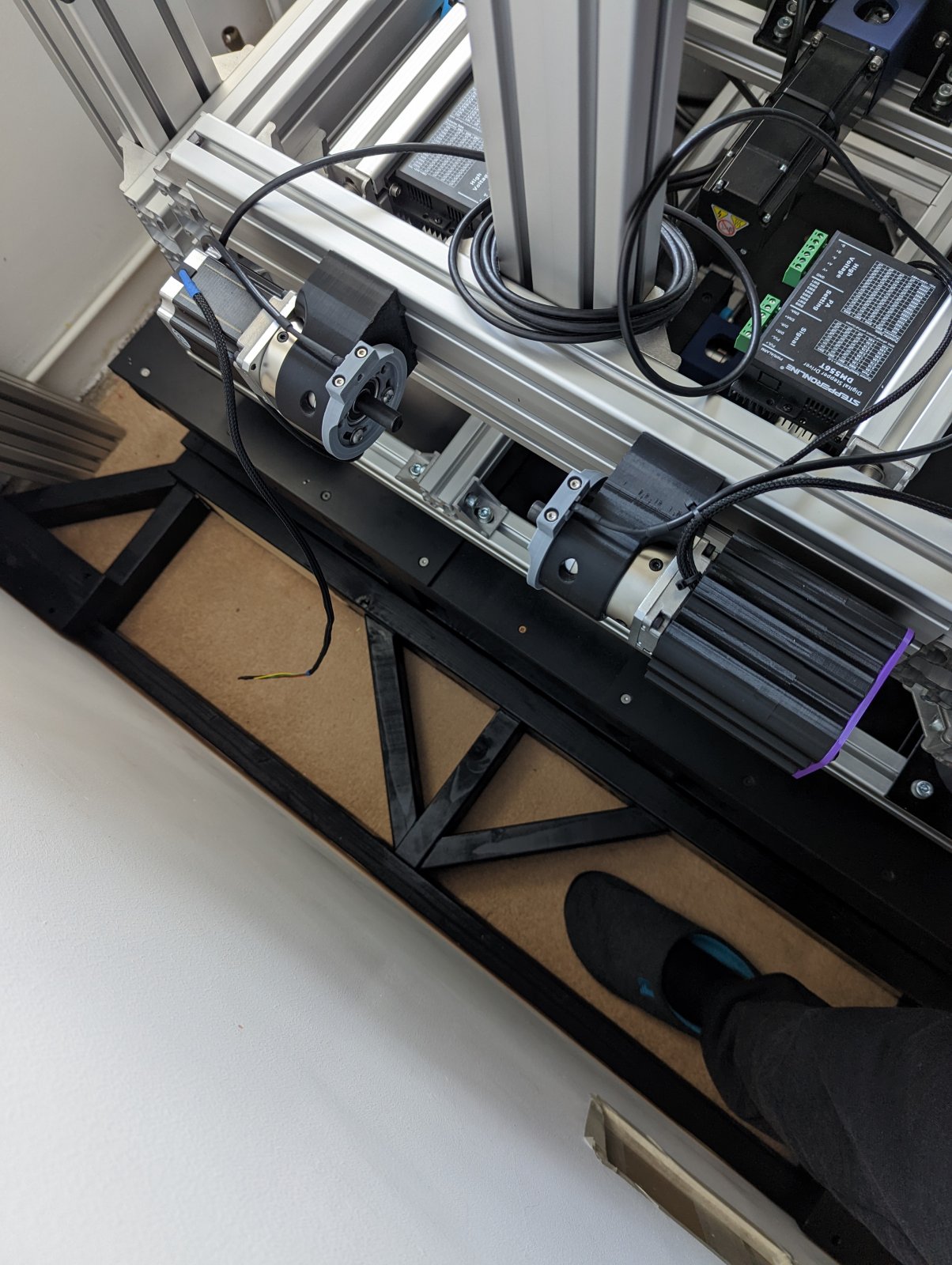

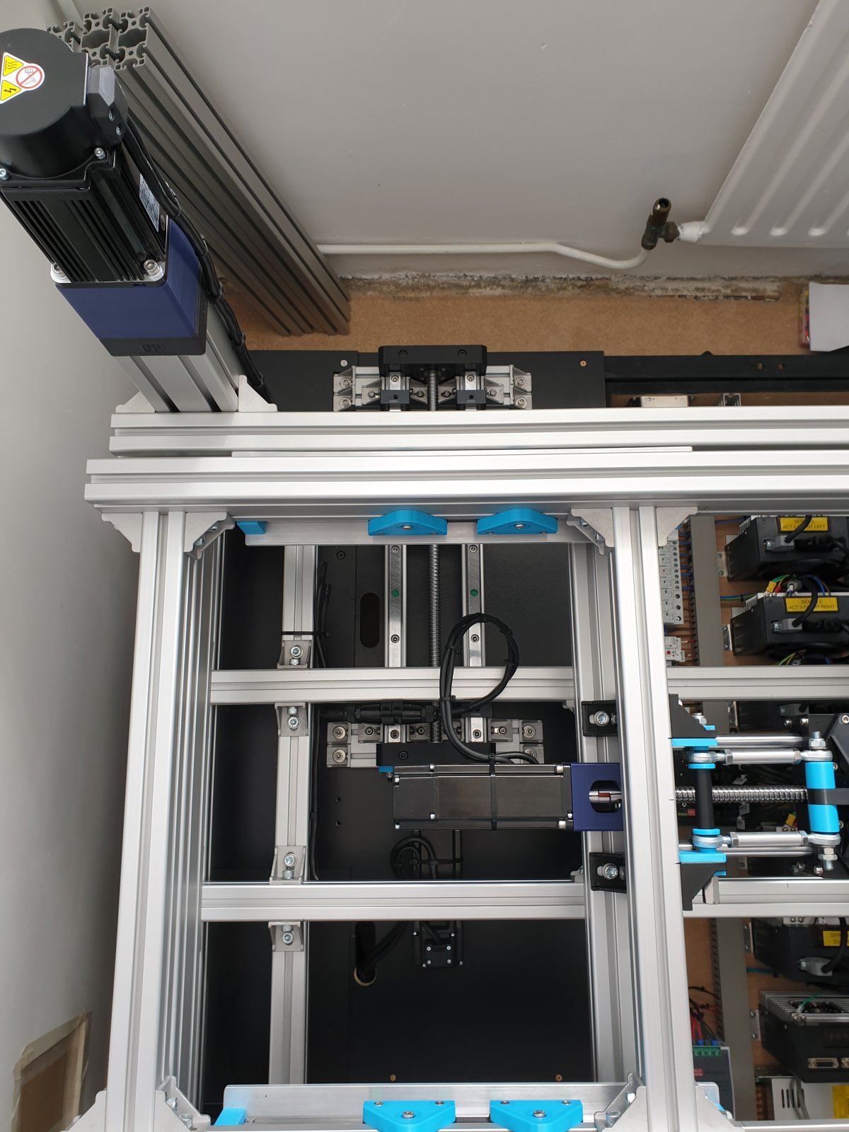

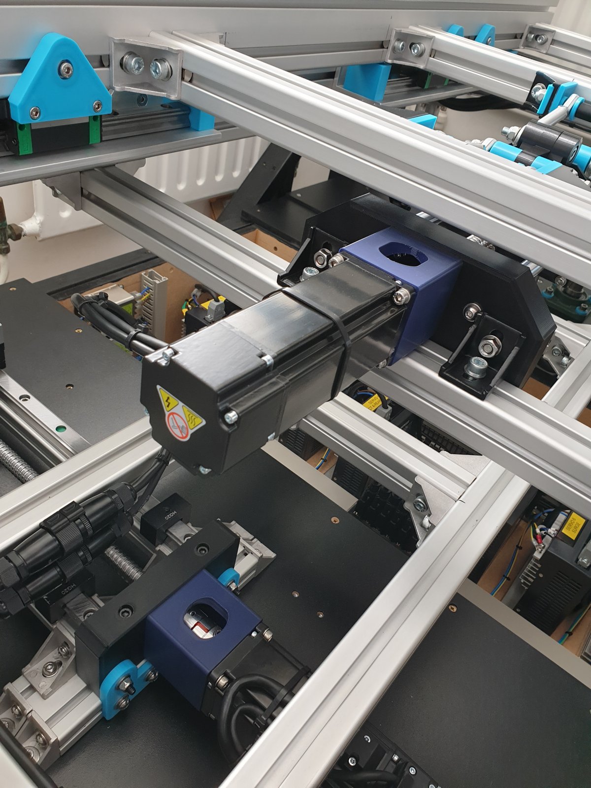

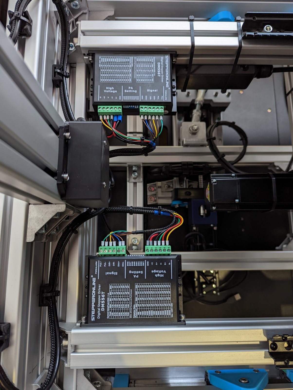

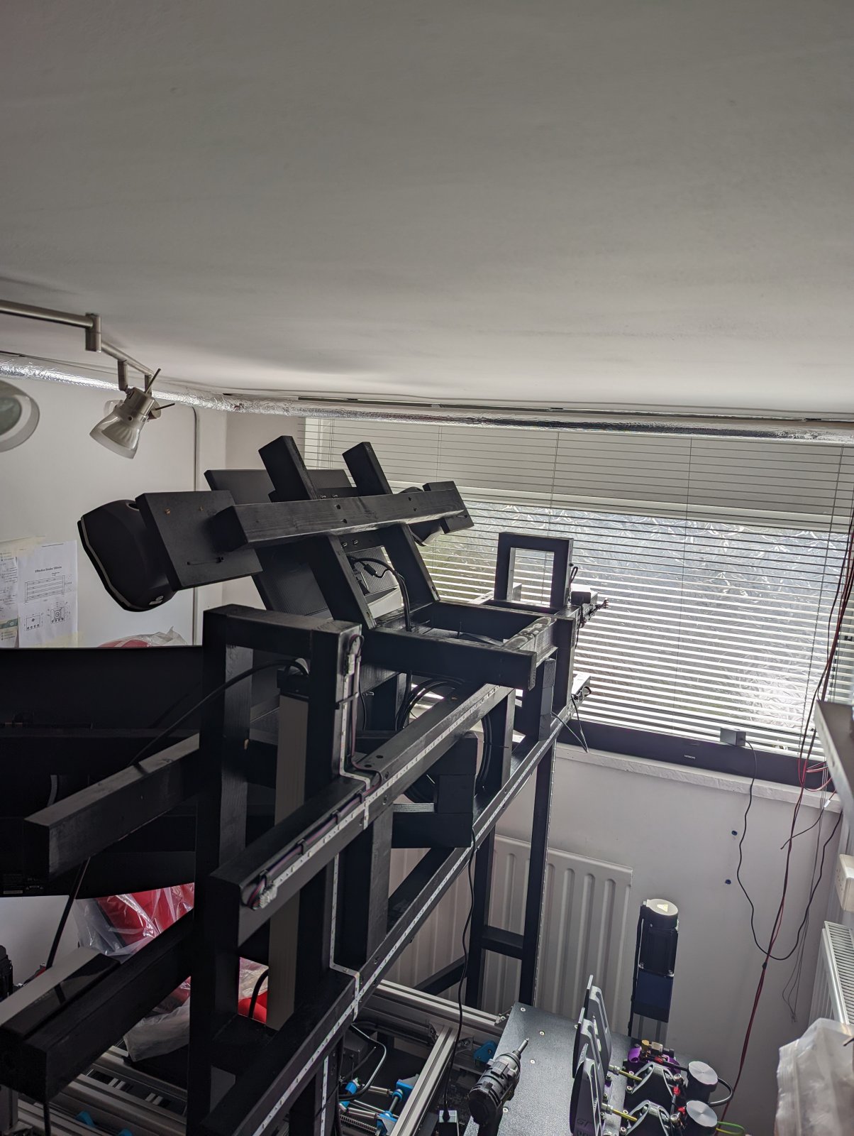

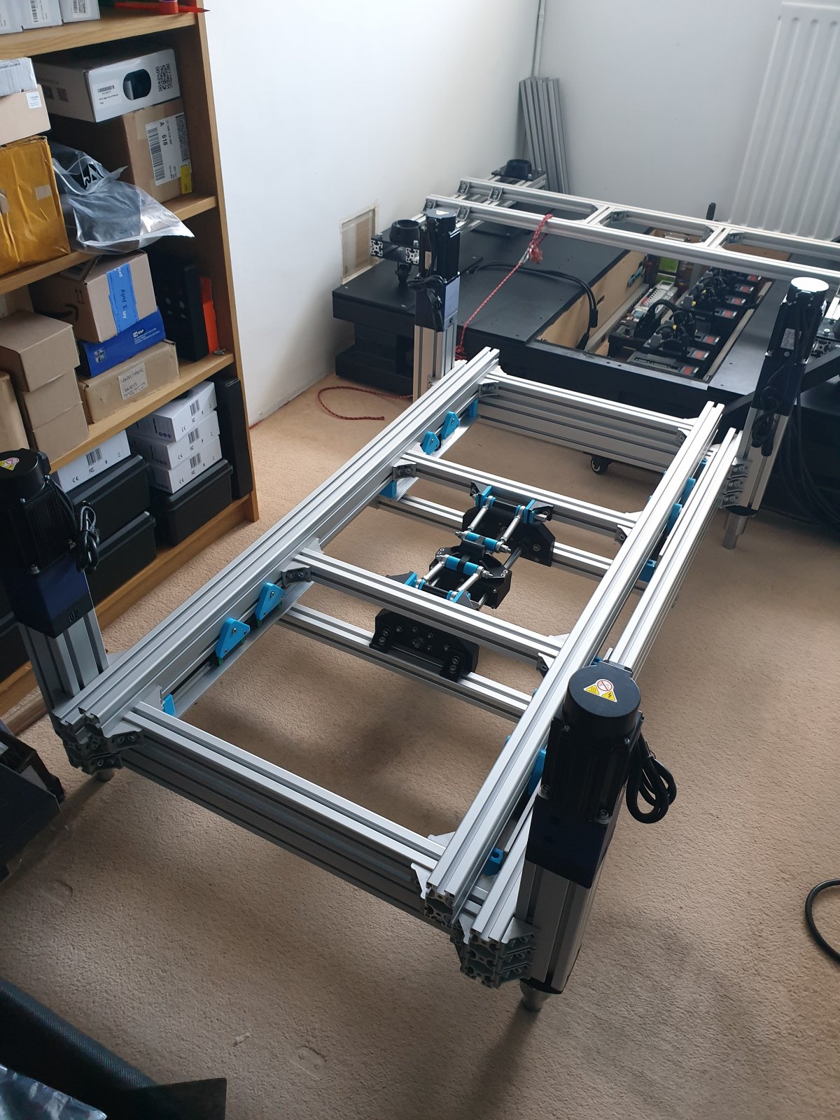

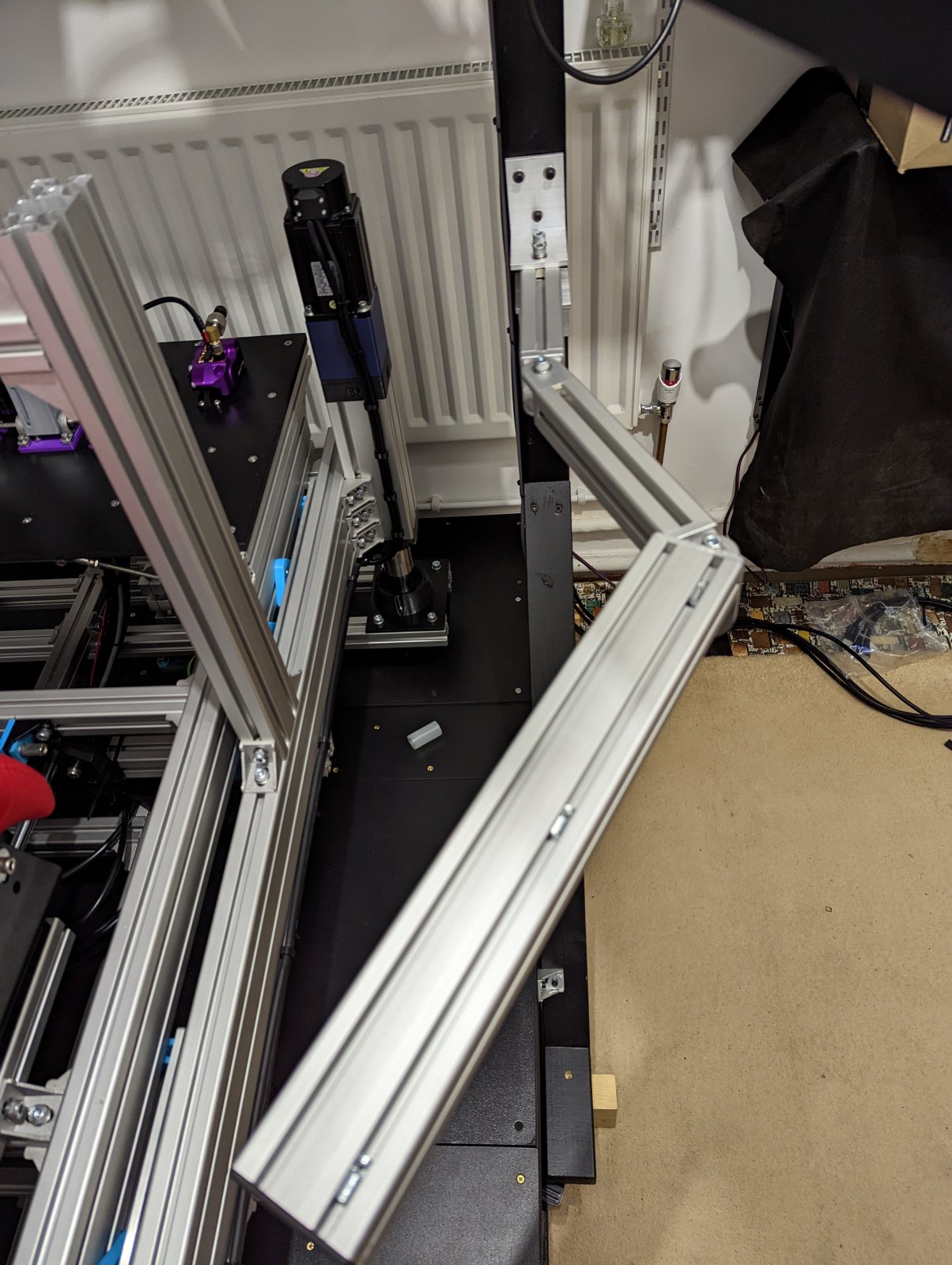

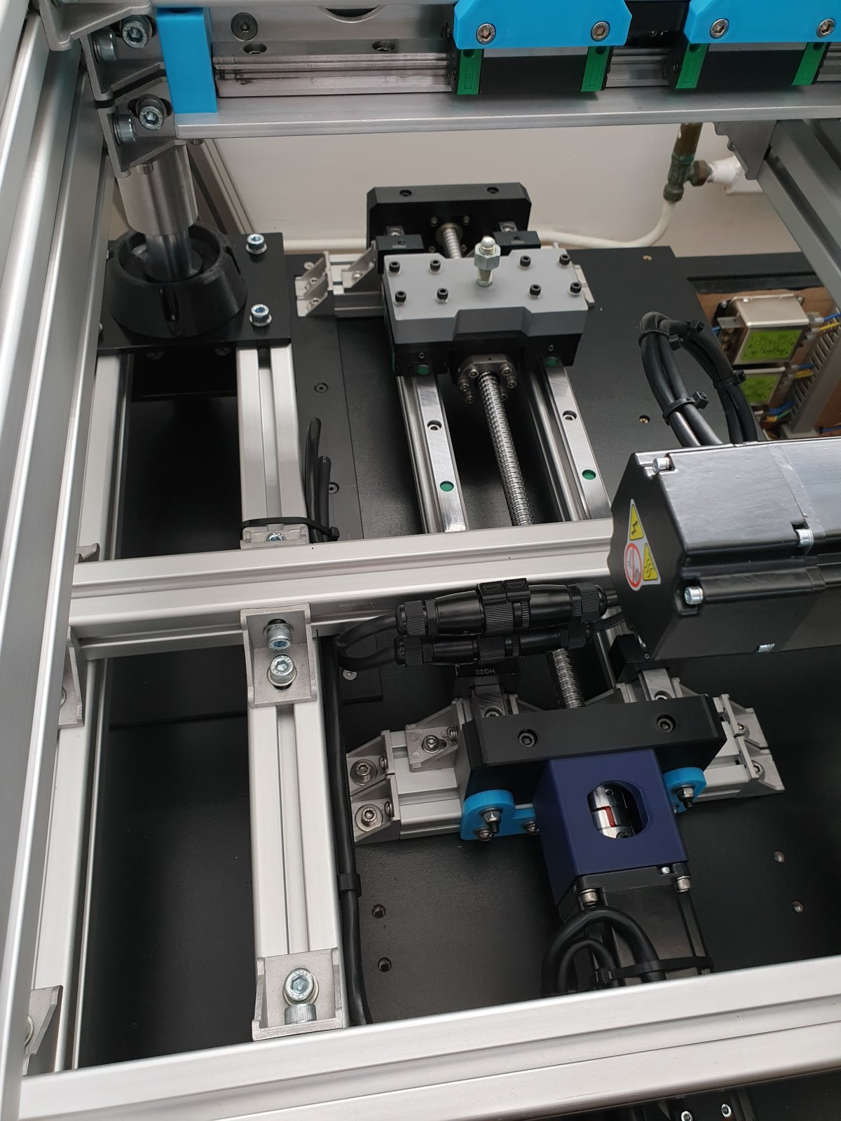

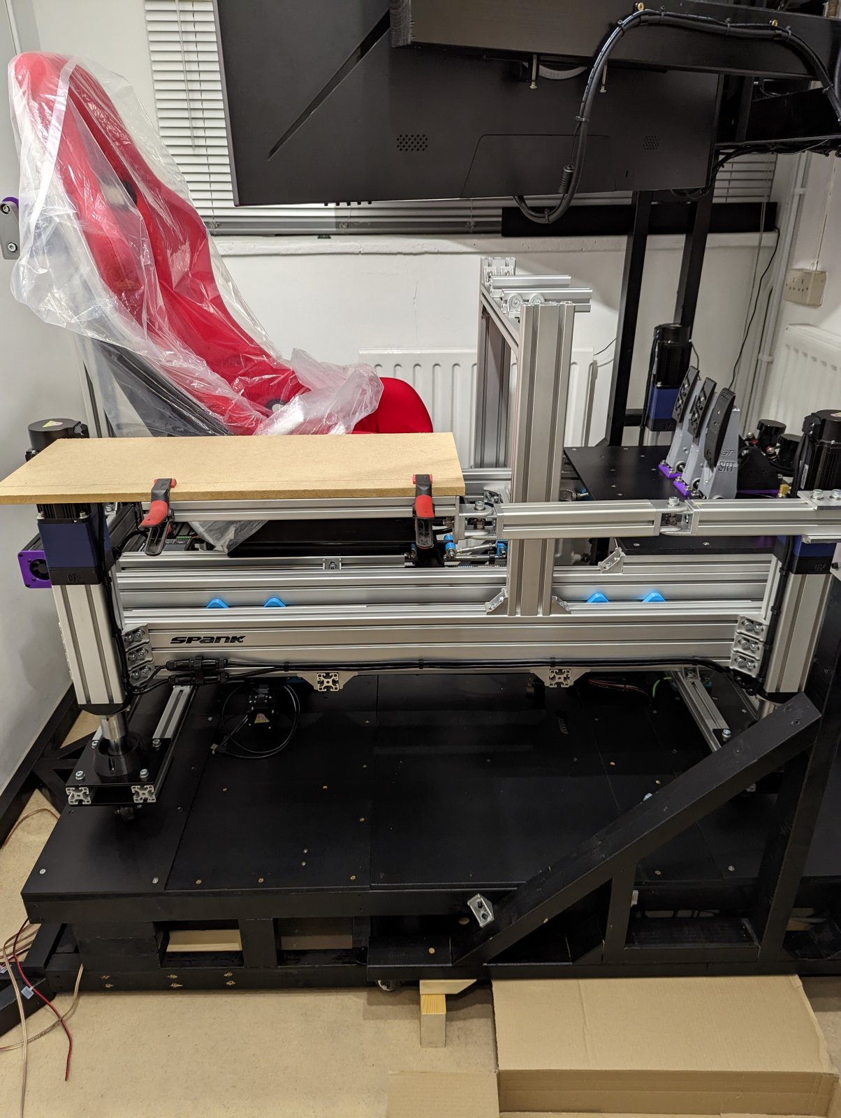

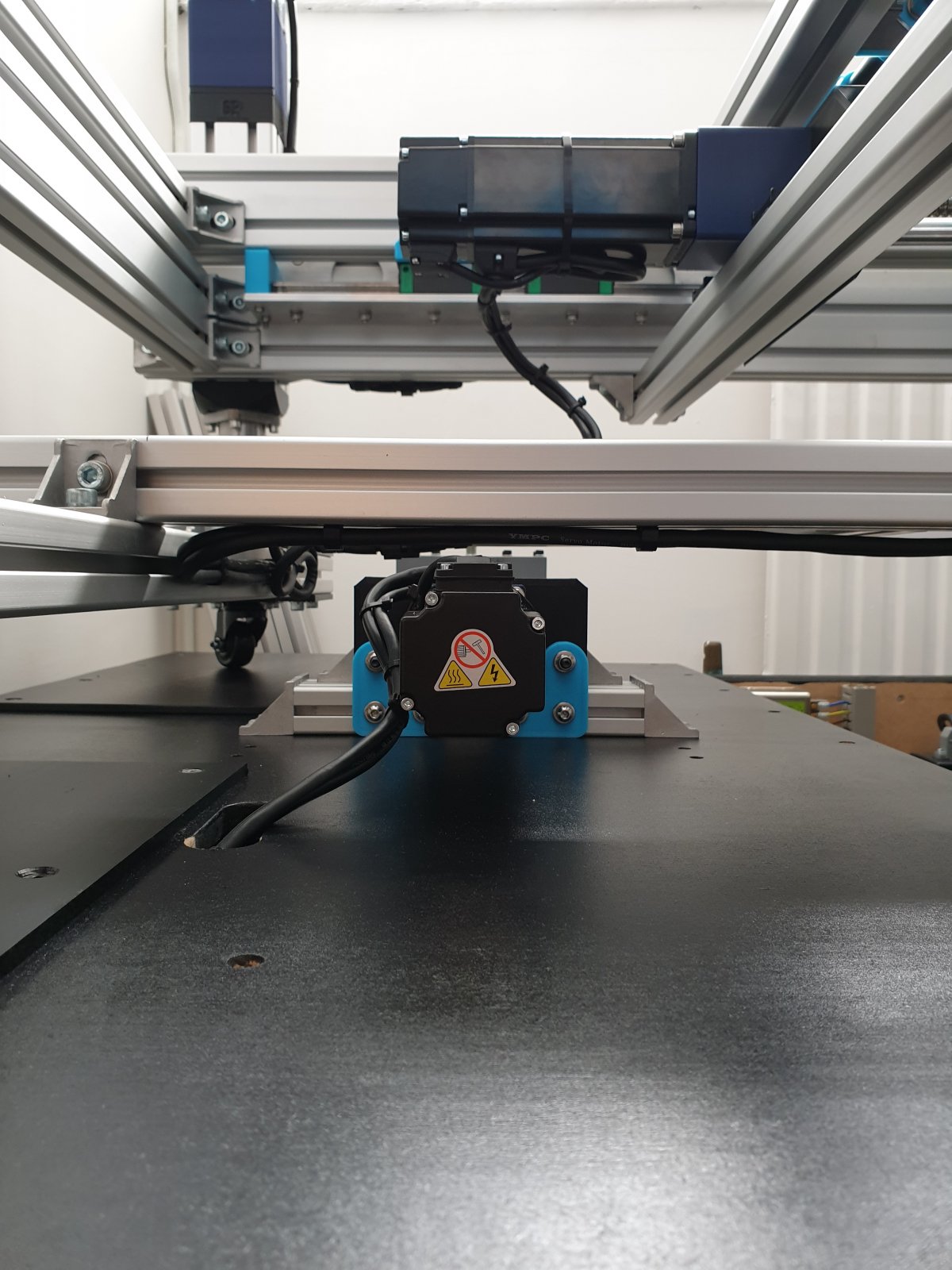

    Very very productive day today. Managed to install the TL axis (still need to make the conrod between TL subframe and drive assembly), added the servo for the surge , done a fair amount of cable management.

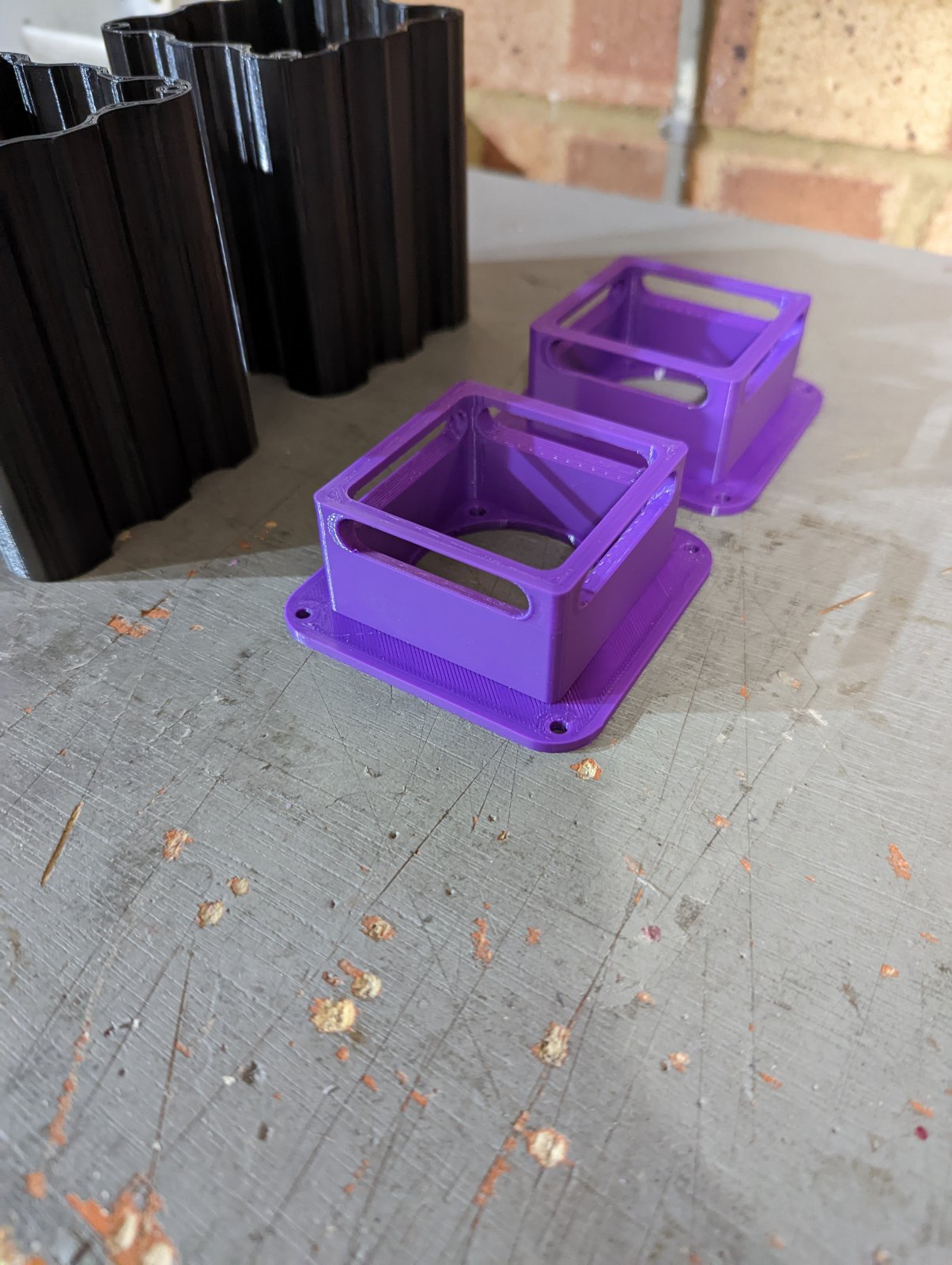

    It's been a long time since last post. Not much has been done but in the background i have designed and printed a lot of parts and figured out what else needs doing and what parts are required.

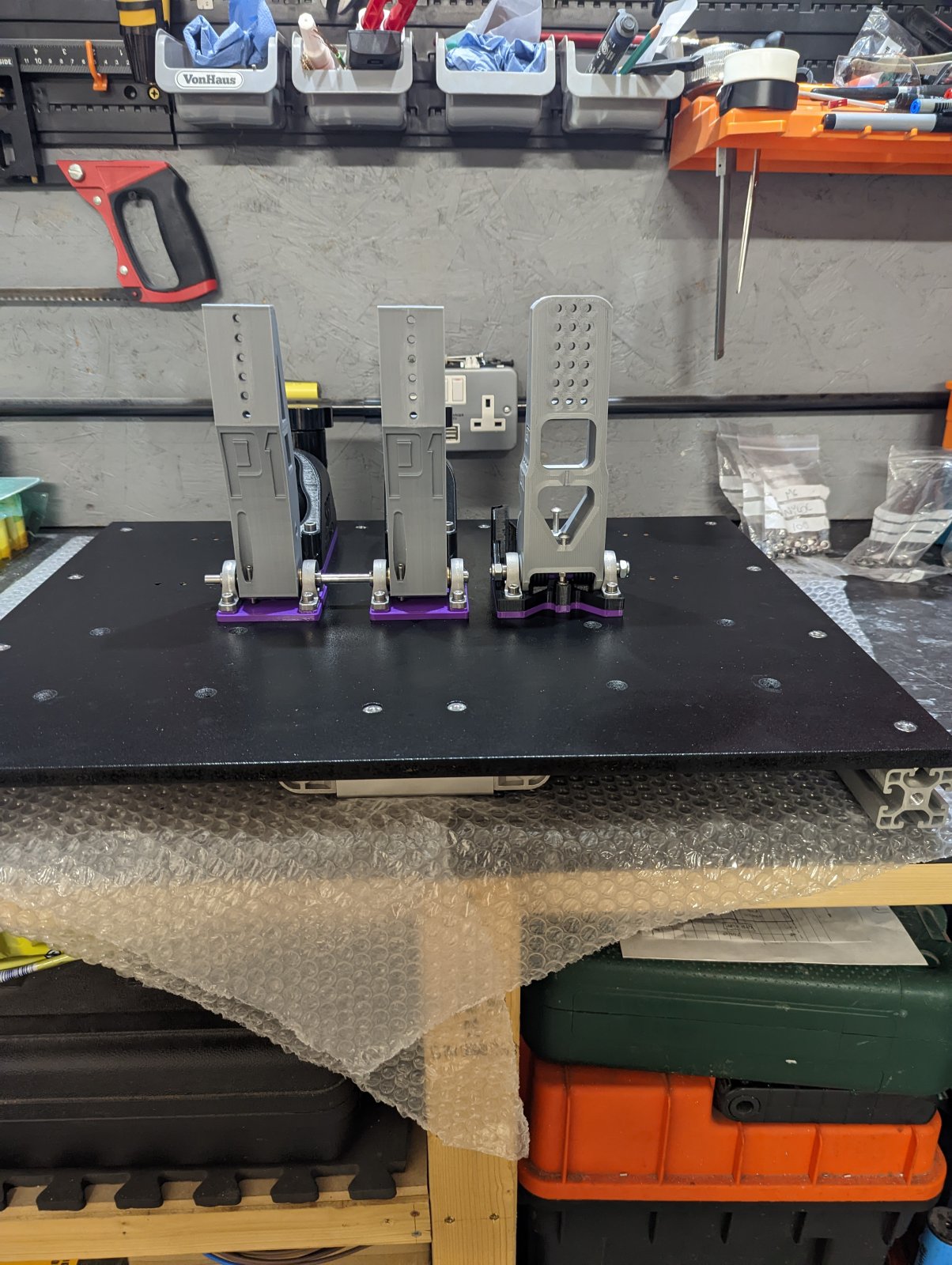

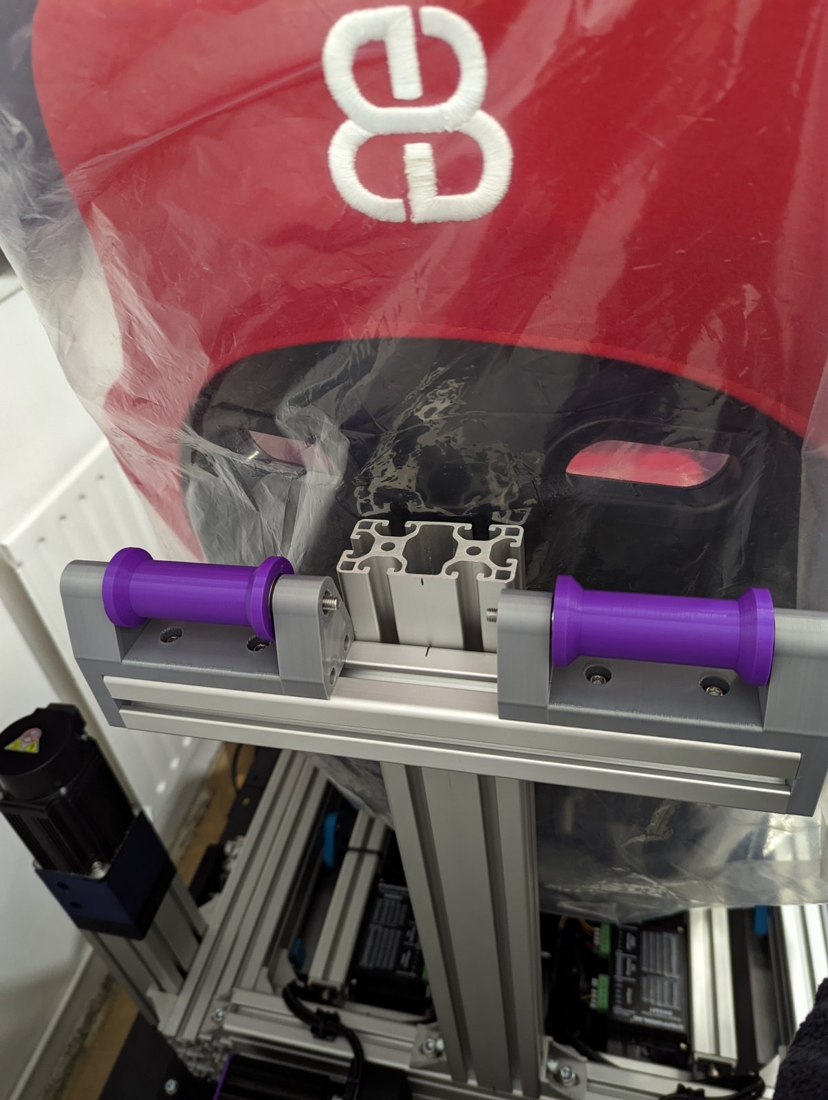

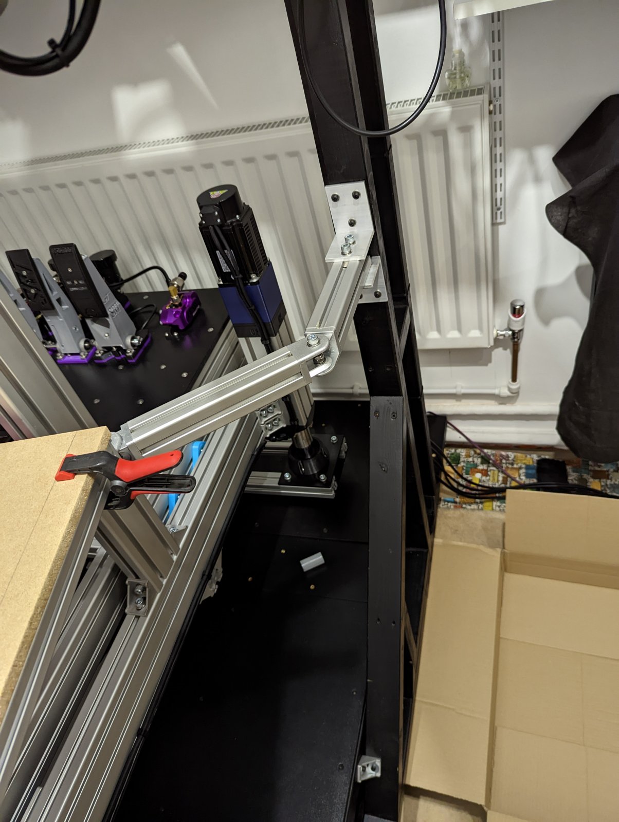

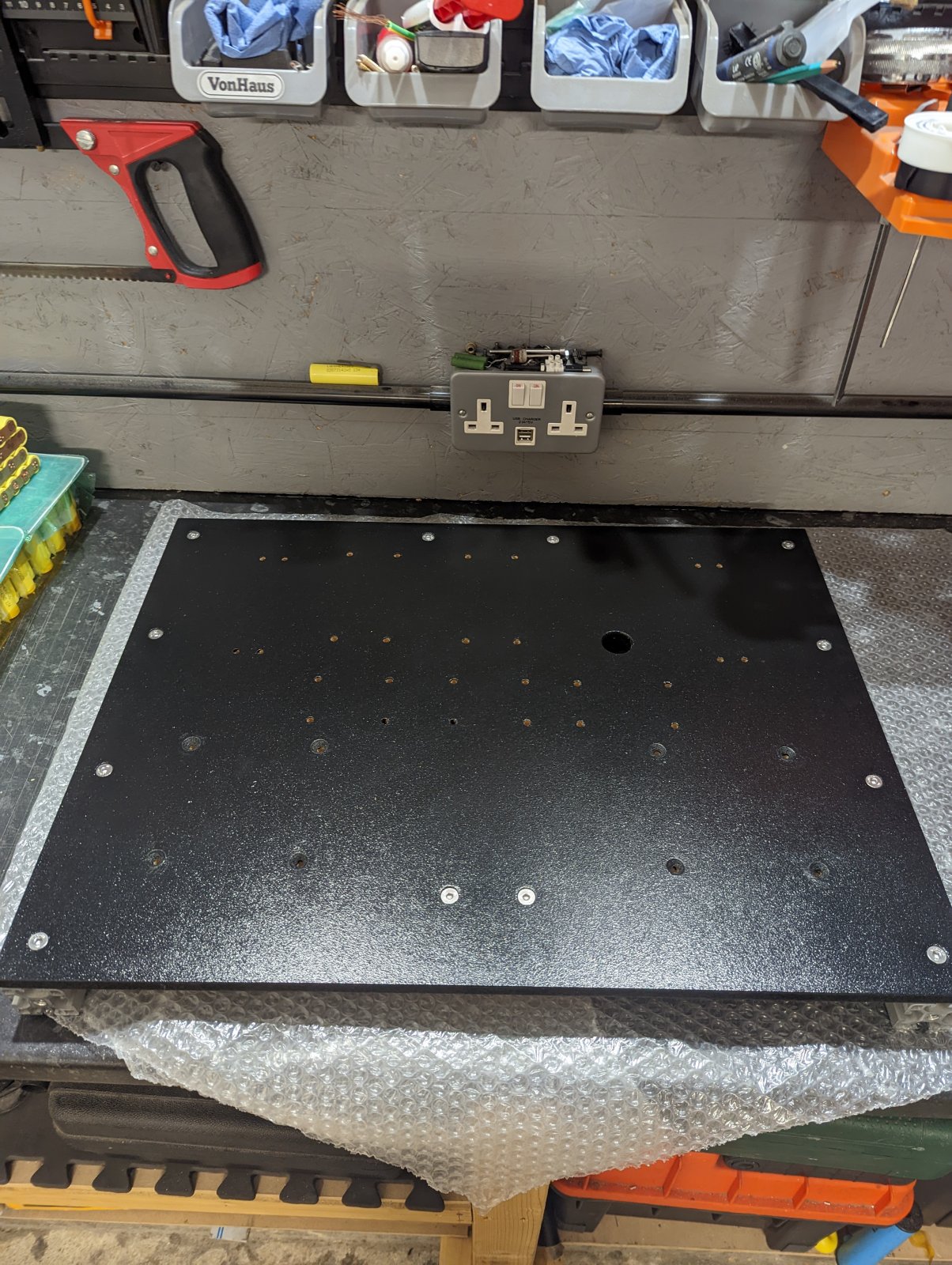

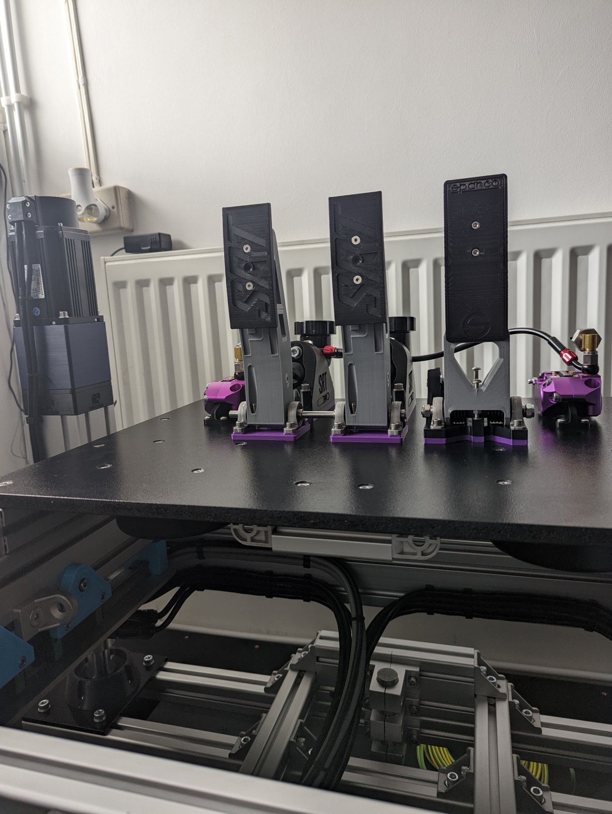

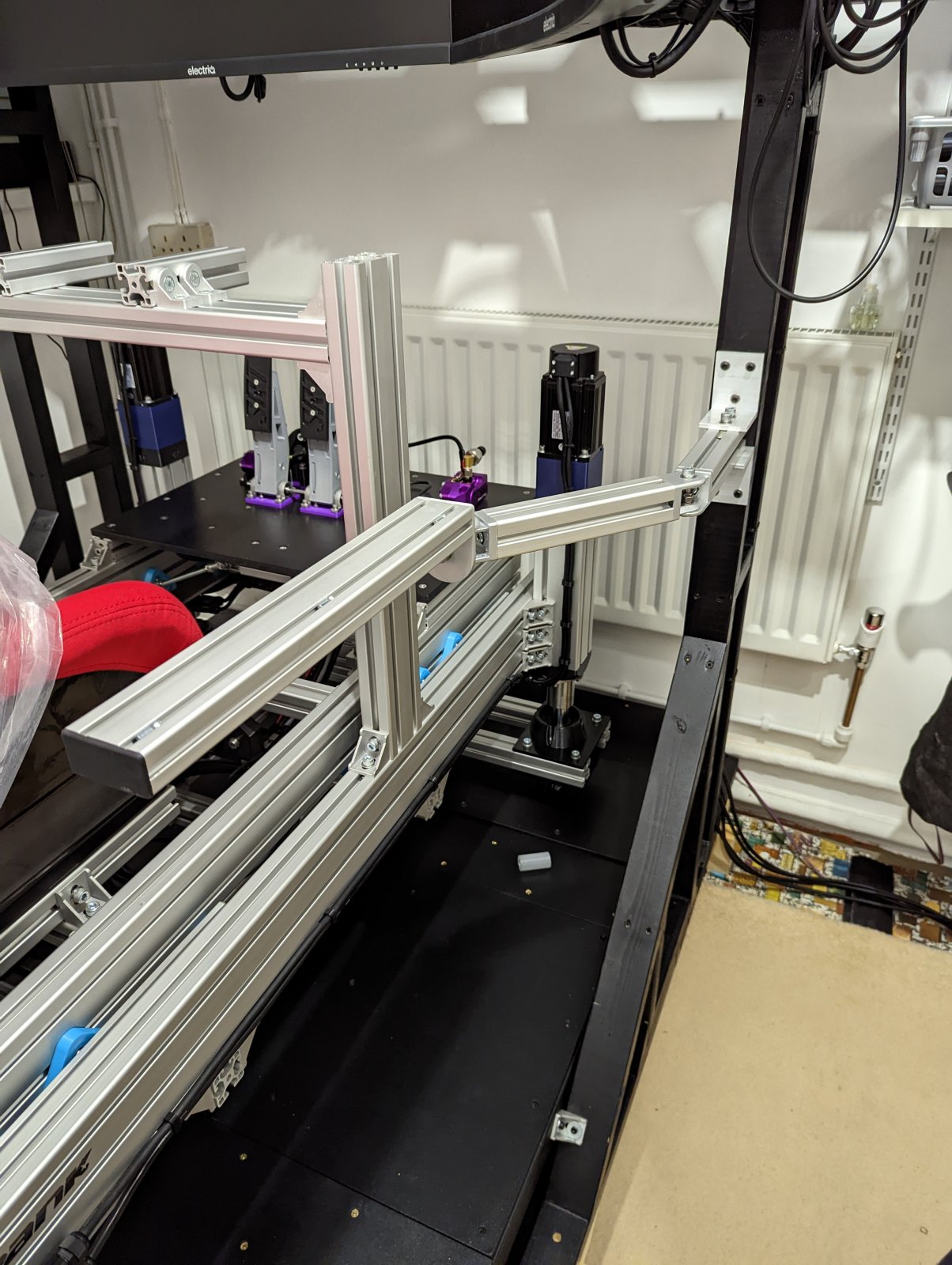

    4DOF

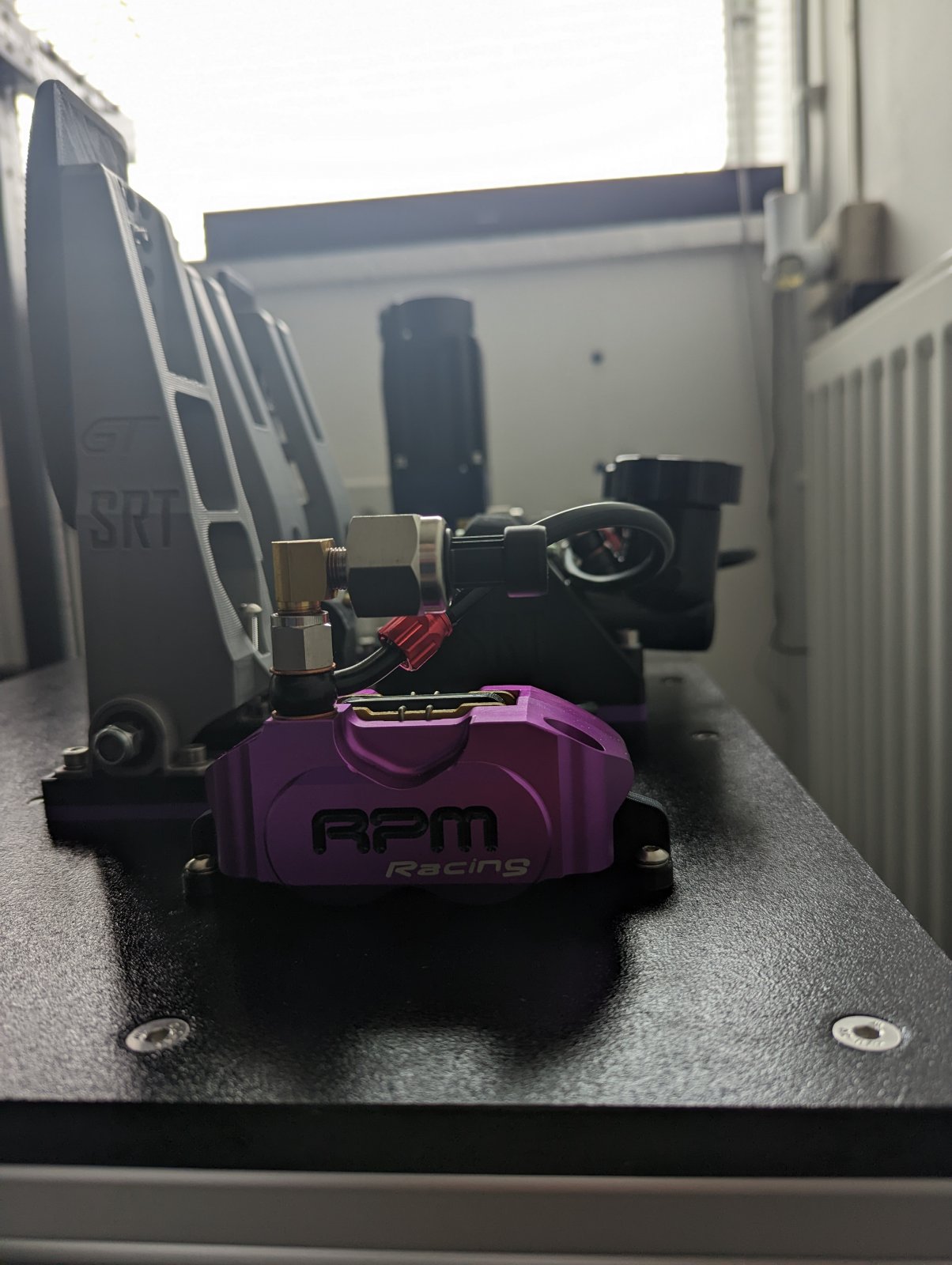

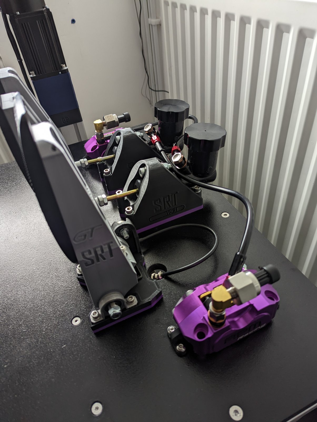

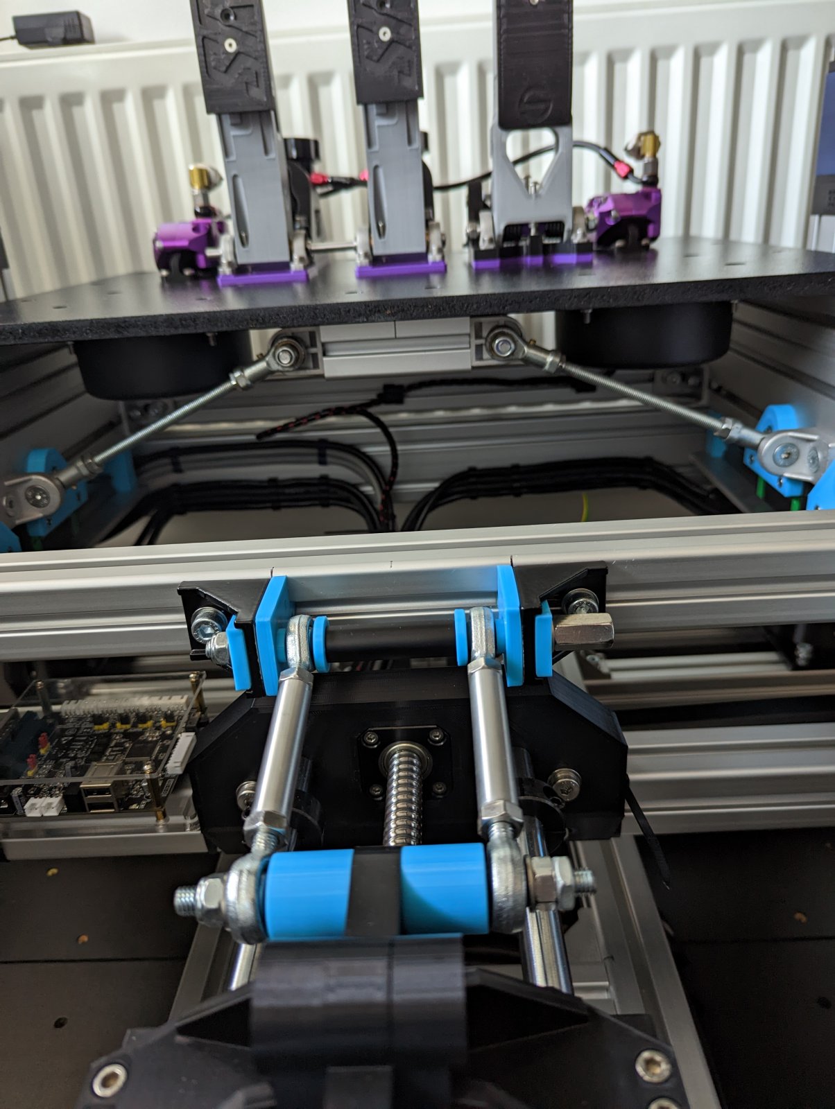

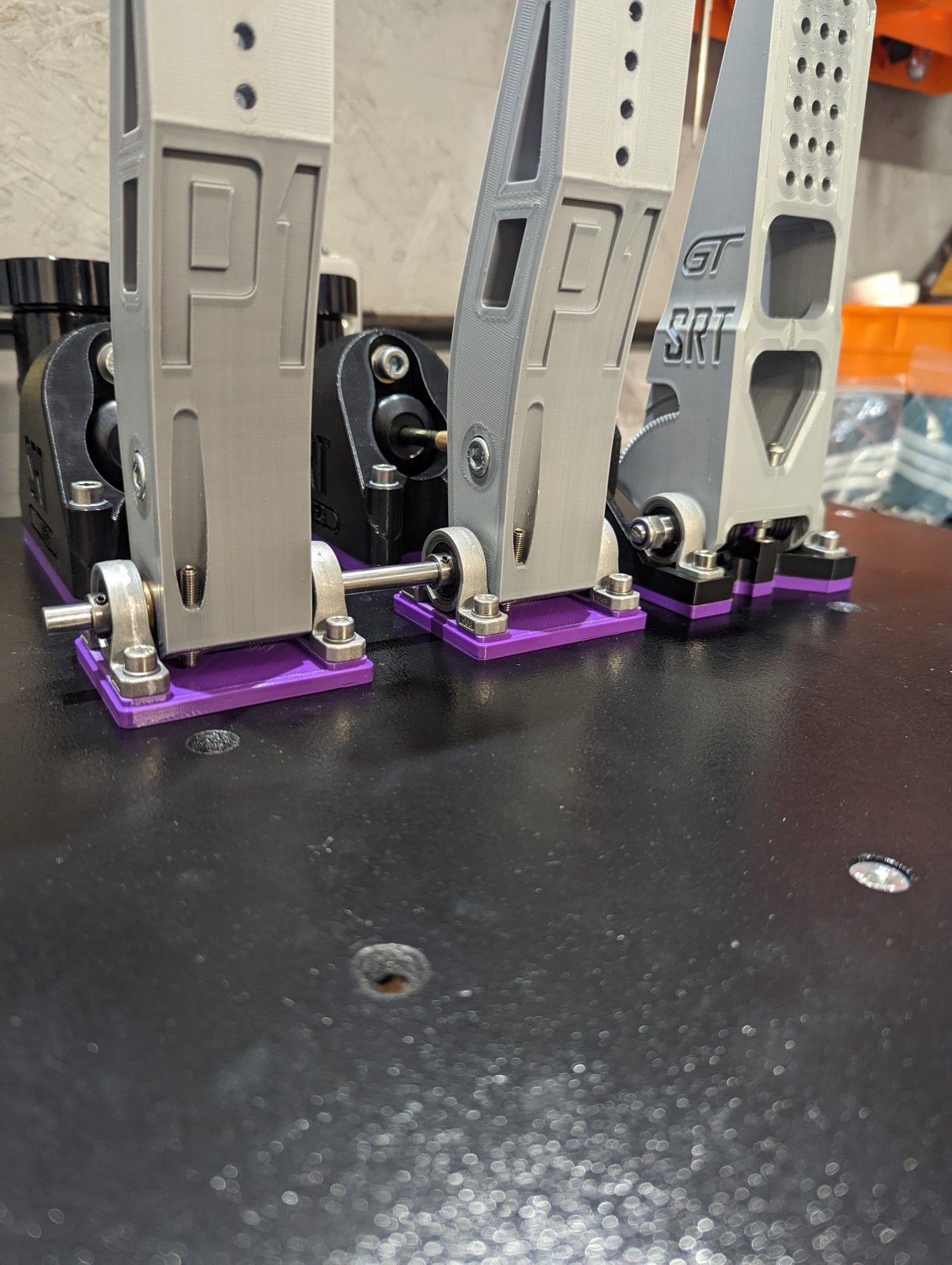

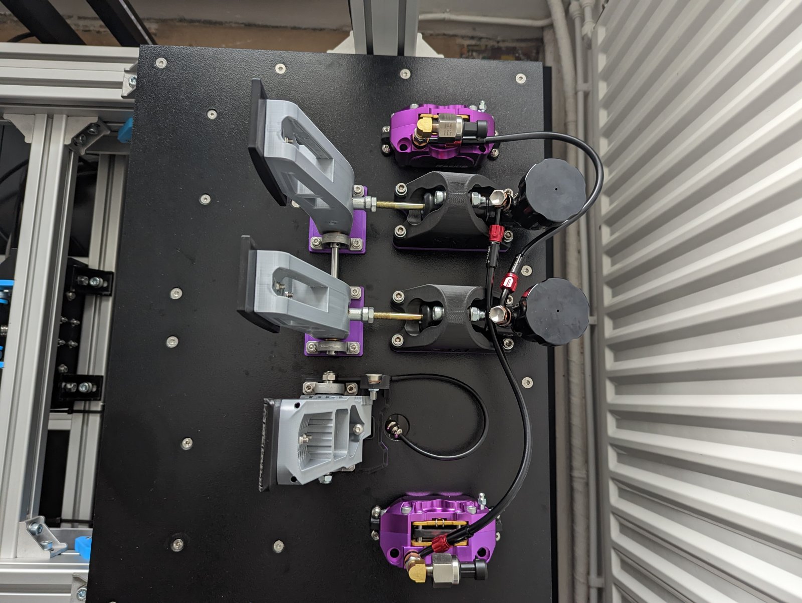

    This post is only related to the pedals deck and active harness tensioner which are not my designs , I have only added little improvements to suit my needs. Belt tensioner is the SimHub version of Wotever build and the pedals are SRT designed by Lebois.
    The belt tensioner is not fully finished yet as i need space to move around the rig at the back hence why is missing the lever arms and the harness itself. (Not much clearance at the back, but enough not to touch the wall when surge is fully slid back)

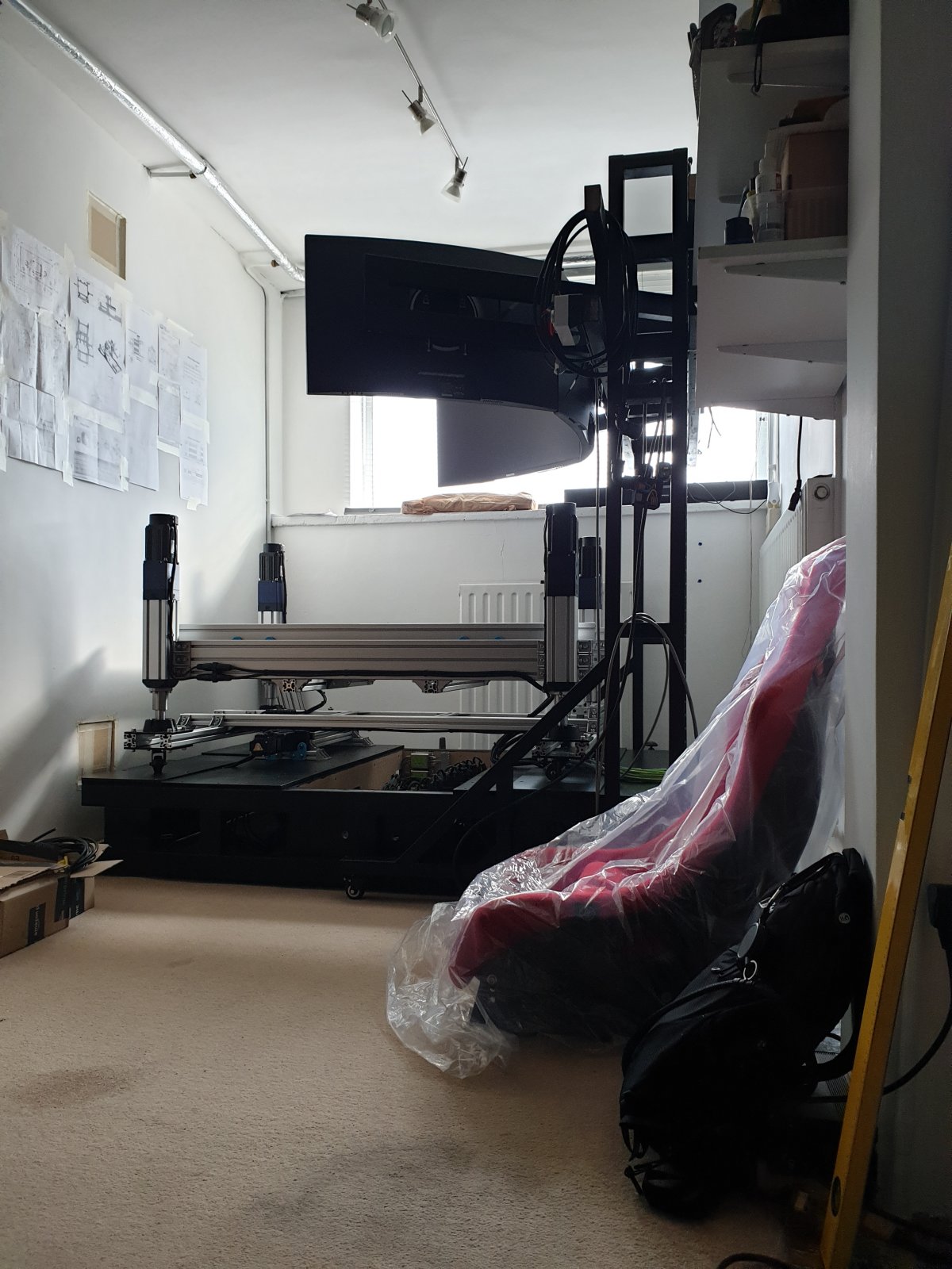

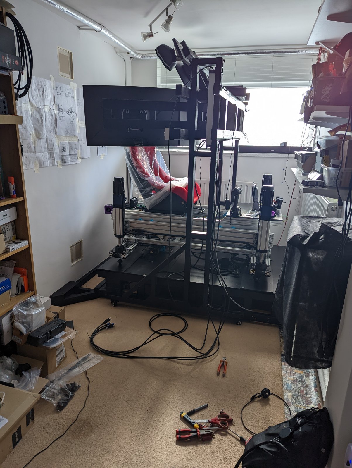

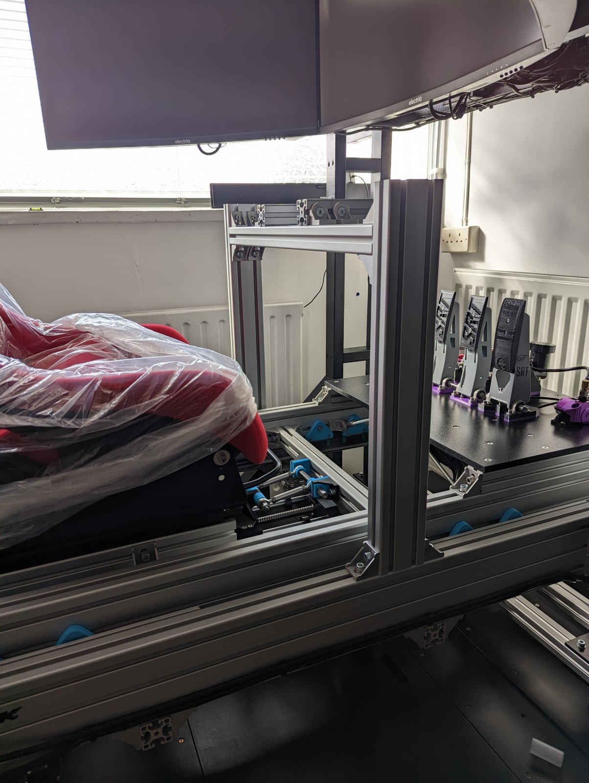

    Back to the rig full time and no stop until is fully finished. (I have a job too but i do not log that time, because i have a partner and kids which are the part of my "household time management" which is critical to when i finish this. )
    From here on, most of the work left is fitting all the the PC / USB hubs/ USB's in general, cables and cable management.

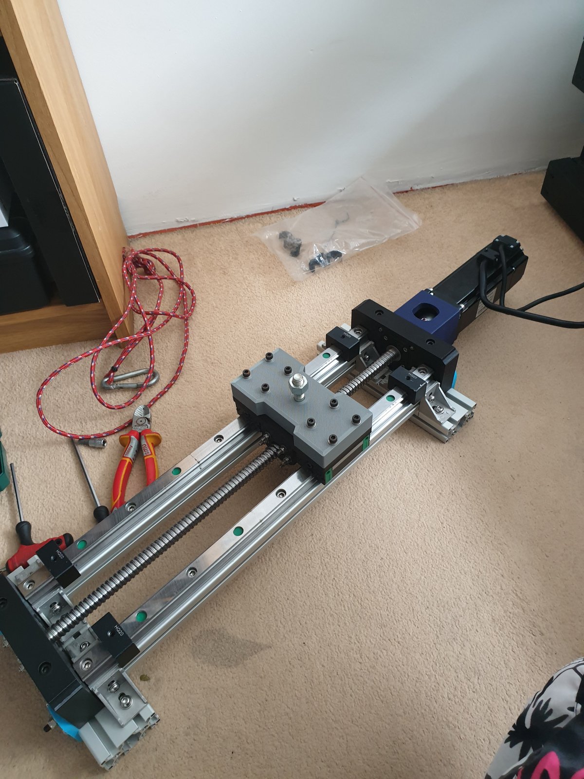

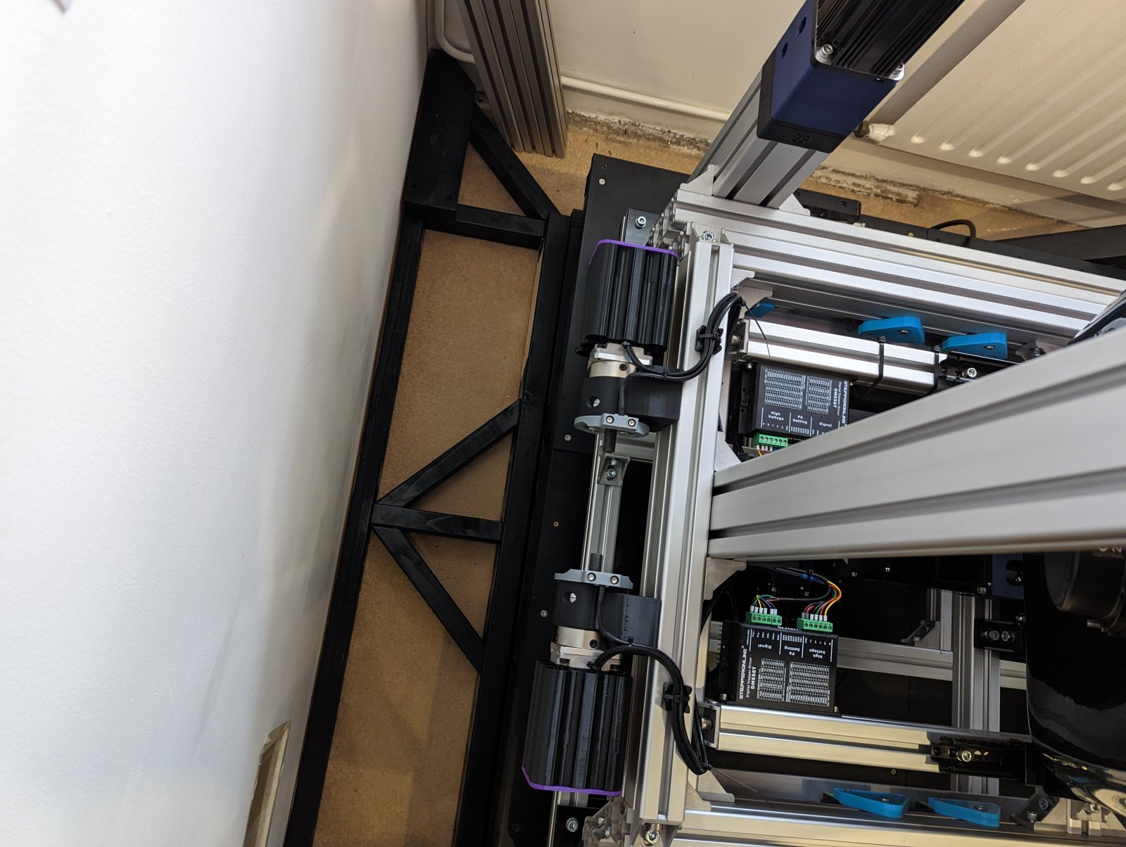

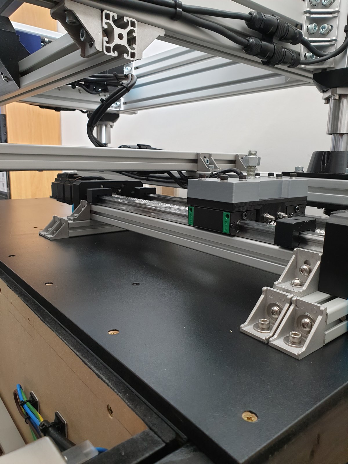

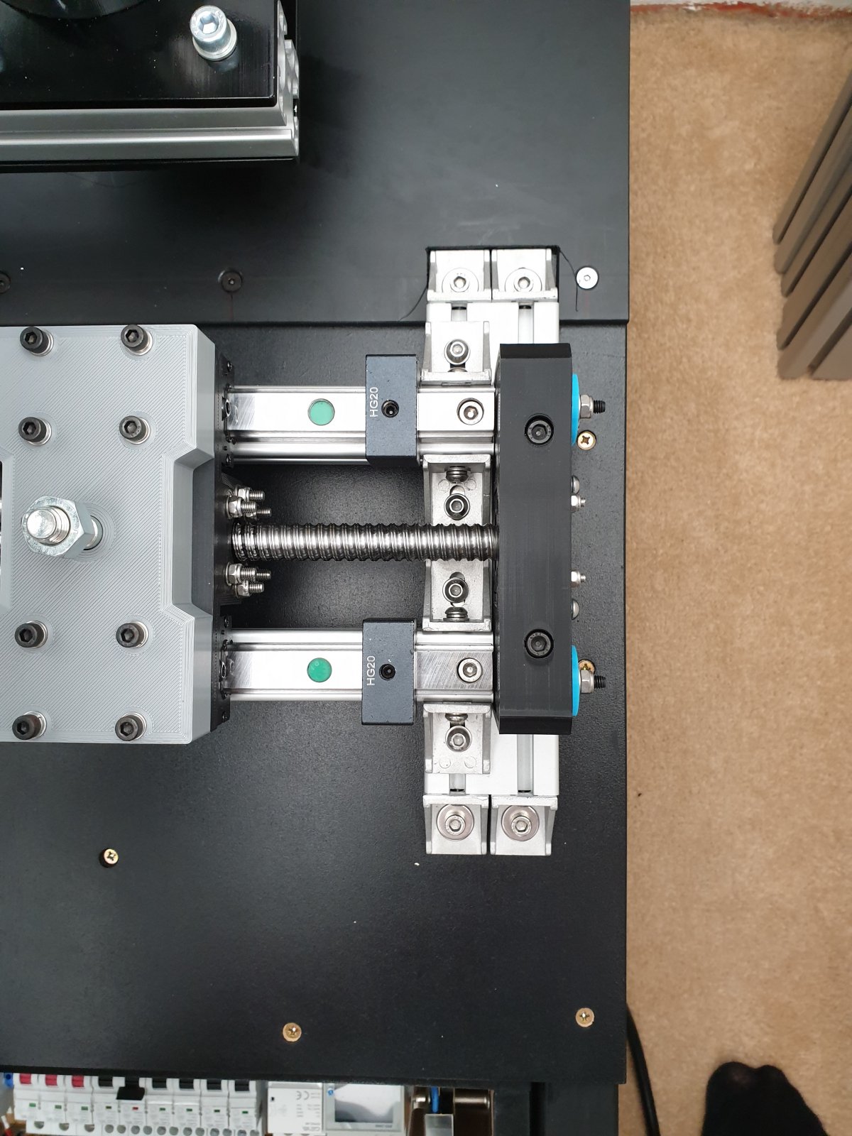

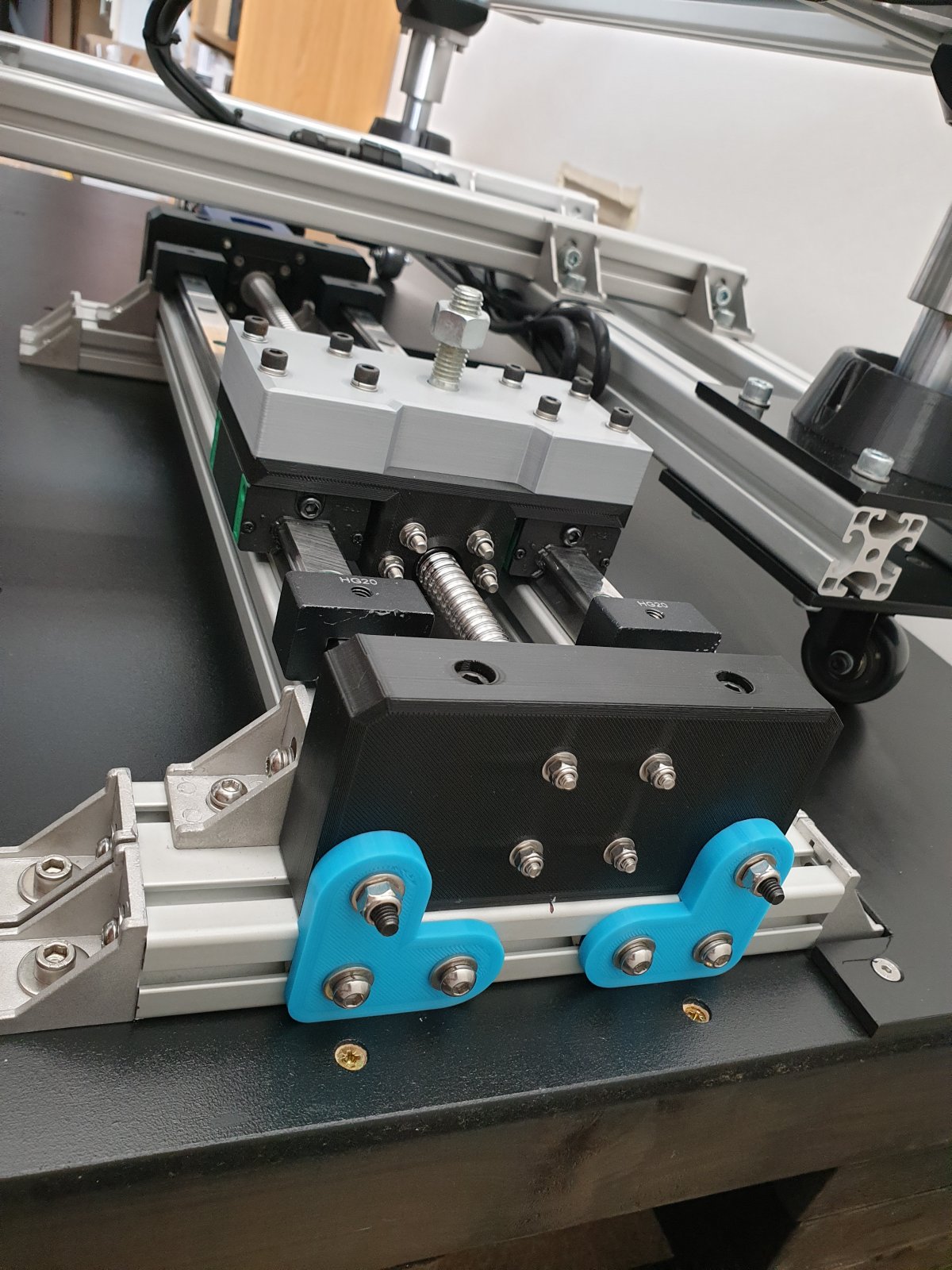

    @ins0mniac please see this post (ignore first 2 3 photos with the subframe) in which you can see how i designed my surge.
    If interested i can provide details on how i have done it and which parts i bought from Amy

    1. Very much.
    2. Yes, please. Bom would be most helpful
    (I got my SFX parts from Amy too =)

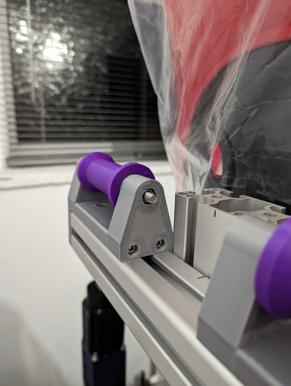

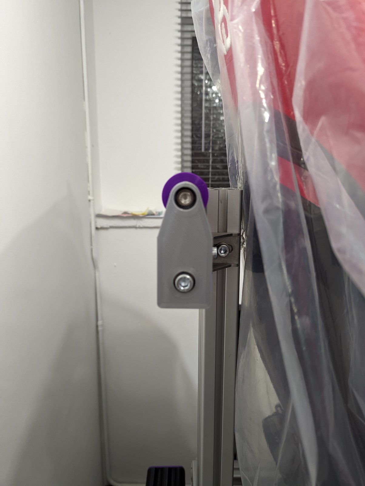

    Hi @MihaiDIY, I am planning to build something similar for surge, but am exploring options for mounting the rail guides to profiles. Originally planned to use L-brackets, but it would be much easier with your solution. Can you please share how strong the mounts are in the long run? Also what material you used? My experience tells me PLA should be enough printed flat to hold enough weight and it should work, but worth double-checking with your experience. My surge platform will be heavy, but yours is too. It will support a seatmover stile TL system that swivels only seat, actuator will be built-in the surge platform so we are looking at near to 200kg with rider.
    Thanks for the well documented build, it served me as great inspiration for my project!
