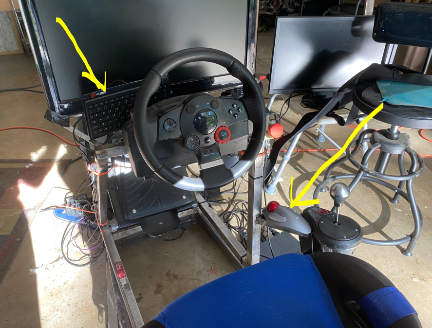

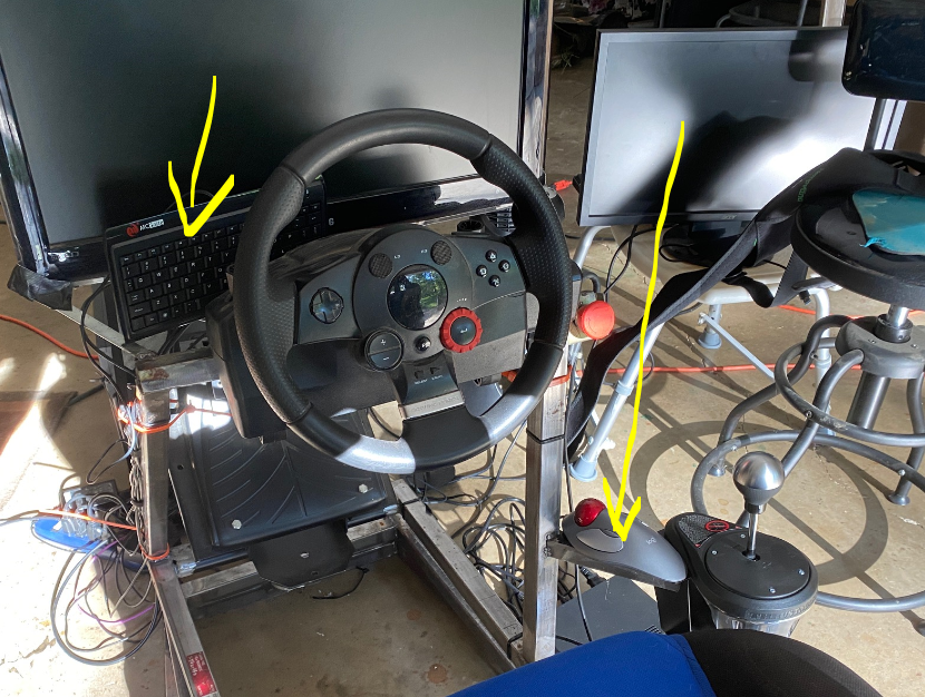

    Also, I did away with my old standard keyboard and mouse and went with a TracBall and a mini keyboard.
    I still need to fabricate a small plate to mount the Mini keyboard. But things are progressing and every drive is getting more fun and better!

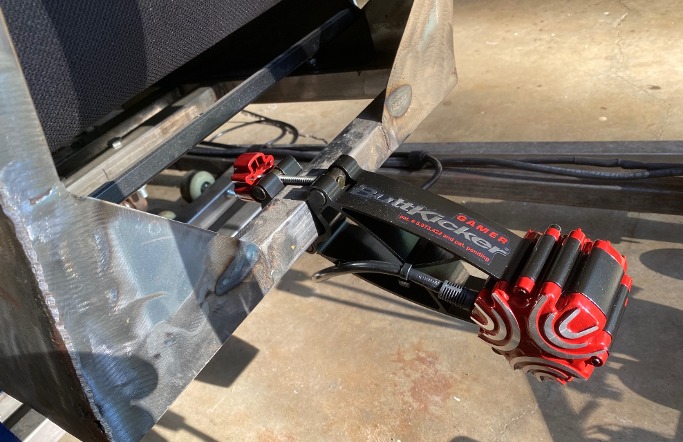

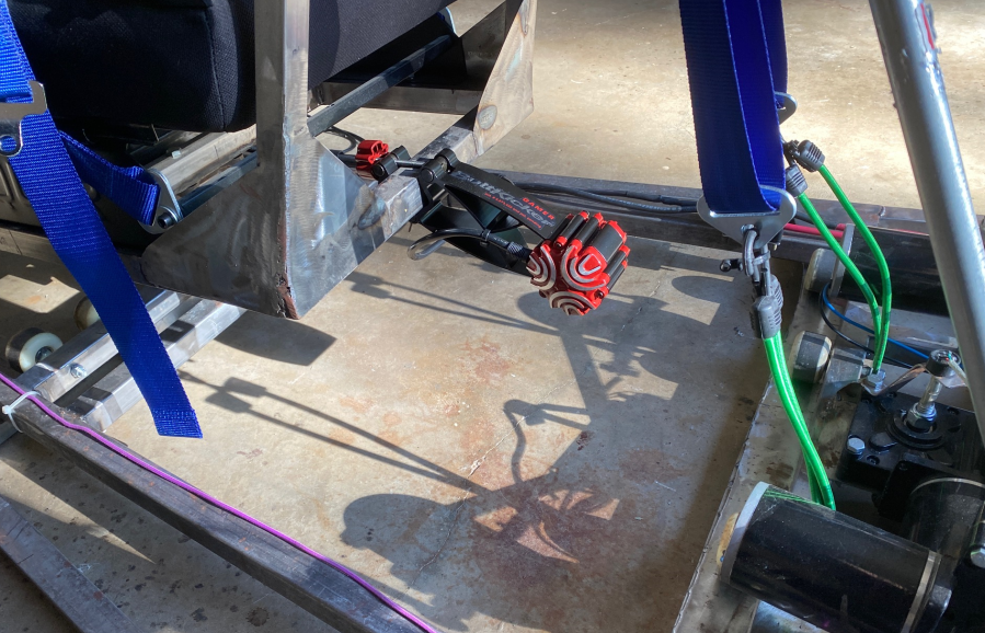

    I did add the butt kicker gamer to the back of the rig and used SIMHub to get it working with Asetto Corsa. So far it's great and I have another of them 'on back order' to give me two. Either front to back or left and right..
    We will see how much a difference 2 will do. Probably awesome.. FYI I turned on the rig last weekend to take some laps and forgot to turn on the buttkicker.. Something was missing, for sure.. Duh, forgot to turn it on! Try one if you have $160 US.. they defiantly add that extra vibration and texture. Here's a Pic of the mounted device.
    also added the mini-keyboard and trackball setup to replace the full size keyboard and mouse.
    So if anyone has advice setting up two butt kickers (either front to back or side to side) let me know

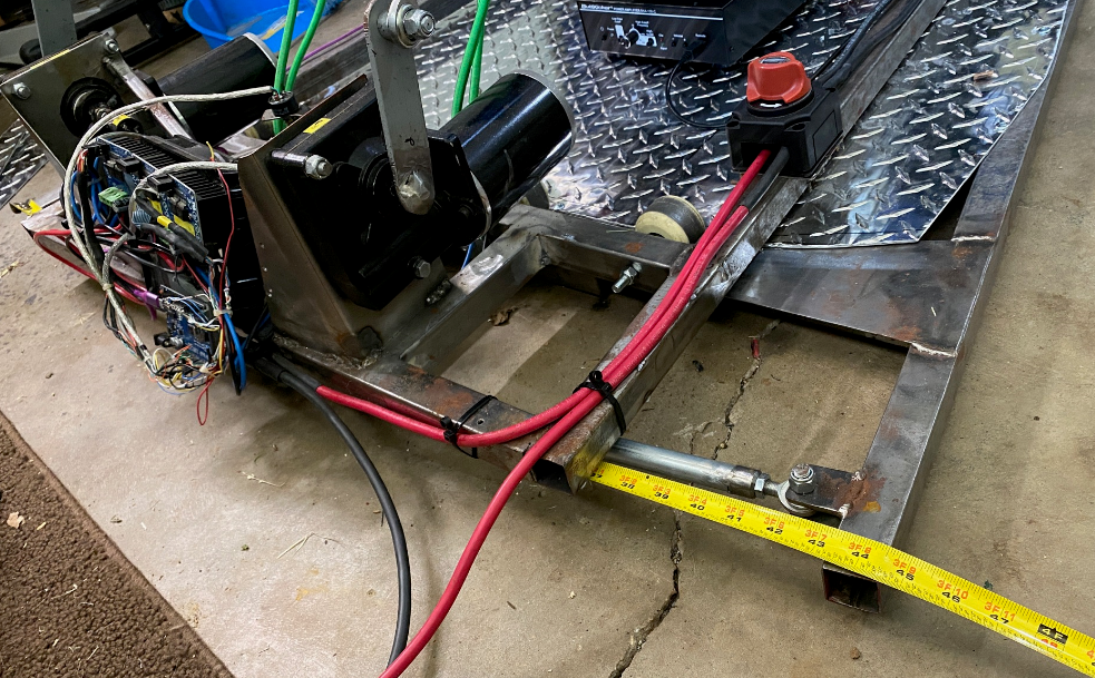

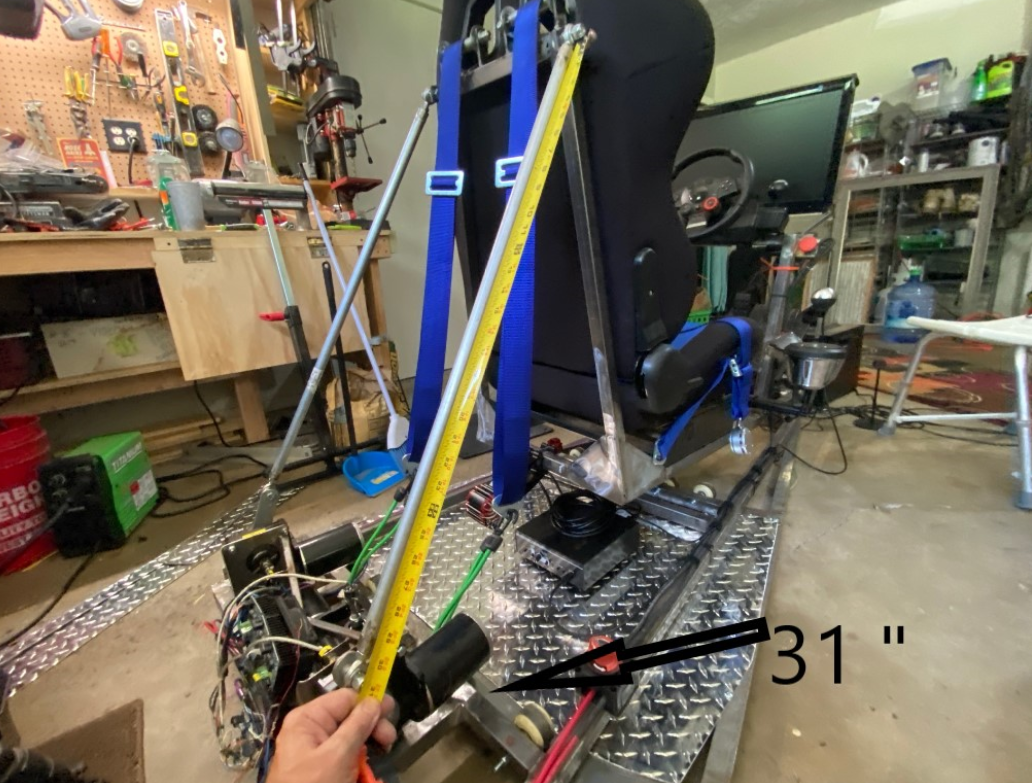

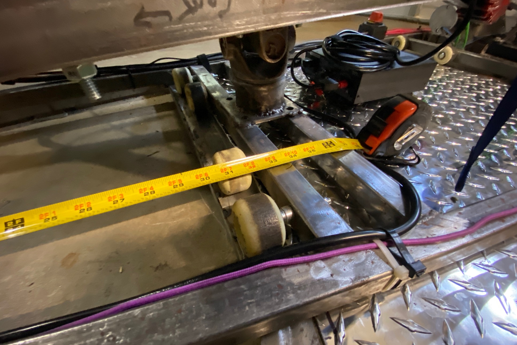

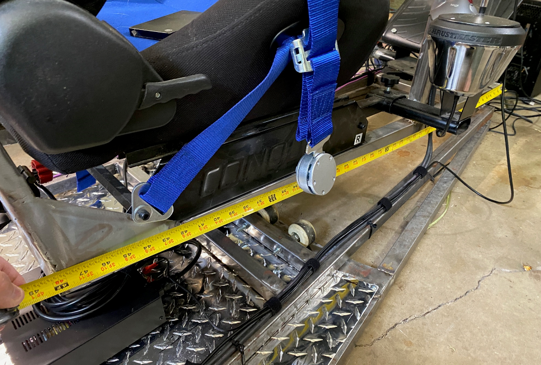

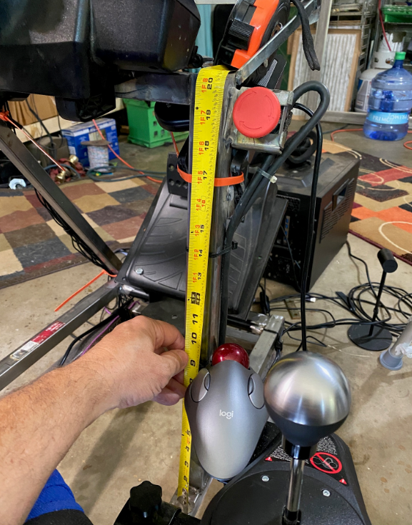

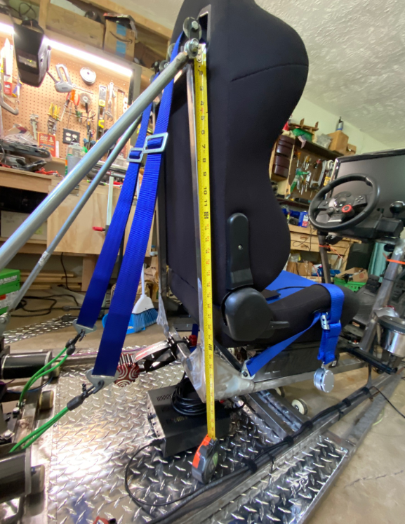

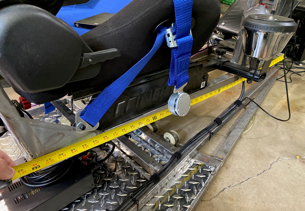

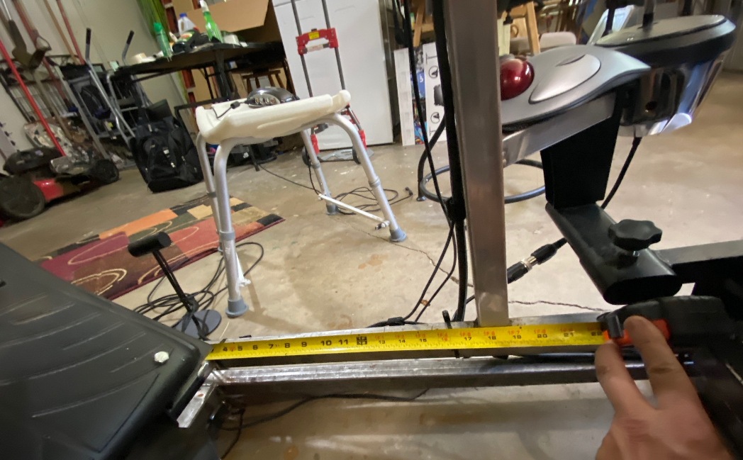

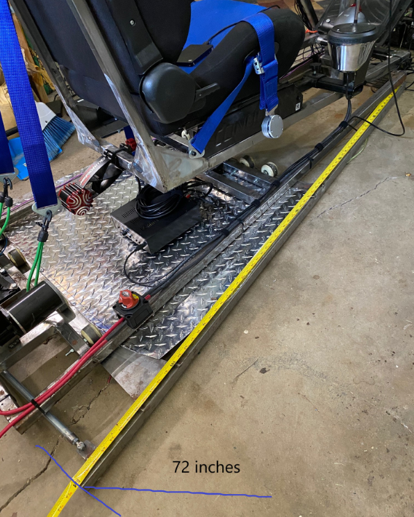

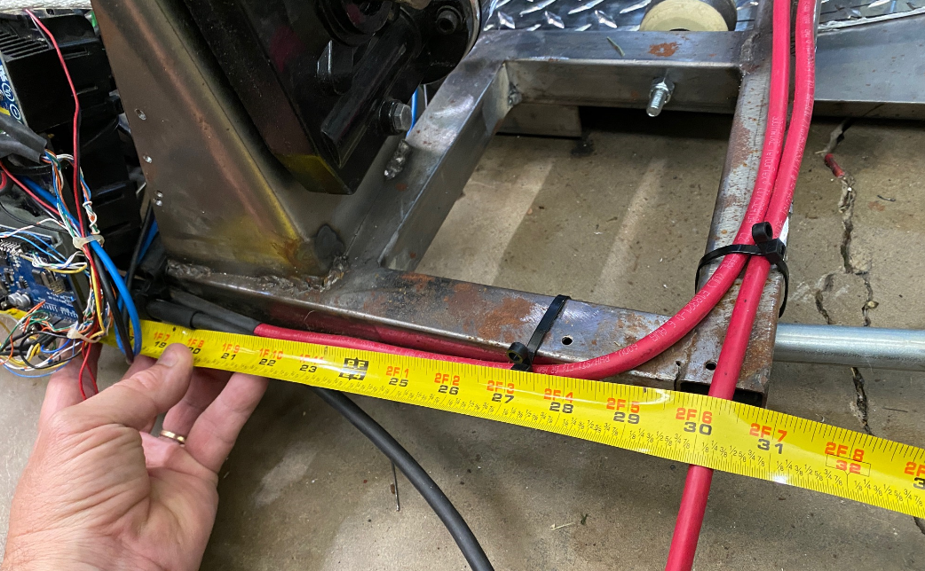

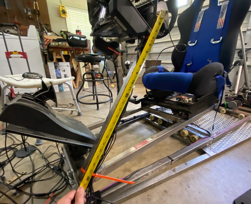

    Thanks I took some photos for reference
    I used 6 foot (72") sections of 1 1/2 square tubing to run the length of the bottom frame and the Traction loss frame. All frames are 17" in the front.
    The BASE frame is 44 1/2 inch wide at the rear and 17 inches wide in the front.
    The Middle Frame (Traction loss frame) is also 72 inches long, with 31 inches wide at the rear and also 17 inches wide in the front
    I am seeing some 'surface rust' especially in this photo.. I still need to take it apart, paint the metal sections and reassemble!! The rear of the Traction Loss frame is 31 inches, the front of the TL frame is 17 inches.
    On the Traction loss frame I welded in two cross braces to hold the U-joint at the balance point of the seat frame which was 34 1/2 inches from the front of the Traction loss frame.
    The SEAT frame is 4 ft long and 17 inches wide
    The Shoulder mount struts are 31 inches long but can be adjusted about 2 inches.
    The rear of the seat frame is 30 inches
    The angled 1 " square tubing from seat base to bottom of steering mount plate is 25"
    The Steering mount plate is supported by an 1 1/2 inch square tubing vertical section at 18 1/4 from the front of the Seat frame. It also supports the shifting mount at an angle.
    The height of the Steering mount plate is 20"
    Hope that helps out anyone.
    The 3 separate frames are very solid and seem to balanced quite well.
    Hope this helps anyone with dimensions of my Rig.

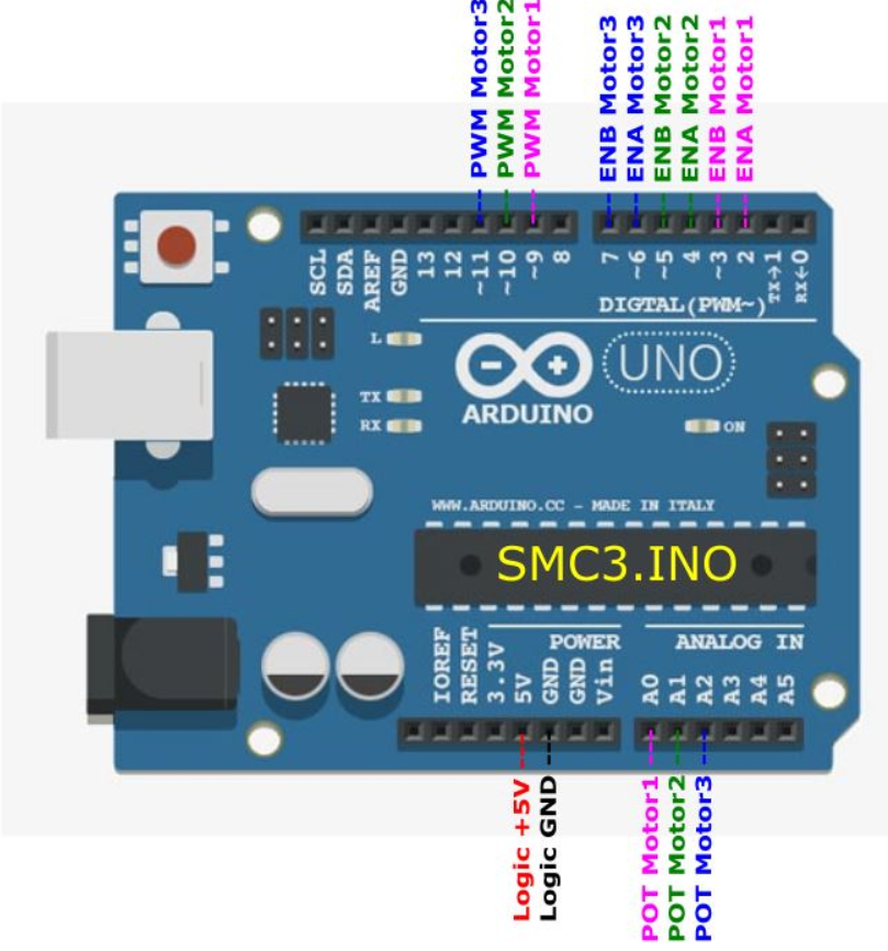

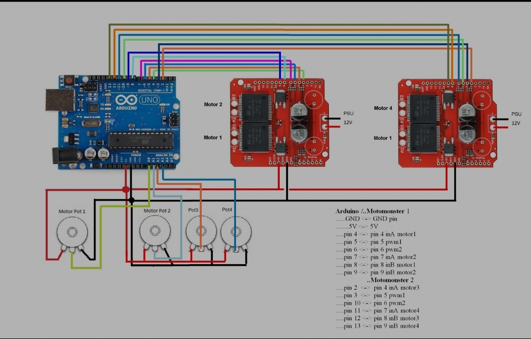

    Pfm21, So the link you may want to look at is here:
    From the diagram below, hook up the 3rd motor PWM to 11 the 3rd motor ENB to 7 and ENA to 6
    and the 3rd motor POT to A2.
    But be sure to read all the info on the linked page. That's what worked for me.
    Also the SMC3 has (3) three motors it will look at so you can set them up.. The third motor is for traction loss.
    Hope that helps point you in the correct direction on adding the third motor.
    H2go

    I have built my 2dof ring . Look
    And I use arduino and 1 motomonster
    Now I want add traction loss. For control third motor can I add another motomonster?
  20. pfm21
    pfm21 pfm21 build 3dof dinamic
    May 13, 2020
    157
    374Coins
    +34 / 0 / -0
    2DOF, 3DOF, DC motor, Arduino
    Can I use this diagram but use only 3 motor?
