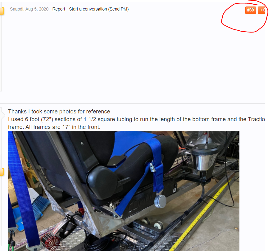

    Can i please have the measurements of the rig
    length of top frame (the one that rolls and pitches)
    width of top frame
    height of ujoin (from base to top)
    length of base frame (the of that slides sideways for traction loss)
    width of base frame front
    width of base frame back
    length of floor frame
    width of floor frame front
    width of floor frame back
    Im sorry for the many questions

    Hi - check out page number 2 post #30 I start showing all the dimensions there .. upload_2021-4-20_16-44-13.png

    sorry i dont know how i didnt notice the tape measure. Would you mind if i inbox you when i have more question so i dont flood your build thread

    Sorry if this is answered elsewhere but how long are your CTCs?

    Hi, On the motors connected to the seat frame CTC is 4".. On the Traction Loss arm it's 5".. The traction loss arm could be a bit longer as I fall a few inches short of capability of the bottom frame. Hope that helps.
