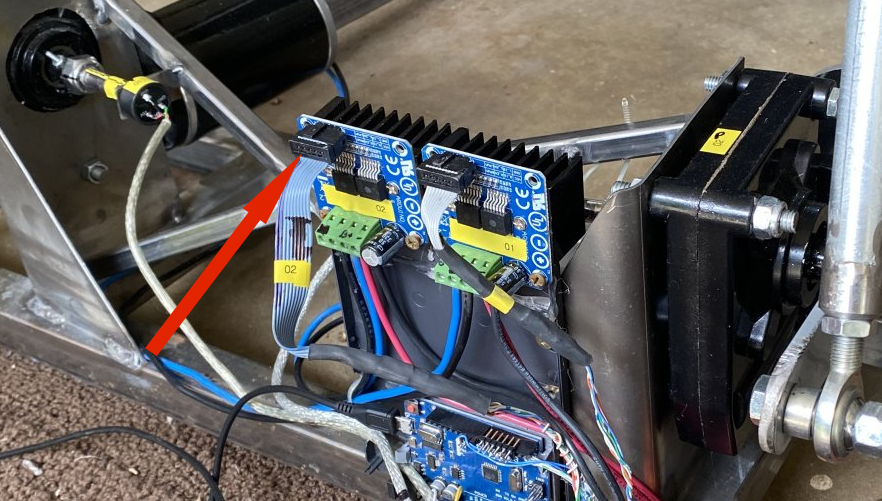

  3. Fdmml
    Fdmml Member
    Nov 4, 2021
    30
    143Coins
    +12 / 0 / -0
    First thank you! Your videos helped me a lot for the construction of my simulator :thumbs
    I am looking for the 8 pin connectors for the H bridges of the motors, do you have a reference, an Amazon link?
  4. ChuckyP
    ChuckyP Active Member
    Sep 21, 2020
    122
    Chicago, IL
    738Coins
    +65 / 0 / -0
    he uses old sound card cables. Mentioned here at 9:45
    If you want those look for an 8pin 4x2 cable.
    https://a.co/d/7HIzRdl
    I bought a cheap kit on Amazon and it came with the connectors and crimps. I wouldn’t use the wire it comes with though. If you go that route.
    Glarks SN-28B Terminal Professional Pin Crimping Tool for 2.54mm 3.96mm 28-18AWG 0.1-1.0mm2
    https://a.co/d/7Afjyx3
    Glarks 1191Pcs 2.54mm Pitch 1 2 3 4 5 6 7 8 9 10 Pin Housing Connector and Male Female Crimp Pins with Pin Header and 10 Wire Rainbow Color Flat Ribbon IDC Cable Compatible with Dupont Connector Kit
    https://a.co/d/e0kVuTu

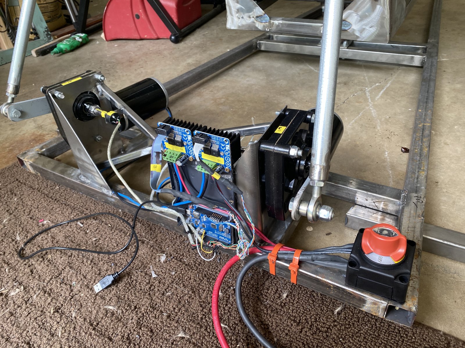

  14. Wingchop
    Wingchop New Member
    Jan 8, 2023
    13Coins
    Hi Dave, thank you for the great informative videos.
    I’m now gathering all the materials to build a rig and your videos are very helpful.
    I got a question, on the jazzy motors video you put a fuse between the IBT’s and the motors, why not between the power supply and the IBT? Wouldn’t it still protect the motor and at the same time protect the IBT if the fuse goes before the IBT?
  15. Kevinski
    Kevinski If it doesn't fit, hit it until it does. Gold Contributor
    Feb 17, 2023
    201
    Jack of many trades, mastering some.
    Australia
    105Coins
    +130 / 0 / -0
    @Wingchop I’d put a fuse both sides of the IBT2’s. One after the power supplies and before the IBT 2’s and one between the IBT2 and the motor. the difficulty will be determining which size fuse to use on the motor side as your motors draw different amounts of current/amps when in use. Depending on motor choice, wattage mainly, they can draw a lot of Amps under load. My motors for example stall at 65amps! My mains power at home that I run my power supplies from is only a 20 amp circuit. My motors in real world terms, with a well balanced rig, operate between 18 and 22 amps when gaming. My two cents anyway.
