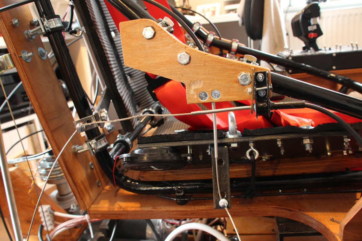

    My Medieval G-Vest
    4 months after my second rig went alive, I have finished another fundamental improvement.
    As I wrote 2 days before, I was not satisfied with the backrest paddles of my g-seat. They simply did not apply enough force to my body. I had three 30kg/cm servos mounted to each paddle, but still the motors stalled quite often.

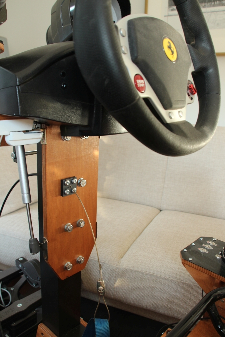

    Inspired by the forum's main innovator @SeatTime, I had already been doing some research on building a g-vest for some time, but without much success.

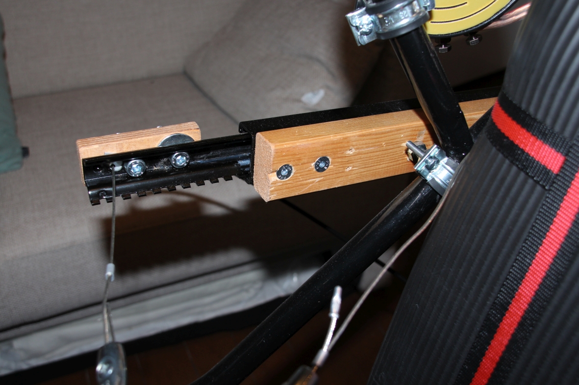

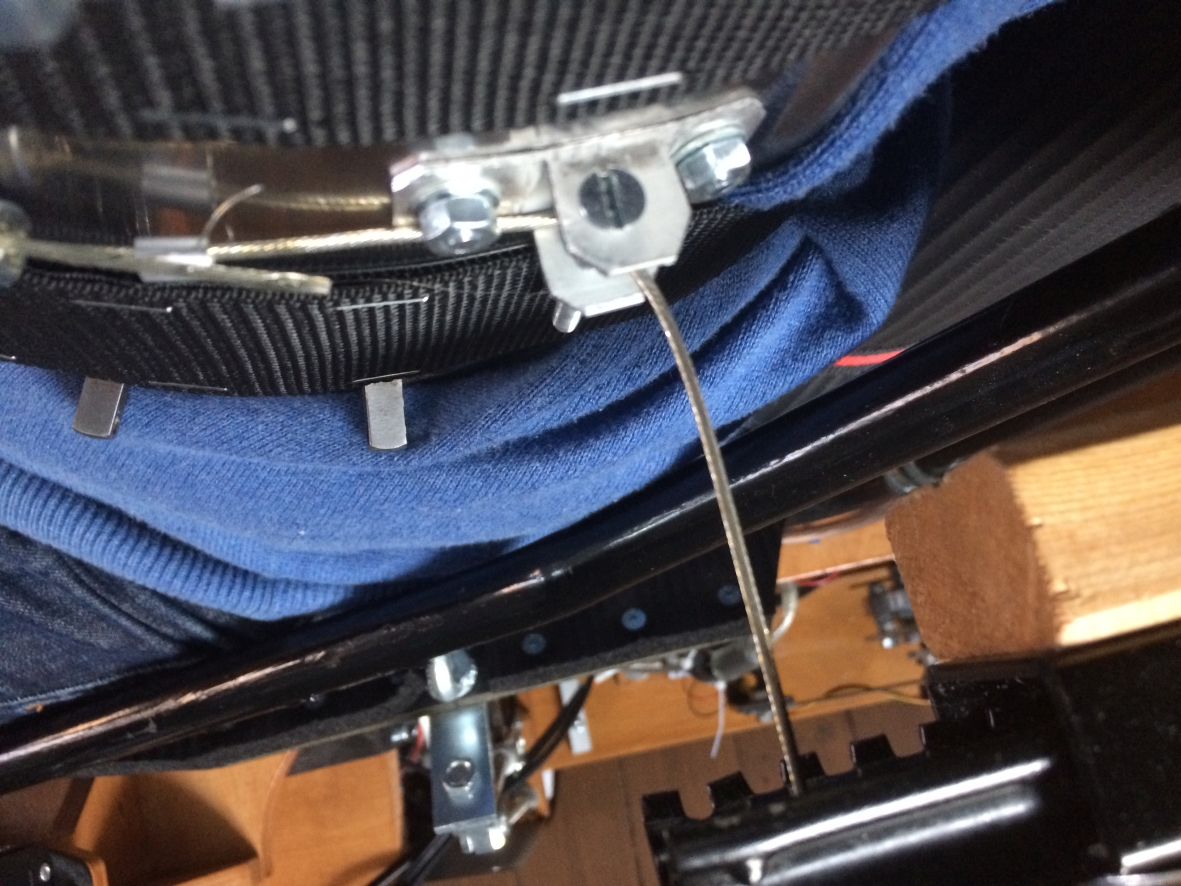

    In my current build I just had one bowden cable installed, which was meant for negative surge (i. e. braking).

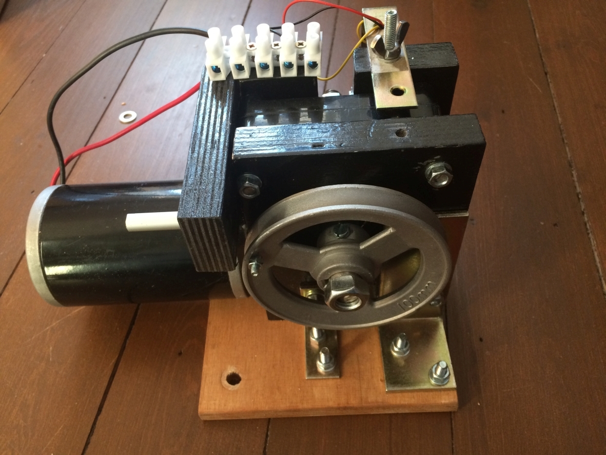

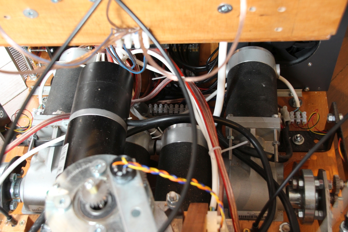

    The following 2 pictures show the outlet of the bowden cable and the motor that was meant for pulling the cable.

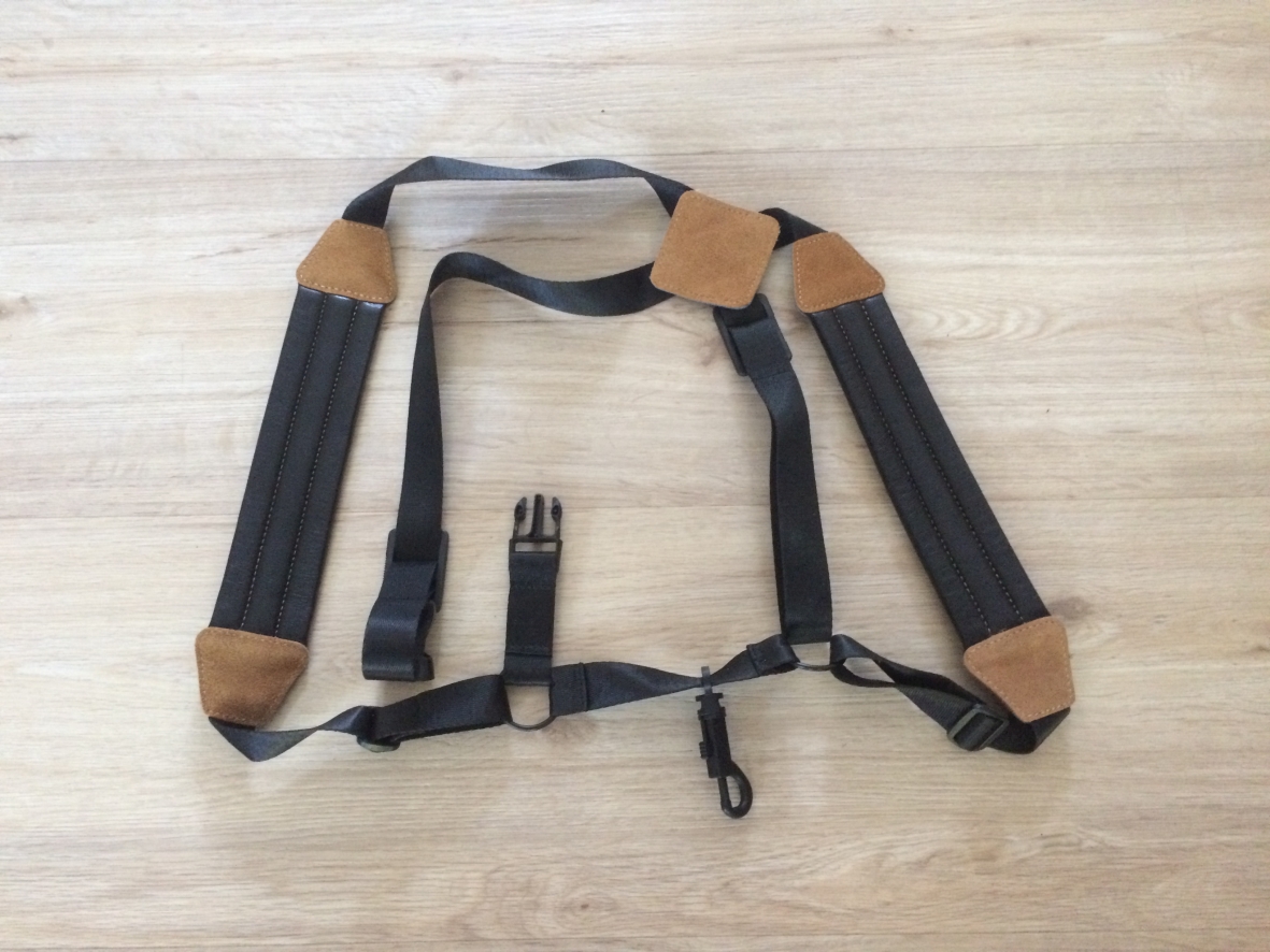

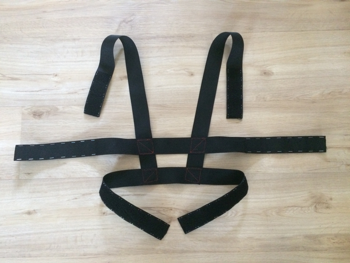

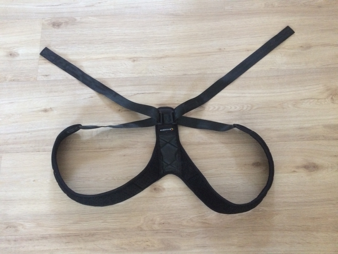

    The cable worked quite well, but the problem was to find a suitable harness that allows the cable to pull my torso forward.
    My first approach was a belt that was originally meant for supporting the upright posture of neck and shoulders (left image below). After this I tested a saxophone carrying belt (middle image), and then a motor bike protection vest (right image).
    01 Back_support_belt_02.JPG 02 Saxophone_belt.JPG 03 Chest_protection_belt.JPG
    All these flexible belt systems did not work. Instead of the sensation of my torso being pushed forward, I just felt the belts squeezing my body.

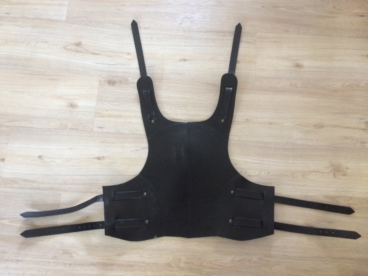

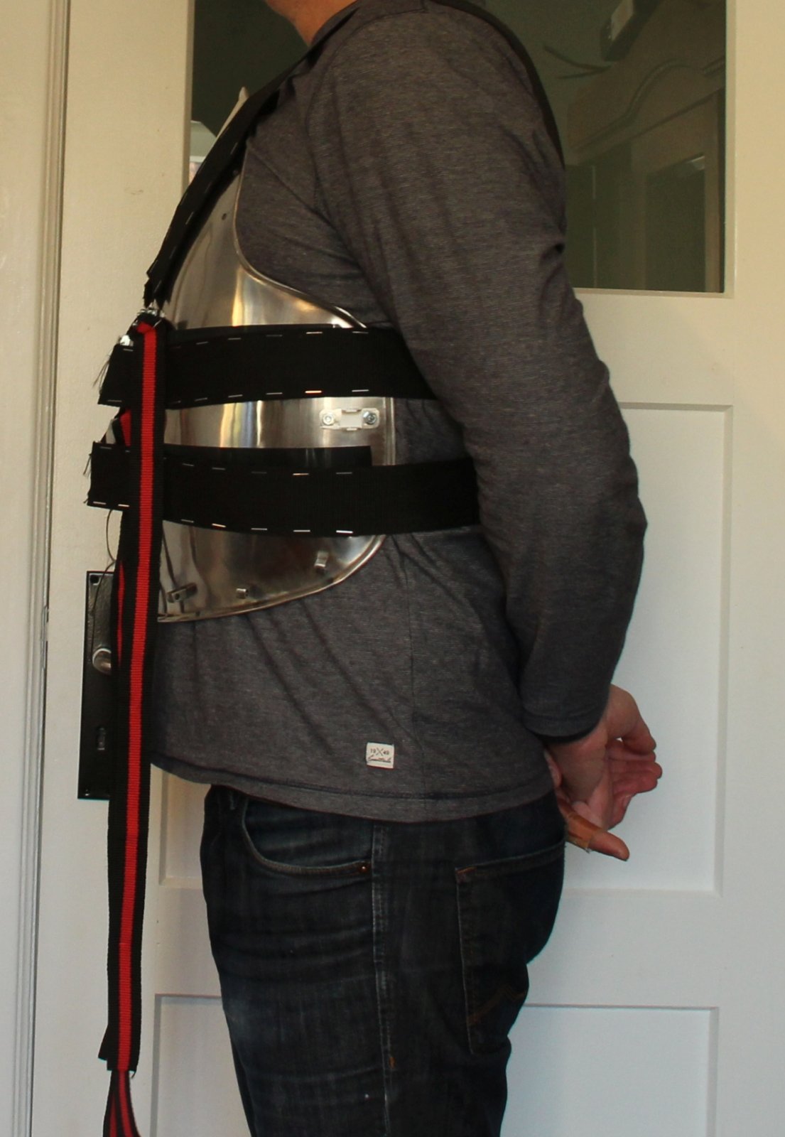

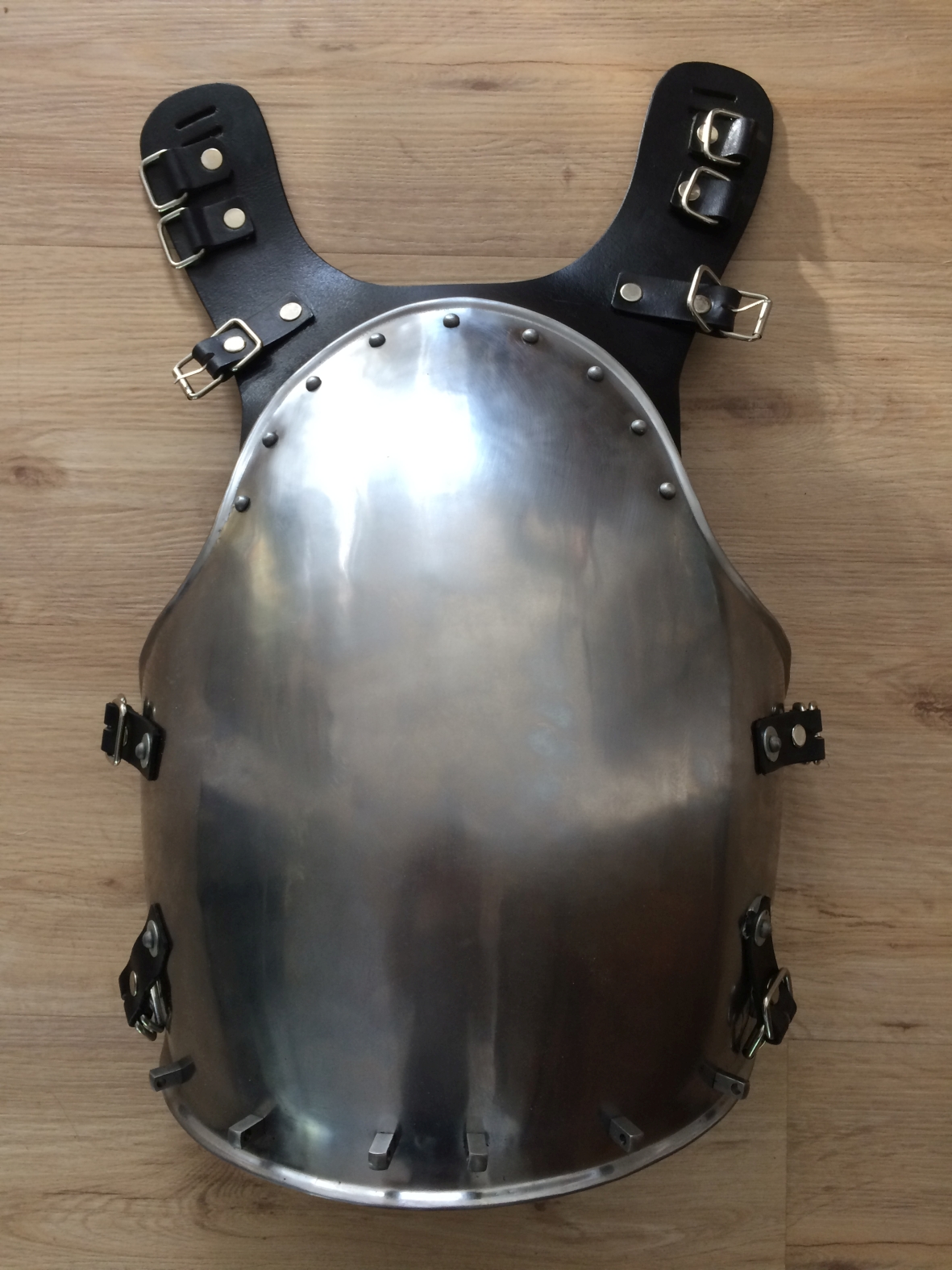

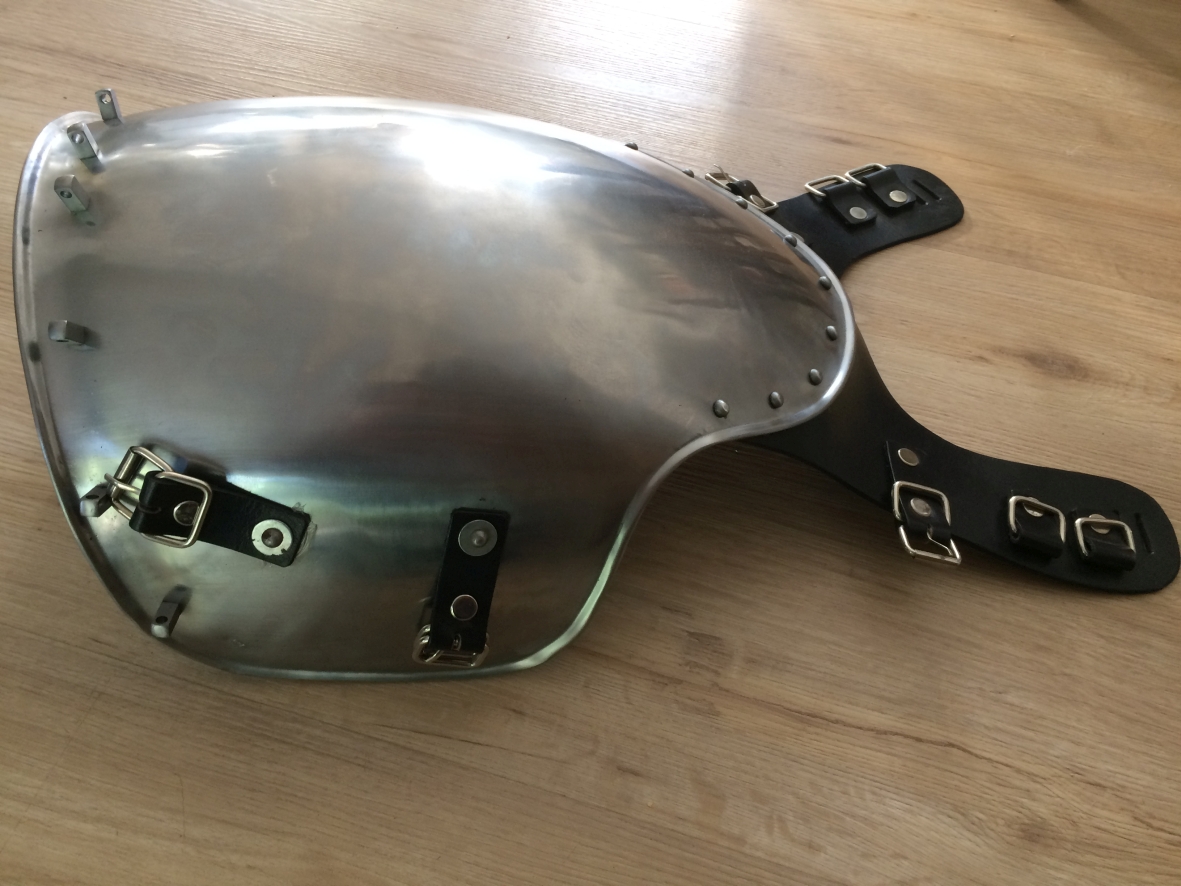

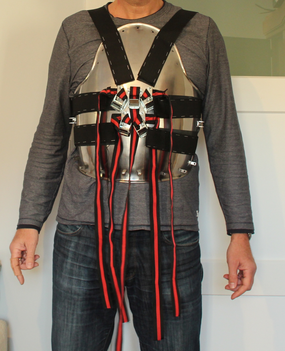

    Finally I found this: A medieval knight armor.
    04 LARP_Armor_01.JPG 05 LARP_Armor_02.JPG 06 LARP_Armor_03.JPG 07 LARP_Armor_Back.JPG
    As it turned out yesterday, this one does the job!

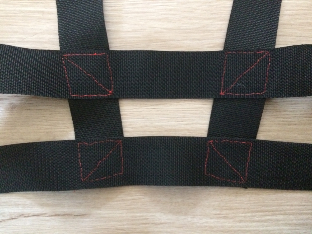

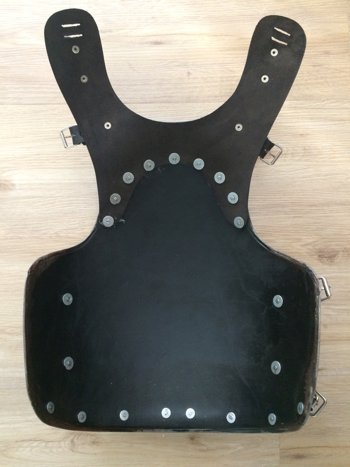

    I just had to modify it a little bit. At first I removed all the leather parts and replaced them with strong fabric belts, supplied with velcro for connecting them to the armor.
    Then I applied 5 tension belts with buckles, one for each bowden cable.
    The next pictures show how the knight's armor became my medieval g-vest:

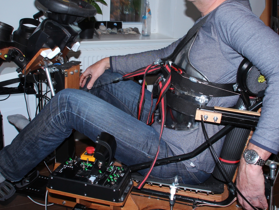

    And here is how it looks when I wear it:
    As you see, the vest reaches quite far to the side of my body. This is important for mounting the cables that pull my body sideways ('sway' force).
    Besides it has turned out that I have the exact size of an average medieval kight, so that the armor fits perfectly and very tight.
    This is essential because I want my body to move rather than the armor to move around my body.

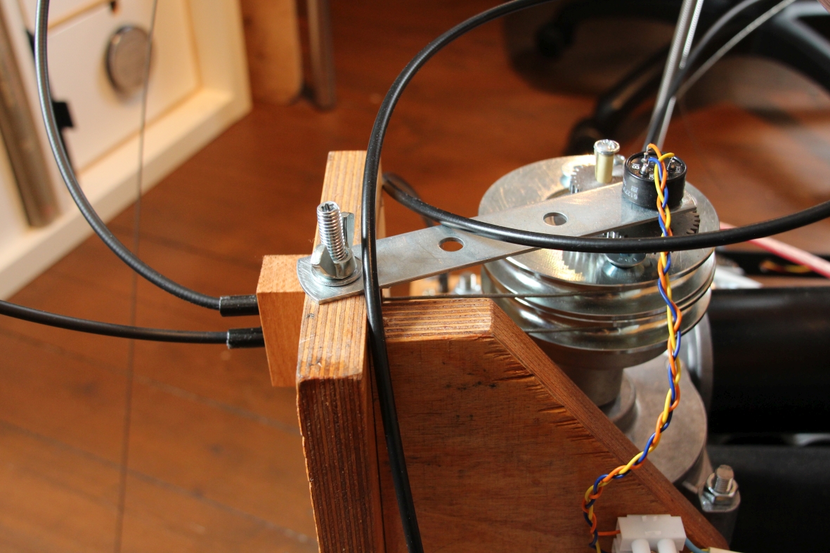

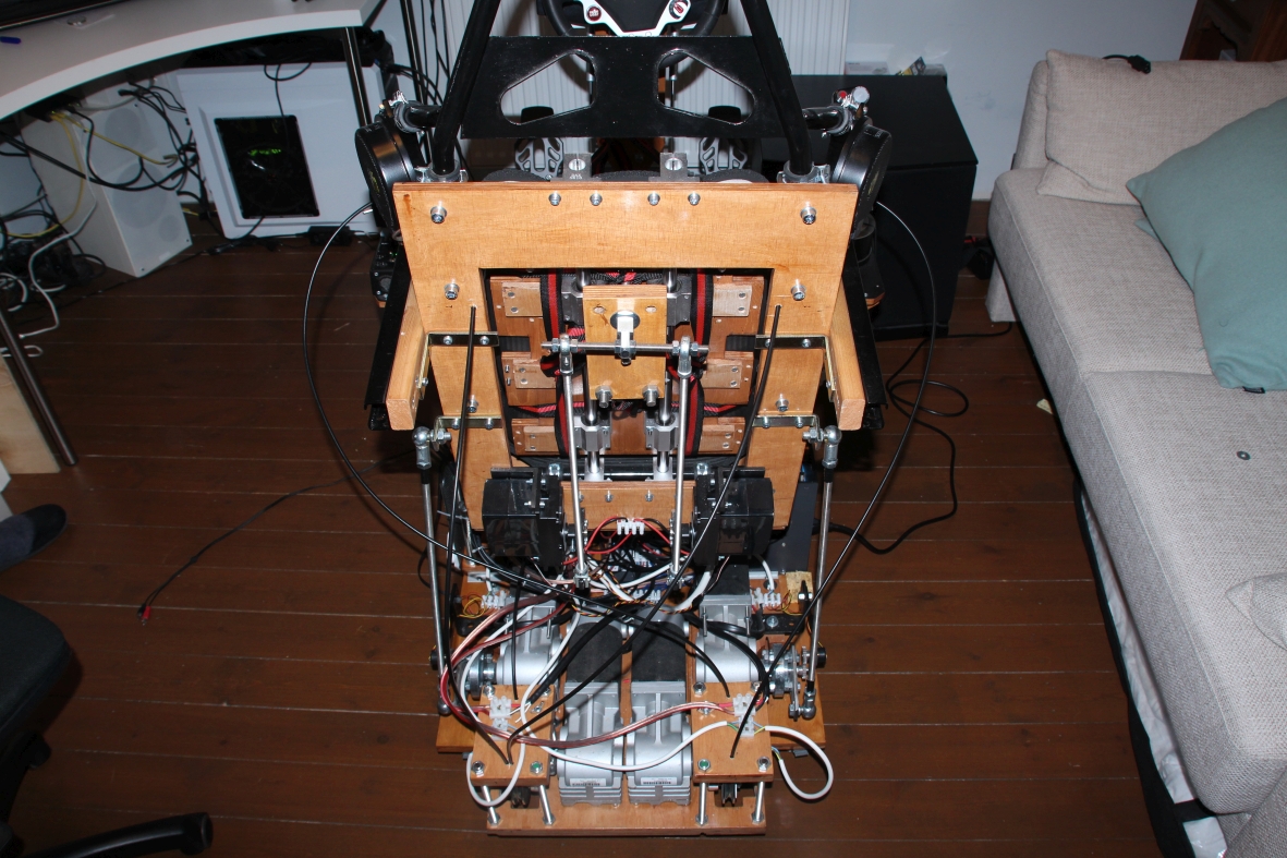

    Now to the rig: I mounted two more wheelchair motors, which are controlled by a new Arduino/Sabertooth2x32 couple.
    Instead of a lever, I mounted a pulley wheel to the axis, in which the bowden cables lie. Her are some pictures:
    The next one shows the rig from behind, where you can see all the cables.
    The left motor is meant for 'surge'. One cable goes to the front, so that it pulls me forward when braking, and two lead into the left and right side of the backrest for pulling me back when accelerating.
    The right motor is meant for sway. It has one cable going to the left and one to the right side of the rig.

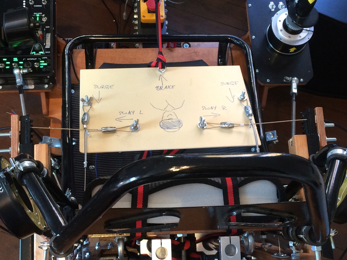

    In order to avoid the surge and sway cables to interfere and act against each other, the end of the sway cables go into a metal rail that can freely move forward and backward. Originally these rails were used for adjusting the position of a car seat. Still had them lying around from an early version of my first rig. Here you see the output of one sway cable and a part of the rail.
    Since it is essential for the force sensation that the body can move in each direction, I replaced my former backrest paddles with a sponge cushion.
    In this way the surge cables can now pull my body back into the cushion. (The forward and sideway movement was already possible before.)

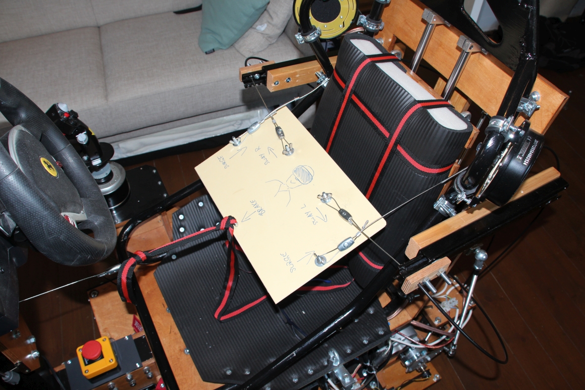

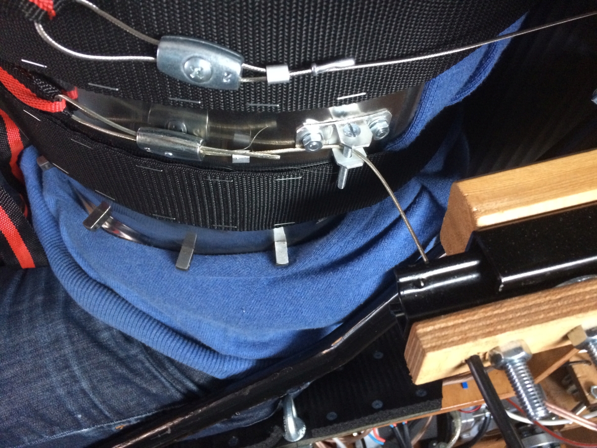

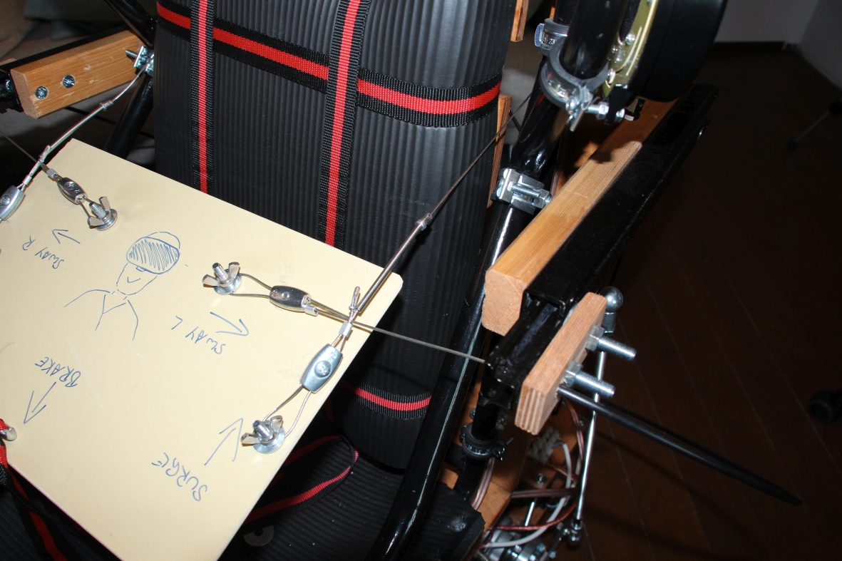

    This is my test setup: I connected all 5 cables with a thin board.
    And so it looks when I sit in the seat with the vest connected to the cables:
    Here is a detail view to how the surge and sway cables are connected to the vest. As you see, the sway cable comes from the side and is then redirected to the tension belt.
    Getting into and out of the seat takes a minute, so that I need to check beforehand if everything I need is reachable. (Yesterday my Oculus headset was out of reach. Maybe I should write a check list.)

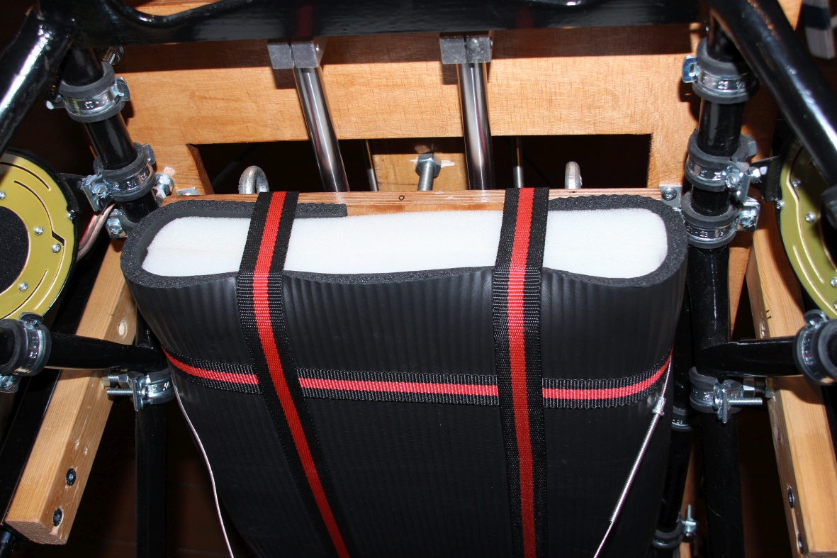

    Again some time went by, and again I did not spend it with sitting in my rig, but with changing it once more.
    The major change is that I went away from my g-vest and returned to old-fashioned paddles mounted to the backrest of my seat.
    The good thing about the vest was that it applied sway and surge forces by pulling my upper body forth and back and sideways. However, at the end the effect was not perfectly convincing, and besides it had the following disadvantages:
    • The major drawback was that it was rather cumbersome to put the vest on and strap it to the five(!) bowen cables. Especially in the case that - as soon as I was strapped into the seat - I noticed that my keyboard was out of reach or the door bell rang.
    • Another problem was that - although the vest had the correct size for myself - it did not fit at all for my daughter and some friends whom I want to spend a ride from time to time.
    For these reasons I am now back to the paddles, but with a major improvement compared to my first paddle approach. This improvement is more torque.
    At first I was using three 33kgcm servos per backrest paddle and they were stalling quite often, especially when the seat was leaning back and my upper body was pressed against the backrest. Now I am using one wheelchair motor per paddle instead, and stalling went away completely.
    The motors moving the backrest paddles do also pull the shoulder belts of my harness when they move into the other direction. In this way I am simulating surge acceleration and braking.
    About the 'heave' paddles: Originally they were moved by Super 500 servos (see the first post of this thread). One problem with this approach was that these servos are slow (0.5 sec per 60 degrees). The other problem was that I burned one of these servos. I just forgot to power the Arduino before powering the servo, so that the servo did not get a defined signal and moved randomly until the lever hit the frame.
    Now I have replaced the servos by another wheelchair motor, which moves both 'heave' paddles synchronously.

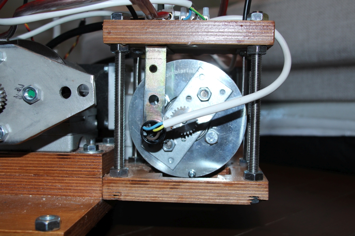

    This is the motor moving the 'heave' paddles. You can see the two bowden cables that go around belt pulleys and the outlets of the cables.

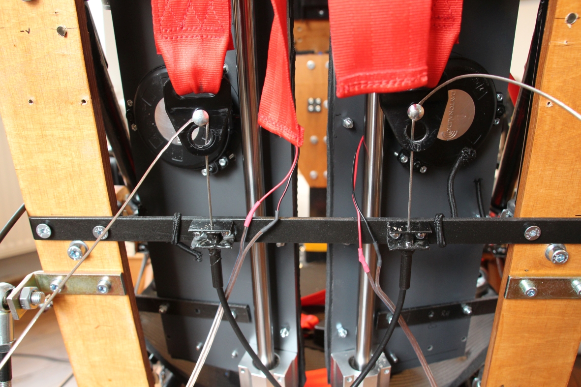

    Here is the opposite end of he cables. The vertical one is mounted to the right 'heave' paddle and the horizontal one to the right 'surge' paddle.

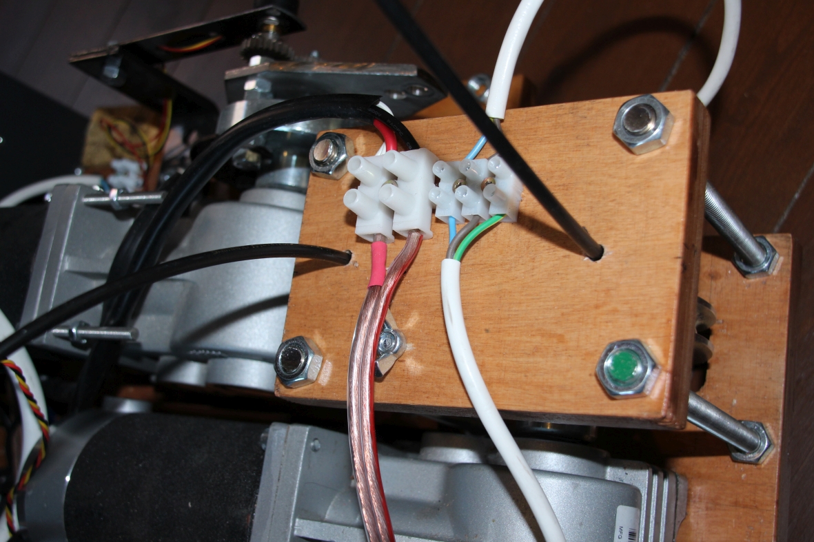

    The next photo shows the harness tensioner cables. It also shows that I have mounted bass shakers directly to the backrest paddles. Another two of them are mounted to the 'heave' paddles.
    And here are all five motors: 2 for the 2DOF seat movements, 2 for the backrest paddles and harness tensioning, and 1 for the heave paddles.

    • The rig needs sliding mounts for the bowden cables. I added such mounts, but they were in the way of my arms when I tried to grab my HOTAS controllers. I always had to put my arms around the sliders, which was uncomfortable. The photo below shows the right-side slider with the outgoing cable. It is built from a car seat rail.
    And the next one shows the left slider any myself seated.
    • Strapping yourself to the bowden cables and freeing you again should be possible as quick as possible. My construction did not fulfill this one.
    • If you want to let other people take a ride, you either need a one-size-fit-all g-vest (don't know if this is possible) or build vests of different sizes.
    If you manage to solve these things or at least those that are important for you, the g-vest has great potential. It moves your upper body into the same direction as the "real" forces would, and it can apply sustained and really strong forces.
    Yes, correct. At the end all available options (2DOF (roll instead of sway), 6DOF (real sway, but non-sustained), g-seat paddles, g-vest, ...) are just approaches to the real forces.
    Thanks!! I think you are much closer to a g-seat than I am to a 6DOG simulator. I really like yours and congratulate you that you got it moving.

    Awesome work Markus.
    Did your vest setup pull your body into the chair making you feel strong forces between your ribs and the chair? If not where were the really strong forces felt?
