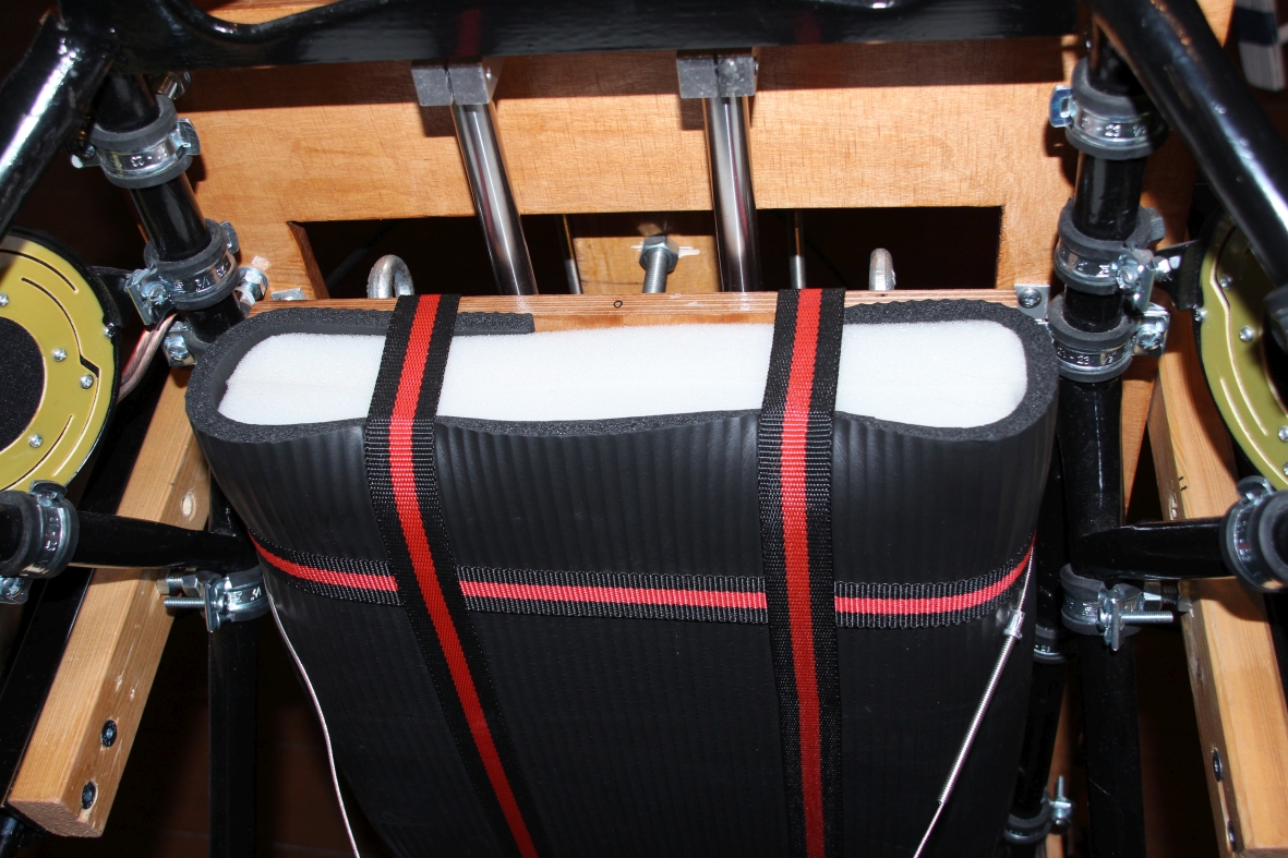

    My ribs were shielded by the metal vest, so that I did not feel much of this body part. It was more my shoulders that were pressed against the upper side of the seat. And I was pressed back into the backrest on forward accelerations. For this reason I added a thick foam cuhion to the backrest (see the photo below).
    Bot the effect of the g-vest was not only caused by the pressure against the seat, but also by the fast movements of my upper body.

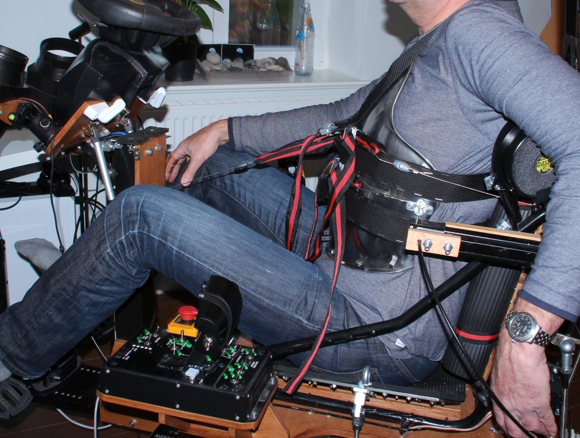

    Using the stick in the middle was not possible for me, but I also did not need it. The photo below shows the front bowden cable that was meant for pulling my upper body forward when braking. On this photo, the wheel is lifted for easily entering the seat. But even when lowering it, the cable was not in the way.

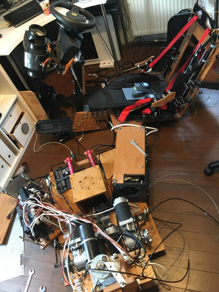

    Right now my rig lies in pieces, but I plan to revive it during the winter season.

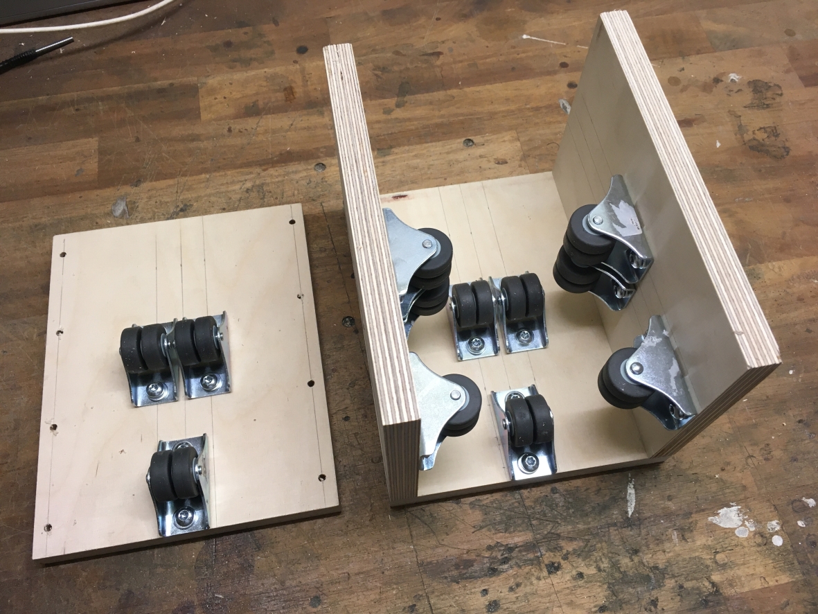

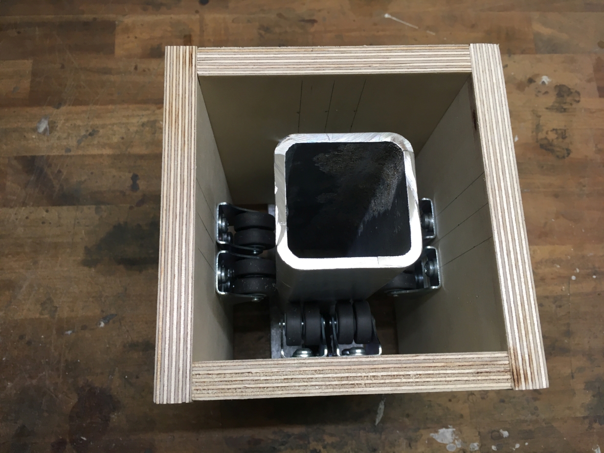

    At first I worked on the stabilizing heave support with a set of rolls:
    Then I saw the solution of @Tim McGuire. Luckily his thread has been brought to the top by a new post just in time, and I really like the mechanics explained here.

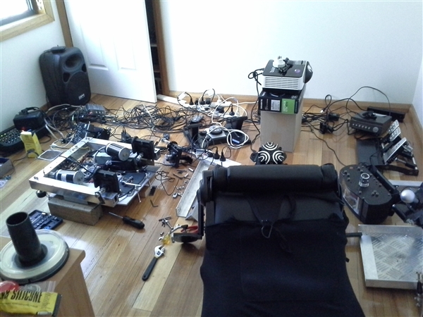

    Many of us have been down that initial chaos upgrade path, this was mine: [​IMG]
    I am looking forward to following the next phase of your project :thumbs

  16. MarkusB
    Jun 30, 2015
    552
    4,215Coins
    +597 / 2 / -0
    Yes, this is a quite familiar sight. I hope I get out of this mess soon, although my wife is happy that my precious seat has disintegrated and disappeared into the workshop in the basement.
