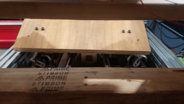

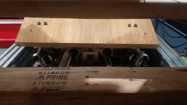

    The seat bucket surge turned out better than I had hoped. The feeling is fantastic.

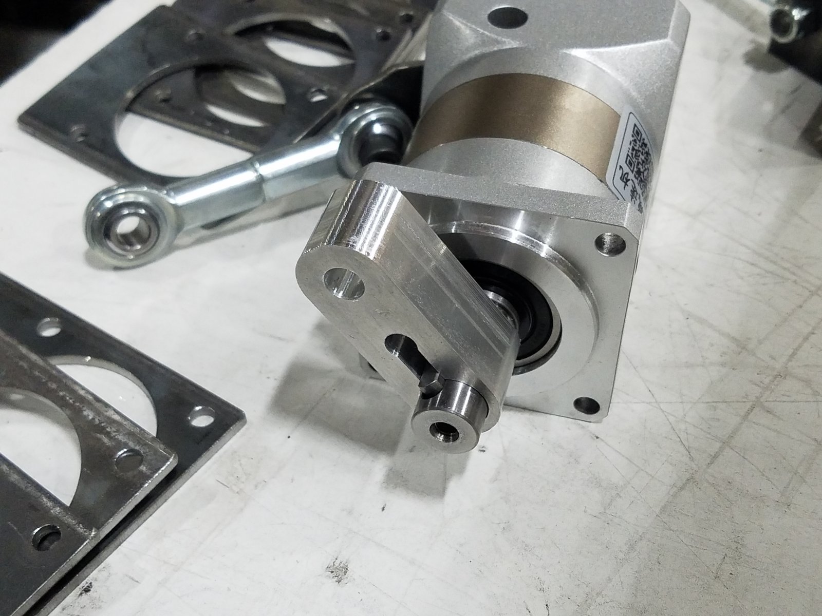

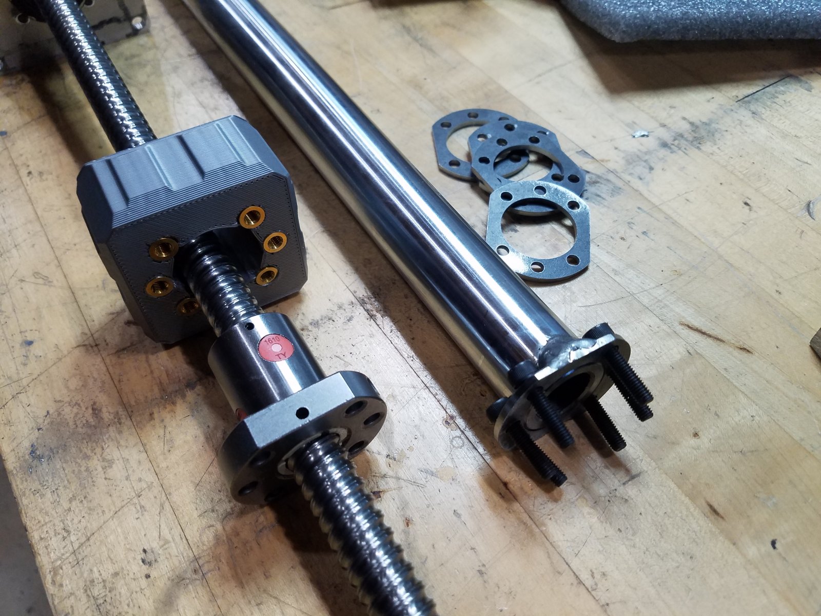

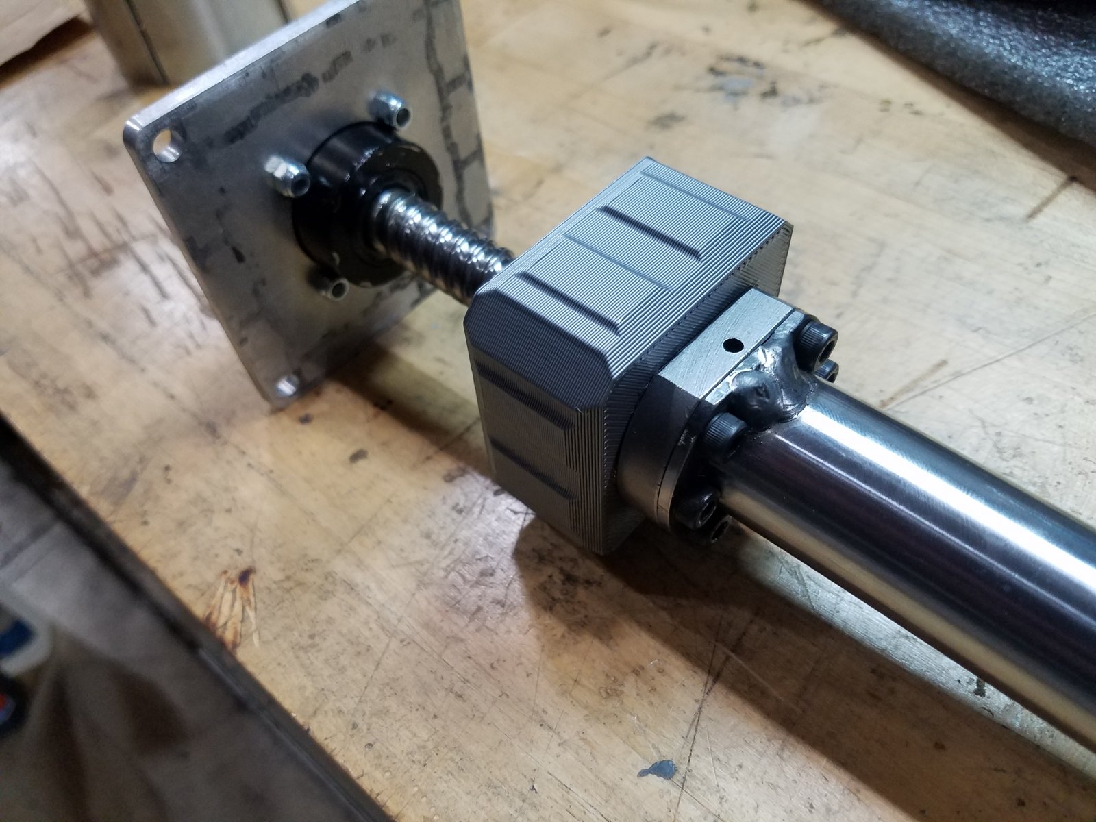

    So a couple of pics from before.

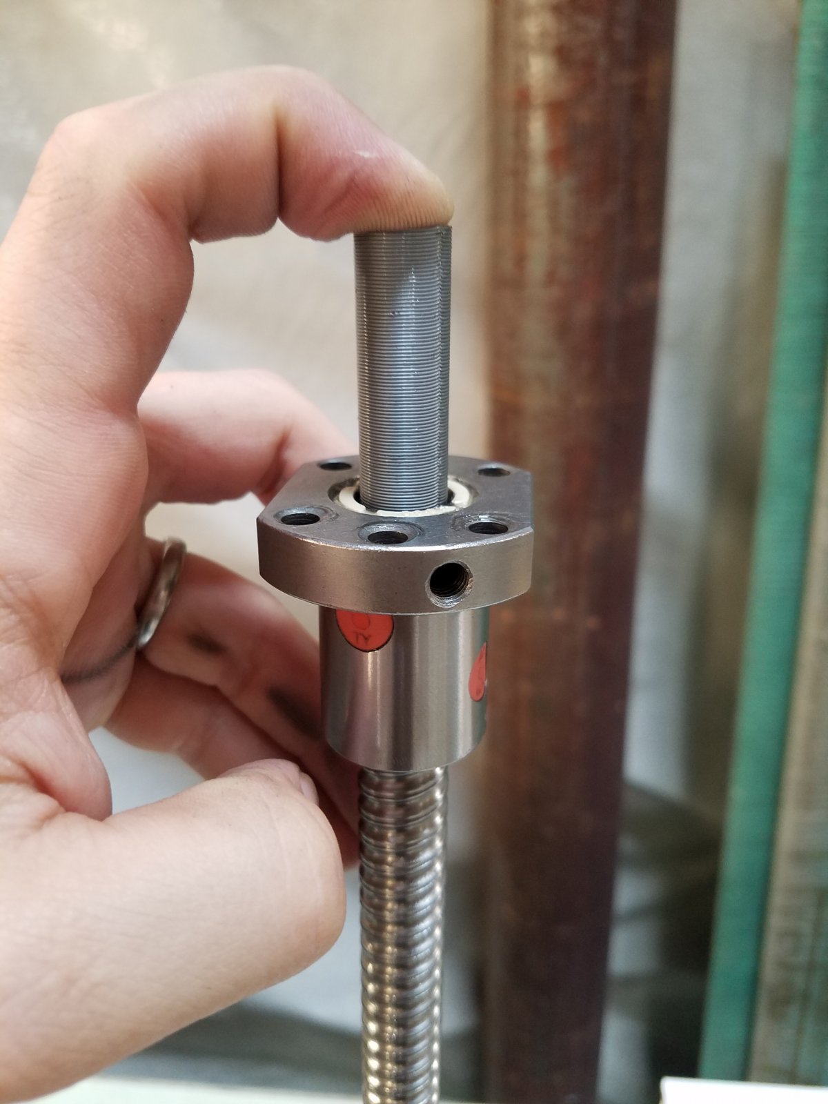

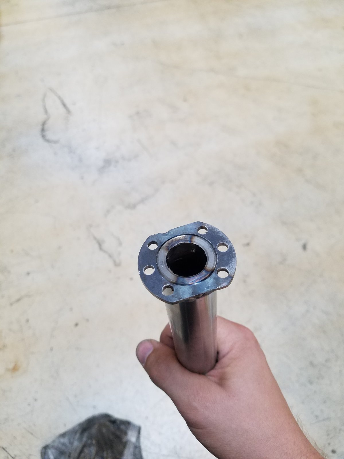

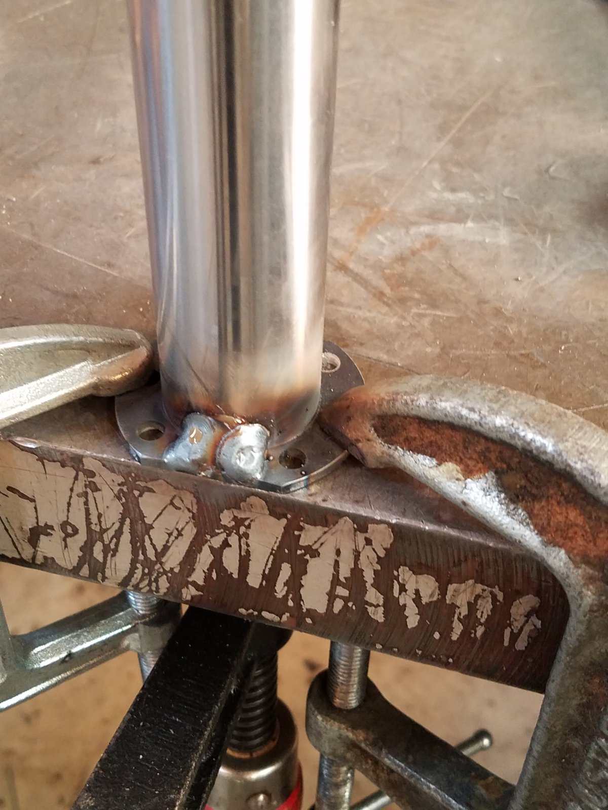

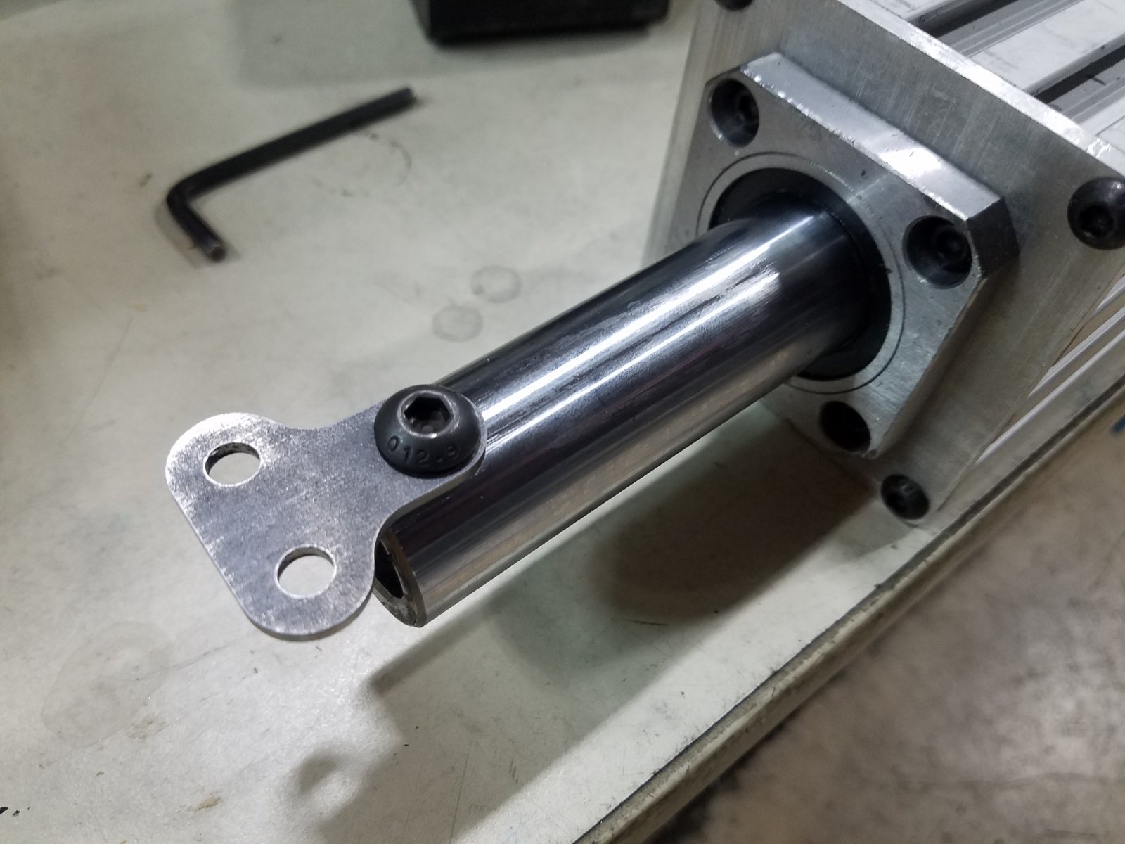

    I needed to convert my push only actuator into push pull.
    So I milled some brackets and welded them on to the steel rod.
    Worked great!
    Printed a cylinder to flip the ball nut on the screw without loosing balls.
    Some assembly and this actuator is all set.
    I drilled a hole in the steel rod and bolted on this bracket. Now I can screw this down to the wood on the seat bucket.

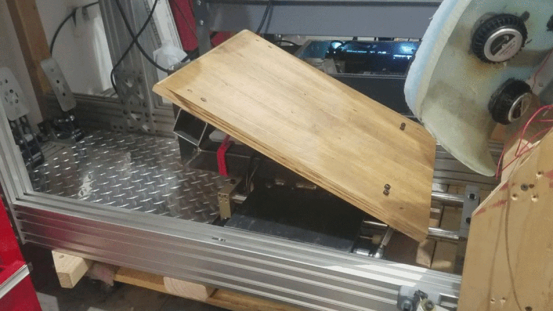

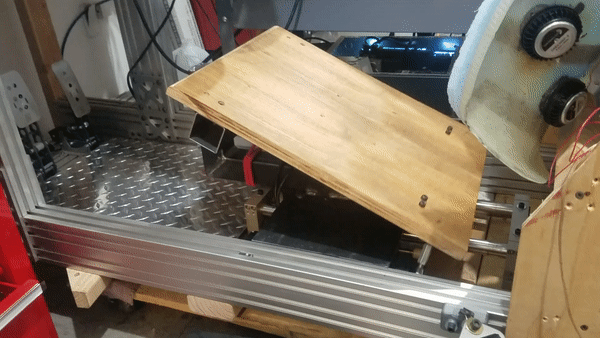

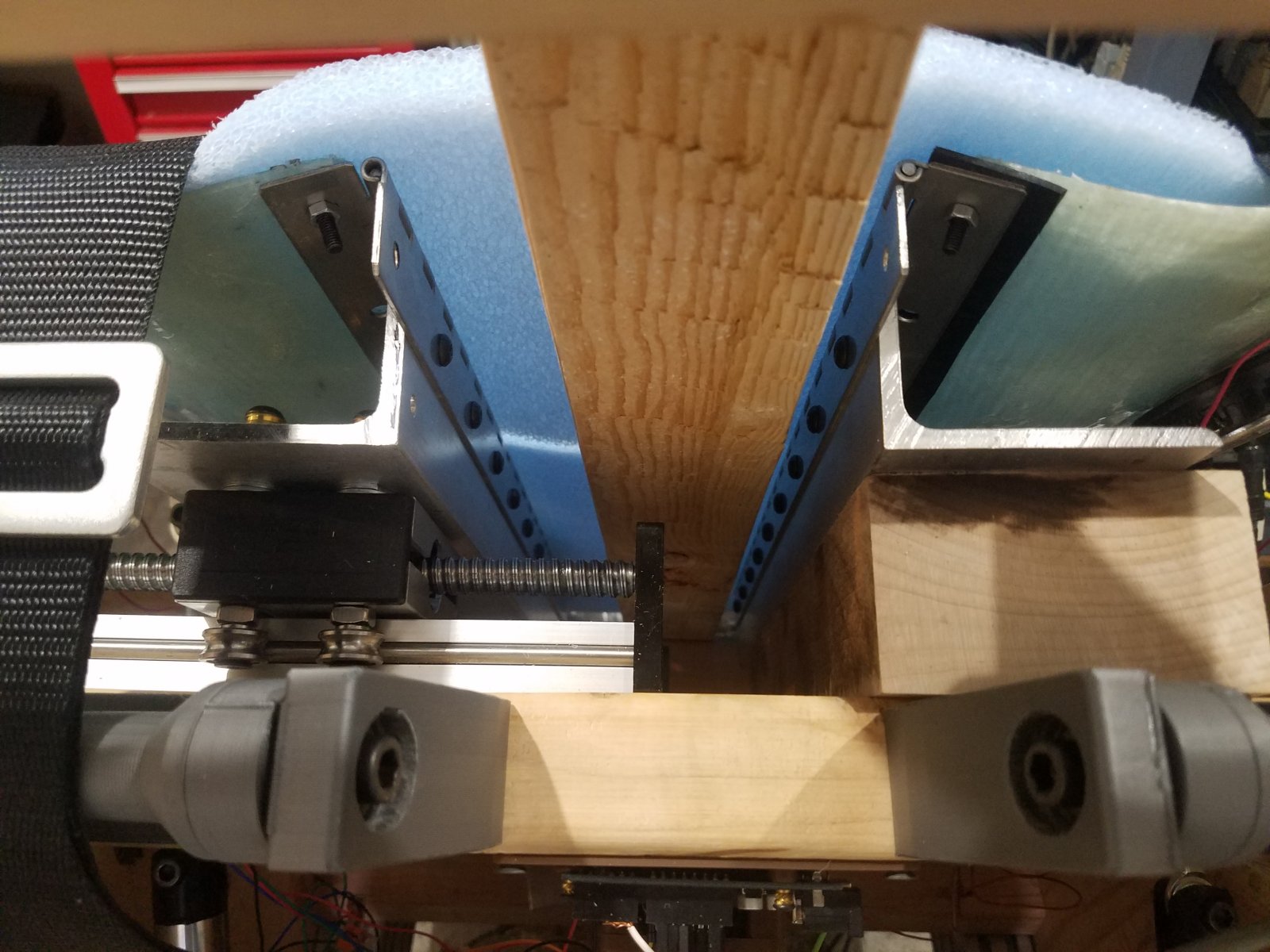

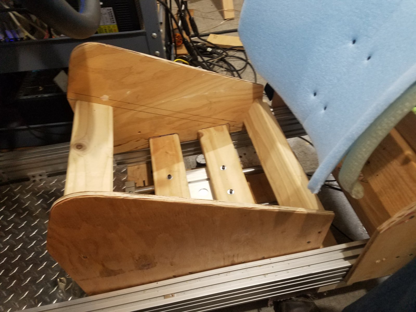

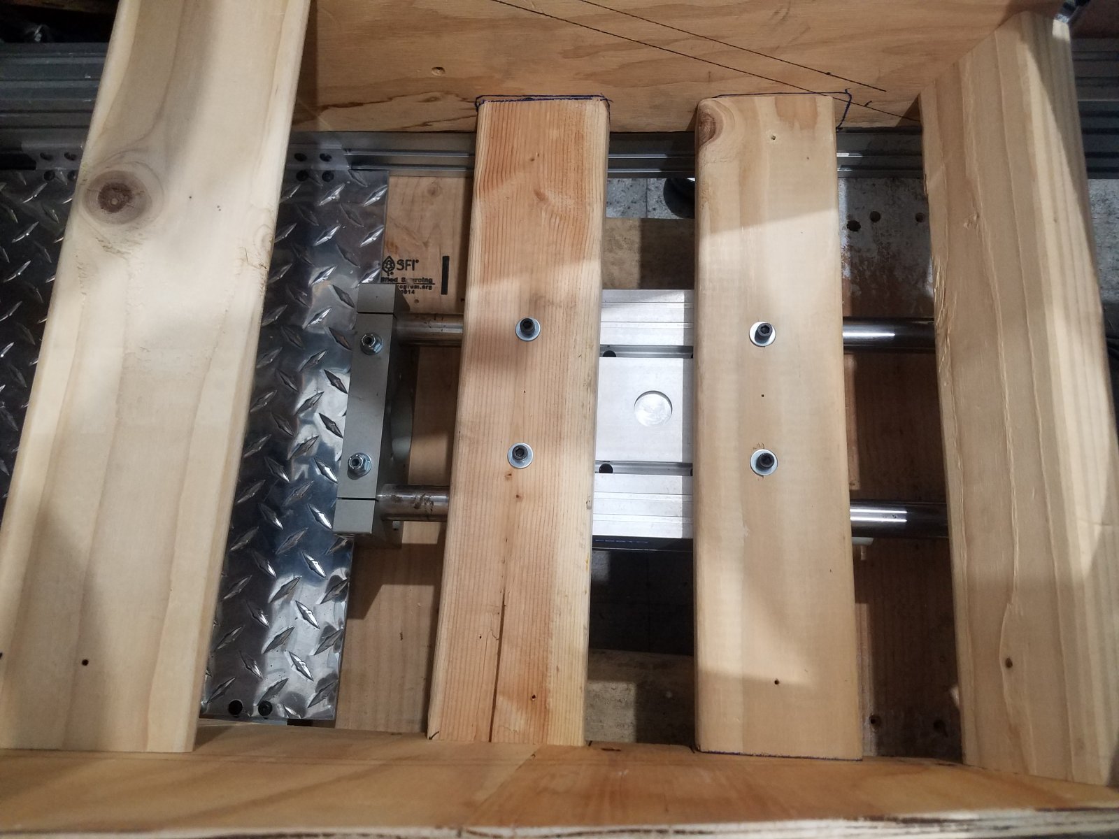

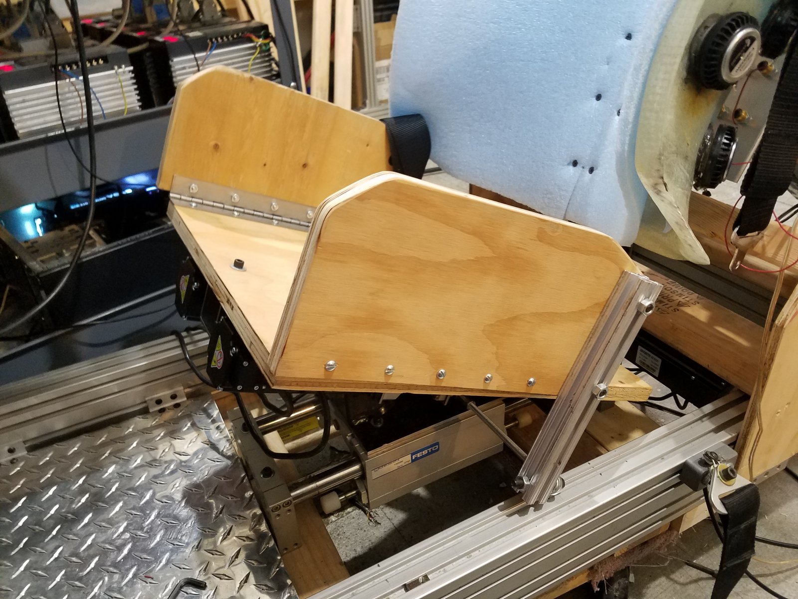

    Got my seat bucket wood mounted to a linear bearing.
    Plywood board and seat pad go on top of these 2x4s as marked.

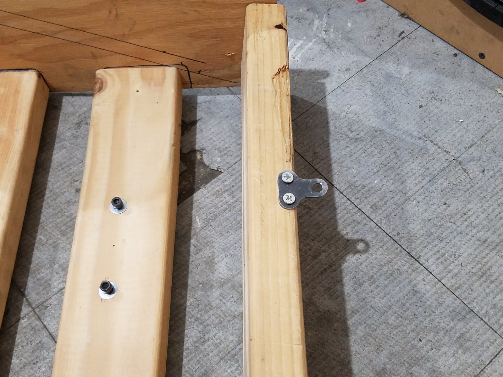

    Here is that bracket I made for the steel rod. Kind of silly how small I made it. I used 3.5" long wood screws (predrilled) and it has survived pretty well.
    I want this seat to be tried by many so I made the left hinge able to be adjusted. This has come in handy since the gseat has to be fit to each person to get the right feelings.
    I can adjust the position of the stepper motors with a pot mounted to the rig. Sadly the little nema 17 motors will skip steps when moving if the body is relaxed in the seat. It will not skip steps when still so if you lean forward during an adjustment it works well.
    Since this seat wraps around the body so far it really needs to be dialed to the person driving. This is a pain but I happily go through the work since the outcome is so excellent.

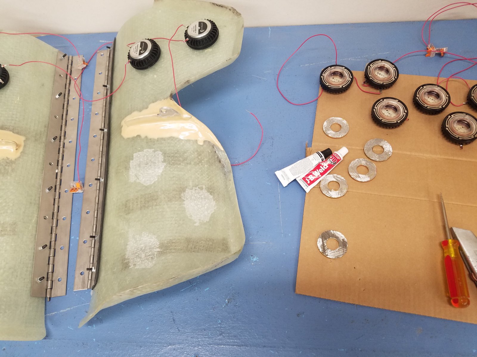

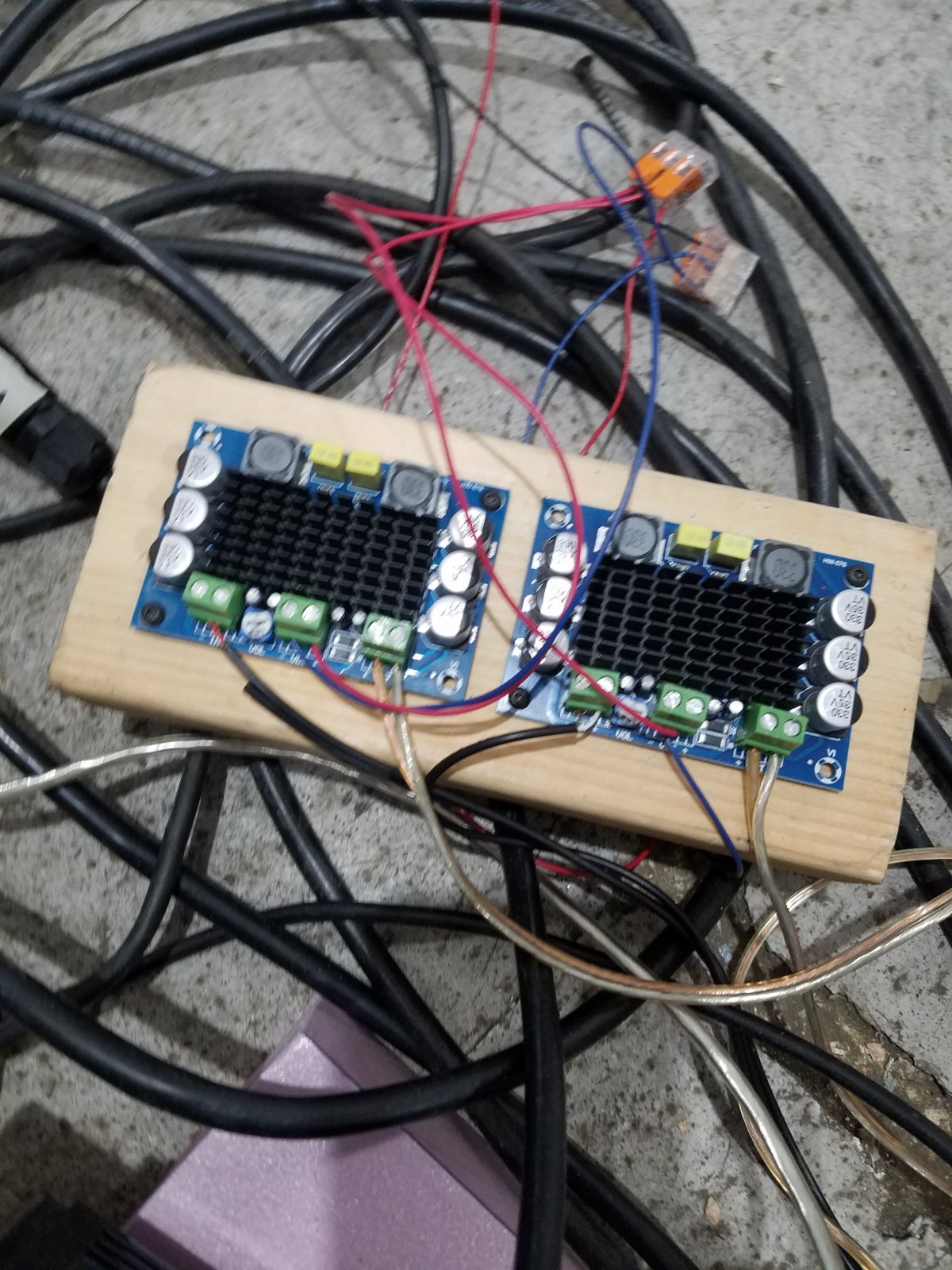

    Since this seat has a lot of curvature i don't have good mounting options for the dayton daex32ep-4 exciters. So I jb welded these washers to the chair as they are a perfect fit. 20200912_142842.jpg
    In the video I posted above you can hear the exciters screaming all the game audio full spectrum through the seat. Feels great! I plan on diving deeper into tactile later. For now I just plugged in 4 4ohm exciters wired parallel and series(adds up to 4 ohm) into two HW-576 amps. One for each paddle. 8 exciters in total. Audio mirrored from the vive to the amps.
    I really love hearing the different vehicles engine characteristics come through. As you can see I drive with headphones while the seat is screaming because they sound better than the seat with my body against it. The combo is excellent.

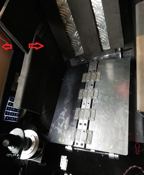

    This does bring me to a false cue with the seat though. As you can see I get moved side to side quite a bit with surge. I am moving in the wrong direction. This is a natural consequence with squeezing strongly on one side. My solution is to tip the torso with a seat mover design in the opposite direction to first cancel out this motion and then maybe add a little in the correct direction.
    The same is true of surge. When I am squeezed from both sides during forward acceleration I get slightly pushed forward. Same solution, torso seat mover tipping back during acceleration. I illustrated this with the animation posted earlier. I am excited to report back how this works.
    I will say now that these false cues are most noticeable when driving tight cockpits with low roofs. Being so close to the walls of the car you can tell when you move incorrectly. I wouldn't say it was enough to give me motion sickness though. Haven't felt that yet (although a couple of old timers in the shop have, I suspect they would feel sick in vr regardless).
    I expect that this gseat will never need any motion cancellation, despite giving a really good feel for the car. This is definitely another reason to be inspired to build a gseat!
  10. SeatTime
    2,572
    +2,854 / 40 / -0
    I got around these false cues by having the back and base of the seat able to move forward and backwards for surge and left and right for sway, while also having two sets of paddles. The top seat paddles were parasitic, while the bottom were independently driven. In my new sim I am going to try offsetting the position of the paddle hinges so that they let you drop slightly into or back at the center when they close.

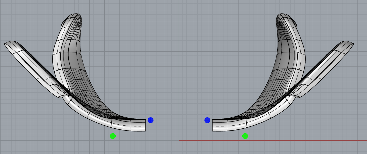

    I was definitely inspired by your design. My current thinking is that I will want independent control of the torso seat mover part vs the paddles. I think I will want my paddles at really high speeds with lots of fidelity while the torso mover will have more filtering and be smoother. If it turns out the motion I prefer is to have the paddles and torso mover at the same speed/damping then I will remove the two extra motors and use them somewhere else.
    Just trying to imagine what you're going to do.
    Are you saying you will not use the blue hinge location but something more like the green?
  12. SeatTime
    2,572
    +2,854 / 40 / -0
    Yes, allowing the centre area to drop back when the paddles close and push out when they open. My gap won't be that wide.

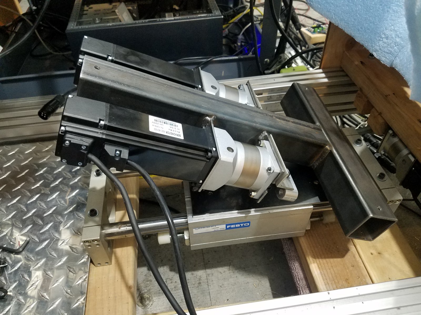

    Right now I have 4 servo motors setup. Two on the paddles, one sliding the seat bucket and one on the seatbelts. I feel like this setup is light years beyond any moving chasis motion. I've only built a pegleg before this but I'm telling you, I am actually feeling the car. With a lot of excellent resolution. It's great.

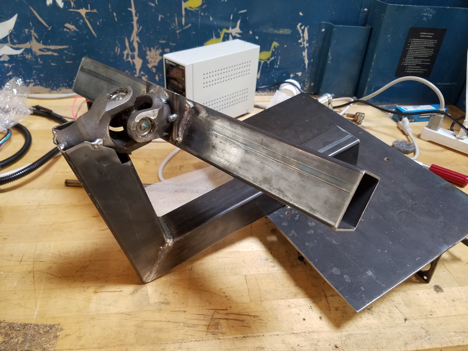

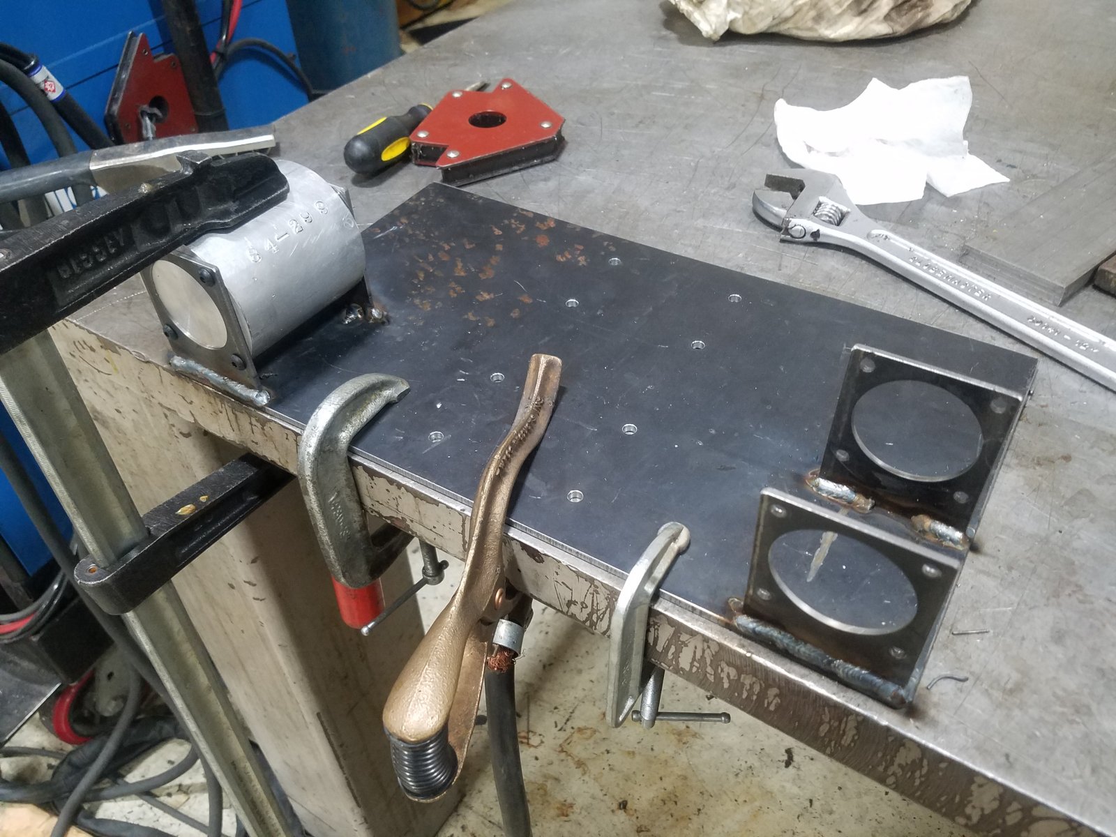

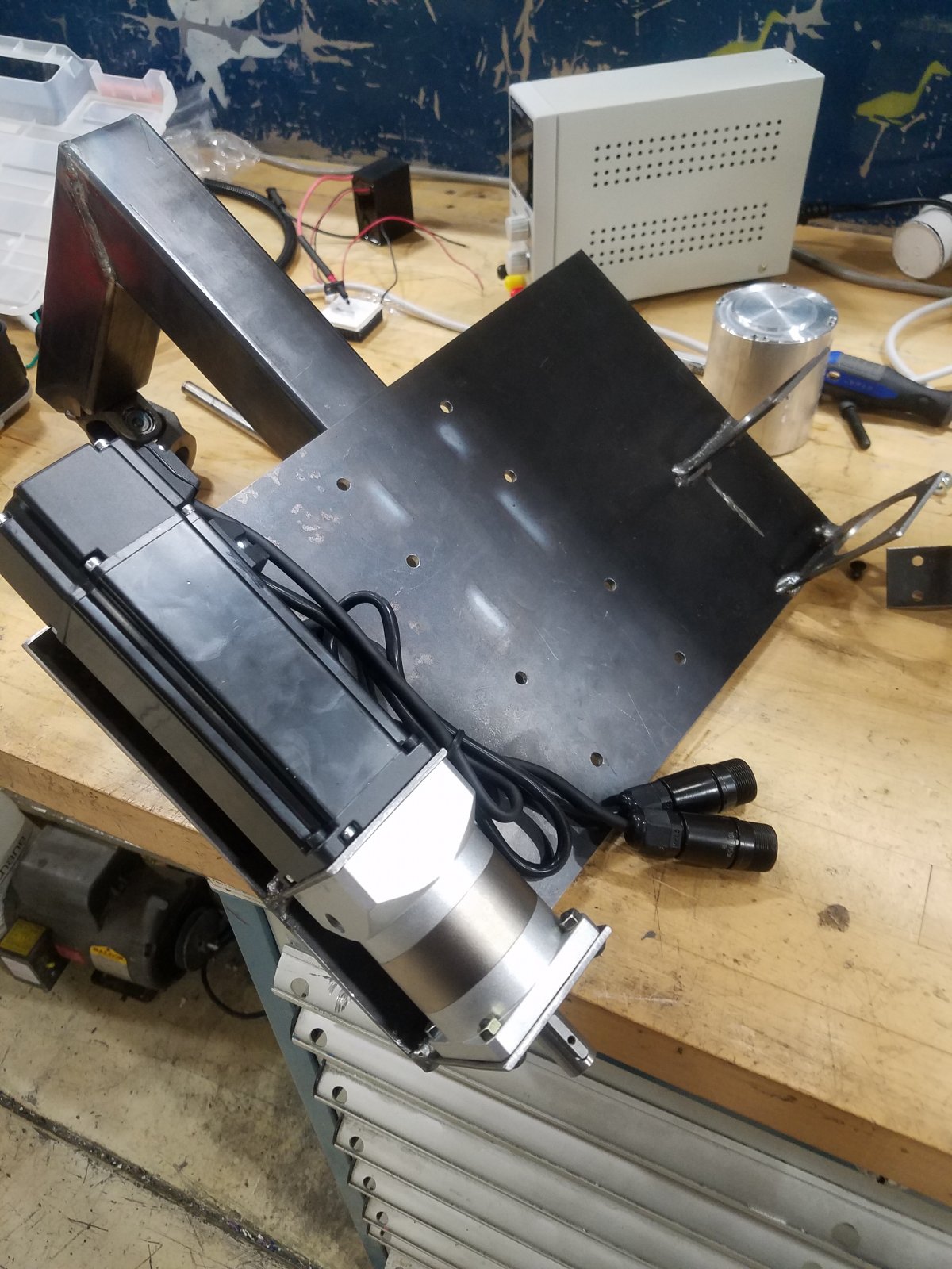

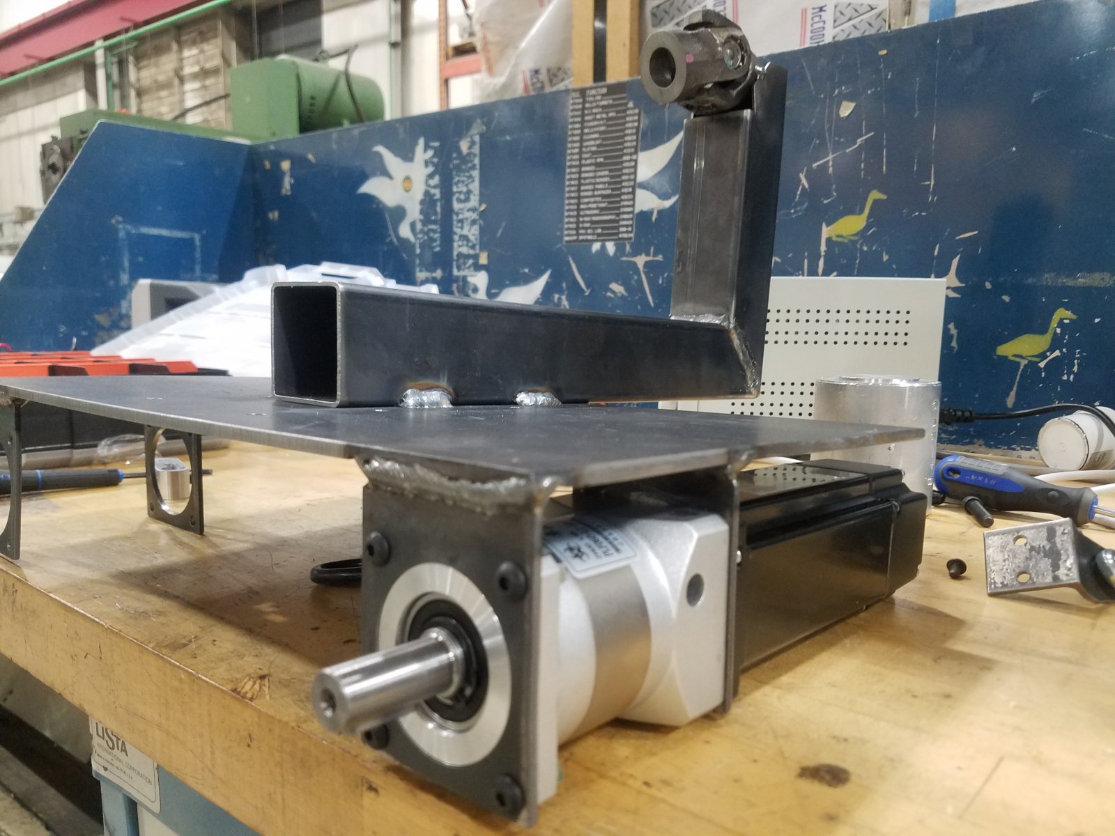

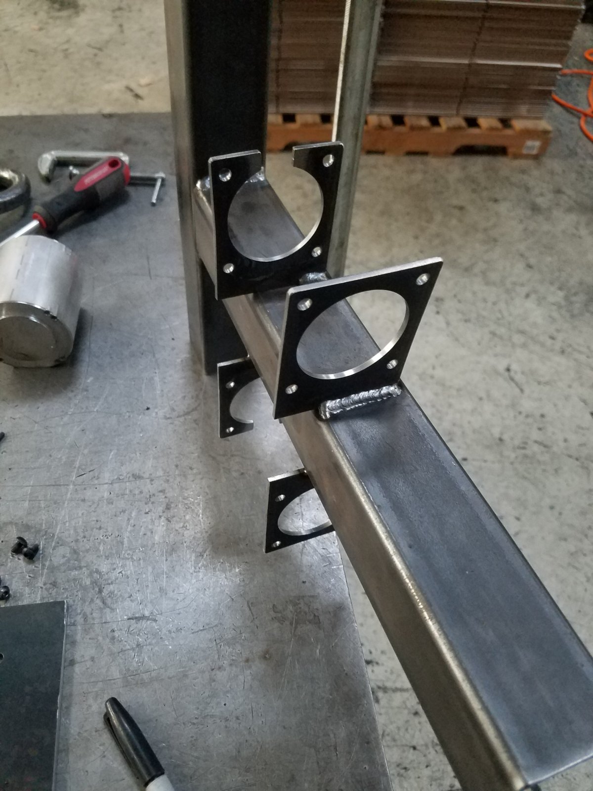

    Ok so as much as I am annoyed spending time showing you something I didn't use, I do think its cool to show failures or things that didn't work out in the name of learning. So hopefully somebody learns something from this.
    I didn't like what I build, but I'm glad I tried it. If I didn't I would have always wondered.
    Crank arms for the gearbox. I drilled and tapped a bolt right next to the key to clamp it to the shaft.
    I made an aluminum spacer to hold the motor mount in place while welding.
    Bracket.

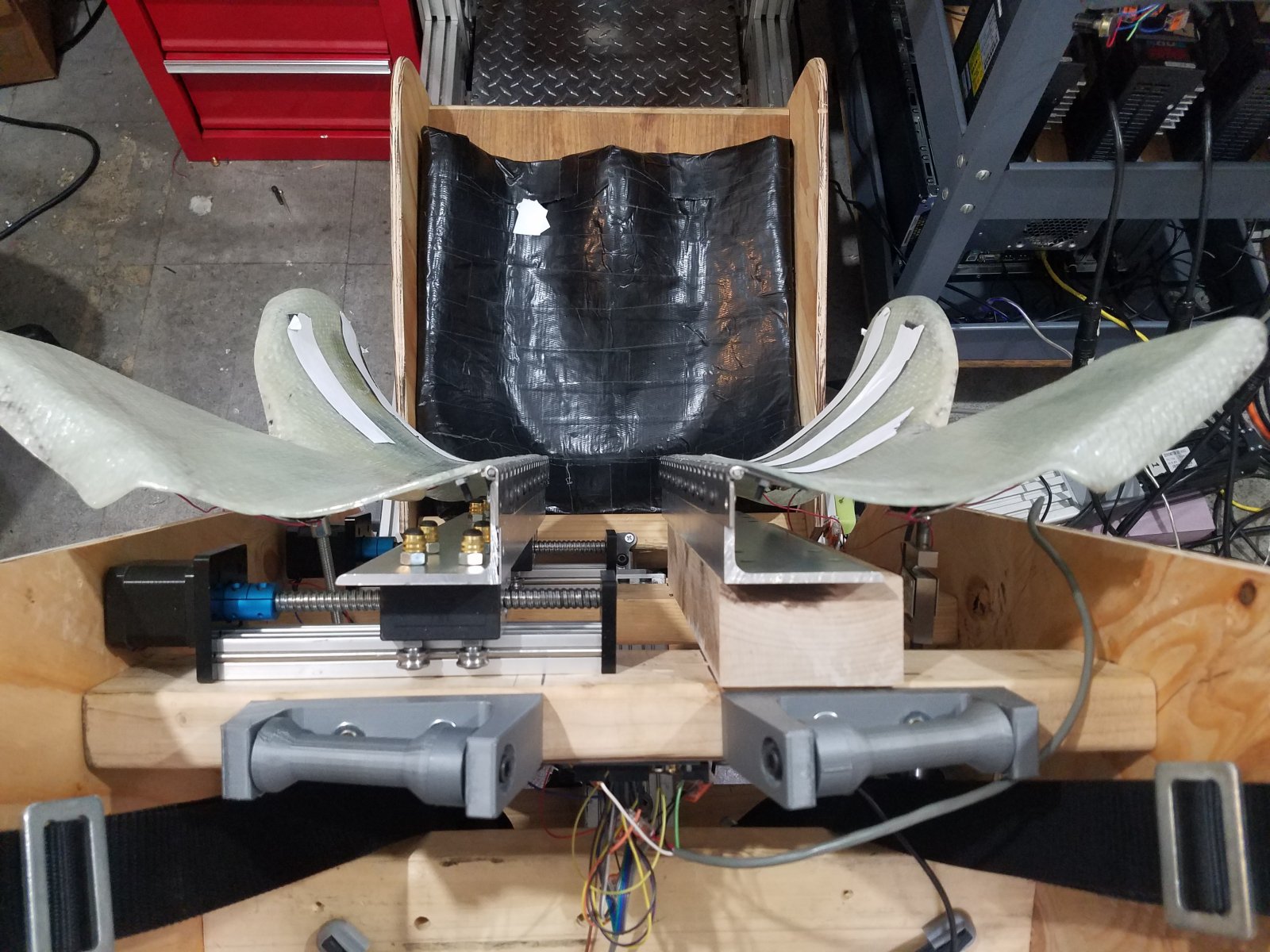

    So I pulled the frame and made a simpler one.
  19. cfischer
    Sep 7, 2015
    399
    Colorado
    2,844Coins
    +276 / 1 / -0

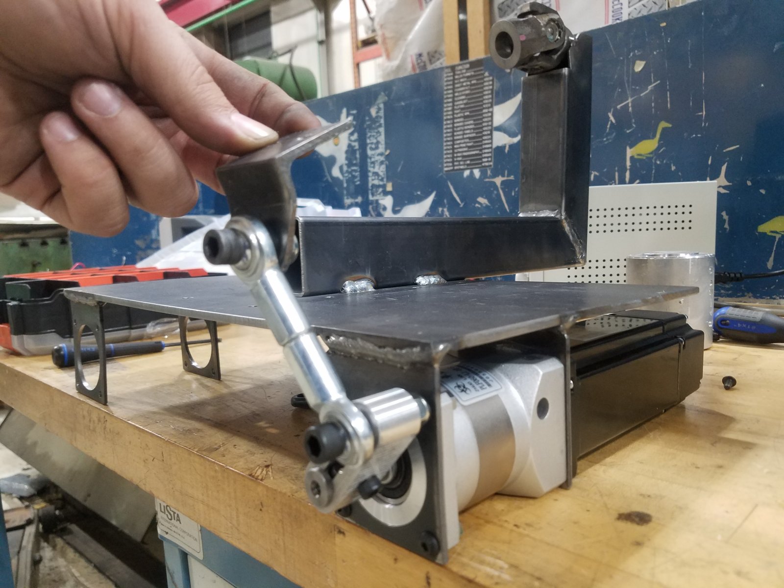

    The simpler frame has mounts for two motors for thigh paddles. This was part of the plan all along but I left out the thigh paddles on the last attempt to keep it simpler. 20201018_175346.jpg
    You can see how everything goes together before the wood comes in.
    So here are the thigh paddles. Again a prototype. They will be composite like the back paddles someday soon.
    I really like the feel of the thigh paddles. They are super strong and bite down into your leg (rather than lift the leg as most seem to do) giving you lots of "resolution" of the force you're feeling.
    Adding this really made the sim feel more "full bodied" and really made me wish a g helmet was already setup.
    I'm sure a video will be along later.
    Let me know what you guys think or want to know!
