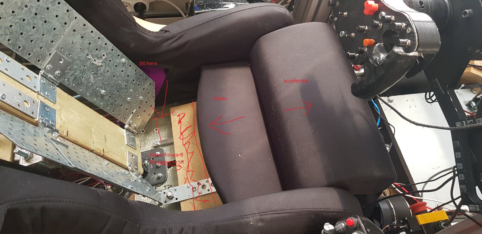

    Oh im just terrible at explaining things so no worries. I also have no idea how yours actually feels so im just going with what i see.
    First off i love what you have done so dont take this as anything against it.
    I did try it more like your setup at first but it just felt wrong. What happens for me is when i press the brake hard i get pressure in my back anyway but the flaps slam backwards so i feel like my upper body is being thrown forward. When the slider moved forward (moving my lower body) the pressure under me feels like im moving backward in the seat (acceleration cues) . My lower body also moved away from the seat while the upper body stays put and i felt like i was being lifted out of the seat
    To me this is not what you want. You want the shear and pressure moving against you on braking while your lower body is generally static. Braking for me is the strongest force. What it looks like to me is that you don't get much if any shear/movement underneath you which is probably why you don't like to have any brake force. You can get the pressure of course but since the whole thing is moving you get to much pressure in the back instead of just under you on braking. We do of course have different ideas and implementations of things and that's great but id argue that having the forces in reverse which is something one should try to avoid.
    What i am leaning against which i think will be the easier implementation is to move the panel to the front so i sit in the back part and not on the plate at all. I will have to experiment with it to see if i should still sit on the plate or not to see what gives the best feel but its important to not move the body much. I do want the shear because when you hit the brakes the panel should move backwards creating the illusion of being moved forward/pressure . And the opposite as you hit the accelerator.
    I will move the sliders all the way out to the sides and have the link under the seat. You can see i have cut a slit already. I will also change the plate to thin steel and have a 10 degree tilt on the pillow.
    My body will be static and the slider will provide the pressure.

    I really don't like shear. I tried it both on the seat base and the torso. I don't find the resolution high enough nor the cue very convincing. I'm all about the really high pressure. Seat bucket surge for me moves the hips back (like an inch) with lots of force (and speed) during forward acceleration. You feel it in the lower seat back as well as you're whole body jolts (please remember that its relative for each car). As for breaking, the seat bucket doesn't provide any useful information for me, so it doesn't move under breaking (after final tuning). I get tons of breaking information from my belt tensioner that pulls all 4 belts at about 60lbs each (max). It can take my breath away. Which I dig.
    Since you are after shear and I am after pressure, your motions are opposite from mine. And since your motion is in plane with your seat you can only achieve shear. As you and others have said, personal preferences can be different. Best thing to do is try everything yourself. Easier said than done!
    All in all, it is fun to discuss.
