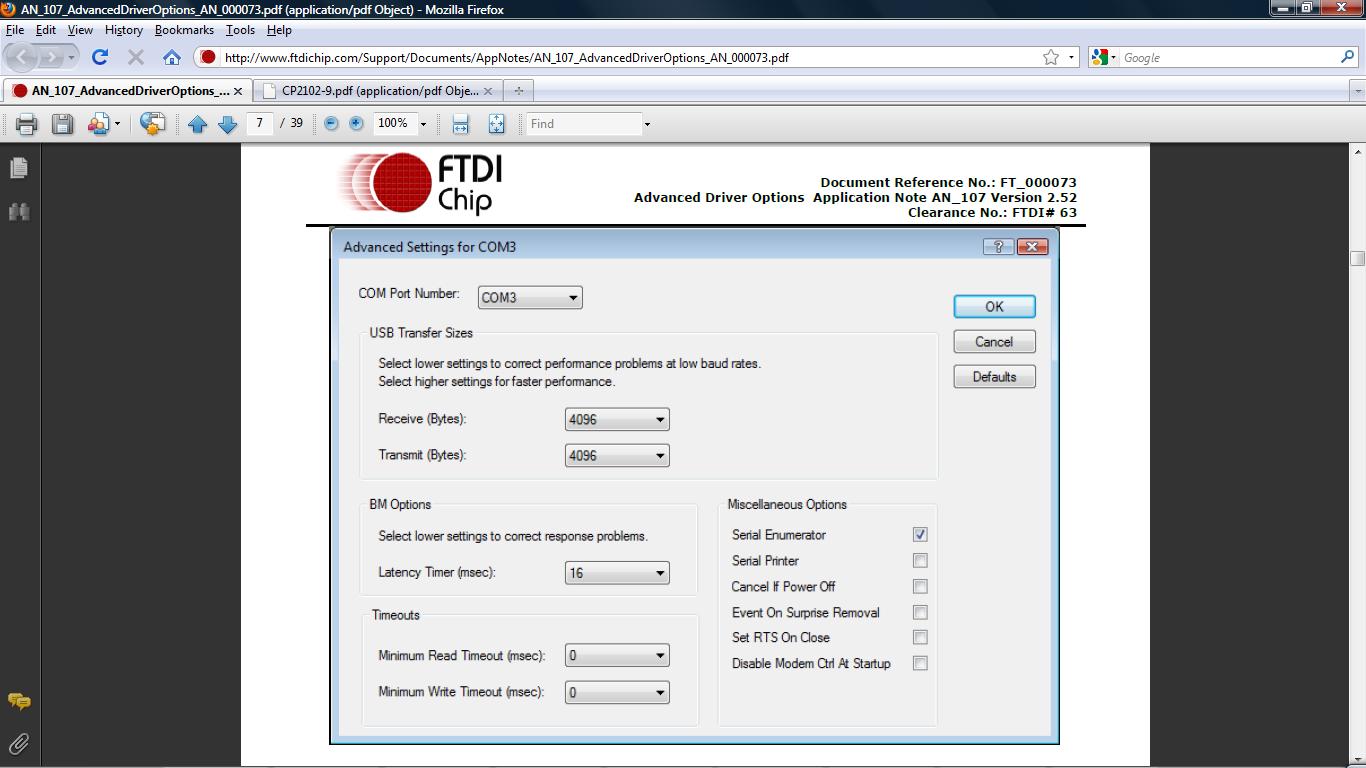

    FTDI has the best driver options so I would vote it best overall. Prices vary but in general the FTDI module is double the cost of the Silicon Labs module though. But double still isn't much.
    It's excellent that you can set the latency and read/write timeouts.

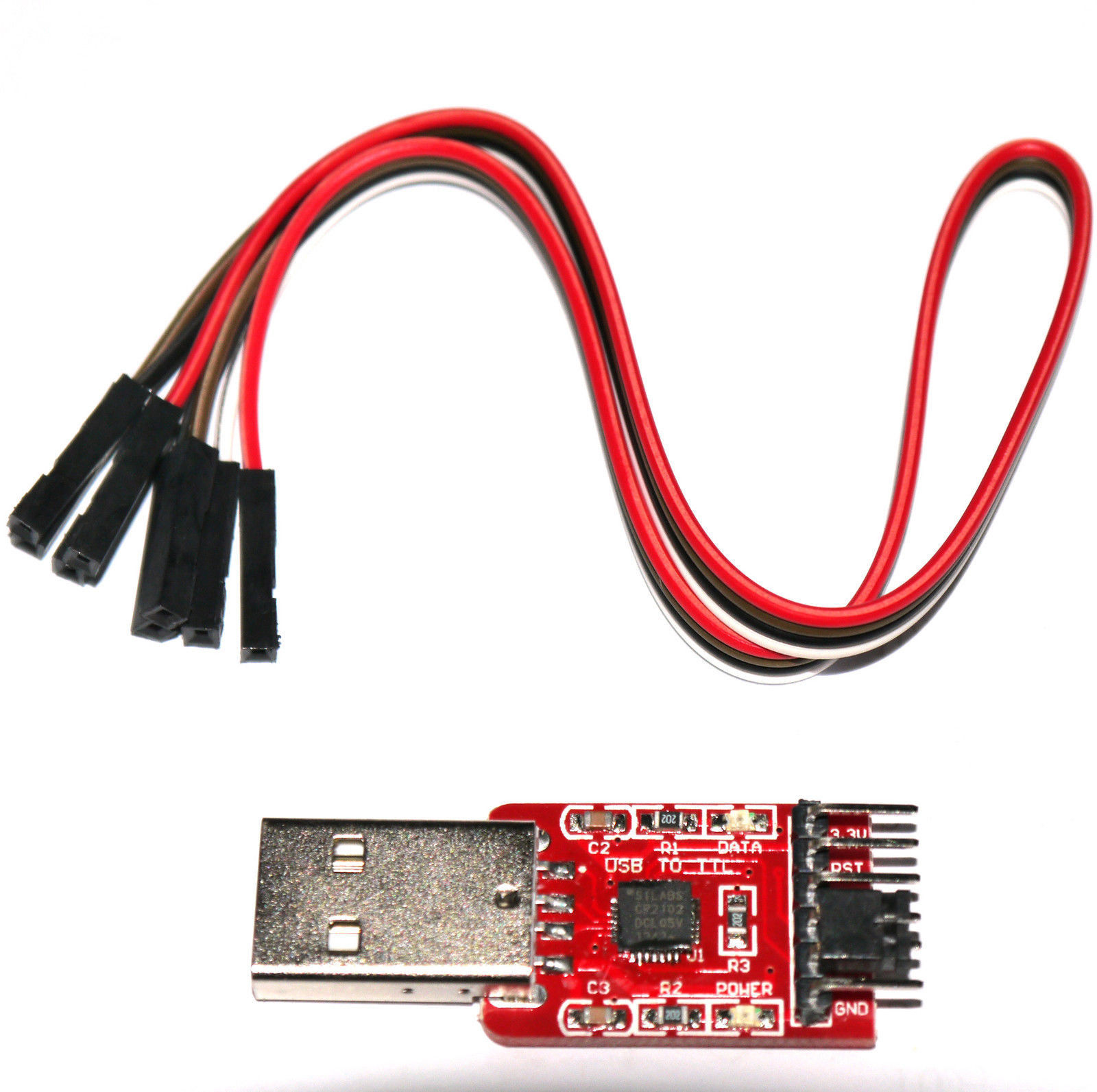

    i still have Game Manager crashing sometimes. I changed my USb converter for one with a cp2102 chip, i changed baud rate for 9600 (instead of 115200) but it's the same.
    For the moment never in game (i don't play a long time constantly). I let the 2 software of Simtools open and when i came back to my computer, Game Manager is close. :( (In 90% of the case)
    Edit: i run with V1.1
    It just happened in game (RF2). The axes begin to have some strange movement and after they stop because Game Manager is close.
