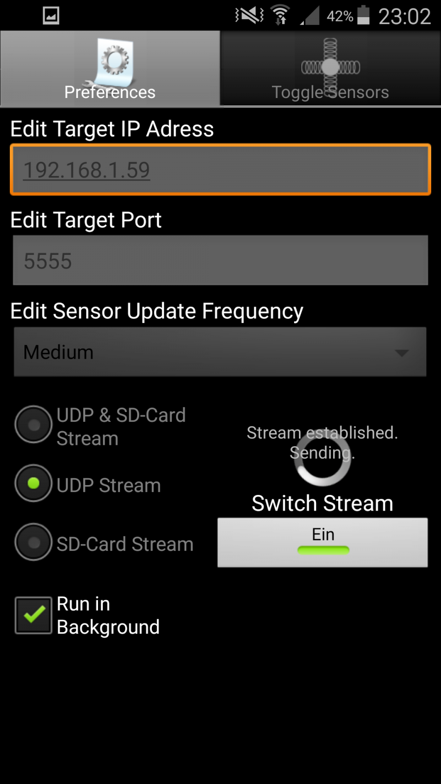

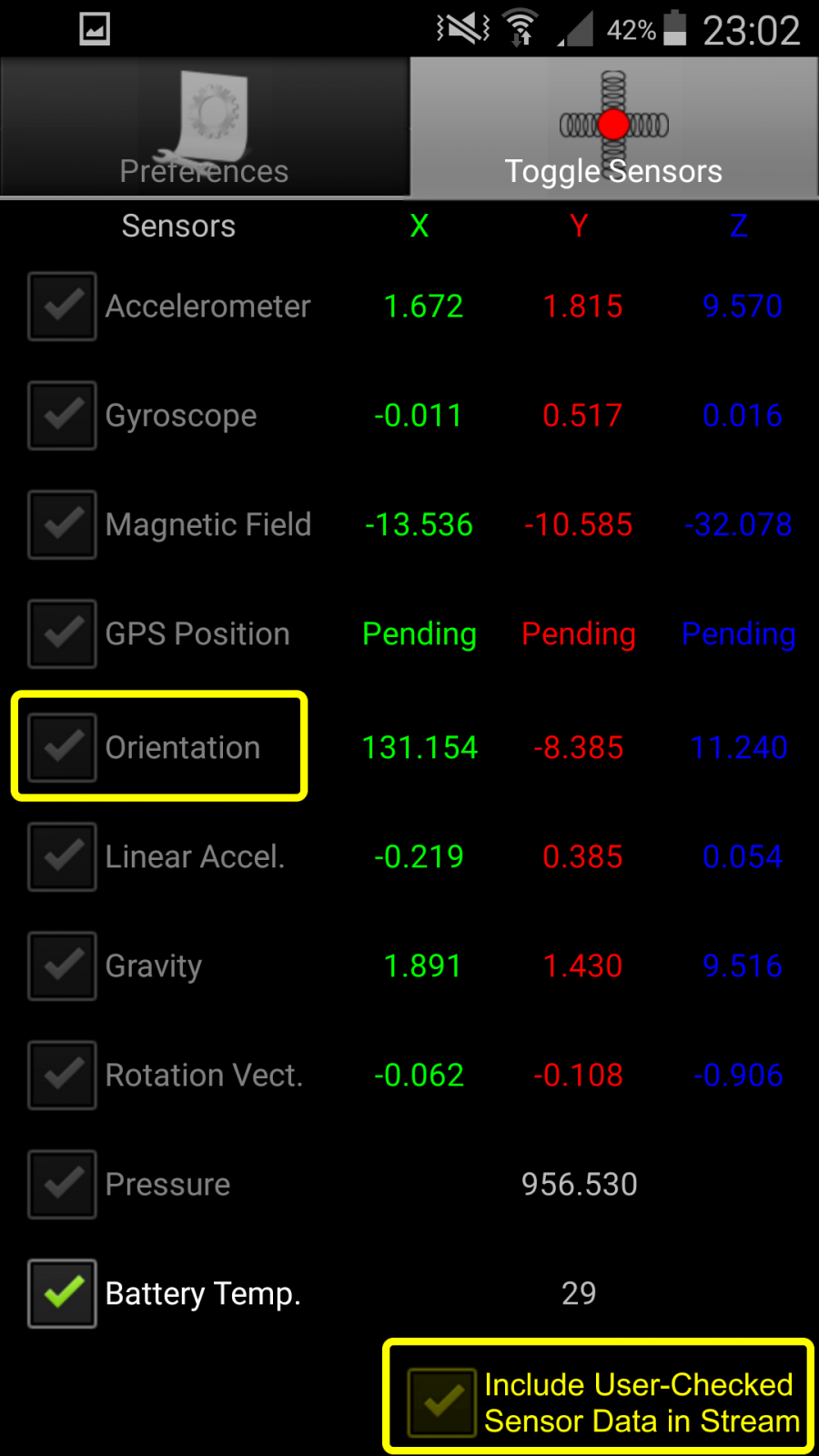

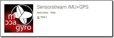

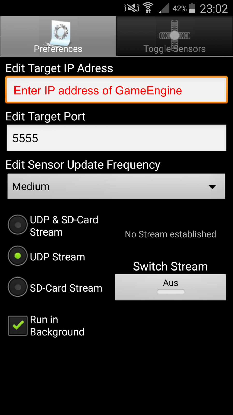

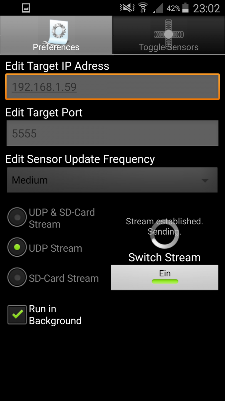

    Give this plugin a try.
    The assumptions are that the Accelerometer sensor in the UDP datastream has ID 3 and the Orientation sensor has ID 81. This is at least the case for my Samsung and HTC phone.
    Enter the IP address of the PC where GameEngine is running:
    The Accelerometer is automatically selected. If you want to add Orientation (pitch, roll, yaw), check the Orientation checkbox and the "Include User-Checked Sensor Data in Stream"-checkbox.
    Select UDP & SD-Card Stream or UDP Stream and switch stream on.
    Now select in GameManager the Sensorstream plugin and click on the upload_2018-6-20_23-25-57.png
    GameManager will turn blue and you can see the data in TuningCenter and in the Output Testing/Virtual Axis tab of GameEngine.
    Let me know please how it works.
