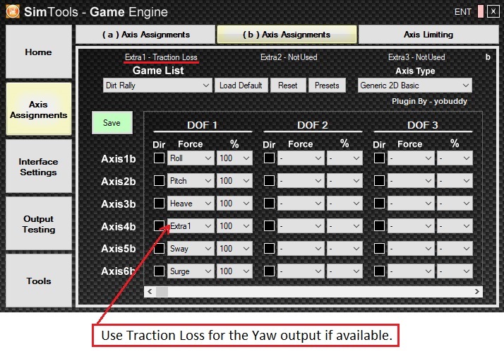

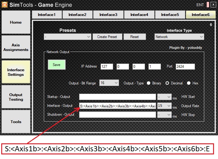

    @lysa elec,
    Setup GaneEngine just like the setup pics show that come with the Video Ride Recorder download.
    Do that and you will get telemetry to record.
    Take care,

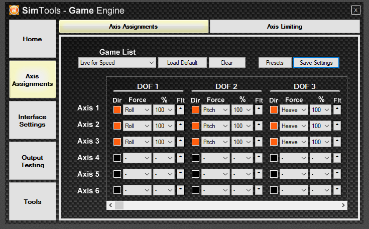

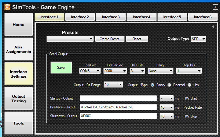

    i try assetto competizione and i have the same problems
    here my setting
