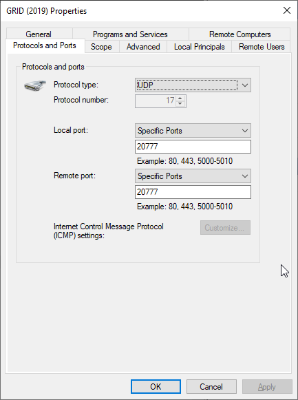

    just open port on your firewall ( create a rule and put udp port in it )
  11. Xcrosz
    Xcrosz New Member
    May 15, 2019
    6
    60Coins
    Like this? I tried and still not working :(
  12. paulopsx2
    paulopsx2 Active Member
    Apr 2, 2016
    616
    brasil
    649Coins
    +166 / 2 / -0
    nope. local port and remote cant be the same

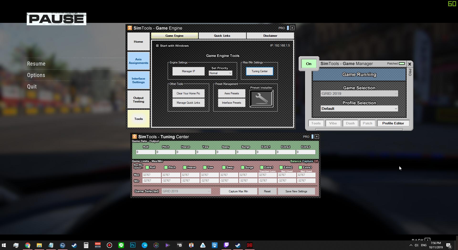

    Hi Xcrosz
    After patching the plugin should be working without fiddling with the game. There is no need to change settings in the game or properties of the game. Unless there is an error in my plugin, of course!

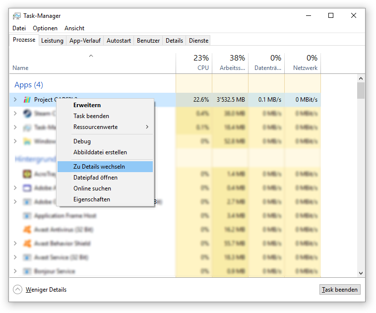

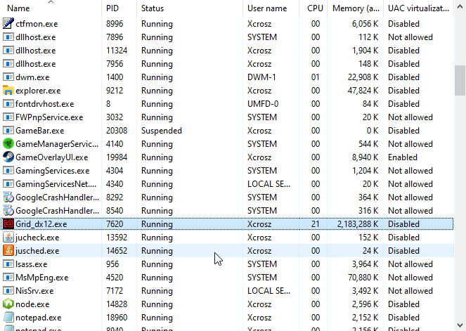

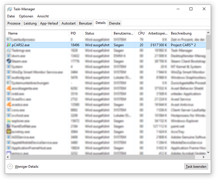

    Can you please do some checks:
    • What is the exe-name of the game?
      Press
      <Ctrl>-<Alt>-<Del> to open the Windows Task-Manager
      Right-click on GRID 2019 and select Switch to details
      Let me please know the name of the exe-file (e.g. grid_dx12.exe)

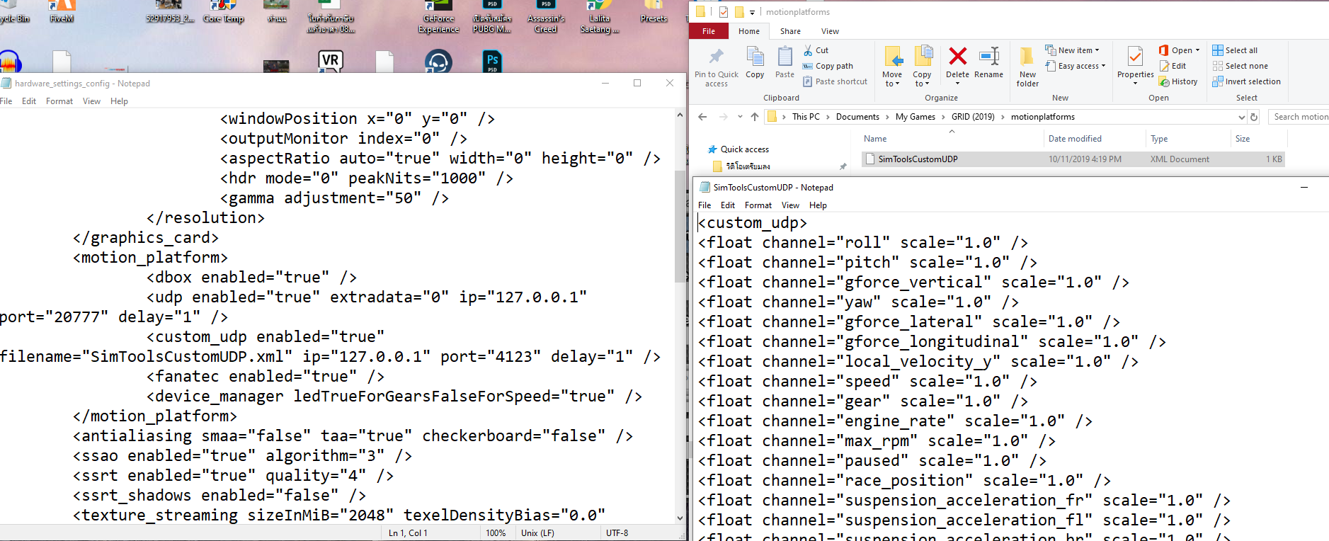

    • Is there a subdirectory in C:\Users\Xcrosz\Documents\My Games\GRID (2019)\motionplatforms ? And is there a file SimToolsUDP.xml? (The name might be different but similar, I cannot remember by heart.)
    • Is there an entry in the file C:\Users\Xcrosz\Documents\My Games\GRID (2019)\hardwaresettings\hardware_settings_config.xml
      Code:
      <custom_udp
          enabled="false"
          filename="SimToolsUDP.xml"
          ip="127.0.0.1"
          port="4123"
          delay="1" />
    Thank you in advance!
  14. Xcrosz
    Xcrosz New Member
    May 15, 2019
    6
    60Coins
    Yes. I have that all. Actually i remember this issue. It's happen in F1 2019 either. I think the problem is Grid 2019 run in DX12. In F1 2019 it can choose to run with Dx11 and working with motion. I think if i can change to run Grid 2019 in DX11 it will working.

    So
    ✔ the exe name is correct.
    ✔ patching works as intended
    ✔ the files and the entries in the files are correct.

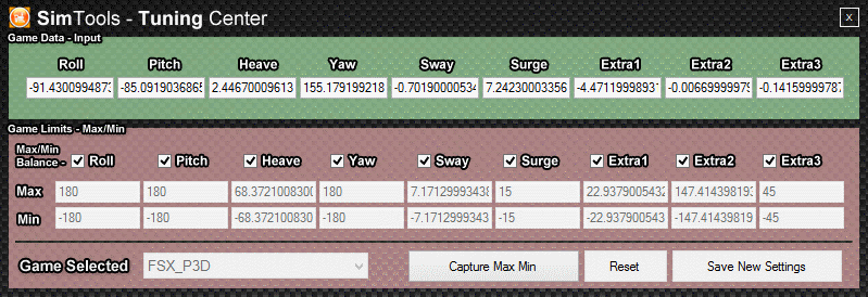

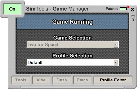

    • Does GameManager turn blue and say Game Running?
    • Do you see flickering data in TuningCenter?
    I have not found a DX11 exe in the GRID (2019) directory. If you can switch to DX11, please let me know the name of the exe.

  17. Xcrosz
    Xcrosz New Member
    May 15, 2019
    6
    60Coins
    Sadly Tunging Center not like you :(
  18. Xcrosz
    Xcrosz New Member
    May 15, 2019
    6
    60Coins
    Ok. I tried to change the Game Limits-Max/Min it's working now. Thanks for your help. So someone have a best setting in this part?
