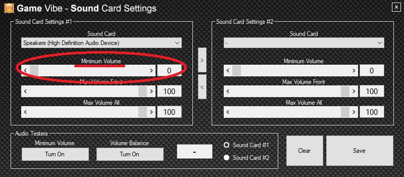

  3. yobuddy
    51,780Coins
    +5,206 / 19 / -0
    I bet you have the Min volume slider under sounds settings set incorrectly?
    Can you show me a screen shot of your sound card setup buddy?
    Chat soon,

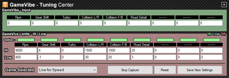

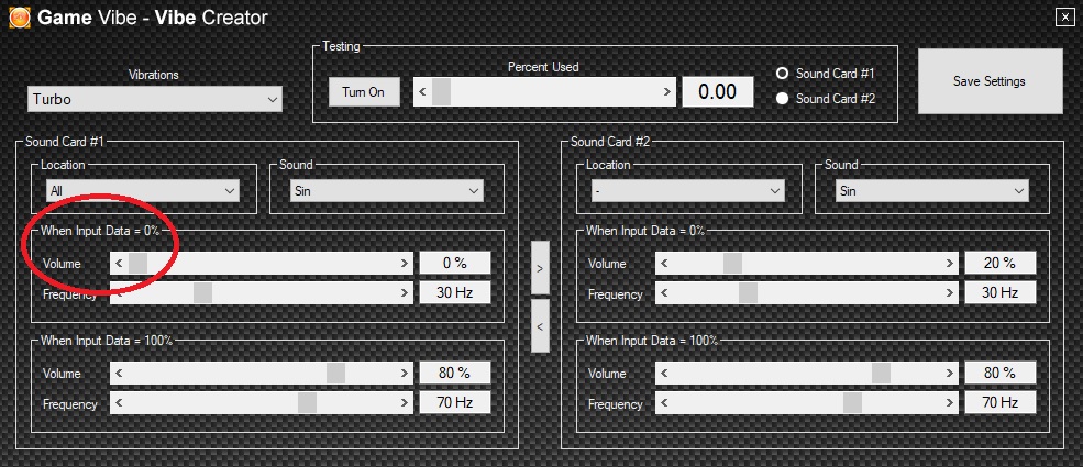

    I recommend that you control the volume by your PC sound card; the possibility of burning your amplifier is great by doing this straight from the vibe creator because the whole signal is injected at once, at maximum volume.
  14. yobuddy
    51,780Coins
    +5,206 / 19 / -0
    There is your problem.
    try 0-100-100
  15. yobuddy
    51,780Coins
    +5,206 / 19 / -0
    Set this setting to zero and test again please.
    Your setting what the minimum volume is for GameVibe.
    If you set this at say 50%, the lowest volume it then can achieve is 1/2 full volume.
    With multiple Vibes on the same kicker, unless the inputs for the vibes are zero, the kicker will sounds like its at max volume.
    If I am only using RPM for a single kicker, then I can run the output at 100%
    If I'm running both Turbo and RPM on the same kicker, I set each to 50% or at least make them total 100%
    I hope this helps guys!

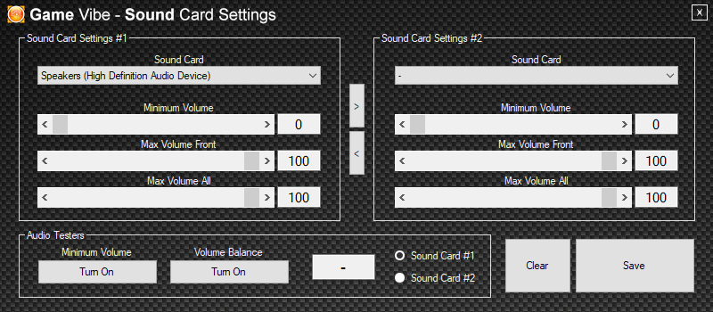

    600
    1,006Coins
    +103 / 3 / -0
    I thought you were talking about this setting.
    I am at 0 on this setting.
    so there is a problem with the volume, 0 is 0, but 1 is 100%

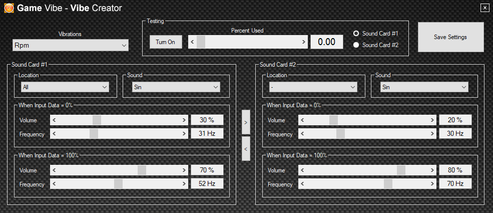

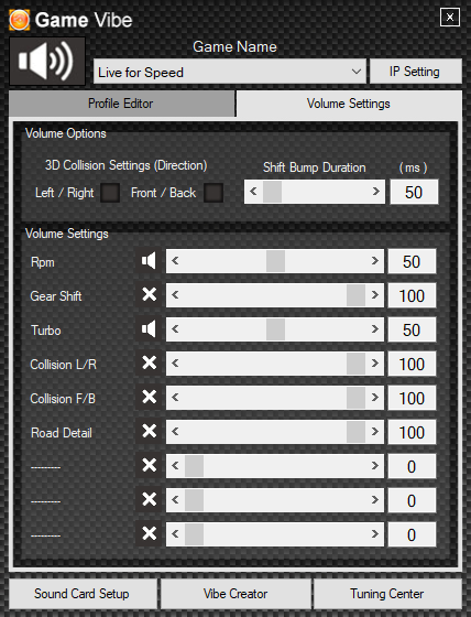

  17. yobuddy
    51,780Coins
    +5,206 / 19 / -0
    It's either your min/max settings for the game then and/or your vibe sound settings are not quite right.
    I would suggest that people tune in one vibe at a time.
    (I would start with RPM and get it working right first, then move on if you want more vibes)
    Do you have it set to be at 0 volume when the input is small?
    Maybe you have it set to high?
    Either way thou, lets just work with rpm first. :thumbs

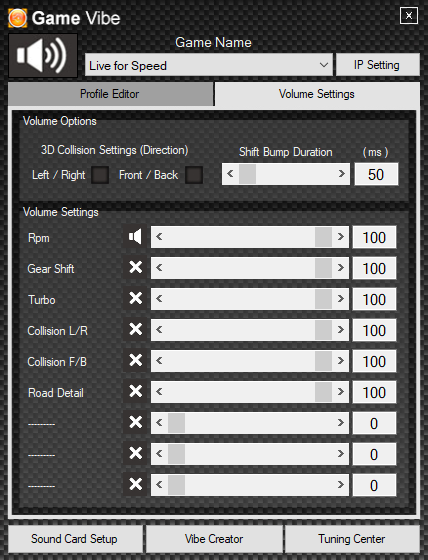

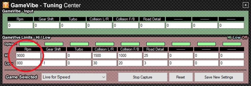

    Please set your settings like this,
    Now sound setup (frequency's don't matter much - use what works well for your setup)
    Sound Card settings, (just use one card for now)
    Set some valid Hi/Low values for RPM
    These settings should get rpm working correctly.
    Please try it and see what you get buddy.
    Take care,

    yeah.. 0 - 100 -100 its my first try.. default from gamevibe.
