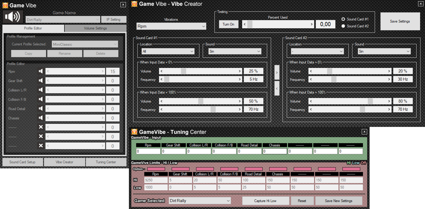

    Hey all,
    How to use the Profile Management?
    I would like to save multiple profiles (for each car in Dirt Rally).
    But somehow I can't find a way to save different settings per profile (it resets or something...)
    My steps: setup Tuning Center, Vibe Creator and Profile Editor. Than copy profile, name it.
    Than change settings, copy profile, name it. Now both profiles are exactly the same (including Default).
    And how can I save the current profile after changing a setting?
    I'm just testing RPM (till I know how it all works).
    See picture for my current RPM settings for the Peugeot 205 in Dirt Rally.
    For the classic mini I just have to raise the volume RPM in Profile Editor to 15 and I'm happy about it.
    Thanks!

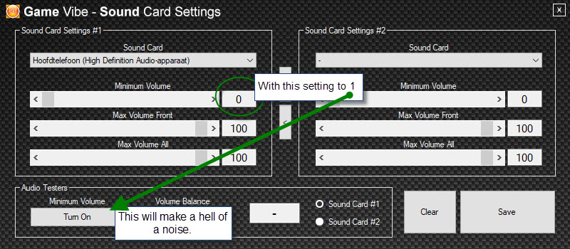

    If I put my Minimum Volume in Sound Card Settings to 1 and I test the Minimum Volume it's sounds like the volume is 100, very loud!
    With the setting to 0 (which is my default setup of the sound card: 0-100-100) than the test remains silent as expected.
    Am I doing something wrong? (see picture of sound card settings and explanation of my "issue").
    I only got 1 bass kicker (Pearl Throne Thumper THMP-1) for output.

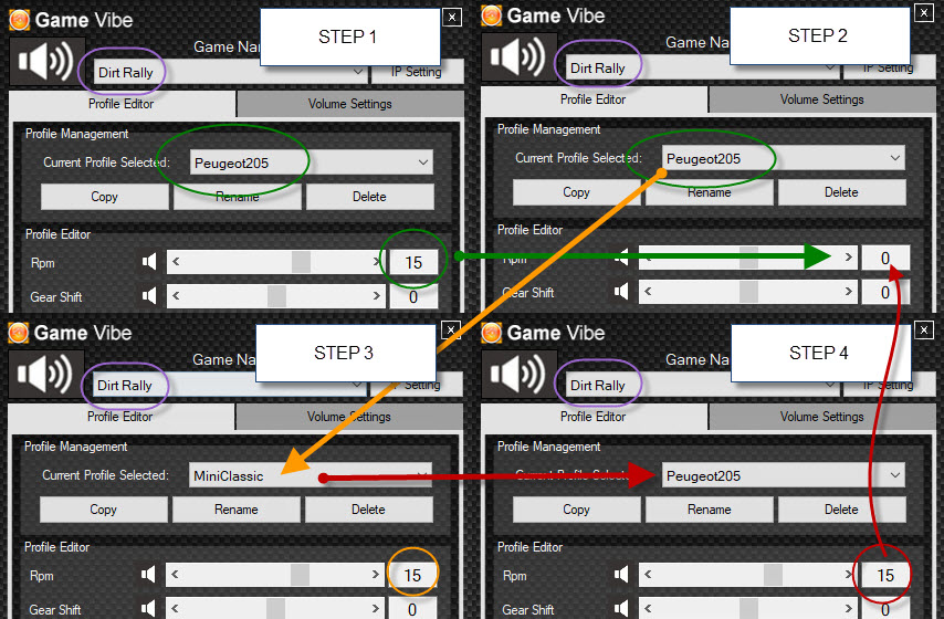

    Deleted member 30486
    Can someone help me with my issues?
    Especially with saving a profile; it doesn't seem to work.
    Changing one profile will also change the other... I am clueless.
  9. yobuddy
    51,780Coins
    +5,206 / 19 / -0
    There is only one set of Vibe settings.
    Set the sounds up so they work best on you system and your all set.
    The profile page adjusts the Hi/Low values for a given game by up to +-50%.
    You can adjust these live while playing a game.

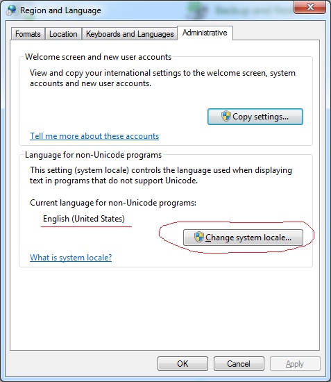

    As for the other problem, will you please change your settings like this and give it another go.
    I can not get full volume with the setting of 1 is why I ask.
    Let me know how it goes buddy.

  11. yobuddy
    51,780Coins
    +5,206 / 19 / -0
    I was asking @wijnants_d to try the region change (as I can see commas in his pics).
    It should not make a difference, but I still can't get 100% volume with a min volume setting of 1, so its worth the try.
    This is what a beta is for thou, iron out the bugs.

  13. Deleted member 30486
    Sorry for the late reply; had to work all weekend.
    Changed my region settings and the issue of max volume at 1 is resolved.
    The range to set the minimum volume (and get response of the kicker)
    is 1 - 8. From 9 till 100 it's not responding.
    Therefore the volume at 1 is louder than expected.
    I ques this is because of the volume button of the hardware (throne thumper receiver) which is set low (marker pointing left).
    For the other issue I'm not sure I understand.
    What use are multiple profiles?
    See picture that shows my steps to setup the profiles.
    The last step shows that my change in another profile also changes that profile.
    Thanks again!
  14. yobuddy
    51,780Coins
    +5,206 / 19 / -0
    Nice, I'll take a look as to what may be causing the problem.
    I can't really tell you about hardware settings as everyone is using different stuff.
    I can replicate the bug, it only happens if you change the profile used after you make a change.
    (basically, does not save the settings)
    If you change the game name after the change, it saves as it should.
    thx, ill fix it!
    So you can tune in other vehicles as needed on the fly.
    (alter the Hi/Low settings as needed per vehicle)
    chat soon,
