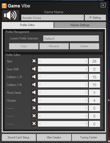

    3DOF, Motion platform

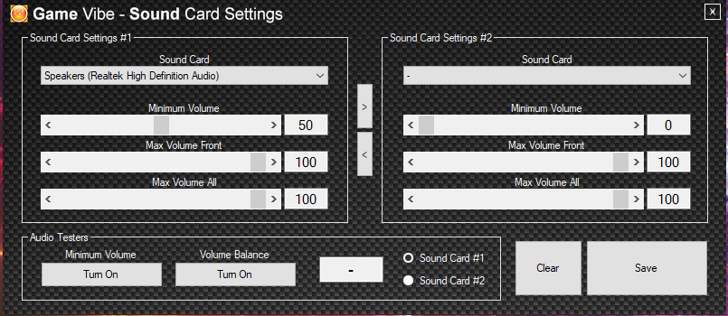

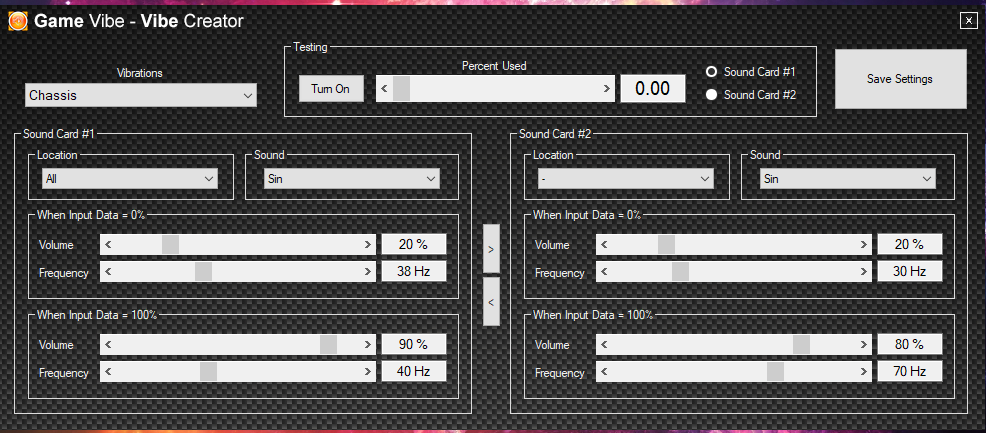

    Hi guys, I have been trying to get Assetto Corsa to play ball with Game Vibe. Game Engine is working fine, I get fully working motion with my platform.
    But no matter what I try, I cannot get any vibes to go to my buttkickers when using AC.
    Audio is working just fine as I am able to test with the vibe creator.
    It seems I am missing something obvious! Help please.

    @TR1PL3D,
    Please set the Min Vol (Sound Card Settings) to '0' unless you really need it like that?
    What do your Hi/Low values look like for the game?
    Also, you RPM is muted.
