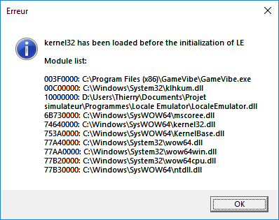

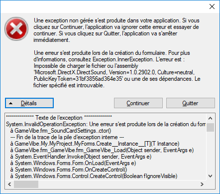

    I have a problem with Game Vibe that gives me the same message from error as Bacon2002 but unfortunately its solution did not solve my problem. Would you have an idea to help me solve this problem? I launched DxDiag which did not find an error.
    I will attach you in PDF the complete error message.
    Thank you for your help.
    Thierry

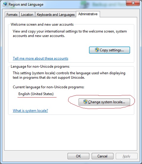

    22,230
    154,849Coins
    +11,229 / 57 / -2
    Try changing the computer language settings to English local: https://www.xsimulator.net/community/faq/simtools-language-setting-bug-change-to-english-local.233/

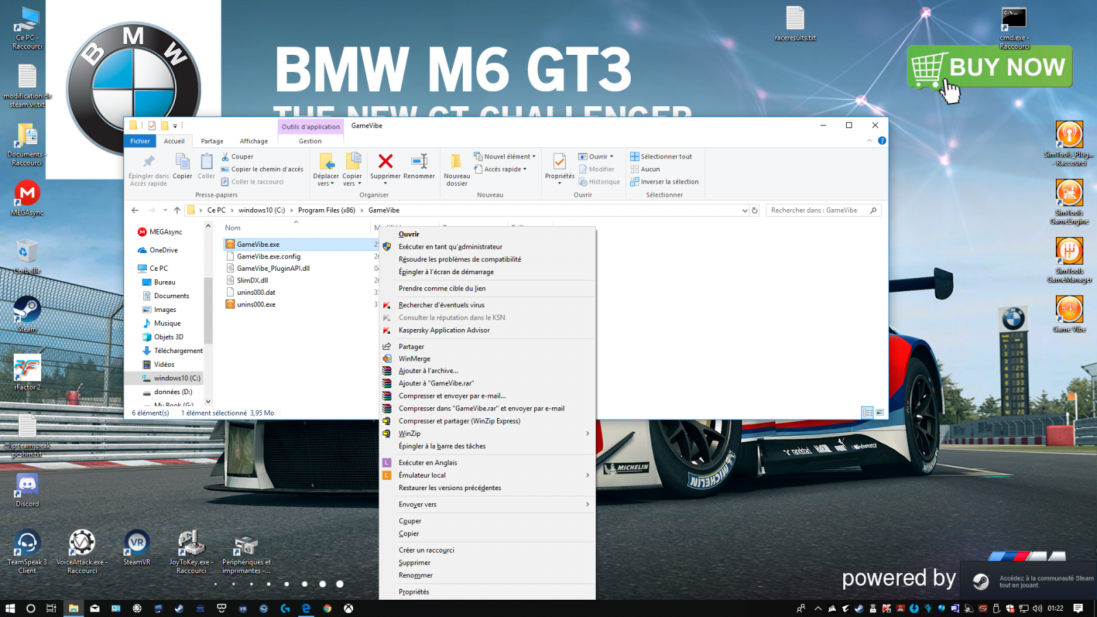

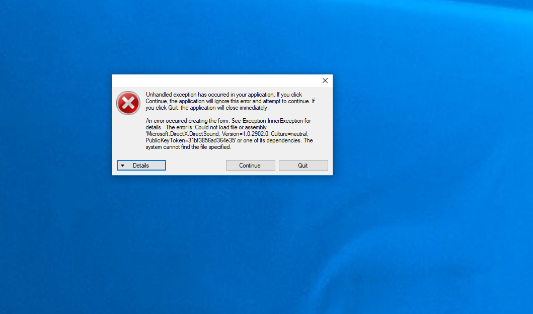

    Thanks for your help but no I have not running multiple copies. After a initialization of Windows I right click on GameVibe. exe and click Execute in English and I have this error message:(
  9. yobuddy
    51,780Coins
    +5,206 / 19 / -0
    It seems the problem is with the local emulator you are using.
    Are you using a 3rd party app for this?

    Hello!
    I'm having a bit of trouble with gamevibe.
    I have a motion sim as well. This works with simtools and use Iracing as my game. I get transducer activity when testing in gamevibe. I also get telemetry in tuning center. When I start to capture telemetry a small window pops up which I can press ok on. It says gamevibe3. After that I stop capture, but when I start to drive. No activity.
    Got questions: I've been testing without turning on power on my motion rigs controll boxes. I get a message when starting up game engine that I need to restart because some of my interfaces are missing. Is this a problem for gamevibe?
    I've read through this thread, but haven't been able to find a solution. Please help!

    @yobuddy
    Hello man! Thank you for the software!!! Its been working great with my motion sim. Now I did as you told except on my menus I could choose "English(USA)". I assume it is the same as "united states" right?
    I was asked to restart computer. Did that. Loaded up the 3 apps, gamevibe, simengine and game manager. Started logging telemetry. Got two pop ups that said "gamevibe 4" and I also got the "gamevibe 3" pop up on next try. Last try telemetry logging stopped as soon as I started doing anything inside the sim. I draw this conclusion as rpm logg had stopped at 3500 aprox, and I had revved up to 9500. Telemetry logging stopped, but I could still press start/stop and save.
  15. yobuddy
    51,780Coins
    +5,206 / 19 / -0
    If your getting this then I think the region is still wrong.
    This is something i hope to have fixed in the future, but for now please choose another regions etting.
    (It should be using a period as a decimal point)
    Take care,
  16. PetroVitallini
    PetroVitallini Member Gold Contributor
    Dec 23, 2016
    71
    Norway
    248Coins
    +31 / 0 / -0
    Ah ok, I think I understand what the problem is now. Away at work so can’t test now. Instead of trying to find a compatible region setting it might just work to just change the decimal symbol under formats -> additional settings.

  18. Otto Ipsen
    Otto Ipsen New Member
    Oct 13, 2018
    9
    Tomelilla
    57Coins
    I would love a solution as i have the exact same problem...
  19. Otto Ipsen
    Oct 13, 2018
    9
    Tomelilla
    57Coins
    Worked!!! Thank you !
