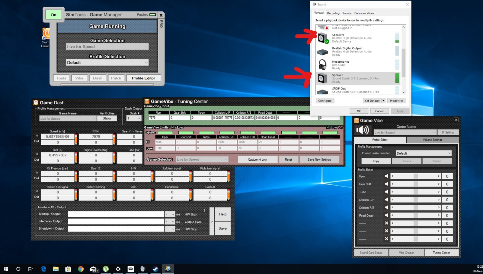

    im facing problem with the vibe. im using 2 sound cards one mother board reltek for game sound and second external sound blaster for the game vibe.
    LFS is working fine for the vibe.
    the problem with other games like AC and PC2. every thing fine with the software. the vibe shows the RPM and other elements and also the game vibe tuning center shows the numbers but the problem the sound do not come from the shaker. maybe its a windows issue or steam????? any one have any idea???
    22,230
    154,849Coins
    +11,229 / 57 / -2
    I have an issue with PC2, which for me does not register the game vibe plugins, but I expect that is a plugin issue.
    However AC works fine, so I am wondering about your tuning settings for it, if testing works fine and data is present in the Tuning Center.

    yes the data are presented in the tuning center and testing the sound card from the vibe is ok.
    do you mean i have to do the vibe tuning center setting to make it work??? capture the H/L values???
    22,230
    154,849Coins
    +11,229 / 57 / -2
    The Game Vibe volume needs to be enabled and set, plus capture then tweak H/L values in the Tuning Center.

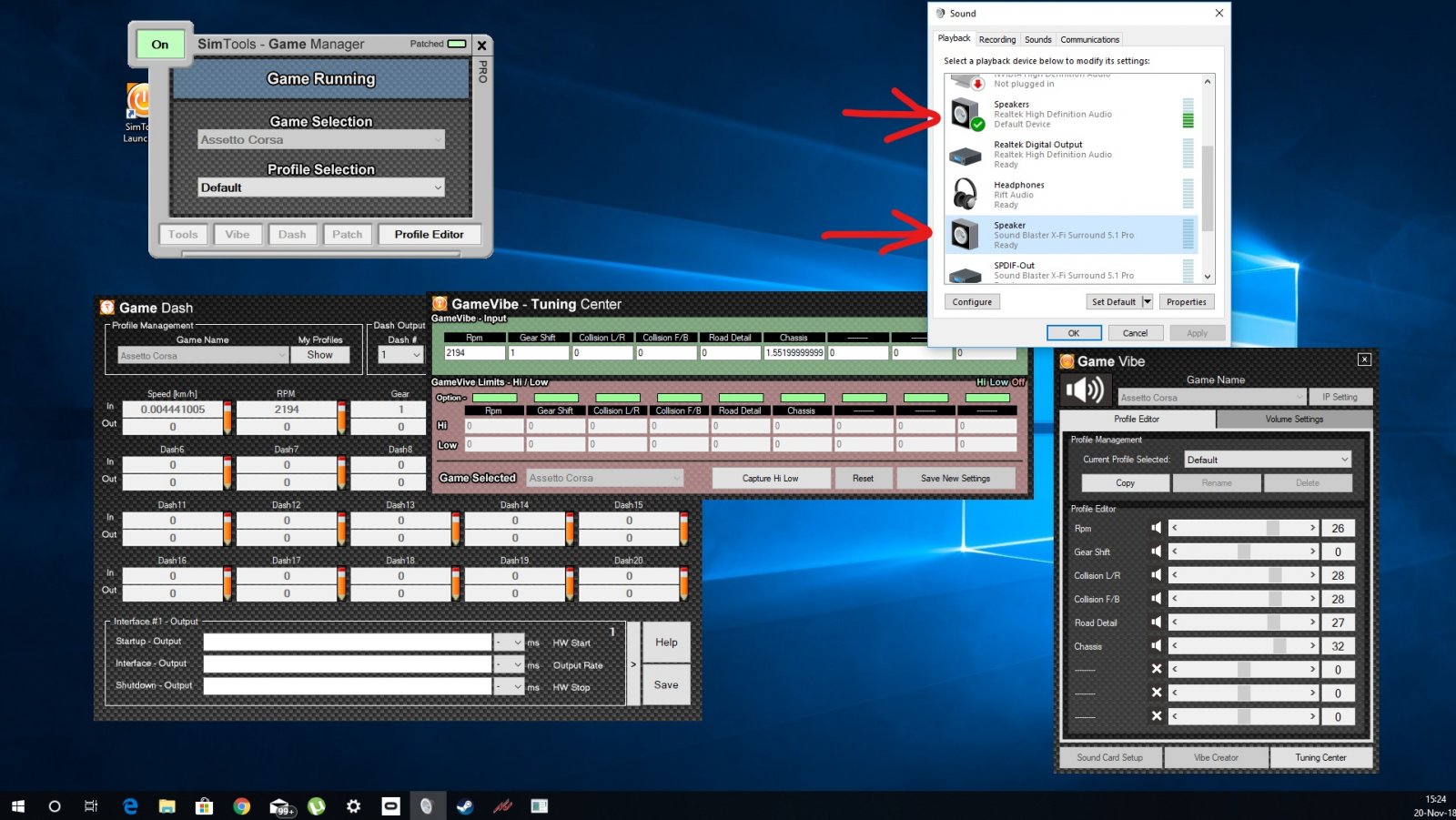

    i checked the sound settings in windows
    for LFS game sound comming from the reltek sound card and game vibe from usb sound blaster
    for AC game sound ok but no vibe
    do you have any idea????
    22,230
    154,849Coins
    +11,229 / 57 / -2
    There are no Hi/Low values set in the Tuning Center for Assetto Corsa, so run capture, drive a bit, save it then tweak as needed.

    @noorbeast thanx its working now i will try it for PC2 and other games.

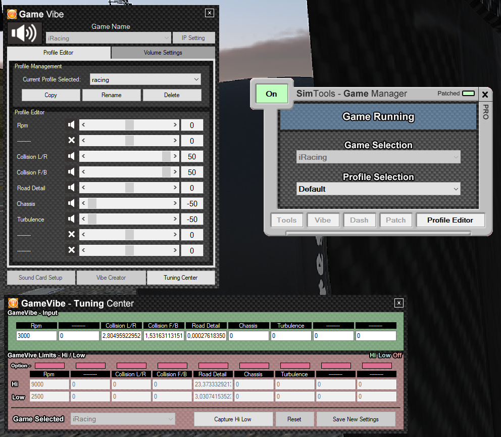

    Hello
    Is it true that I do not have a vibe for gear shift with iracing?
    Guus.
    22,230
    154,849Coins
    +11,229 / 57 / -2
    Have you configured it and can you please post a picture of your settings.

    RPM and Road detail works just fine....but I miss the kick in my back ;)

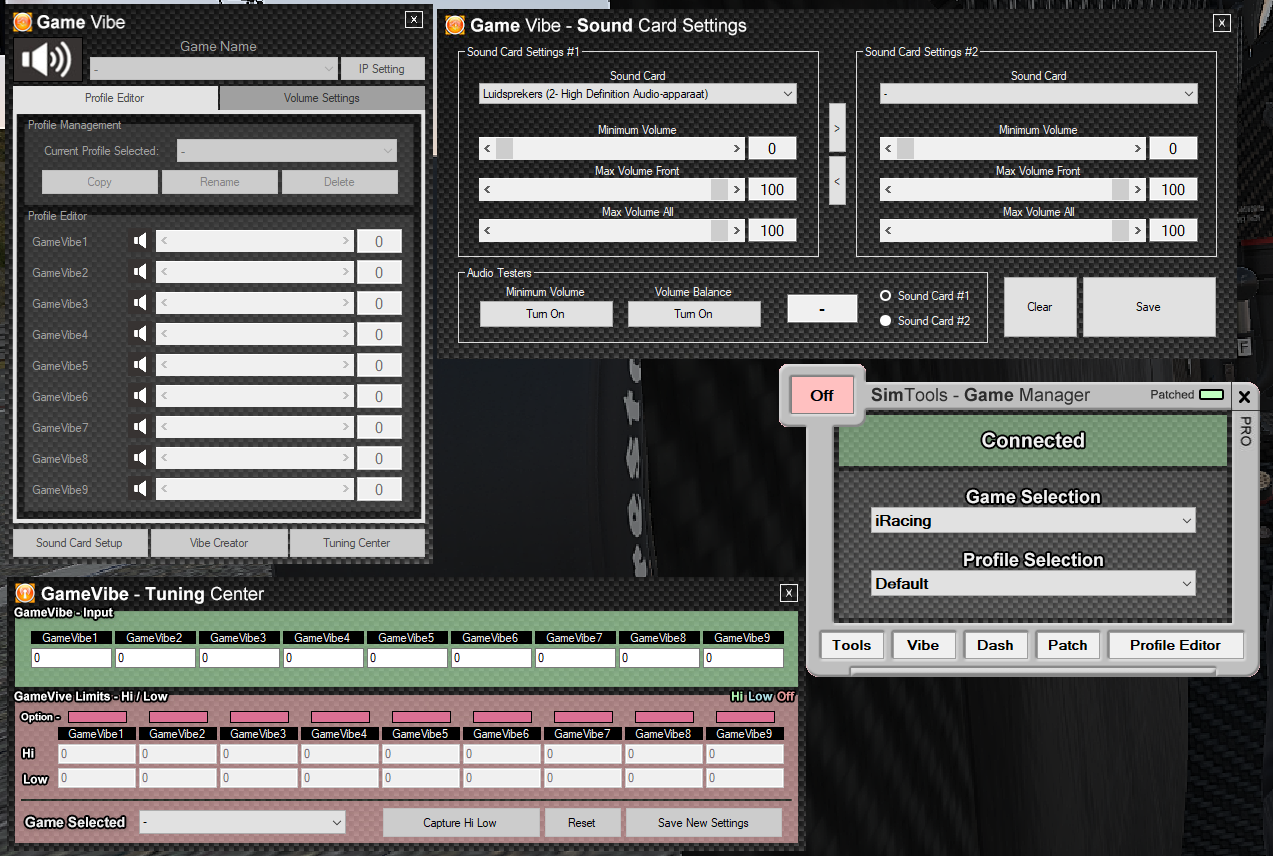

    I got the problem with the min sound is off...very loud and then off again. Very similar to the problem that was solved with the regional settings. For me changing the regional setting did not fix it. (Swedish initial)
    My initial problem with the sqr wave is still there to. Tried another sound card too. All other wave forms work (when listening on the sound).
    Is it just me or someone else experience the same?!?
    Thanks!

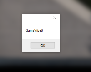

    I have been struggling several hours to get gamevibe working on a windows 10 enterprise because of the "unable to create form" error. The issue was not with DirectX but with the .Net framework 3.5 which is required by gamevibe and not installed by default on Windows 10. Installing it using the windows roles/apps/features kept failing.
    I finally had to install it using the ISO of windows 10 and an elevated powershell command :
    PS C:\Windows\system32> dism /online /enable-feature /featurename:NetFx3 /all /Source:E:\sources\sxs /limitaccess
    Outil Gestion et maintenance des images de déploiement
    Version : 10.0.17763.1
    Version de l’image : 10.0.17763.379
    Activation de la ou des fonctionnalités
    [==========================100.0%==========================]
    L’opération a réussi.
    In my ISO under sources/sxs I have for info:
    PS C:\Windows\system32> dir e:\sources\sxs
    Répertoire : e:\sources\sxs
    Mode LastWriteTime Length Name
    --r--- 06/03/2019 02:29 31331 Microsoft-Windows-InternetExplorer-Optional-Package~31bf3856ad364e35~amd64~fr-FR~.cab
    --r--- 06/03/2019 02:30 1509278 Microsoft-Windows-NetFx3-OnDemand-Package~31bf3856ad364e35~amd64~fr-FR~.cab
    --r--- 06/03/2019 02:06 305497 microsoft-windows-internetexplorer-optional-package~31bf3856ad364e35~amd64~~.cab
    --r--- 06/03/2019 02:09 72729053 microsoft-windows-netfx3-ondemand-package~31bf3856ad364e35~amd64~~.cab
    Then reboot, re-install directX, and it works !
