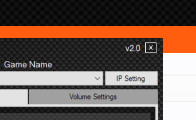

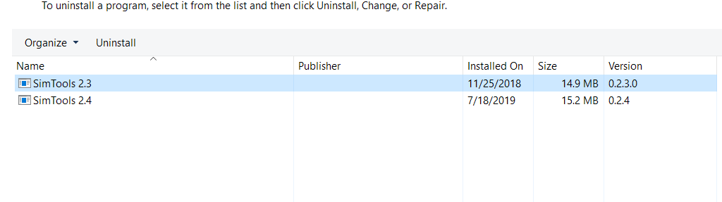

    Thanks @yobuddy, I grabbed my mine from the simtools site after upgrade of license. It appears to be v2.0:
    But I installed Simtools v2.4 on top of v2.3, I wonder if there's some conflict. To my surprise, I still see v2.3 in the control panel:
    Lastly, I do not think I have .NET 4.6 installed, highest I see is 4.5.1, I wonder if that is the issue. Also, crash seems to be in SlimDX/Xaudio - are those built against 4.6 as well?
    However, if it was dependency issue, wouldn't tool crash all the time? It crashes only sometimes, and it seems to be related to the startup order of SimTools/GameVibe/Game. I am getting my transducers/amp today and will update if I figure out the exact sequence that leads to crash.
