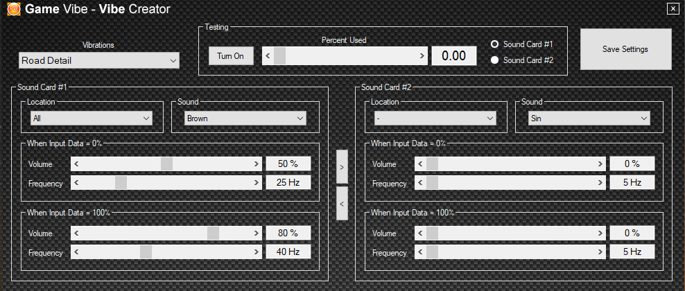

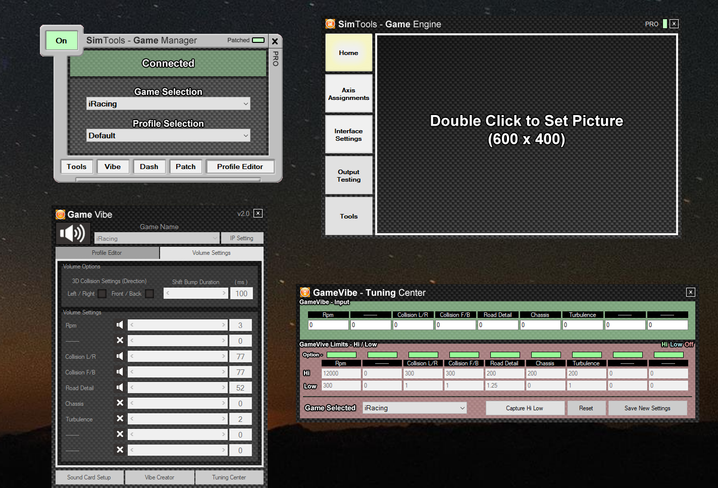

    I have a question about Road Detail and Chassis vibes. I was able to make Chassis work fairly decently by lowering the lower bound. I followed tutotrial in post #2 and if I capture Lo the way it is suggested, I get pretty much no vibes for chassis. But anyway, I am unblocked on that one.
    My question is: I set my Lo/Hi as you suggested, but it seems to me that Road Detail is the one I get kerbs and bumps from, and Chassis feels more like a road surface feel, and there's little to none feel of kerbs in Chassis vibe. I thought that sensations will be the opposite (based on post #2) - Road Detail will communicate road surface, and Chassis will be bumps. Could you share your insights on this? Or, maybe this is plugin/game dependent? Thanks!

    Road Detail can be either, if you set the Hi to a big number it more like road noise.
    A lower number will pic up more bumps as you said.
    Chassis works like like the road noise above, so if it now sounds more like road noise, maybe lower the Lo number a tiny bit.
    And then set a Hi number to a tiny bit over the number you have now.
    I think you will find that you now have bumps, but they are also in 3d.
    Give it a shot and let me know how it goes buddy!

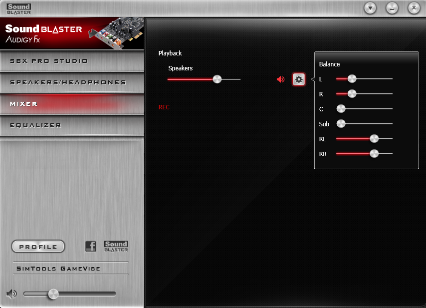

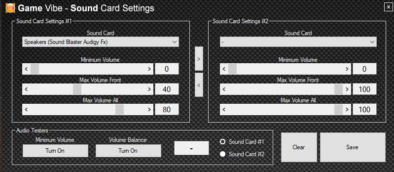

    I have a volume problem I'm hoping someone can help with.
    While in iRacing or RRE the rear transducers for road detail are barely noticeable no matter what settings I try.
    The 'volume balance test' produces even sound levels between FR, FL, RR, RL, all.
    Collisions are set to 3D and FR, FL, RR, RL have the same volume levels.
    Road detail is set to ALL and the rear transducers are very faint while the front are strong.
    I tried every combo of 'front' and 'all' in the sound card settings.
    So, collisions in 3D have same volume but for some reason 'All' does not like my rear transducers.
    current setup:
    - Win 10
    - SimTools 2.4
    - GameVibe 2.0
    - iRacing plugin 2.0.3.2
    - RRE 2.0.7.1
    - 2 x 120 watt amplifiers
    - 4 x 50 watt bass transducers
    - 1 x pcie 5.1 sound card
    - 1 amp for 2 front transducers and 1 amp for 2 rear transducers
    - all drivers are up to date
    The sound card is setup for 5.1 surround in win 10 and in the sound card's software:
    - turned off center speaker and subwoofer
    - set front and rear to full range speakers
    I'm sure I'm missing something. Thanks in advance for any help.
    Gary

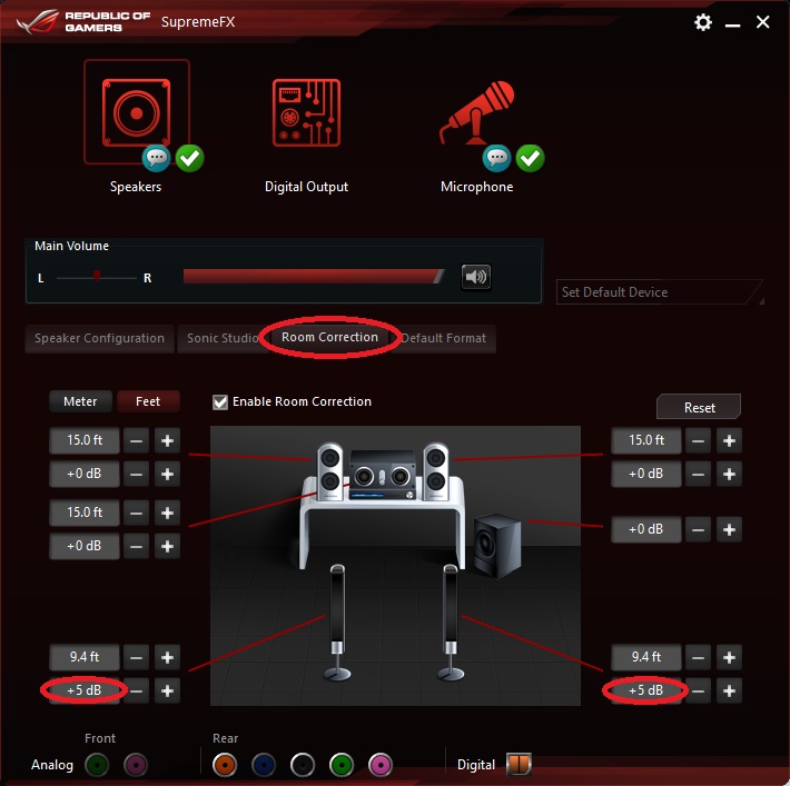

    Is there a distance setting in the sound cards application?
    Meaning it may think the back speakers are further away from center than the front ones are?

    Thanks for the fast reply.
    There is no distance setting and I verified all the correct speaker settings again in win 10 and the software.
    Not sure this has any bearing but I have SimHub for rumble pedals (gas = wheel slip and brake = wheel lock) and tried the bass shaker option and my rear did not work until I set them to channel 5 and 6 in custom settings.
    For me, road detail is not that important, the 3D collision tuned for curbs, bumbs, etc is my immersion sweet spot, but I'll keep testing various settings. :)

    This is the same setup i do also
    But i also have to adjust the range a bit in the driver for it to work right.
    Take care,

    I found the speaker volume adjustment in the sound card's software but the rear are still not felt for 'road detail - ALL'.
    Will keep trying various setting... i'm convinced the right combo is in there ;).
