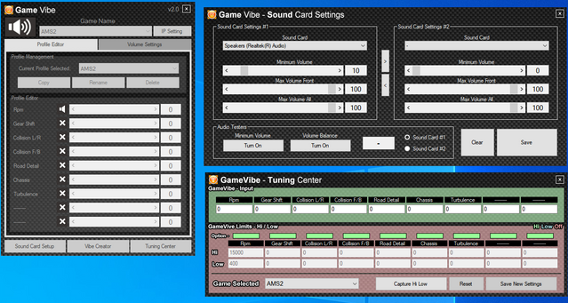

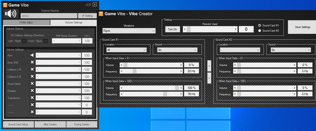

    I recently setup GameVibe with four Dayton Audio exciters to run RPM effect with Automobilista 2, and I'm having a weird issue: While driving there is a distinct "snapping" noise/distortion which is quite loud and occurs at a regular interval (less than 1 second apart). When I press the "esc" key while driving, and get to the initial pause menu, the snapping noise stops, and the exciters rumble without any issues on the pause screen. Besides this obnoxious noise, everything else seems to be functioning just fine. Anyone have an idea how to fix this?
    22,230
    154,849Coins
    +11,229 / 57 / -2
    Could you please post pictures of all of your settings.

    Please help me, @yobuddy , you're my only hope. More troubleshooting tonight, and I've determined that the distortion/crackling/snapping is the result of a change in RPM. If I sit on the track either idling, or with the RPM at max, there isn't any distortion. Is it possible that Windows is adding some detrimental effect as the volume increases/decreases from the RPMs? Almost as if the system is adding an annoying noise whenever the volume changes.

    Maybe configure GameVibe to run a set of speaker, rather than the transducers, and see if the crackling is still there. (it will let us know more of where to look for the problem i think.)
