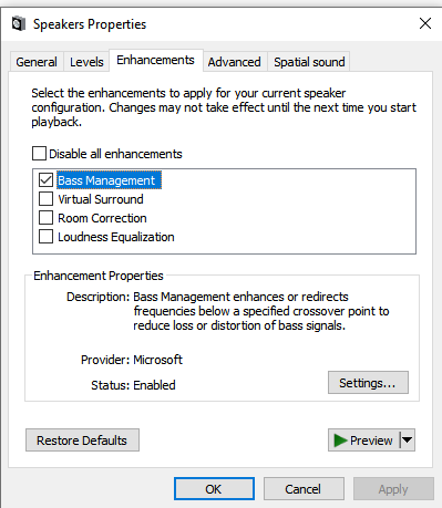

    I've tried it with all enhancements disabled (e.g. bass management disabled) as well. Same result. Am I supposed to hear what sounds like rapid mouse clicking when I slide the "Percent Used" slider in the Vibe Creator? Can someone please experiment and report back when you get a chance?

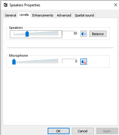

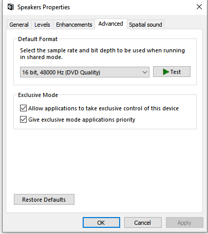

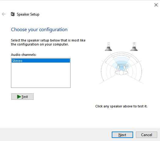

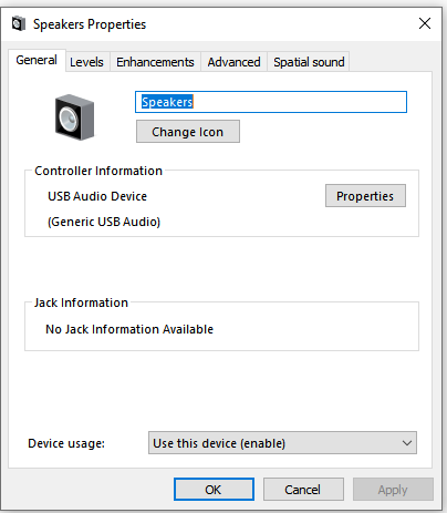

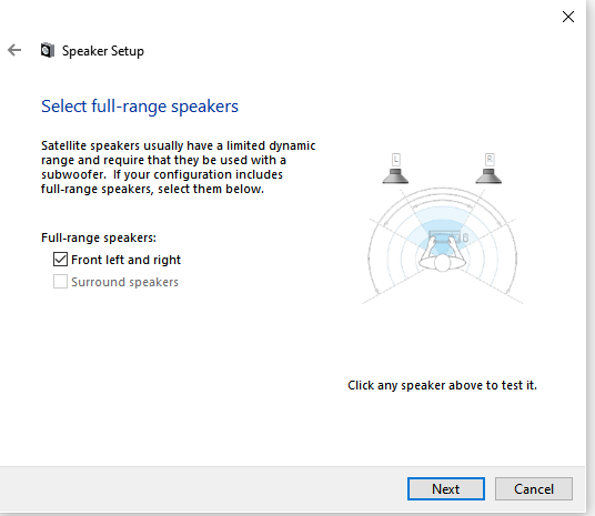

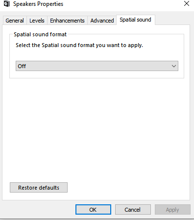

    The new sound card is just an external USB sound device/external DAC, doesn't do anything other than act as a digital audio converter I'm pretty sure. It's selectable as a sound output device in Windows, which you can see in my Speaker Properties where it's listed as a "USB Audio Device". It was suggested by @noorbeast as a troubleshooting step. I've also tried it without the USB too of course. Here is the one I bought:
    Can someone please verify that they do not hear any sort of loud and rapid mouse-clicking type noise while sliding the "Percent Used" slider in Game Vibe's vibe creator? I'm almost positive it has something to do with that since the sound is almost identical to what I'm hearing in the game, and I've been able to determine it's not a problem with AMS2 given that there is no problem with a constant RPM value (e.g. when a car is idling or at redline). Thus, it is a problem with Game Vibe or Windows, or the interface between the two. FWIW, I've also tried playing music through the transducers I'm using, and then changing the music volume with the volume slider within Windows just to make sure there isn't any sort of distortion or weird noises as the volume is changed.
    It would be great if someone with the latest version of Windows 10 could verify that there are no weird noises when manipulating the "Percent Used" slider. I am running out of ideas on my own since I'm not a software programmer and can't take a look "under the hood" of Game Vibe so-to-speak.

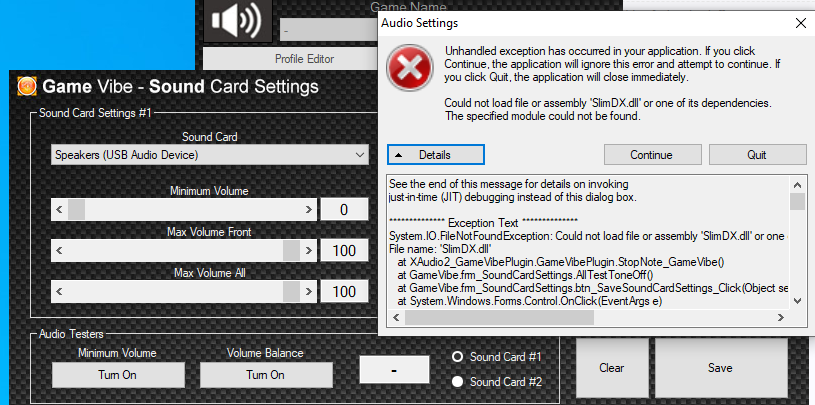

    Going through the process of reinstalling everything on a new PC and run into a dll missing issue with SimVibe. Anyone know a fix? I have tried to download and run the DirectX9 update but it says I am OK for that.
    Error is appearing when i click save after choosing my sound card.
