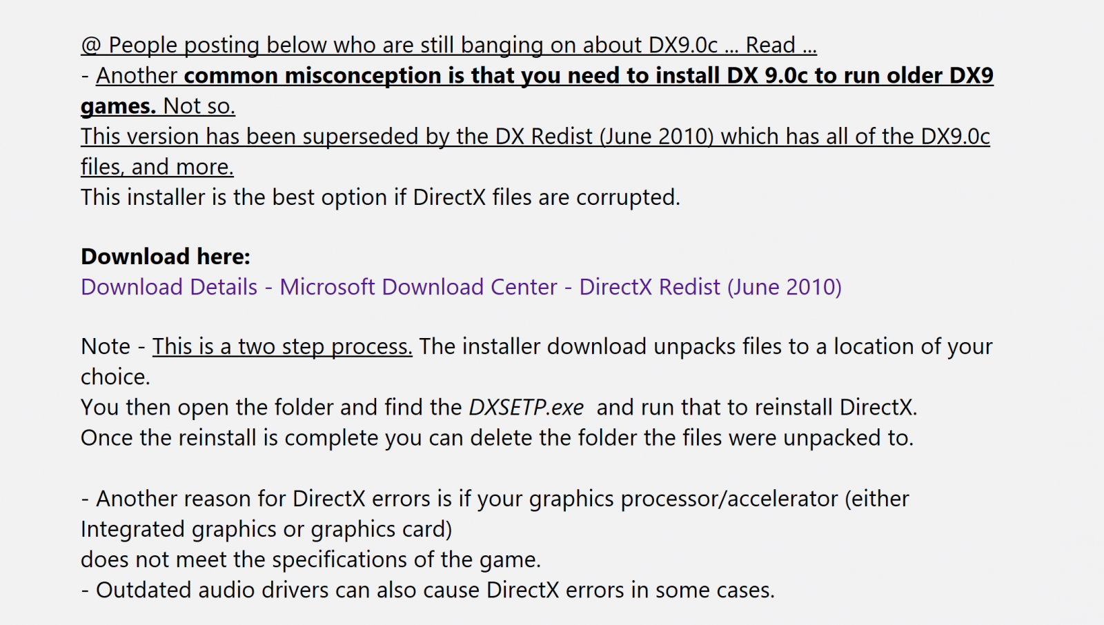

    Good job David!
    Its just older dx assemblies that wont get called unless something needs it.
    I can't see it hurting anything, but I can see it fixing a few things!
    Its funny to me that windows says "you don't need this" but you install it anyway and it fixes the problem. lol
    good old windows hehe

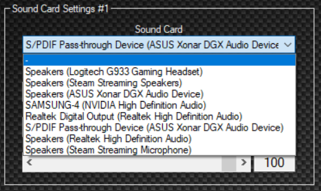

    Just to clarify this a bit more: you have to select the card above the right one.
    In my setup below, the card for the Vibe is Speakers Realtek High Definition Audio, but to make it work, I have to select S/PDIF Passthrough Device.
    edit: this is fixed in the lastest version.
    One more note: caution when testing the MIN and MAX. The square wave on the Buttkicker will be LOUD. :)

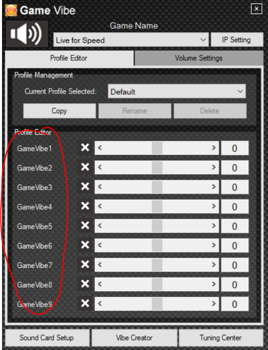

    In the current Beta version, this was renamed to Vibe Creator, instead of Vibe Settings.

    but spdif in your case... using a xonar. Here.. i put realtek and usb pnp ( im using2 sound cards with 4 auras in each )

    It's a list index issue within the code of GameVibe, so the actual name will always change in one's setup but the important thing is: you must select the item just above the right one in the list. In my case it was the SPDIF of my Xonar.

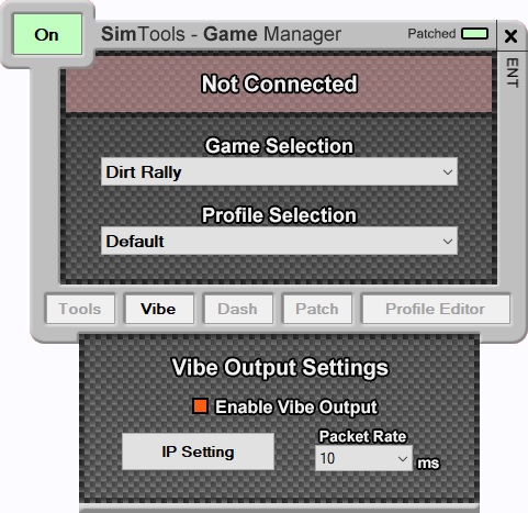

    @yobuddy, even with the provided LFS plugin, I'm not seeing the effects in GameVibe.
    Any hint?
  9. yobuddy
    51,741Coins
    +5,205 / 19 / -0
    @llluis,
    Did you turn it on in Game Manger buddy?

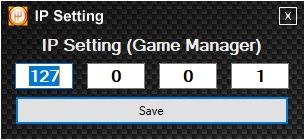

  11. riton
    riton Active Member
    Jul 6, 2007
    600
    1,006Coins
    +103 / 3 / -0
    I have the same problem.
    I'm on Assetto corsa, maybe it still does not work for Assetto?
    I saw another problem, I have a bug?when I change the IP, or I open the IP tab, then I can do nothing.

    This is happening with me too. I believe GameVibe is not communicating with GameManager for some unknown reason.
    Maybe @yobuddy should include the green box in the top corner of GameVibe too.
    edit: this is fixed in the latest version.

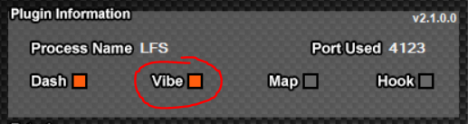

    Hi Guy's, I think what may be happening with some, is that LFS does not output telemetry when not In first person view mode.
    So when you first hit the track, press 'V' on your keyboard to change the view to inside the car.
    This will update GameVibe with the effects LFS has to offer.
    Let me know how it goes guy's
  19. yobuddy
    51,741Coins
    +5,205 / 19 / -0
    It should popup as IP Settings Box.
