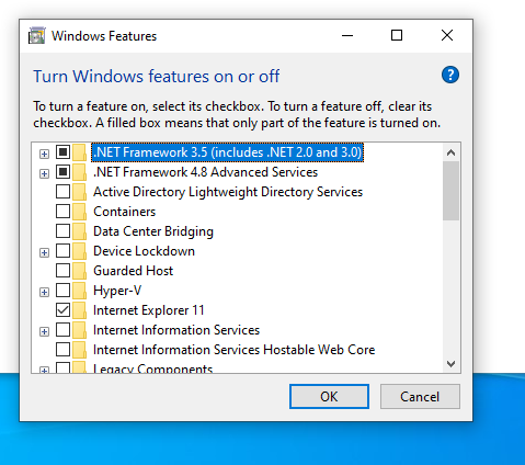

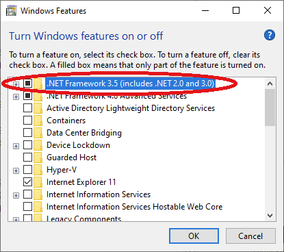

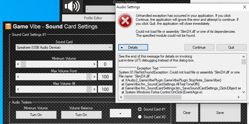

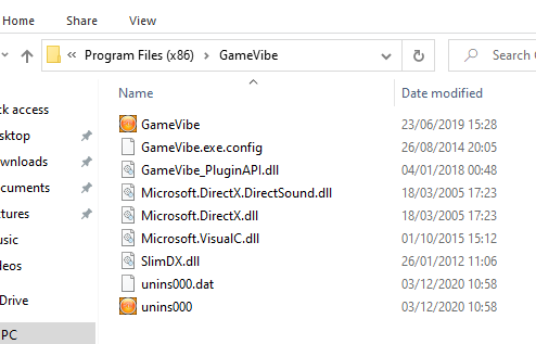

    The error say it can't find the file called "slimDX.dll" or one of it's dependencies.
    My guess is its a .net dependency thing for slimDX since we can see that you have the file pressent.
    Please make sure that windows does not have the older .net support off.
    (Control panel, programs and features, Turn windows features on or off.)
    Next, I would make sure you .net is up to date.
    https://www.microsoft.com/en-us/download/details.aspx?id=55170
    Let us know how it goes buddy.

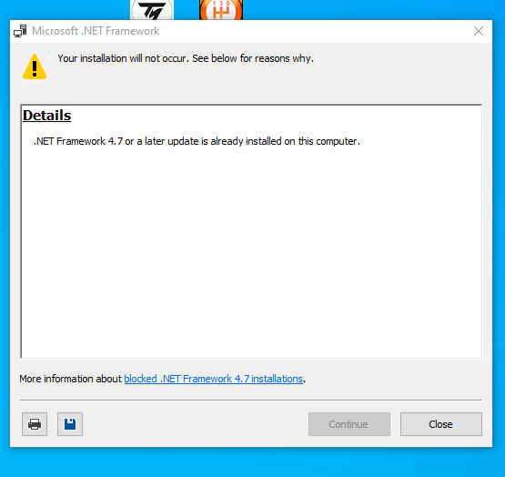

    Hey @yobuddy
    Checked .net is on for older versions
    Also checked .NET is up to date
    GameVibe still crashes, checked again after the PC was off all night. Quite the head scratcher!

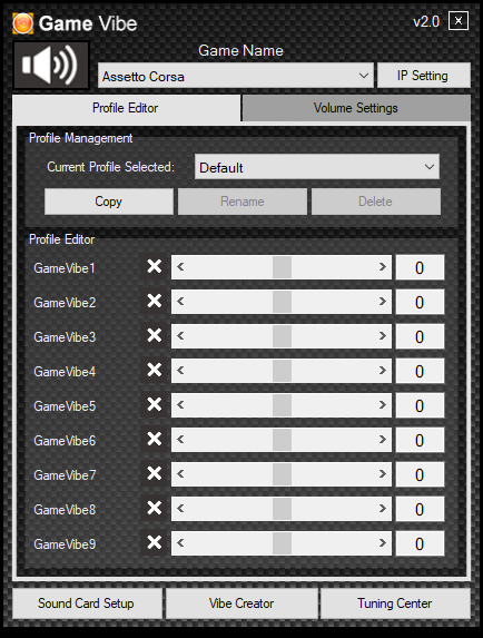

    It turned out to be just ignorance on my part. The sim software needed to have run at least once with game vibe on for it to 'understand' the vibe names. Once its setup like that it remembers in future.
