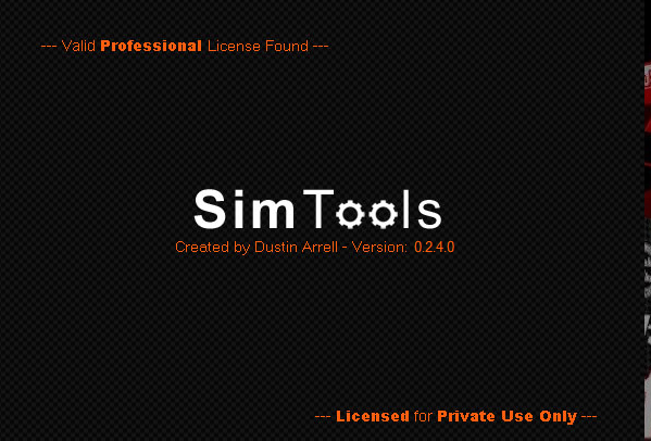

    I purchased 2 bass shakers and an amplifier and knowing that i have Game Vibe I thought it would be a piece of cake to have it start running. But no.
    I am using a usb stero sound card (for headphone) connected to a mono amplifier (Reckhorn) which has 2 shakers serial connected.
    In Game Vibe I can select the ""2 USB PnP sound device" and with the audio tester I get the test sound. However if I start AC I get no sound(shake) from the game. Only a very soft rpm sound that is hartly detectable. Messing with the volume in Game Vidbe doesn't do anything. Tuning Center is showing min/max data when I rev the engine for example. SO that looks good. Game is patched.
    I tried everything but nothing helps.
    Now i found out that not all Simtools versions support Vibe.
    I am not sure which version of Simtools I am running, startup screen says: Version 02.4.0 but my download history file says SimTools_v2.4.
    So my question are:
    • Would it be the SimTools version or could it be something else I am missing.
    • If I do an uninstall and install a new version would I delete all my motion settings and patches?
    Thanks, Mark.

    I had the same problem. Just downloaded the simtool install file and re-installed. Did not loose any presets
  12. noorbeast
    22,230
    154,849Coins
    +11,229 / 57 / -2
    The SimTools splash screen shows the version and you should upgrade to the latest version: https://www.xsimulator.net/community/marketplace/motion-simulation-software-simtools.63/
    From your description it is not clear if you have fully configured GameVibe, as like creating a motion profile GameVibe needs to have a profile for the vibrations you want to produce for a particular game, please see the manual: https://simtools.us/wp-content/uploads/2019/06/GameVibe_v2.0.zip

    Thanks for your help Noorbeast. Apologies for my late reply.
    So I got it finally running after the update of Simtools and re-install of Gamevibe.
    I tried to run Simvibe without my motion on, and that doesn’t work.Tthis took me a few hours to find out. Gamevibe only seems to work with my actuators powered on. Is this due to the com port error thats generated by Game Engine?
    Is there a way to run GameVibe without my actuators on?
    Also another thing i noticed is that in tuning centre i sometimes can’t save. And the game name is greyed out in the profile editor.
