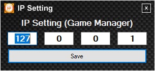

    The popup shows ok. But if I click Save, it freezes completely and I have to close the program. If I change the IP the change is not saved.
    edit: this is fixed in the latest version.
  2. yobuddy
    51,741Coins
    +5,205 / 19 / -0
    Bug Confirmed.
    I will take a look at this and the wrong sound card selected bug after i get some more info posted to make setup easier.

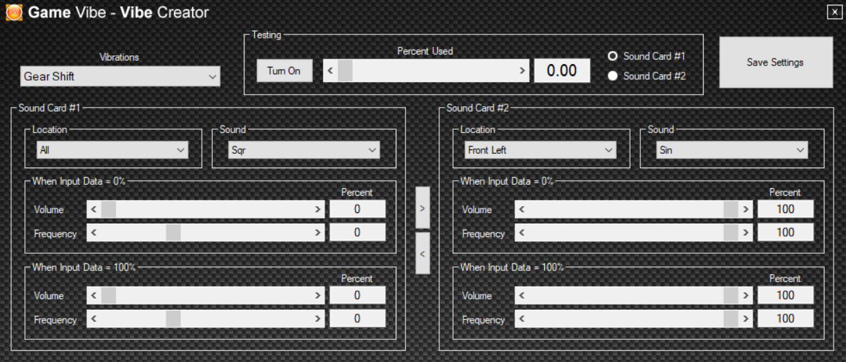

    Hi @yobuddy, two questions:
    1) Why frequency is from -50 to +100? Is it possible to correlate this with Hz?
    2) In Vibe Creator, should we have a "None" location, to allow us to select if the effect goes to SoundCard #1 or #2 only?
    For instance, if I want Gear Shift only on FrontLeft on #2, how would I configure #1?
    One more note: if we close the Vibe Creator without hitting Save, it will save the changes anyway.
    edit: changed in the latest version
  10. yobuddy
    51,741Coins
    +5,205 / 19 / -0
    Well I want to get to where we can add more sound effects.
    (like anyone can try out any sound loop they make)
    And I'm not sure exactly what everyone will base their sound at.
    I made all the samples at 50hz, but we will see if we keep them there after the beta.
    And is 50% negative deep enough for all transducers?
    (I only got to test one set after all.)
    Do we have enough high frequency headroom too?
    (to much and the note becomes audible)
    I guess there is still some questions I have before I work out the fine details.
    In the end, I'm sure there is math for the proper output.
    2) Yes, this is a good idea!
    Man I spent all day working on the wrong sound card selected problem for XAudio2.
    (everything works fine on XP lol, but that's because it uses direct sound)
    Anyway, after a long day and not much working, i noticed they changed the way it works in the newest version lol.
    So I will try that tomorrow.
    It would be a whole lot easier if it was just a math +1 error lol.
    Take care,
    btw, the IPAddress windows problem was because I forgot to re-enable the main window after you click ok. :p
    Simple fix!

  12. llluis
    Mar 30, 2017
    164
    Quebec
    1,632Coins
    +103 / 1 / -0
    Sorry to hear about the soundcard list issue. Let's hope the new version will help you.
    So, a 0 frequency in GameVibe (which is a %) means the tone will be 50hz? And our range, using the built-in samples, will be from 25hz to 100hz?
    Buttkickers can go as low as 10hz.
