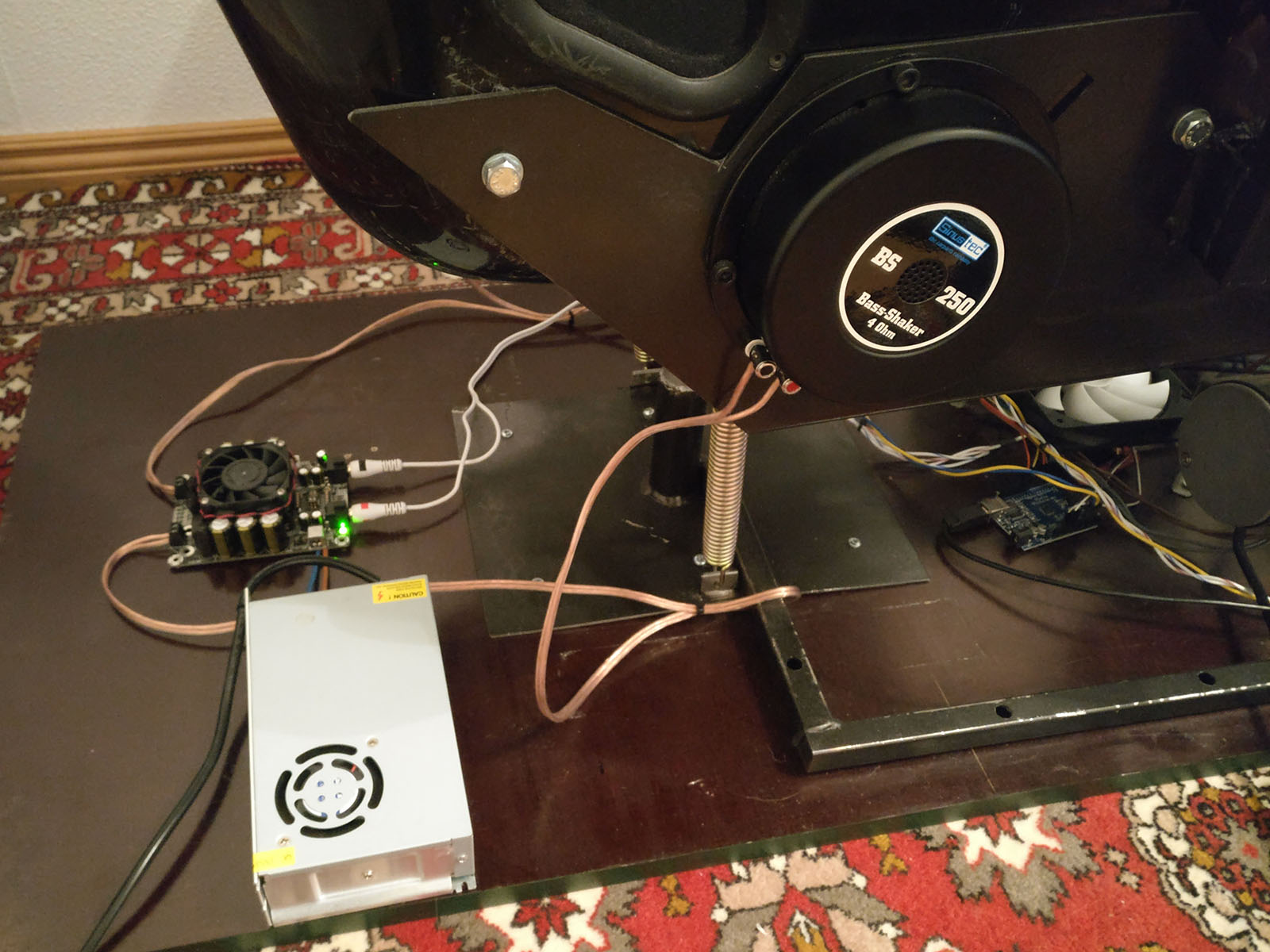

    @Daguru @Lol4 I tried increasing volume. If I increase it a lot, vibration will be noticeable with different frequencies. But then when I change back to 23-24hz using that volume level - earthquake time as Daguru said. :grin I also played this bass test straight from my phone and again the frequency range was very narrow. Although the video isn't correct I think (23-24hz in GameVibe was comparable to 40-45hz in this video). *youtube*
    Some specifications of ST-BS250 bass shakers say they work 30-100hz. Ok, they might make some vibration but they only really work at 23-24hz... Unless there is some problem with my amplifier, but I guess it's unlikely. Fortunately GameVibe has such precise adjustments. :thumbs For these shakers it would be nice to have 0.5hz steps though. @yobuddy
    My simple setup (WONDOM AA-AB32971 2x100w amp):

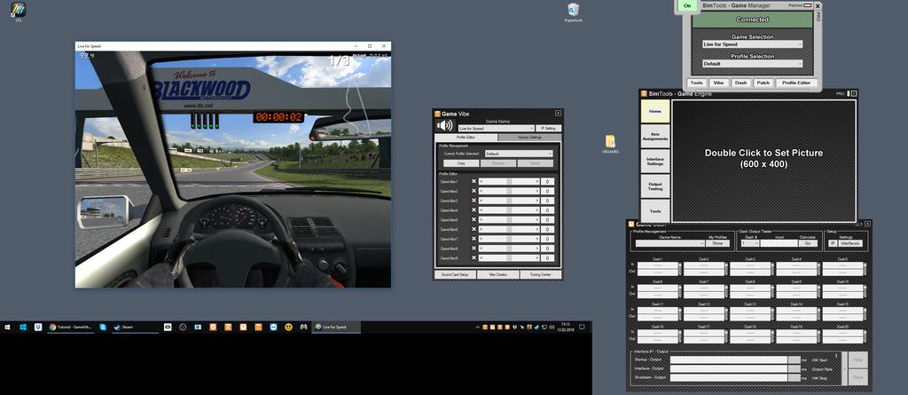

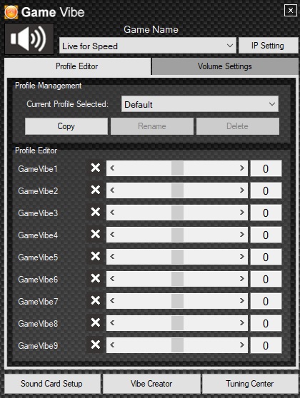

  9. Bastiuscha
    Bastiuscha Active Member
    Apr 1, 2017
    291
    750Coins
    +192 / 2 / -0
    In know, i know, that picture we have here more than one times...but i have to post it again, to explane my mind. :)
    Since a short time, we have GameVibe support (for ASSETTO CORSA) in the lastest plugin update. But on the profile editor, i have still no entry's. It's my first contact to gamevibe, so i think, i do some wrong. But you can see, on the screenshot, on LFS, i have the same issue. What i can do wrong? I installed ne lastest plugin, with the updater and activated (10ms)gamevibe on the gamemanager. Soundcheck's on the vibe creator works fine.
  10. llluis
    Mar 30, 2017
    164
    Quebec
    1,632Coins
    +103 / 1 / -0
    Was the game running? Are you using only GameVibe or do you have a motion sim too?
  11. Bastiuscha
    Apr 1, 2017
    291
    750Coins
    +192 / 2 / -0
    Yes it was running, but LFS btw not. I did not know, that it must be running, to show that. :) But again, AC was running. Yes i use motion sim and GameDash too.
  12. llluis
    Mar 30, 2017
    164
    Quebec
    1,632Coins
    +103 / 1 / -0
    Keep that window open and start the game and a race. With the racing going check the window. It must have changed.

  13. Bastiuscha
    Apr 1, 2017
    291
    750Coins
    +192 / 2 / -0
    Yes, that was my plan...i the meanwhile, i installed LFS. (I had to install new, because i installed win10 last week) But with LFS, i now have a second problem. The gamemanager don't find LFS. He do not connect?! I installed it, like many times before. The race begins, but "game running" will not appear. For tests, i can use my notebook. There is LFS and simtools installed too. But, what is here wrong. ;D Now, i will going to check that stuff on my notebook.

  15. Bastiuscha
    Apr 1, 2017
    291
    750Coins
    +192 / 2 / -0
    Oh man, of course i did not patch the game. :oops: That was the reason for the "game running" problem. How dumb....
    Now LFS works on my PC and on my notebook too. But on both machines, gamevibe still don't work. Yes like i said, i activated vibe with 10ms. I start the game, but nothing on the gamevibe window is changing. And maybe important: on the vibe tunning center, the informations from LFS don't arrive. That means, i don't see, any valuechanges during driving.
