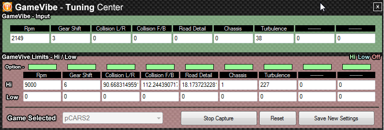

    Similar issue with latest PC2, rF2 & AC plugins. The only way I can get GameVibe to recognize that the game is on is by
    switching Game Manager On/Off when the game is running.
    All looks fine in GameVibe Tuning Center however transducer is silent.
    Dirt and LFS works fine.

    Can you tell me, how dumb one man can be? Of course i had V2.1! I was sure, that a have the latest version. After your question, i checked again and found that disgrace. Since the first test with LFS and Assetto Corsa, in both sims, Game Vibe show me the values in the profile editor. :thumbs
    But one problem left...on soundcart setup and on the vibe creator, i can hear the testsounds and on the tunning center, i can see the valuechanges during drving, but no sounds still. I believe here in this thread is the solution for that. I will read from the beginning again. Much thanks man!

    ok i re-tested simvibe and after my test, game vibe doesn't works again but.... what i found...
    My sound card works with realtek driver and i have an option to split the signal between front (where my headset is connected) and rear (my buttkicker).
    I am able to make gamevibe working with this config (as simvibe) (headset is configured as main device and buttkicker as second communication device) but i'm not able to succeed at the first try.
    if i connect my headset at the back and i set my config as quadraphonic(as yobuddy explained at the beginning), everything works as expected.
