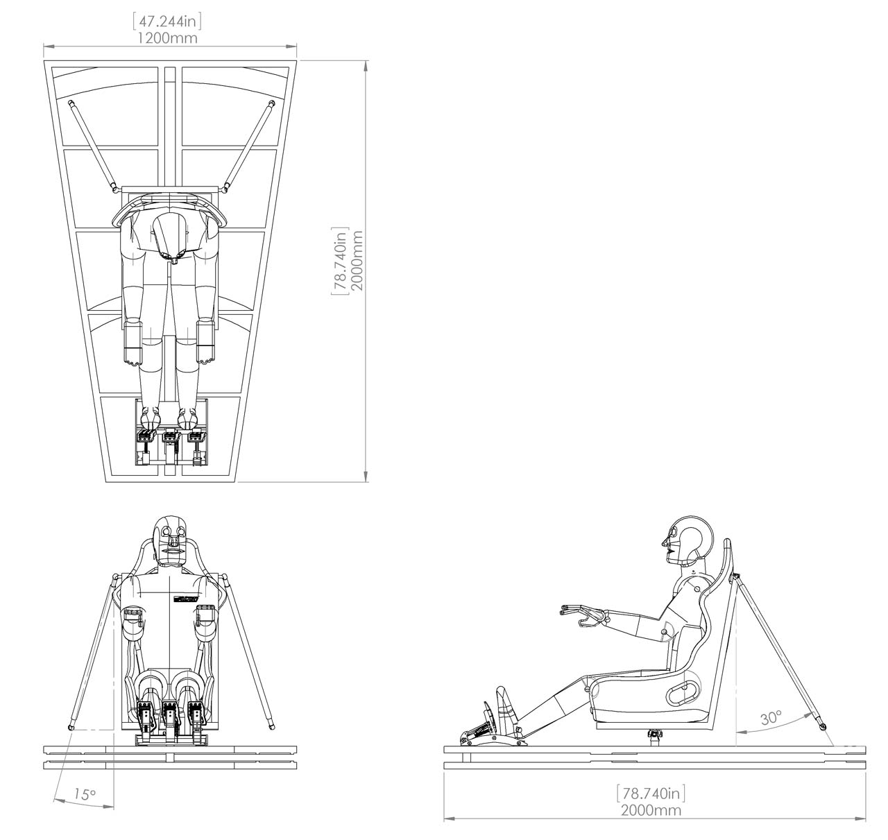

    I wanted to solicit some advice from the expert builders here on the forum :)
    Based on my preliminary design above, I want to determine what material to use for the frame. The obvious is steel but perhaps I need to use lighter weight material since its going to be traction loss frame that needs to be moved smoothly (with a 50:1 gear motor)
    If steel, how wide should/could the steel square bars be and how thick? I want to ensure there is no flex or bending.
    Lastly, what material to use for the castors to roll on for traction loss, should it be a half inch piece of steel or what else can I consider.
    thanks guys!
  4. bsft
    @Nick Moxley , what did you build your set up from? Maybe you can advise here

    +166 / 1 / -0
    That setup is not yet built. I think steel is likely the senseable choice. Wondering what size rods others have used.
  6. bsft
    Ive use 25mm box steel on mine with no problem, and had 16mm MDF sheet screwed to the base to hold the tailshaft uni. It supported my 86 kg and 12 kg seat easy. And even survived 130 kg players
