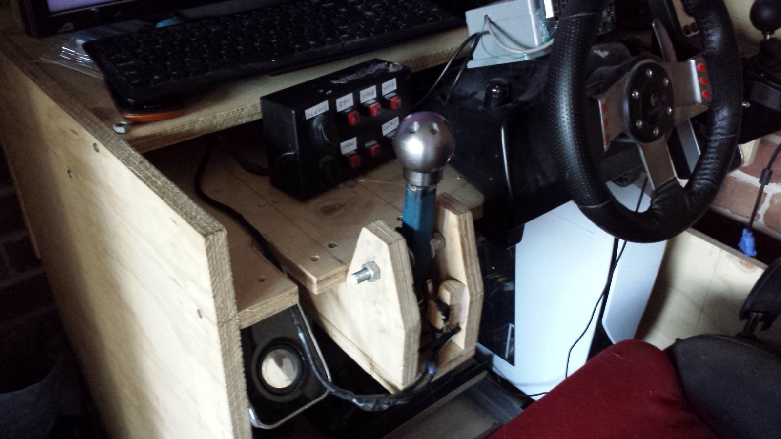

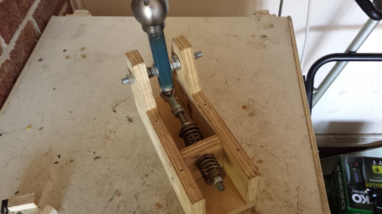

    @f1iceman , its a neat set out.
    I can figure out the spring part easy, done that. Well. with a sequential.
    and adapting that into a "H" pattern shifter doesnt seem difficult. Theres a few sites and youtube videos handy.
    Just the notchy rod might be a tad hard for me as I do not have an engineering workshop handy. But I reckon a length of steel rod with some grinds shaved into it to make the shape and a suitable spring ball would do it.

  4. bsft
    @f1iceman , its a bit difficult to see, but i use micro switches that are wired into a hacked dpad button board.
    one switch for shift up, one for shift down, you can see my rough and ready button box as well

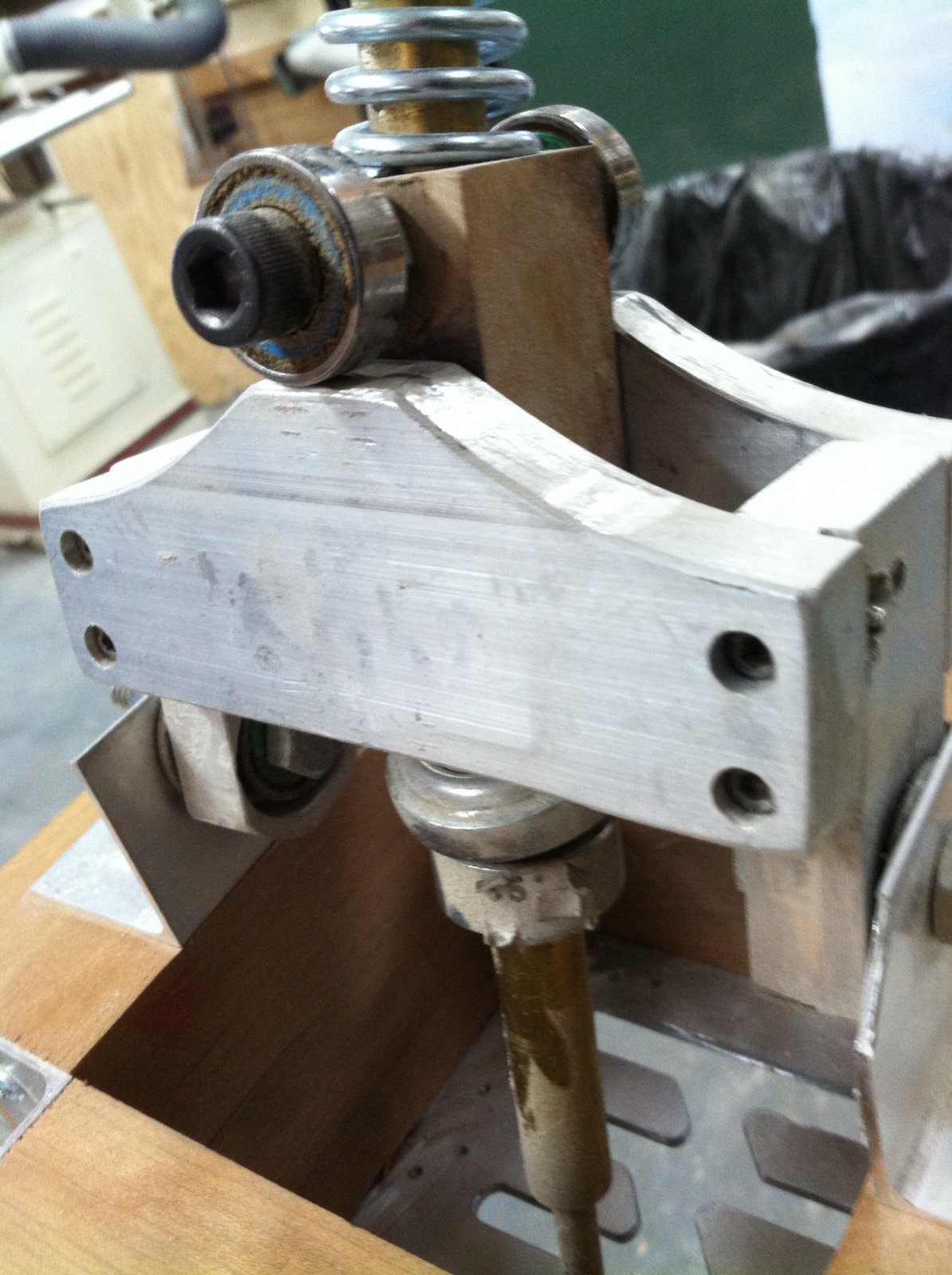

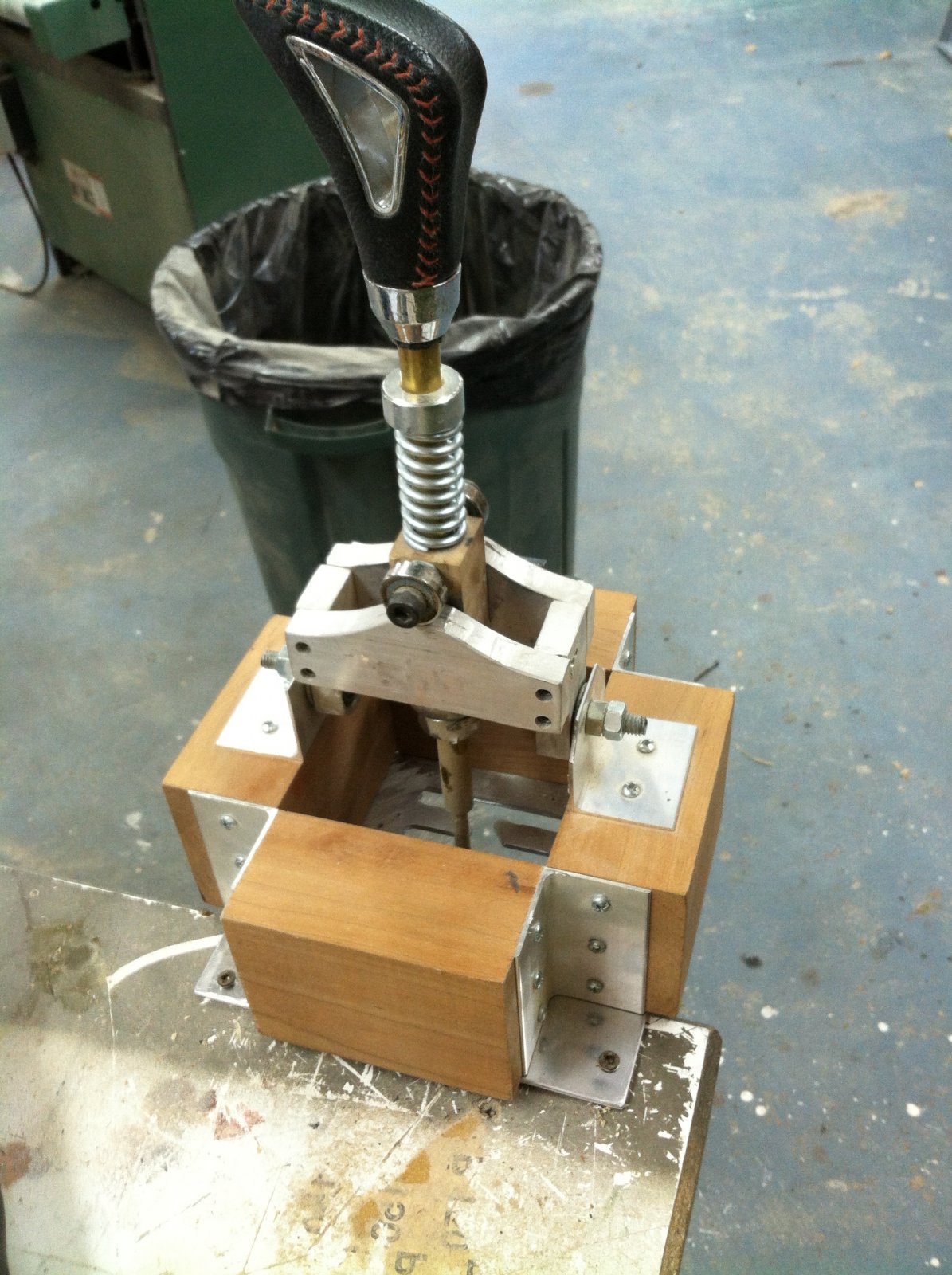

    I agree Dave, you can use a long rod out the bottom and hand saw (a drill bit and keyhole saw would work) to make the H-pattern plate like I have below, also a good place to put the micro switches (ok, so the ones that I had handy were not so micro, lol).
    For F1iceman he could do the same but at the top.

    That brilliant what you have made :)

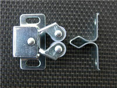

    a long time ago me n a friend made a similare thing but used a joystick and just cut the H plate saved all the switches, then just mapped the joystick moves, but also please look into the ball bearing part on the pic i put up as that denotes a real feel of going into gear that will work awesome with what you have done so far. i think you can use cuboard catches to do the same from memory put them at each end of the lever travel by each switch.

    That clasp is not needed with this setup, the bearing rolling off the high points give the exact feel of engaging a gear.

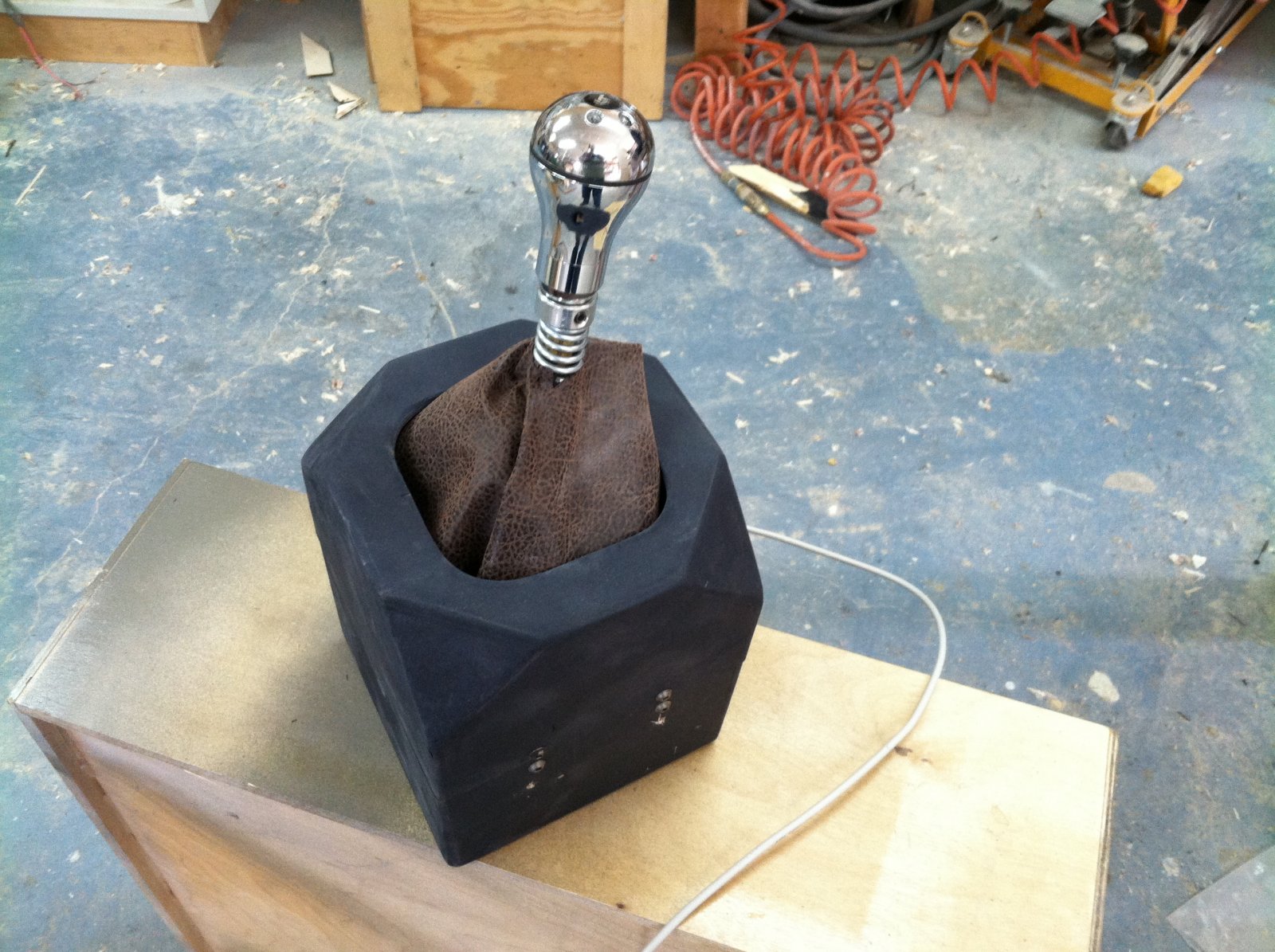

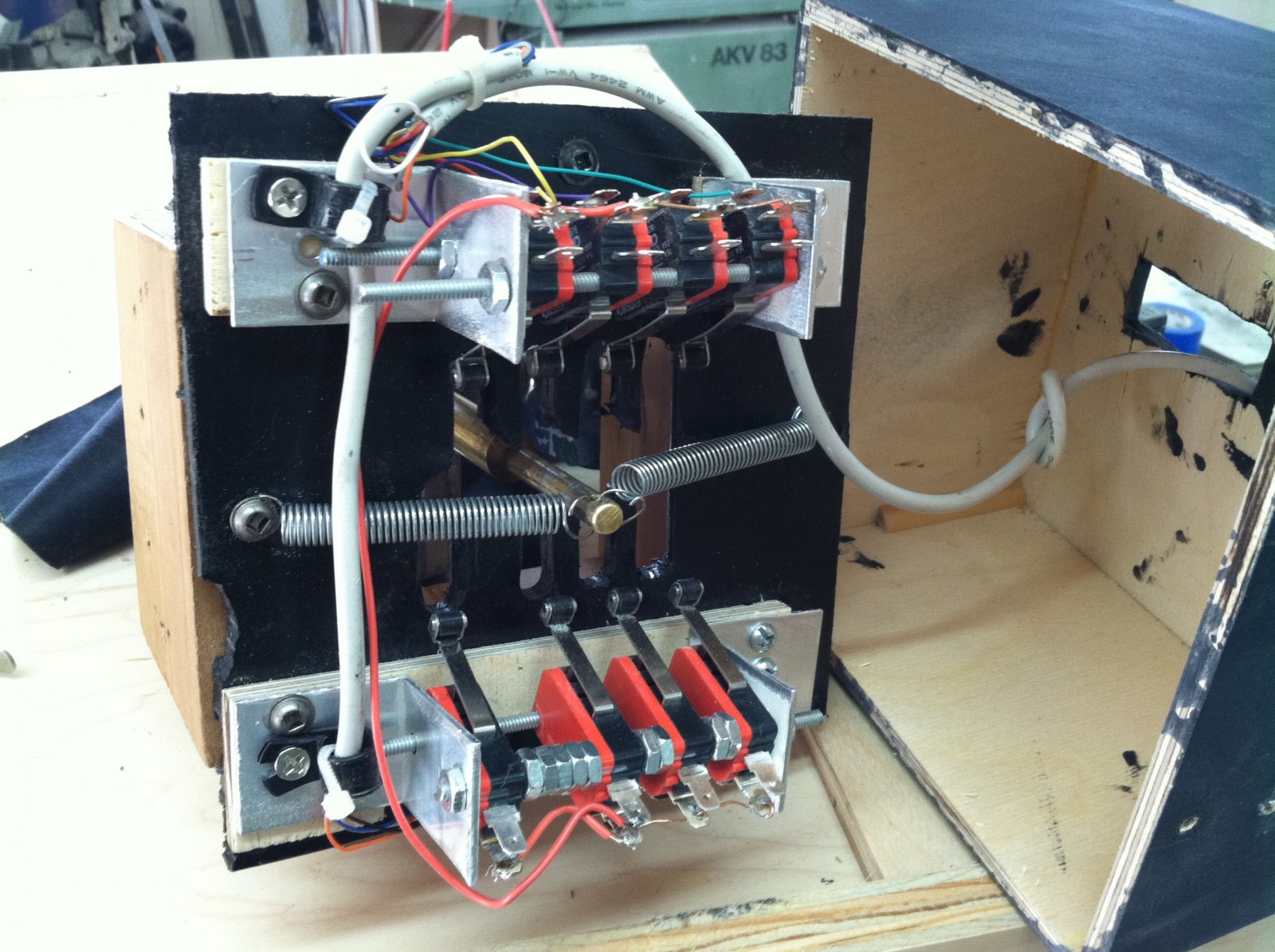

    This shifter was first pioneered by a member here on the forums; Elnino. I just enlarged his plans slightly to make it easier to machine, added my own design for the h-pattern plate and micro switches.

    Love it does it drop into gear and do you have to pull it abit to get it out of gear?
    is the spring there so the bearings can move up n down to follow the curve when pushed forward n back

    The spring and ramp give it that "clunk" into gear and the resistance getting it out of gear. It creates a very realistic feel of shifting gears.
    @bsft The Notchy Bit is the whole point of building the shifter. Without it I may as well just put seven buttons on a panel and push the one numbered for the gear that I want. I wanted a shifter that felt as realistic as possible.

    You need to design the notchy bit then build around it i guess is the best way with how you go about it. im not sure i get the drawing as you have 2 spring pulling the stick back to centre forward and back not side to side so your not able to keep it in say first without it coming back to neutral ? i would build from the notchy bit and make the H shift on its own then add a clip on plat for sequncial shift with 2 spring that push back to centre from 3rd n 4th.the springs are build into the plate tho. or even a lever that pushs the spring out the way and not intererfer with the h shift pull level and they sit between 3rd n 4th. get both gearboxs in one that way.H shift is they way to build to then add the sq shift as thats easyer.
