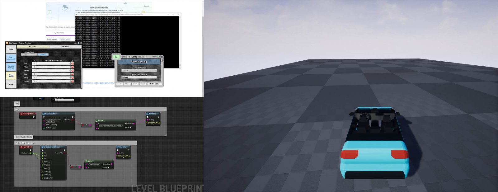

    If someone could help me out, I'm trying to use Simtools with the plugin provided by Claudio (great work by the way!) .
    It is sending information to his UDP servers (I don't have the SCN5 actuators here with me yet), but as can be seen on the attached screeshot, unreal is sending the same values repeatedly, and are the same values defined in the Blueprint inside unreal no matter how hard I turn and move the car.
    Is that supposed to be like that or should it vary according to movement? If so, should it be connected to the car geometry somehow?
    I appreciate the help! Thanks!

    Did you make any progress? The short answer is yes. The tilt and roll are handled a little differently. If you haven't already, I would start by tying your acceleration (in game)to your pitch. You may have already done that but it's a little hard to tell from your blueprint. Roll is tied to x translation.
    Side note, had anyone experimented with tying pitch and z translation (platform) to acceleration (in game) at the same time?
