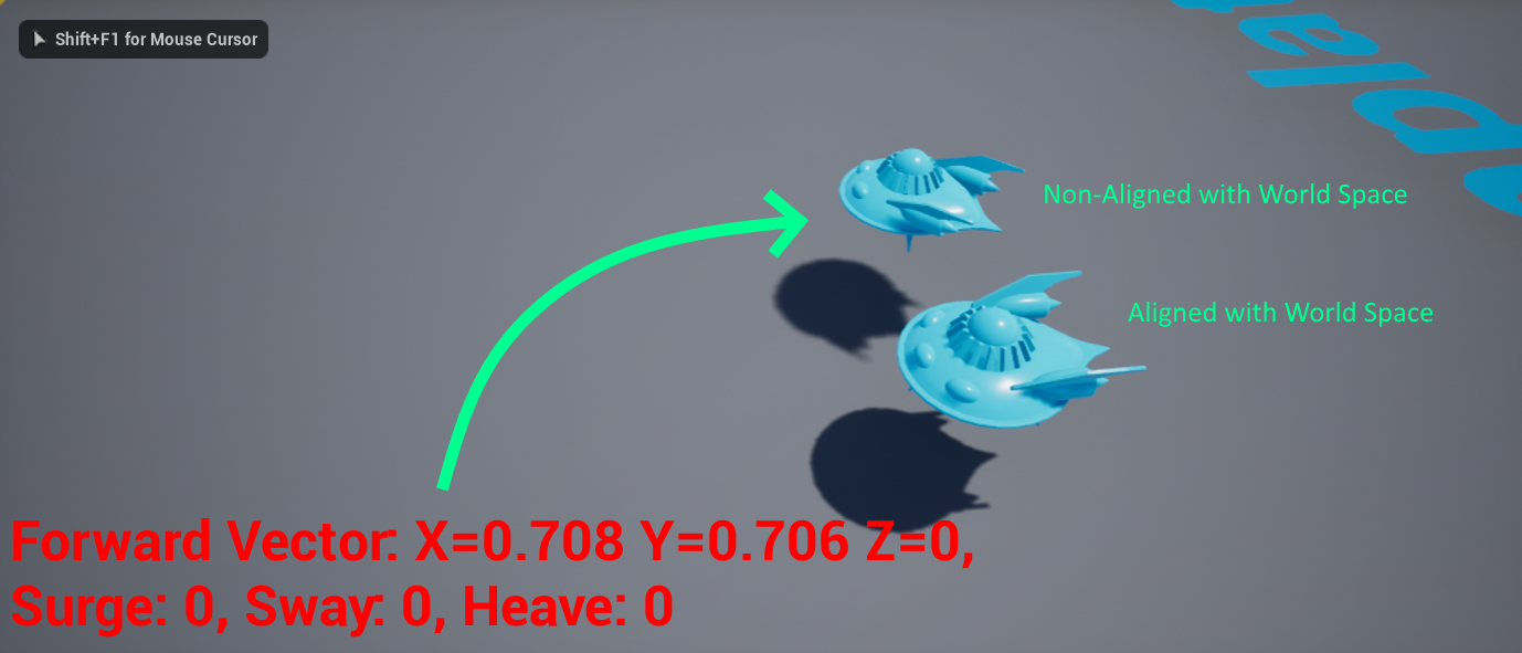

    So here's the problem:
    I have an object in world space, X is the forward axis, Y is the right axis and Z is the up axis. When I move the object in the X direction, I get a surge value, positive or negative depending on how it's moved. Sway and Heave also gives me good values when I move the object left and right or up and down.
    Problem occurs when the object is rotated in the world space, so that it's forward vector changes. As such:
    So when I move the non-aligned plane along its X-axis, you can imagine it moves along both X and Y axes in the world space.. resulting in both surge and sway, even though it should just have sway at that moment.
    I hope I explained this correctly, I can only access the world coordinates of the object and that is the way I can calculate acceleration, by checking its position between the last frame and the current frame. However whenever the forward vector isn't (1, 0, 0), this method fails. It needs some extra mathematics and some sort of calculation with the forward vector to figure out.
    Thank you very much @Dirty so far for your help. :)

    Hey :)
    yeah, let's continue our conversation here, as there might be people around who might be interested or able to help.
    These are the steps I recommended:
    1. For every frame you subtract the previous position from the current position. Always in world coordinates! That difference is a "Vector3" (I guess it's called a "Vector3" in Unreal as well?)
    2. Then you divide that vector by DeltaTime (frame duration in seconds). Now you have your inertial speed vector (ISV) in [m/s].
    3. Since you also did this on the previous frame, you can subtract the previous ISV from the current ISV. This difference is then also divided by DeltaTime (frame duration in seconds) and you get the inertial accelerations vector (IAV). It is in [m/s^2]
    4. Divide this vector by 9.81 to convert units to Gs.
    5. Add the gravity acceleration to this vector. I think it should be {0,1,0} in Unity or {0,0,1} in your project. Anyways, the positive "one" should be on the UP component. The resulting Vector3 is your world specific acceleration (WSA).
    6. Then project this vector onto your vehicles longitudinal, lateral and vertical axis. I mean onto your vehicles lon/lat/vert axis expressed in world coordinates. You only need to know the length of the resulting projections. 3 floats. There should be a function for that somewhere. I think it's called "change of basis". These three numbers form a new Vector3 of their own and that is your vehicle specific acceleration (VSA).
    7. These three numbers can be sent to the motion cueing cueing software to represent lat/vert/lon acceleration in [G]. It represents the translations a person would feel on the vehicle.
    ...the important part is step 6. This is where you convert world accelerations into local accelerations in the coordinate system of your vehicle!
    If you also want to get the vehicle specific angular rates (if your vehicle is pitching and rolling), you will have to compare each frame's quaternion with the previous frame's quaternion. I am certainly not an expert on quaternions, but basically for each frame the question is:
    "How do I express the current orientation in the previous frame's reference system?"
    Maybe someone with a better understanding of quaternions can say which quaternion operation you need to achieve this.
    If your vehicle does neither pitch nor roll, then (world) heading rate can be used as vehicle specific vertical angular rate (yaw rate) and maybe you don't even need to add the gravity vector.
    Dirty :)

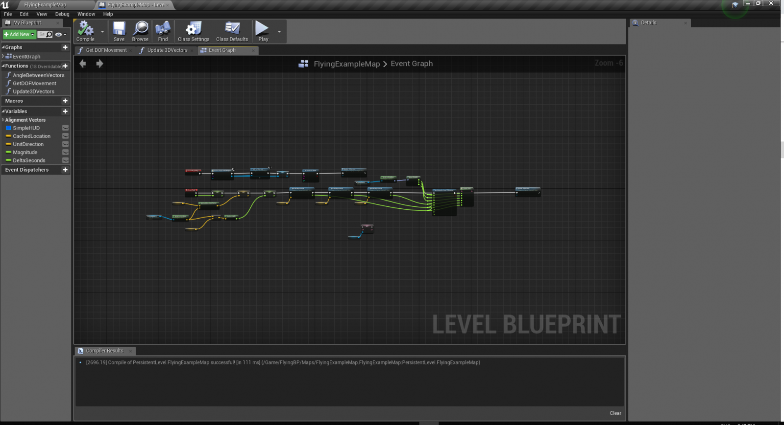

    Ok so I had to go back to my days at university and bring out the trigonometry a little bit for this one :D And some common sense. :D I wrote the full blueprint code and get seemingly correct values in Unreal now. I can post the full code in Github if other members can confirm that this is an acceptable solution. If not, I'll do further fixes with your help and post the code then.
    I'll cut to the chase and try to explain it the best way possible. I'll explain it in a 2D coordinate system first, because the solution is exactly the same for a 3D coordinate system. So in my explanation, you only get the values surge and sway, since there is no up-vector for heave.
    1. Take the world space location of your vehicle, and take its forward and right vector.
    2. Move to next frame and take the new world space location of your vehicle.
    3. Find the difference between the new world space location and the world space location at the last frame. Then take its length, this will be the magnitude of your movement.
    4. Find the unit direction vector from your world space location at the last frame to the world space location at the new frame. Keep in mind that the order of this is important! It moves from the old frame to the new.
    5. Right now you need the 2 different angles. One will be between your forward vector and the unit direction vector. Other will be between your right vector and the unit direction vector.
    6. For the surge value of your vehicle, you will take the angle between your forward vector and the unit direction vector, and plug it into a cosine function. Then you will multiply this with your magnitude. This is your surge value.
    7. Do the same thing for sway, by plugging in the angle between your right vector and the unit direction vector into a cosine function and multiplying it with the magnitude. This is your sway value.
    8. In order to keep this logic going, before moving to the next frame, you have to save your new forward and right vectors. As well as saving your new location so that it can be compared with the location at the next frame. Then you repeat this logic! Simply move to the next frame and repeat from step 3.
    9. If you want to add heave, simply keep note of your up vector and do the same thing. Nothing changes in this logic except a few additional calculations for heave. Find the angle between your up vector and the unit direction vector, plug it into a cosine function and multiply it with the magnitude. That will be your heave value.
    I will write in the spoilers 2 simple examples showing that it provides correct output.

    What you have done is calculate the velocity along and perpendicular to the vehicle fwd. direction. If you want the accelerations (which I highly recommend!) take one more derivative of those values. Just divide the difference in velocity by the difference in time: ∆V/∆t
    That will be a much better indication for the forces felt on the vehicle.
    Other than that, it seems correct for a 2D-only application.
